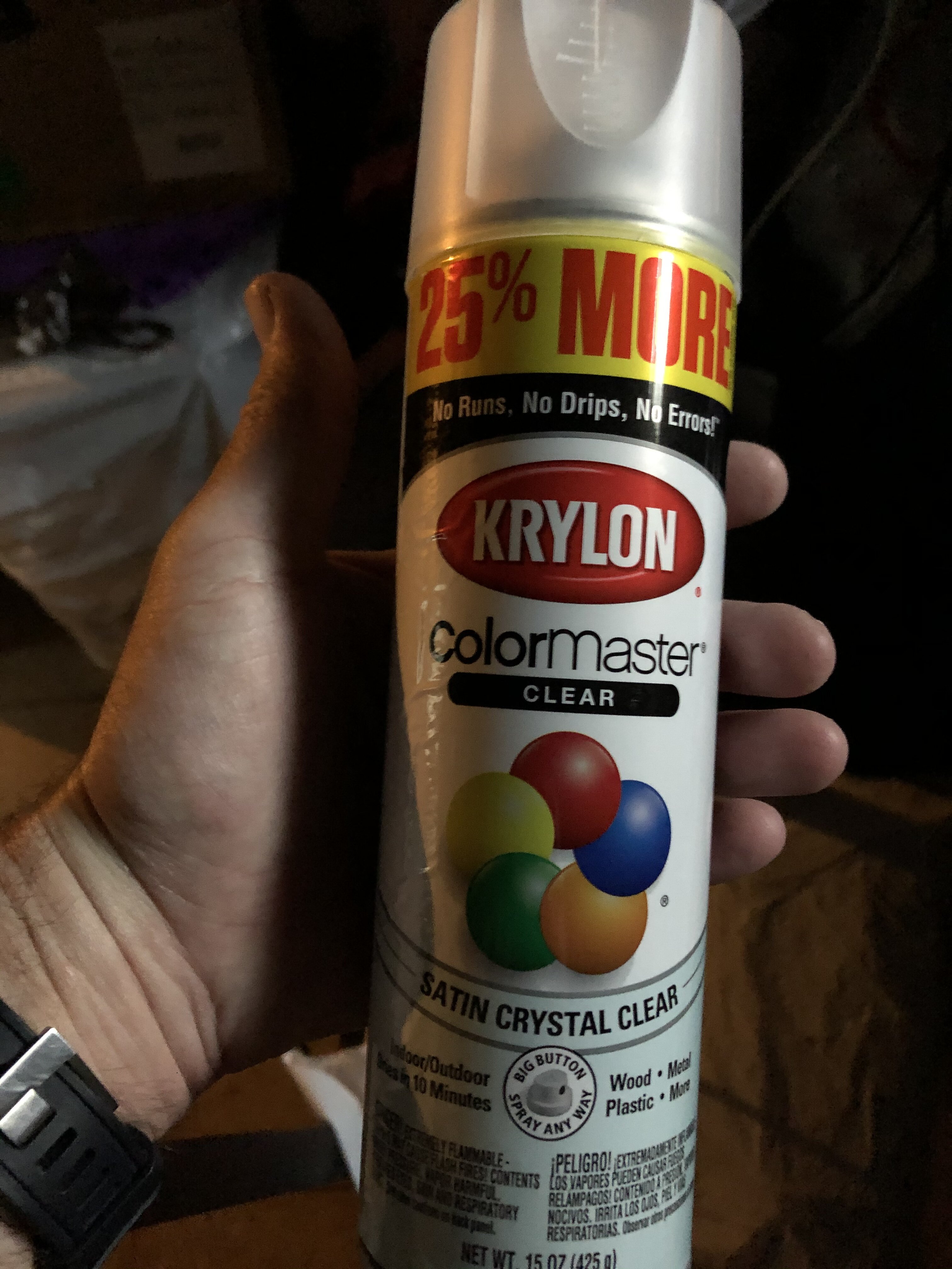

Slightly off topic, but perhaps relevant for the “sheen” aspect.
I needed to matte a watch dial. Most matte clears cloud the surface- basically a white cast is carried in the clear, which turns a black dial gray. So, it’s not truly “clear” but cloudy.
I tested a bunch of rattle cans on a #9 (I think) dark green welding glass. Doing this you could see as soon as it was dry, if it was “white” or clear.
I ended up with a Krylon product (it’s down on the watchmaking bench or I’d post a picture) that did matte the glossy black dial without “graying” it out. And it went on thin enough that the raised printing (pad printing) on the dial was still raised.
Now, will it react with another paint? You have to test. Ideally on the same substrate. Reason being: the paint may not appear to be attacked by the clear on one substrate; but on another it could delaminates the paint from the substrate.
in all cases be sure the paint is well cured before clear coating.
Here’s the semi-gloss that’s not cloudy:
All I know is, when sprayed onto a welding shade glass, this remained the original green color, whereas the others I tested clouded the surface, like white powder on the green (Silica I presume).
So, to preserve the color, try this stuff.
