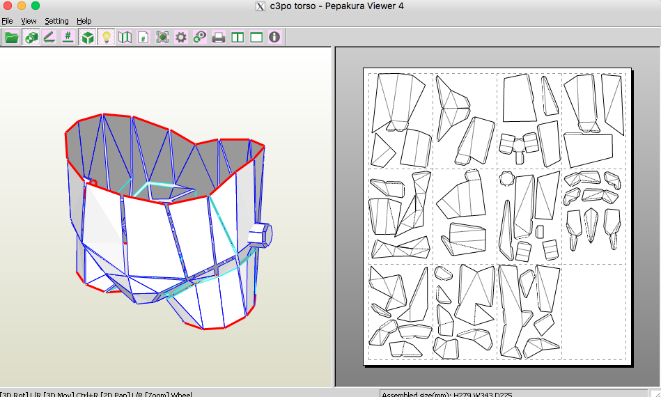

If you share some screenshots of the pep file 3D maybe we could comment more.

Here are some screenshots for you to check out. Now I have no clue how to use pepakura designer. I know how to build pepakura, just not use the program well. I pretty much know how to print it out. Screen Shot 2017-06-26 at 12.29.32 PM.pngScreen Shot 2017-06-26 at 12.30.24 PM.pngScreen Shot 2017-06-26 at 12.30.48 PM.pngScreen Shot 2017-06-26 at 12.31.05 PM.pngScreen Shot 2017-06-26 at 12.31.27 PM.pngScreen Shot 2017-06-26 at 12.29.32 PM.pngScreen Shot 2017-06-26 at 12.30.24 PM.pngScreen Shot 2017-06-26 at 12.30.48 PM.pngScreen Shot 2017-06-26 at 12.31.05 PM.pngScreen Shot 2017-06-26 at 12.31.27 PM.png

here are the pep files I'm using

I don't think those files are really much use.
The mask looks ok but is probably the easiest thing to get for not to much money.....
