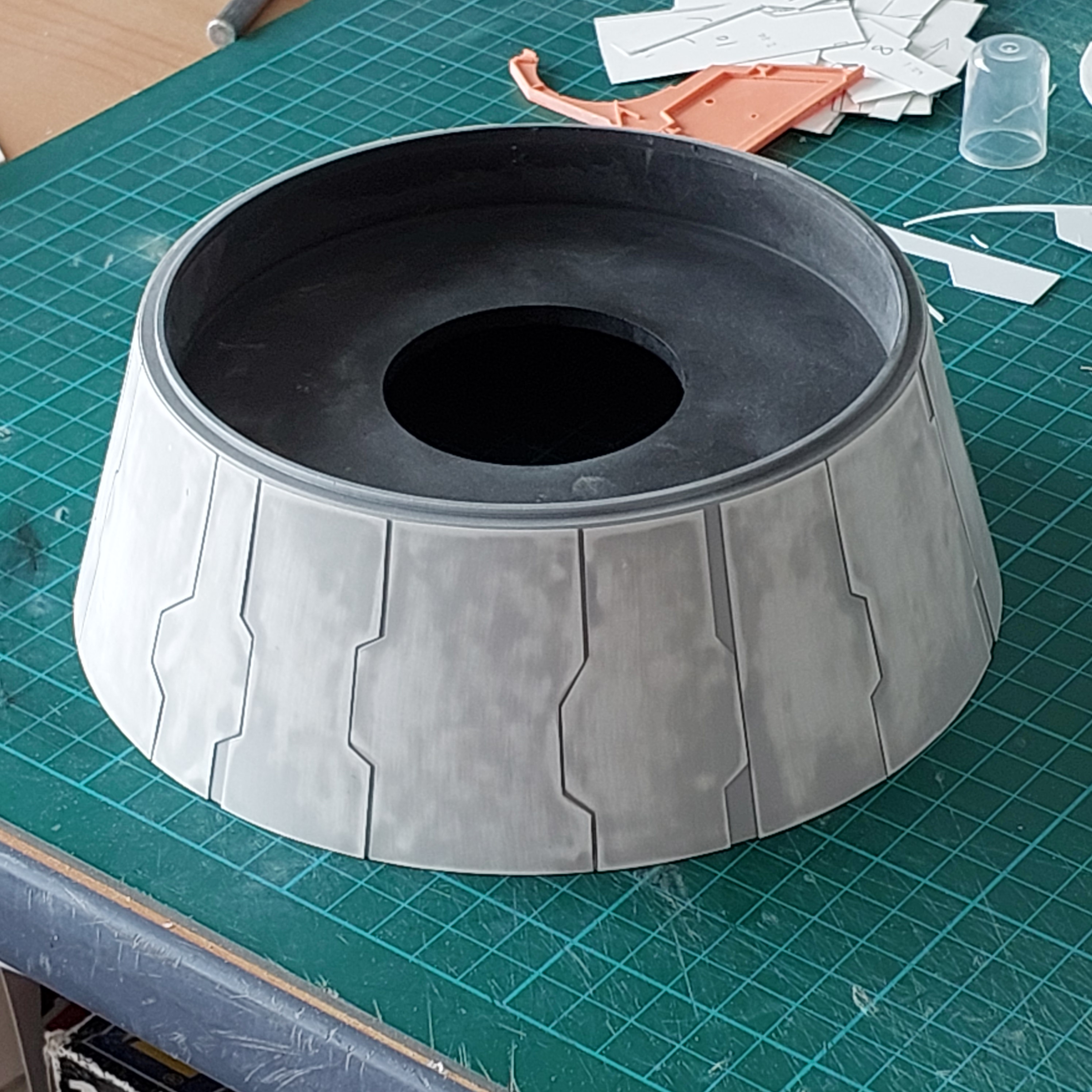

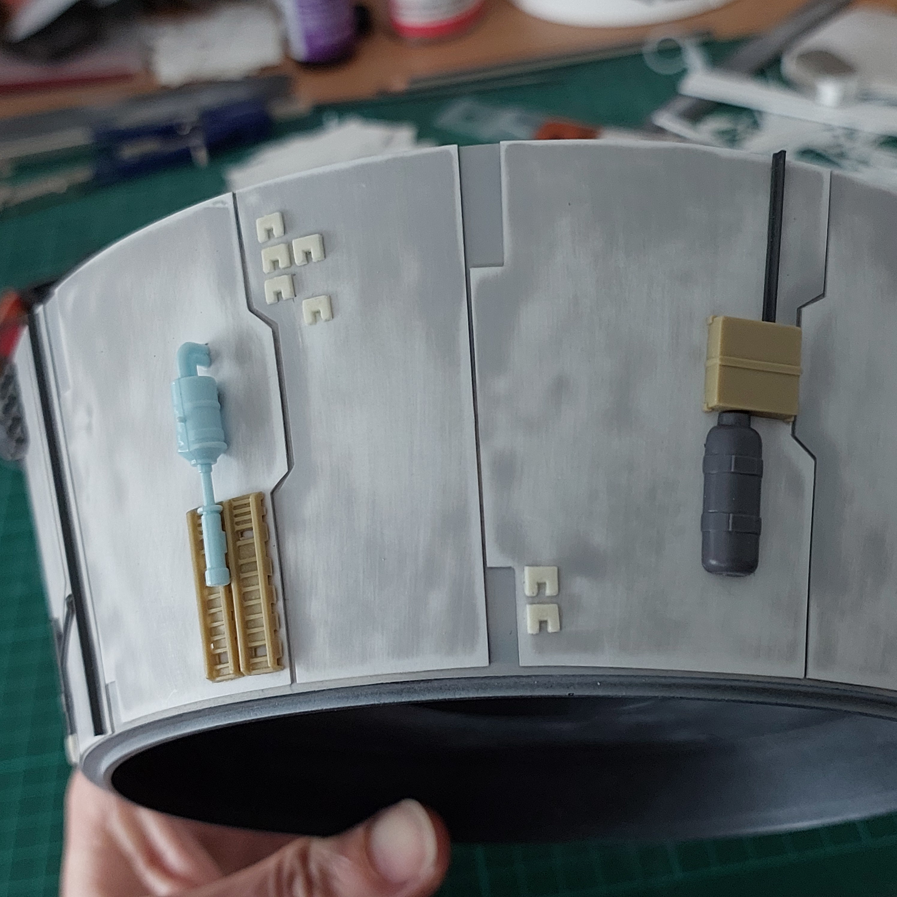

Hey guys!.

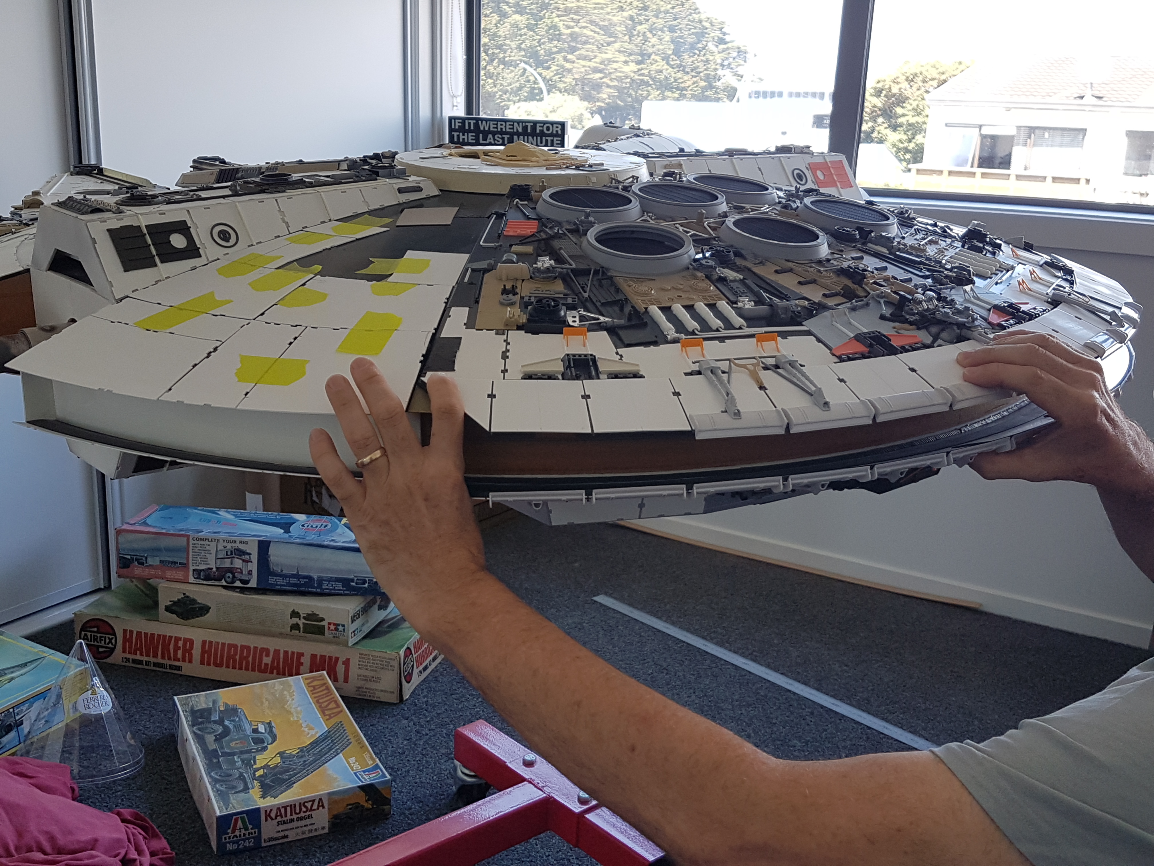

A few pics of me working around the Falcons rear end & what a complicated rear end she has!.
Nearly finished up the engine petal strips top & bottom. Gets repetitive here in that there are 26 styrene plates, 26 M8 plough blades & 26 struts to add. I'm finding going back to this area in intervals works best for me, while working on other others, keeps the interest levels up & not bogged down on one set area for long.
The dome sets i have had to reorganise with another fabricator for some of you, this has been a real, lets say 'challenge' to get right in how i envisioned them, but they will be delivered to all who ordered them.
Cheers

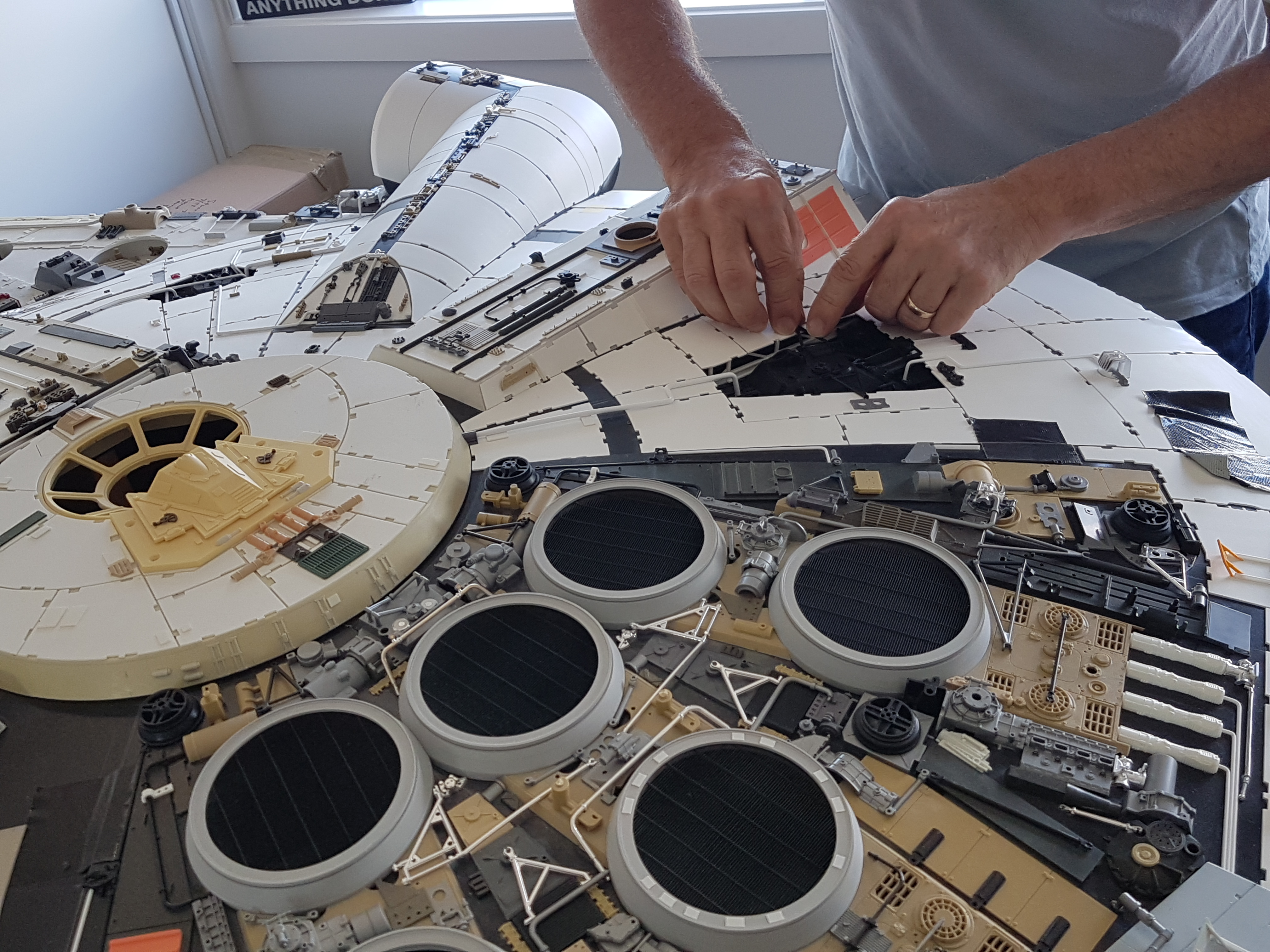

Hi guys. Been a while with updates here, but here's a few pics & details. Had a major health scare which threw me for a while, but getting back into things again.
So I have been working on the docking rings. I mostly finished up the portside docking ring with plating & kit parts, one or two parts to add still, but glad that's done, the plating is fiddly to get right, but then again...everything is!.
Working on the starboard side docking ring vertical wall plating & side plates, adding the damaged areas with the melting & dremeling. Its difficult to match the outer ring plating segment lines to the vertical wall plating, with all the notches matching. The side plates were heat bent as well to better reflect the fit & what ILM did to add damage.

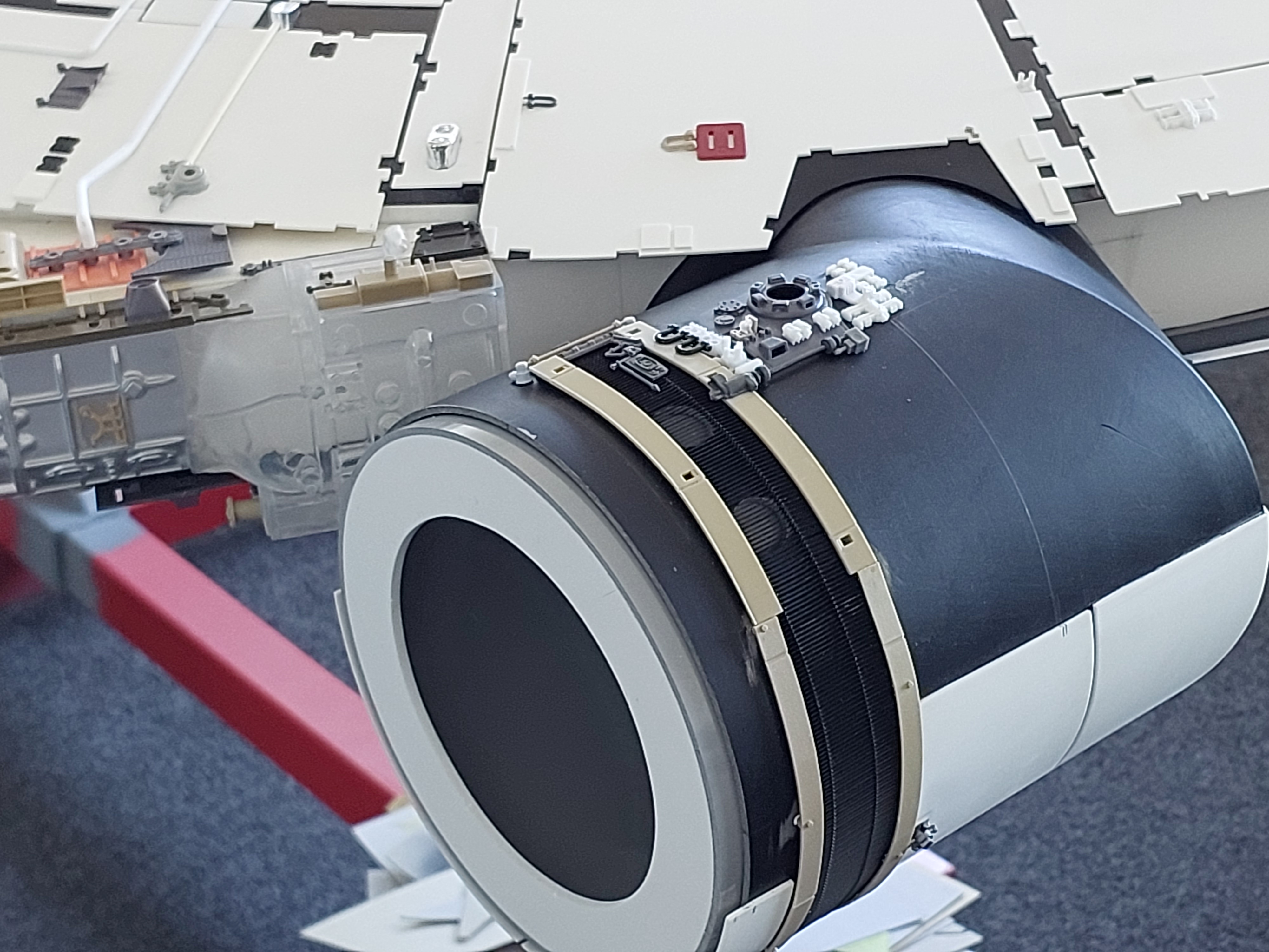

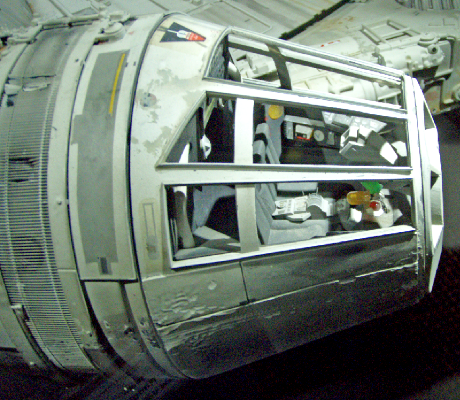

A wee update showing the cockpit outside detailing going on. A few more parts to add & the underside hole damage to do & add the damaged styrene plating, looking forward to that.
The 'Panther' strips are a real challenge to fit & sit to pretty match the ref. Even then with checking & rechecking & dry fitting, when it comes to glueing you only get one shot to put them in place over the coolshade. I spray kicker over the assembly & fit the strips & that's it...no pulling off ever again, as they stay where they were laid. Pretty happy overall, but no replica is going to be 100% to the original.
Hats off to Lee & Sean for doing wonderful work on their cockpits...I now know the pain!.
