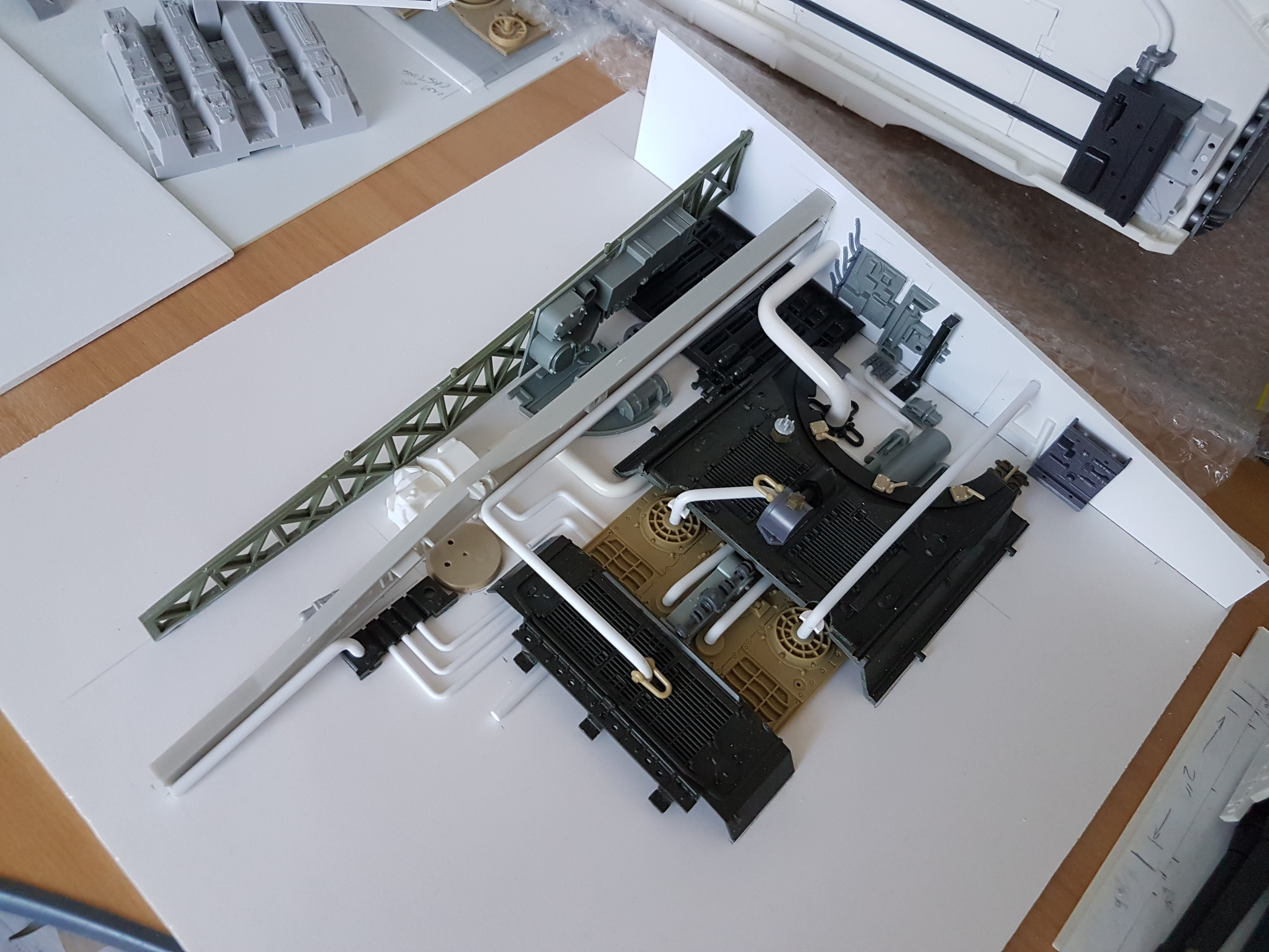

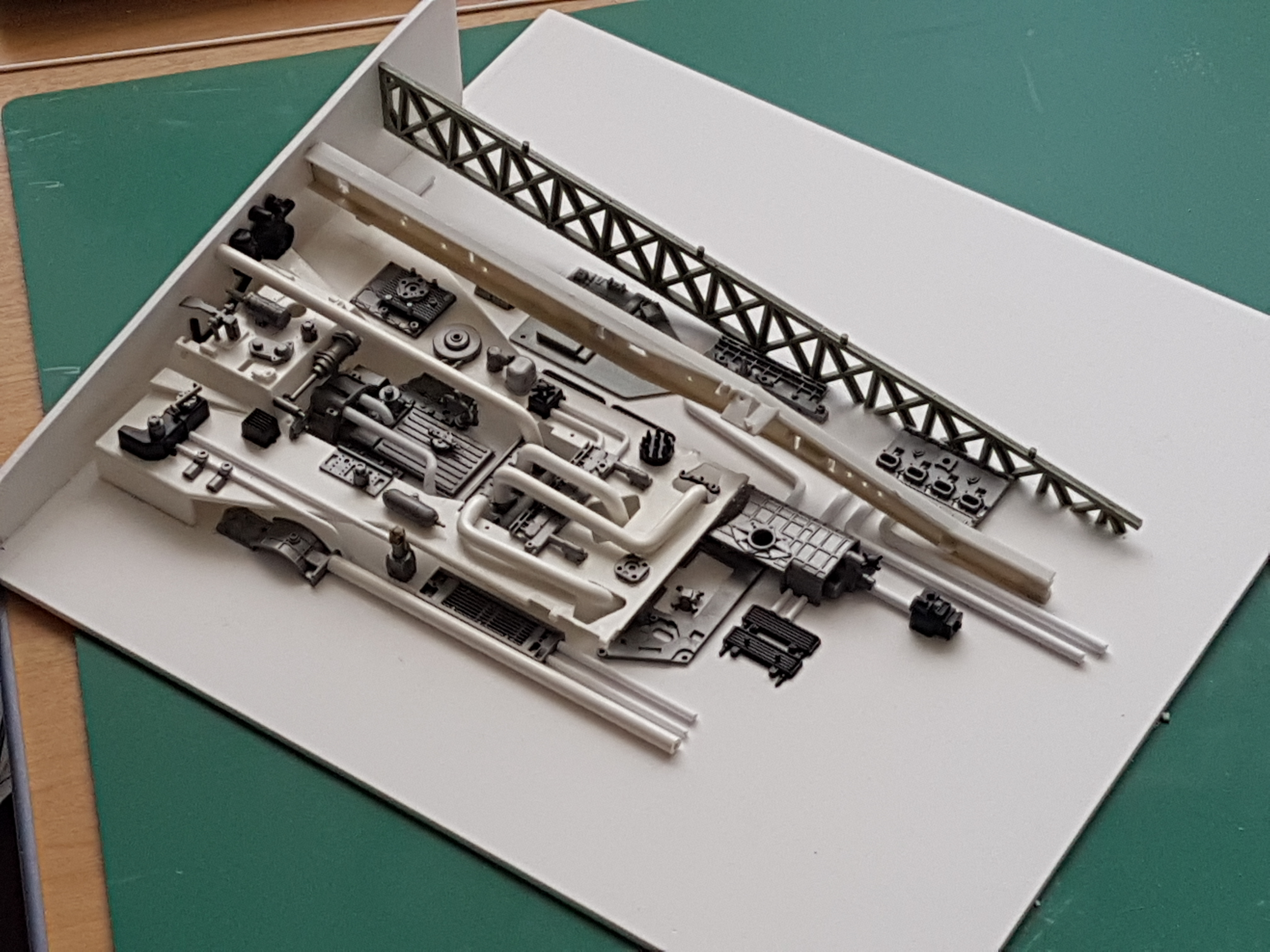

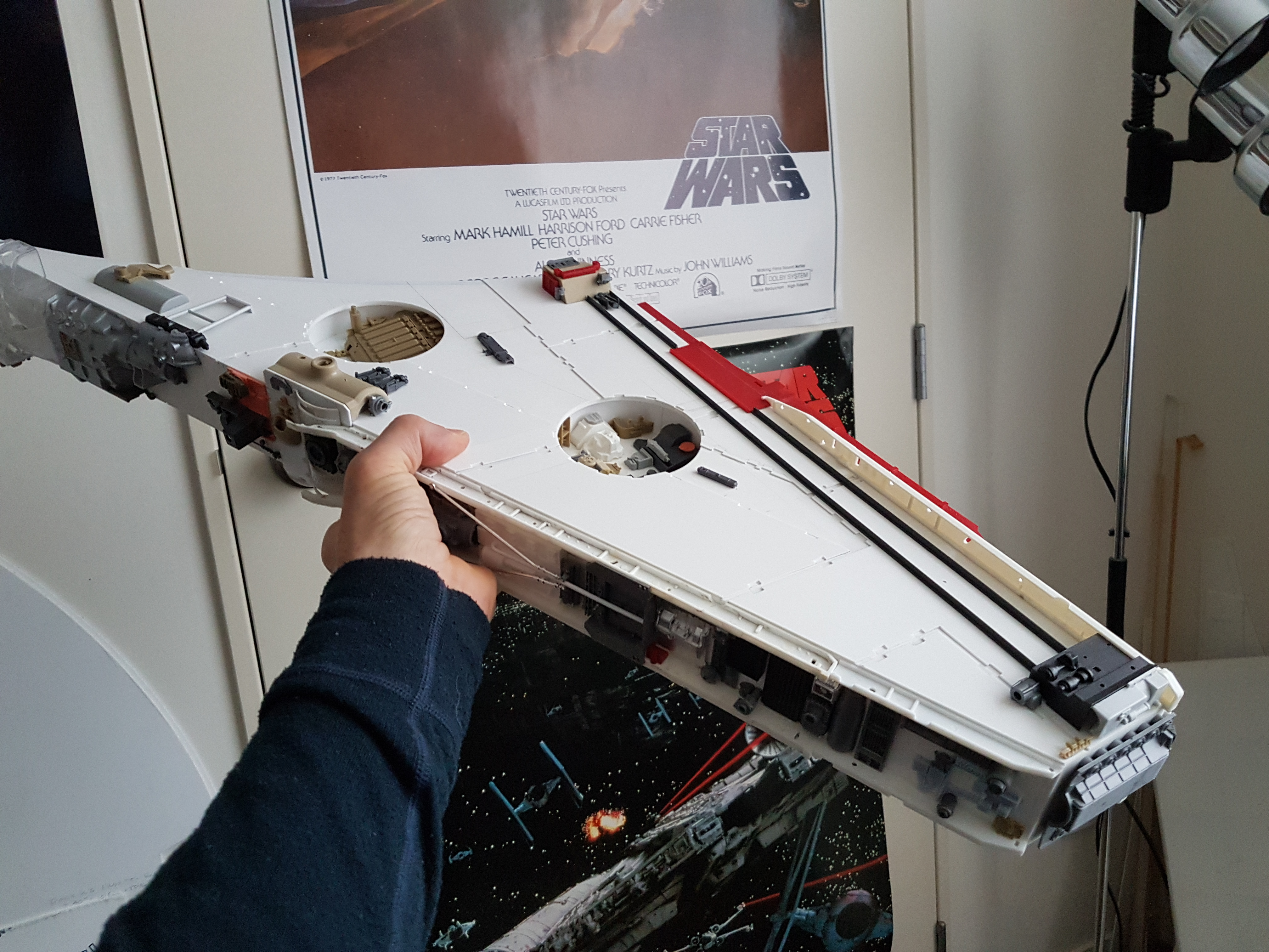

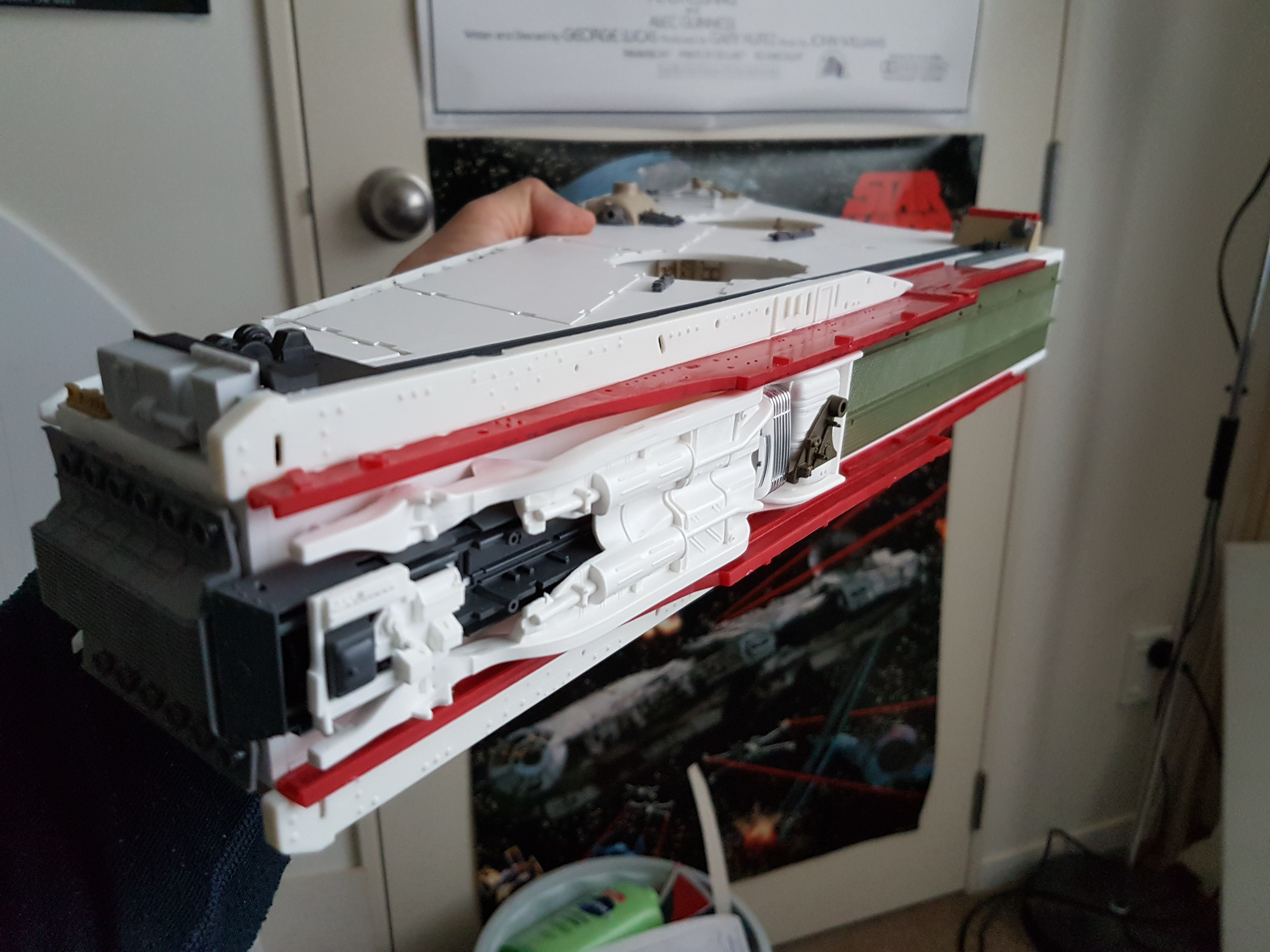

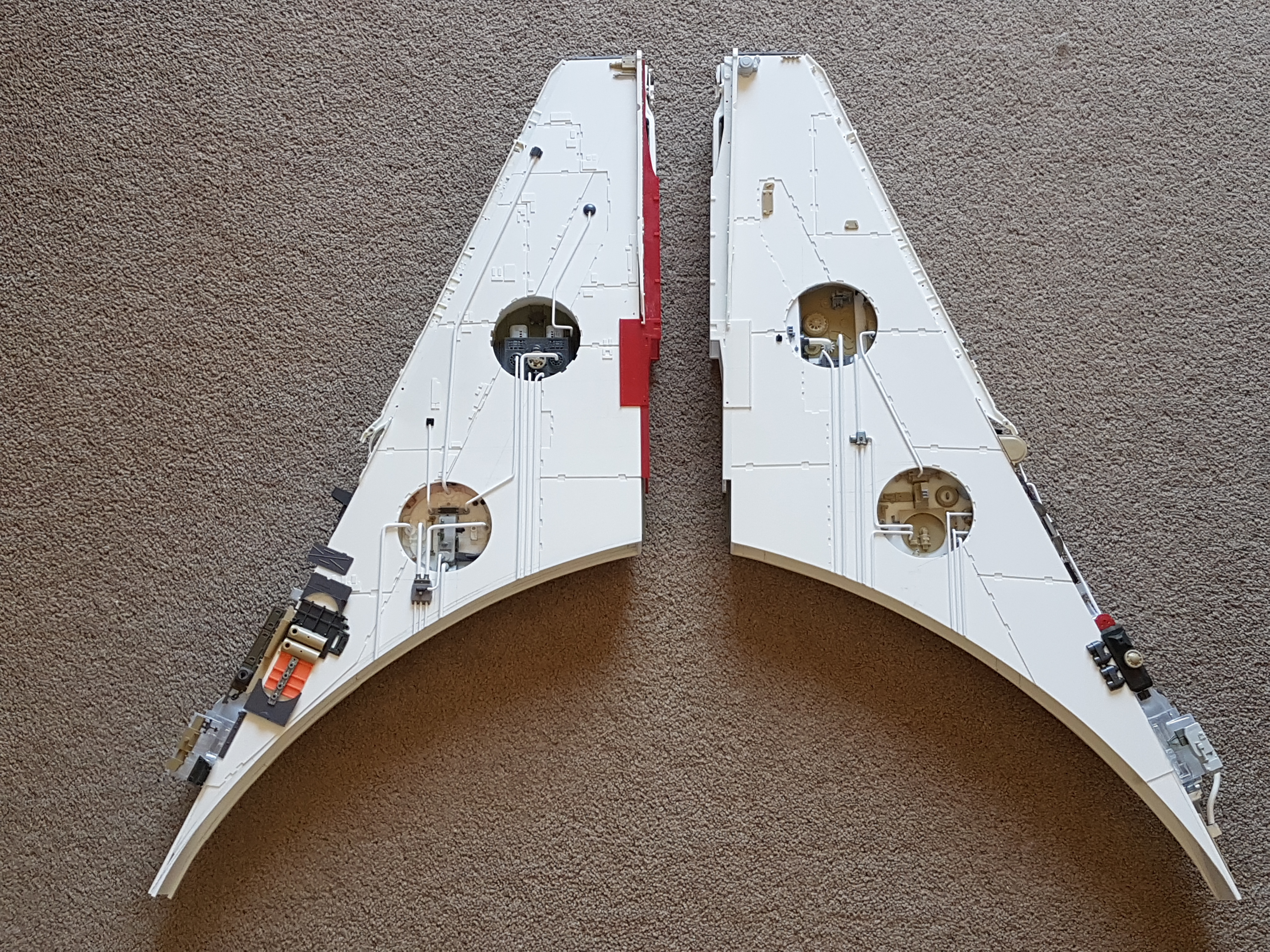

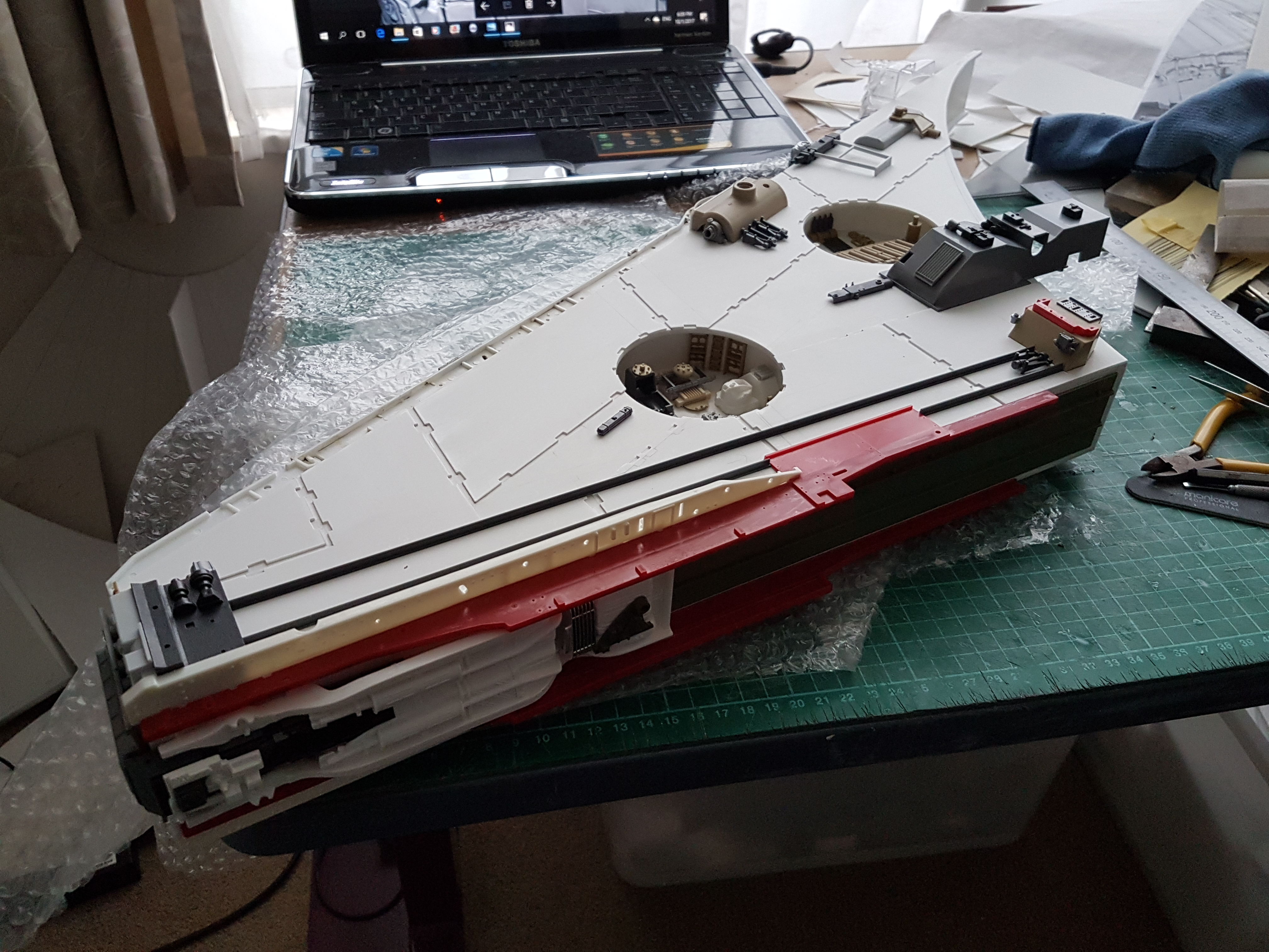

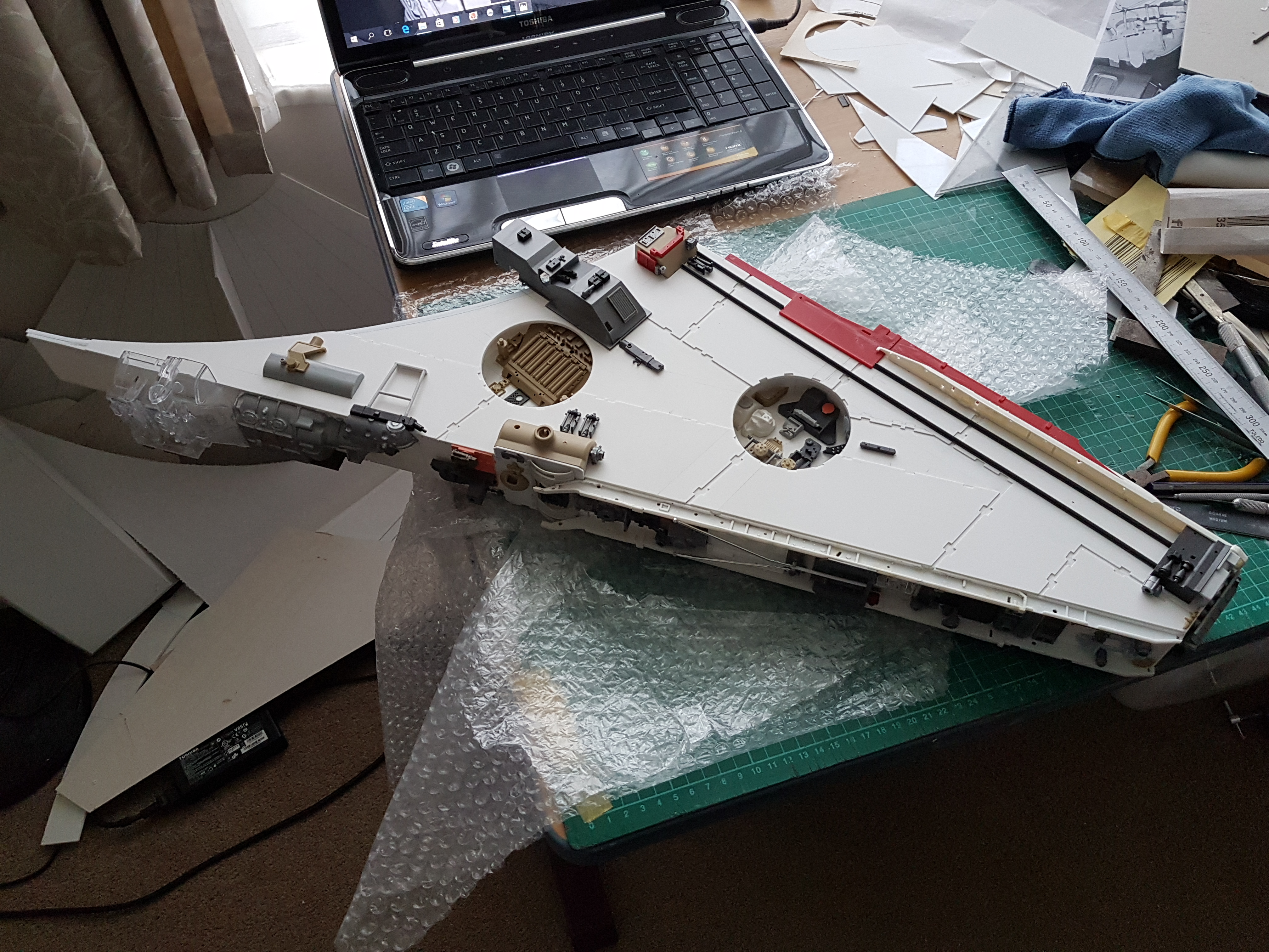

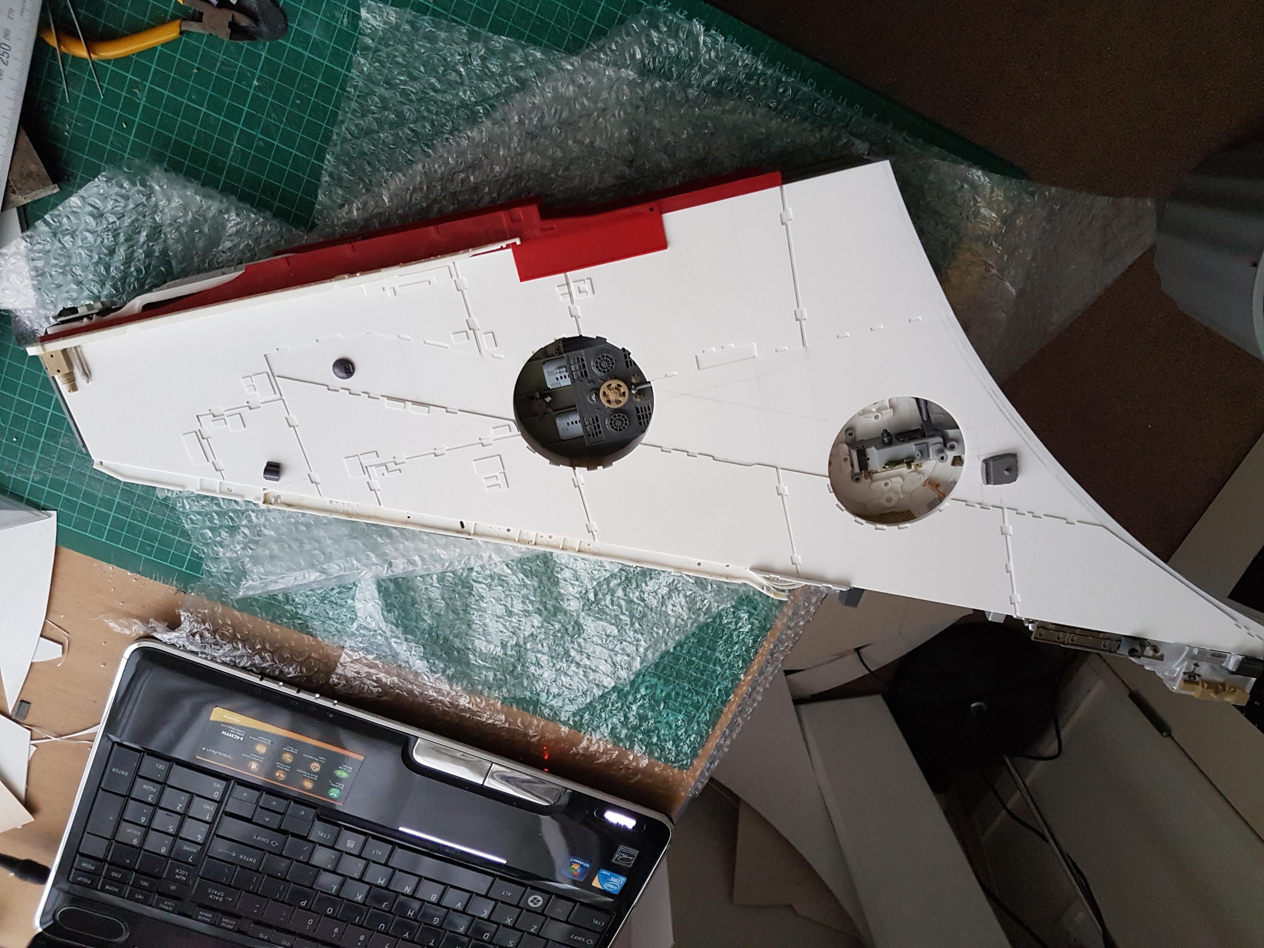

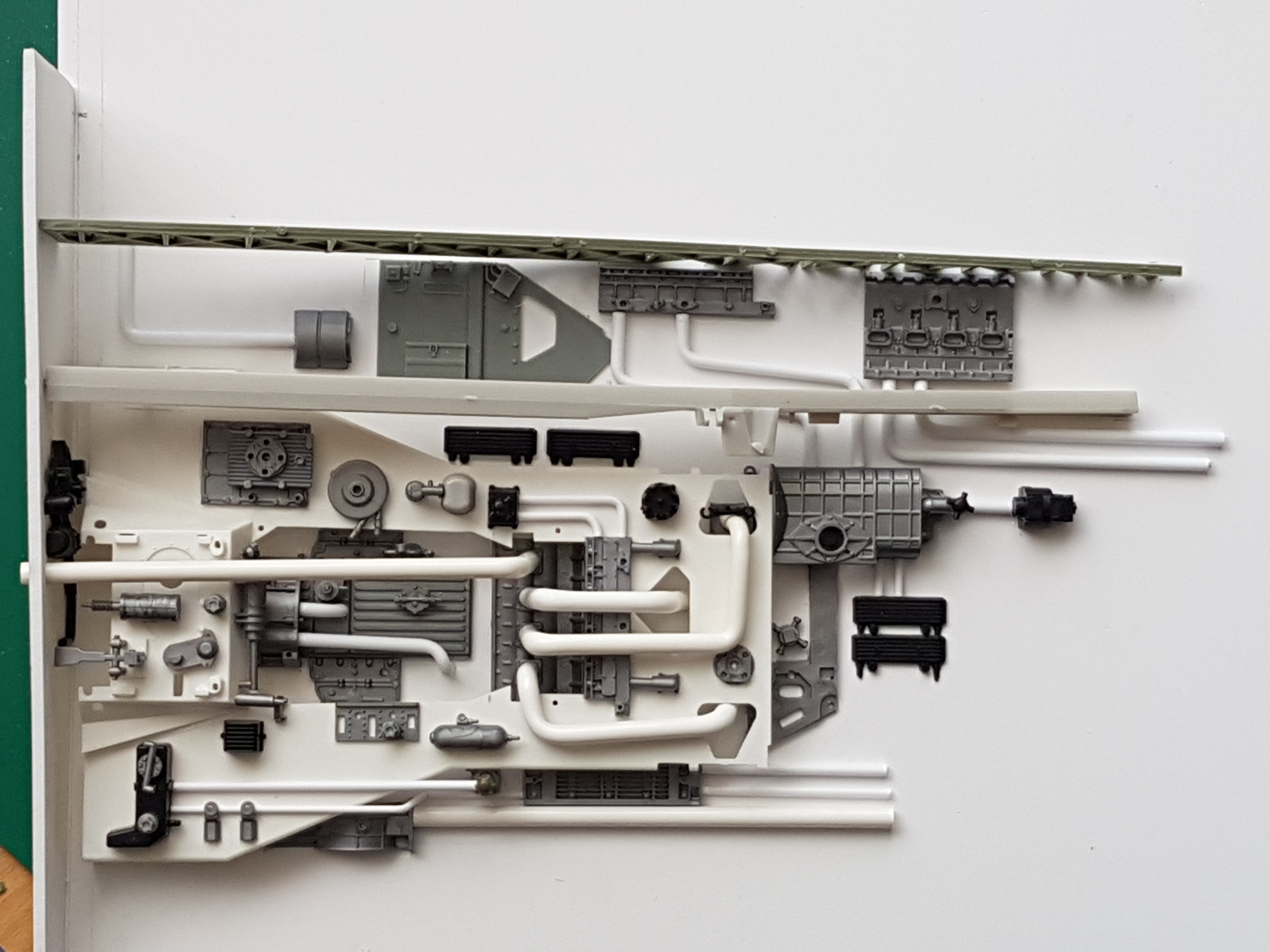

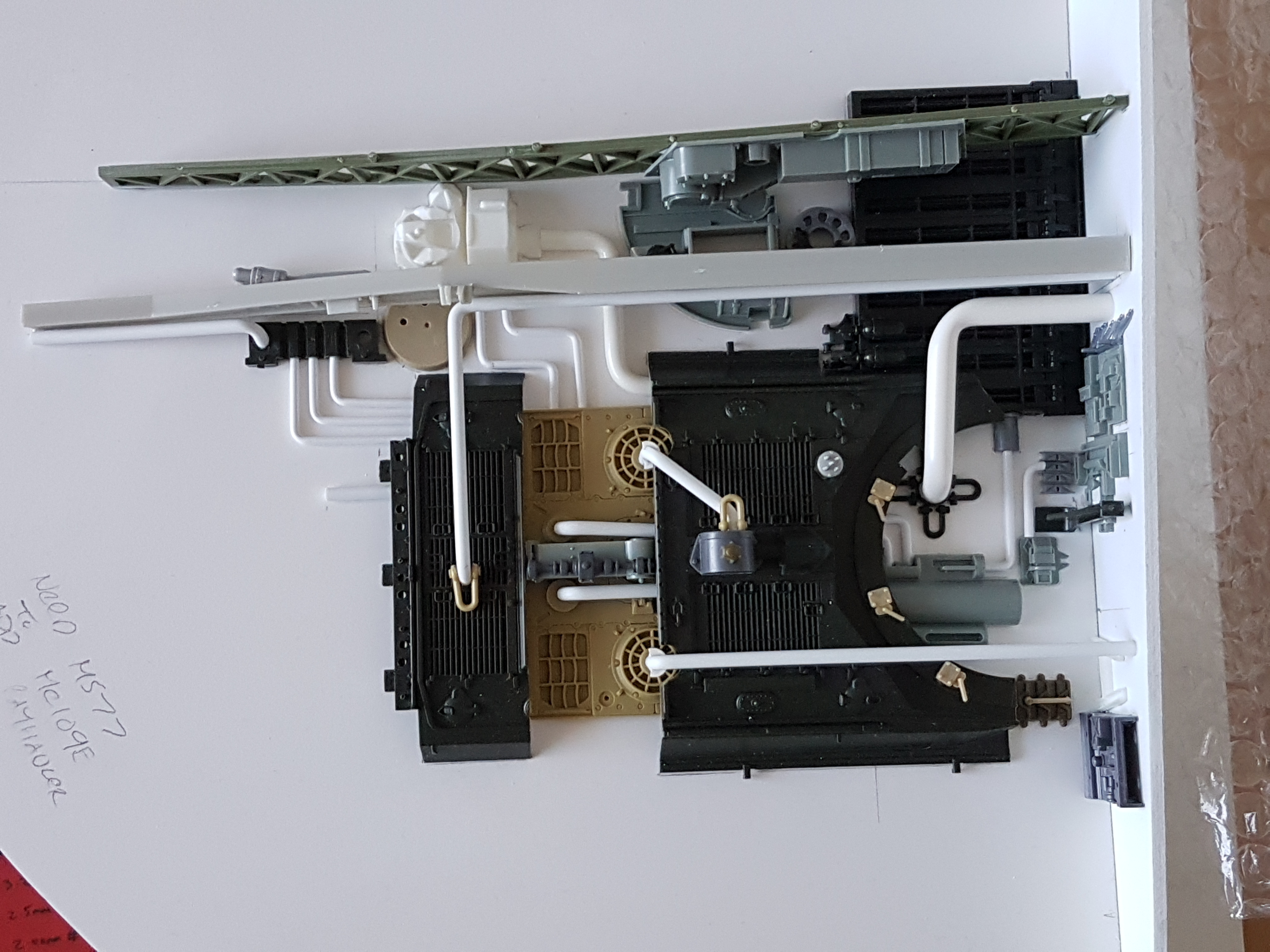

More progress. Starboard side mandible nearing completion. A few donors yet to place in the pit wells & chipping & adding pipework to do. But starting on the port side mandible in the meantime.
This thing is wonky, the actual miniature I mean. To replicate all those intricacies is all part of the building process, but it slows you down somewhat to achieve a good replica.
I will have acrylic beams that slide through the mandibles from the core that will provide alignment & strength. Not sure yet if I will have the mandibles as removable or glue them in place.
Stu

Cheers guys, yes for sure pics will keep on coming. I'll post up some progress of the port mandible in construction as well as the pits over the weekend.
Stu

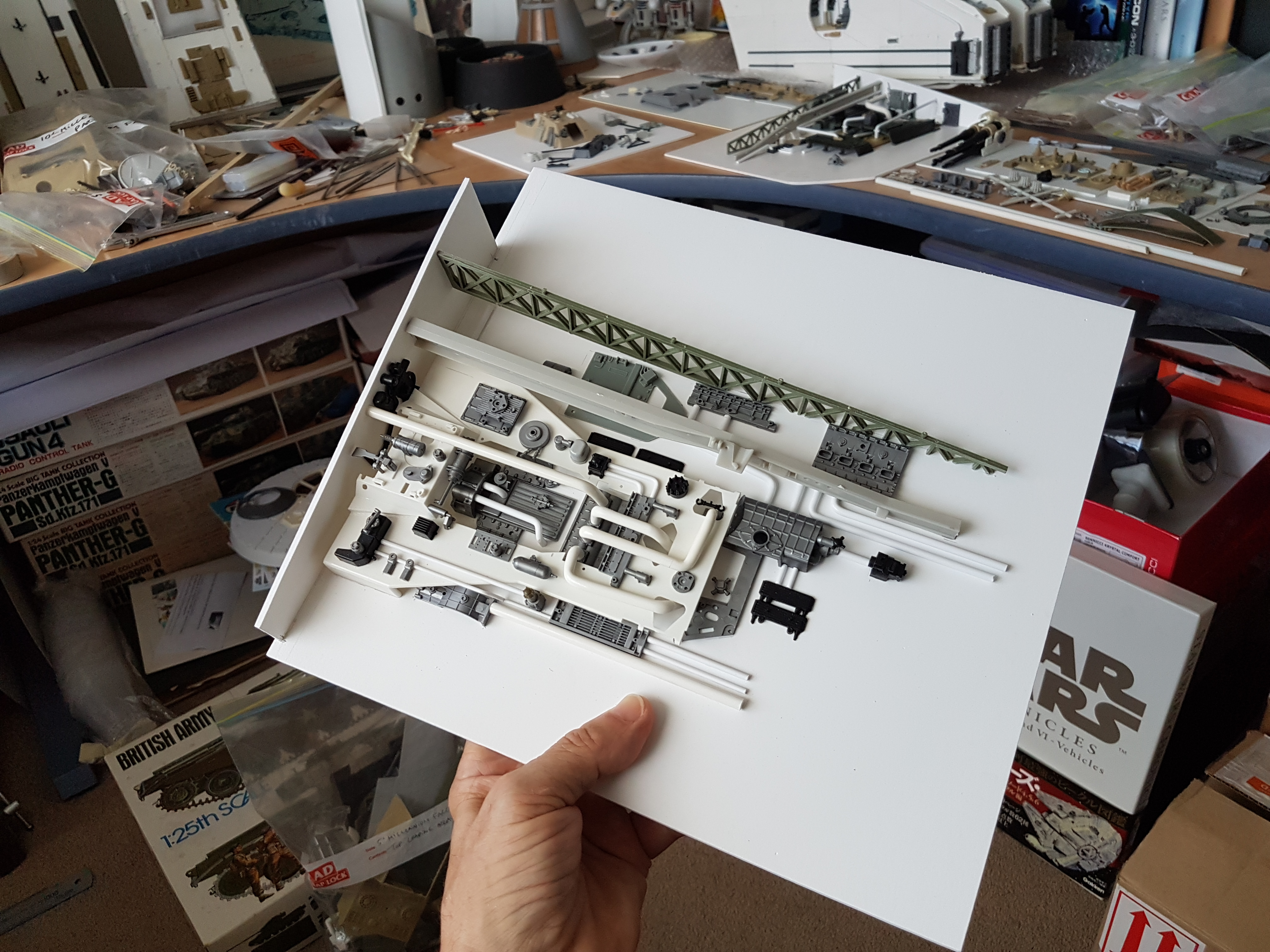

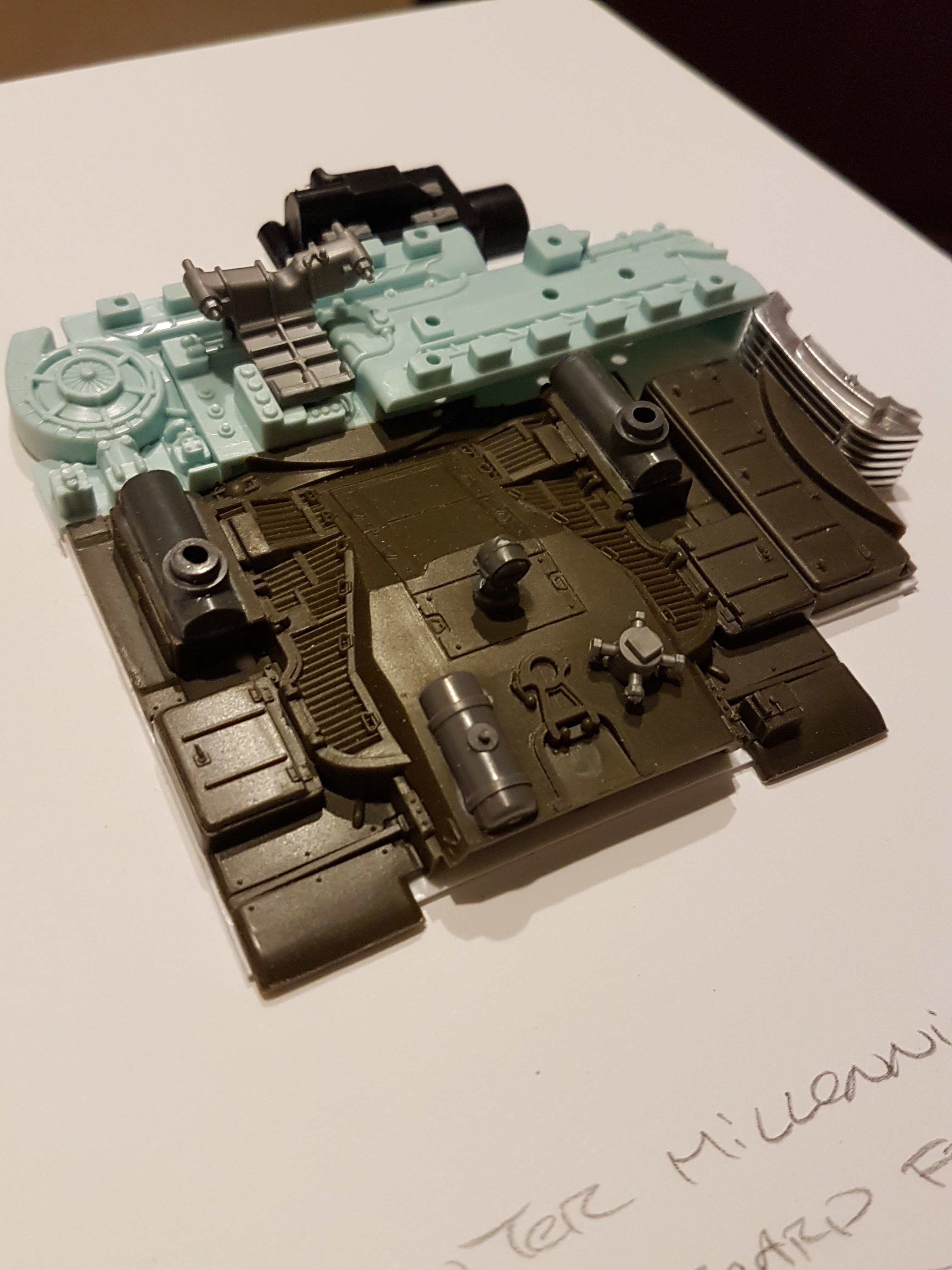

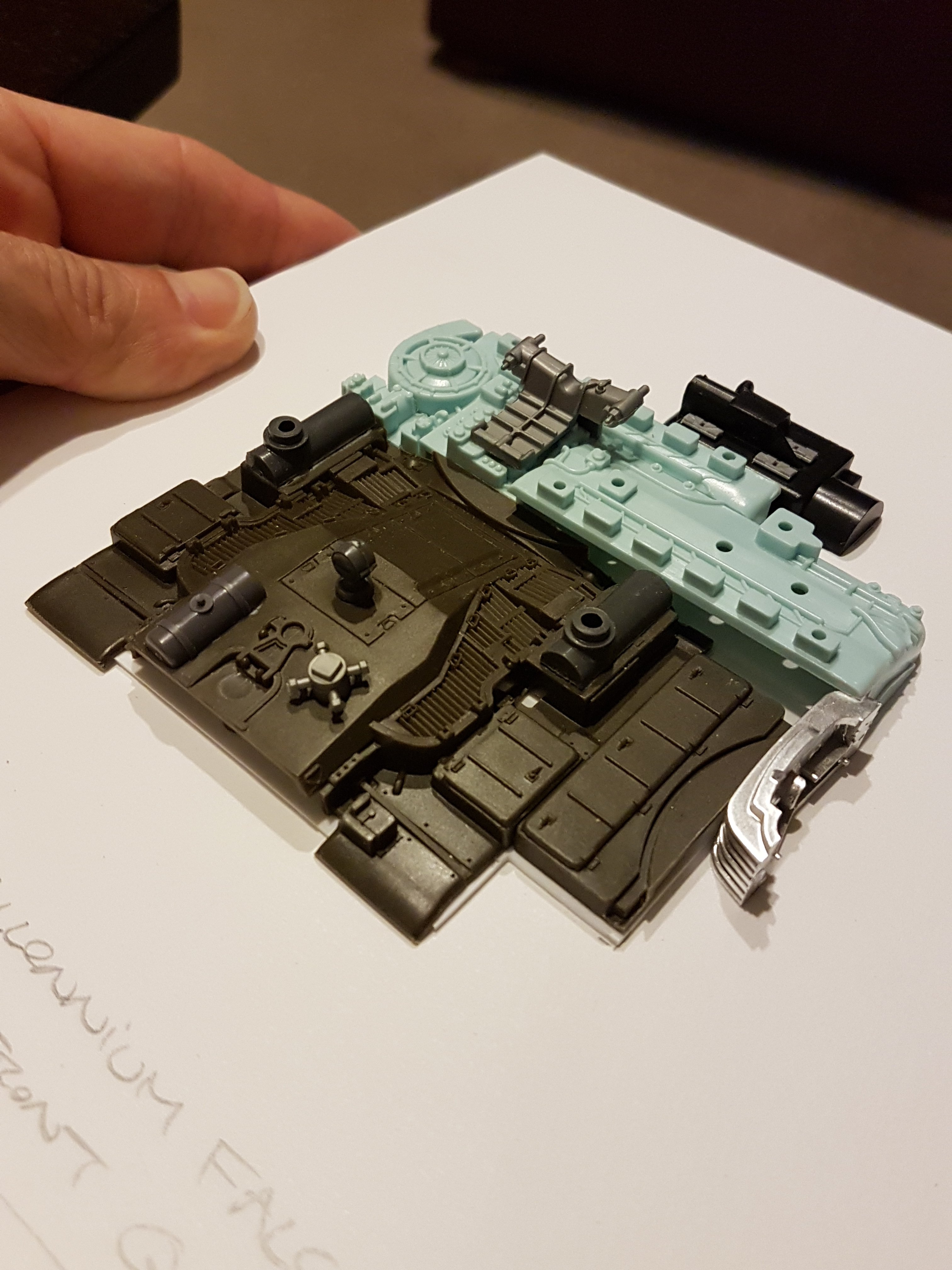

Some more progress. The large underside pits worked on. The McLaren pit has a only a few parts to add & the Tiger ll/Chieftain pit a number of parts to add & a few more pipes.
Mandibles still require the relief chipping & still a few more parts to add in various pits. Kits acquired as I go along, which seems a never ending cycle haha.
Masters for the sidewalls & jawbox plates are nearing completion & casts will be done, as per ILM.

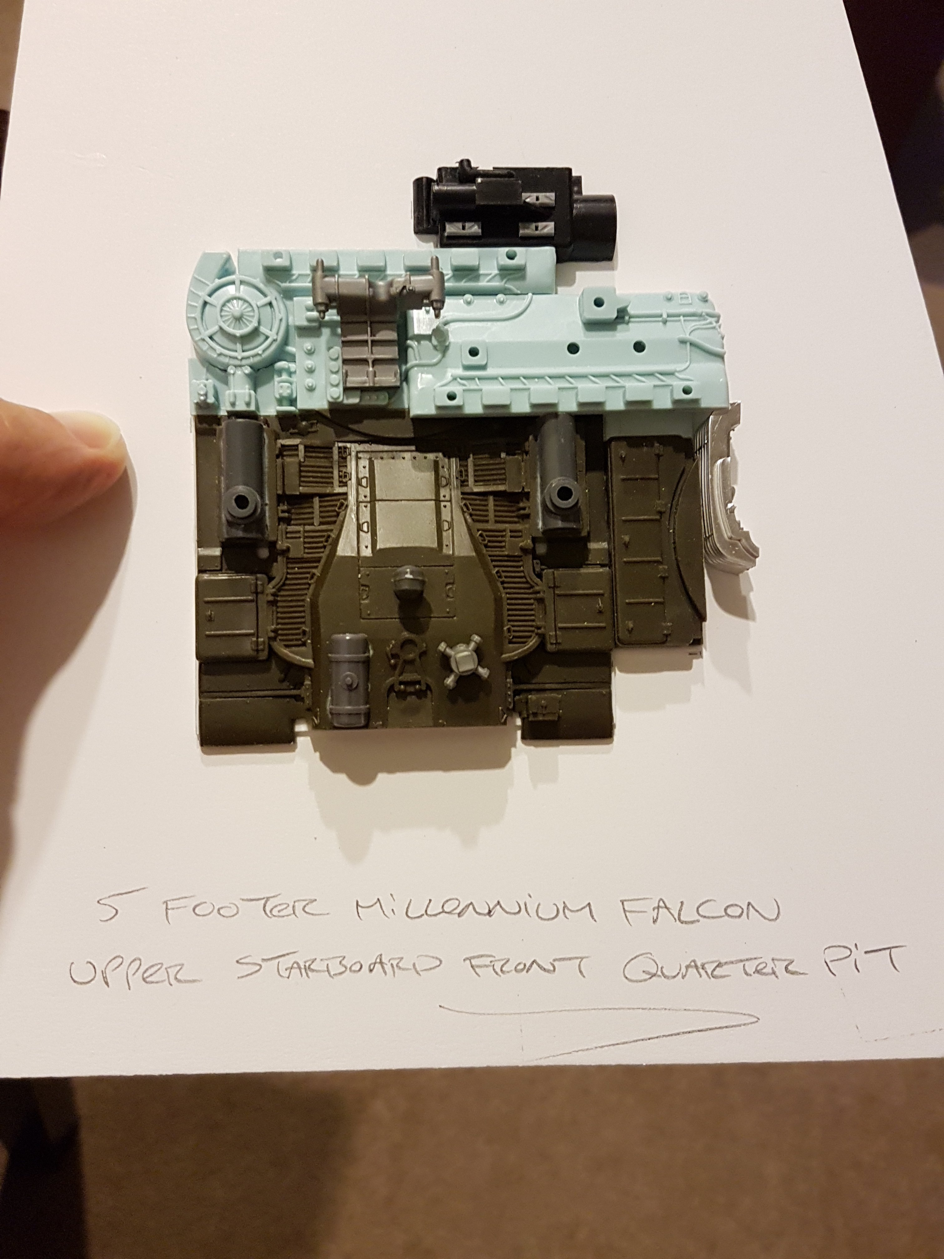

The mandible pits are interesting in themselves. No two seem to be alike in diameter to make the donor parts fit correctly. So each one has to be carefully placed out, sometimes two or three times to get things sitting right.
Is the depth of the mandible pits all different too?
Yes. When building the pits I had to keep two things in mind...depth & width. Certain kit parts gave the depth indicator as to a particular pits depth. Of course this determines the pit that sits immediately underneath as well, but when you have one depth sorted the other kind of falls into place & can be doubled checked to make sure there is enough clearance for both in the internal mandible space. It's tight in there for sure & the odd kit part was trimmed, say a landing gear, to fit the pit sidewall. I built my pits separately & fixed in place later, keeping in mind the correct orientation. ILM would have detailed the pits out in situ, but seemed easier for me to do separately & work out diameters & depths.
Stu
