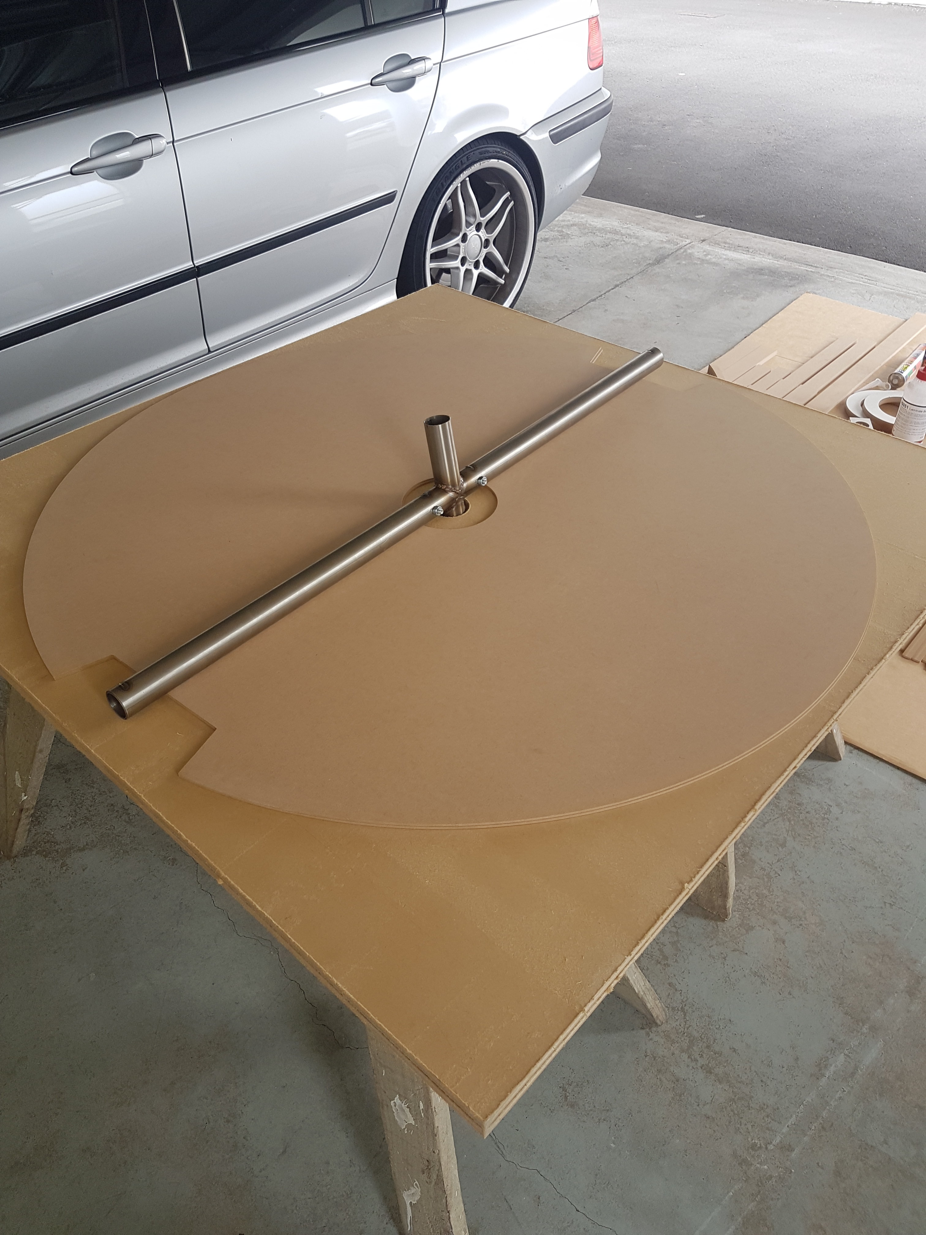

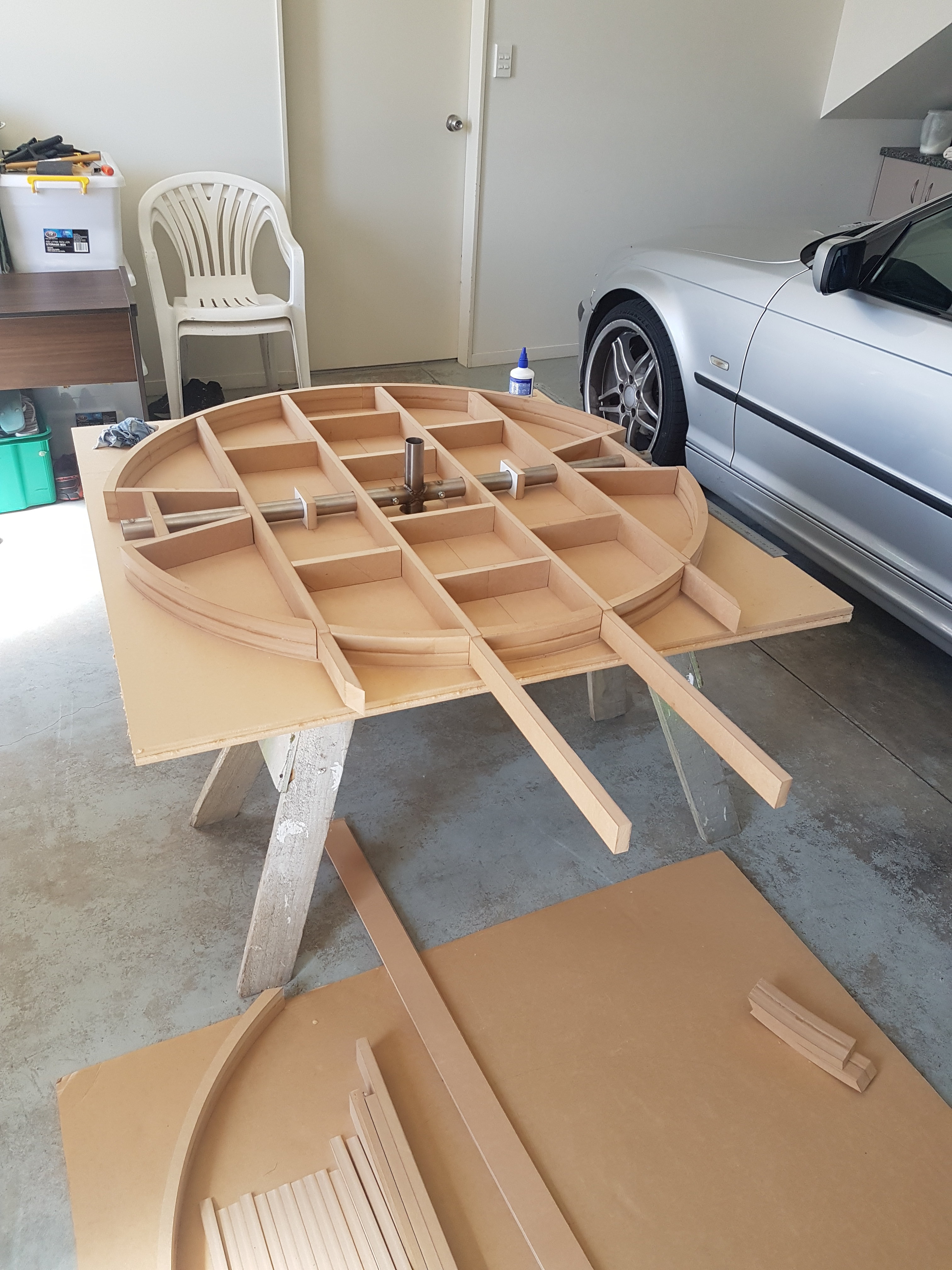

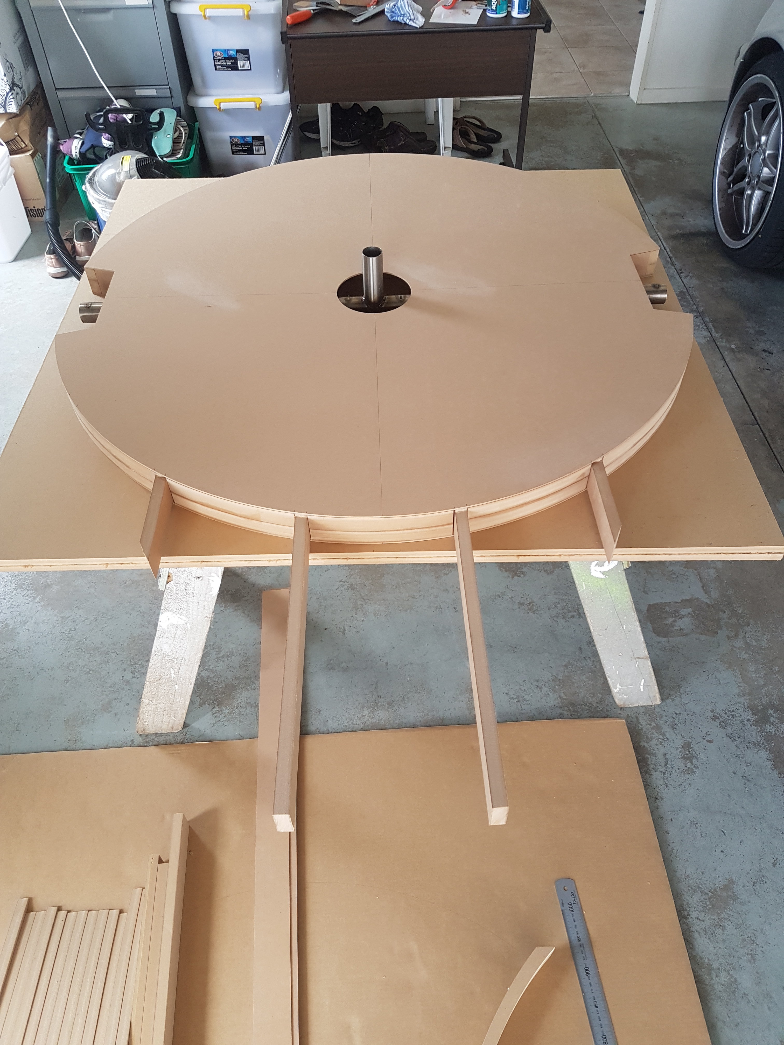

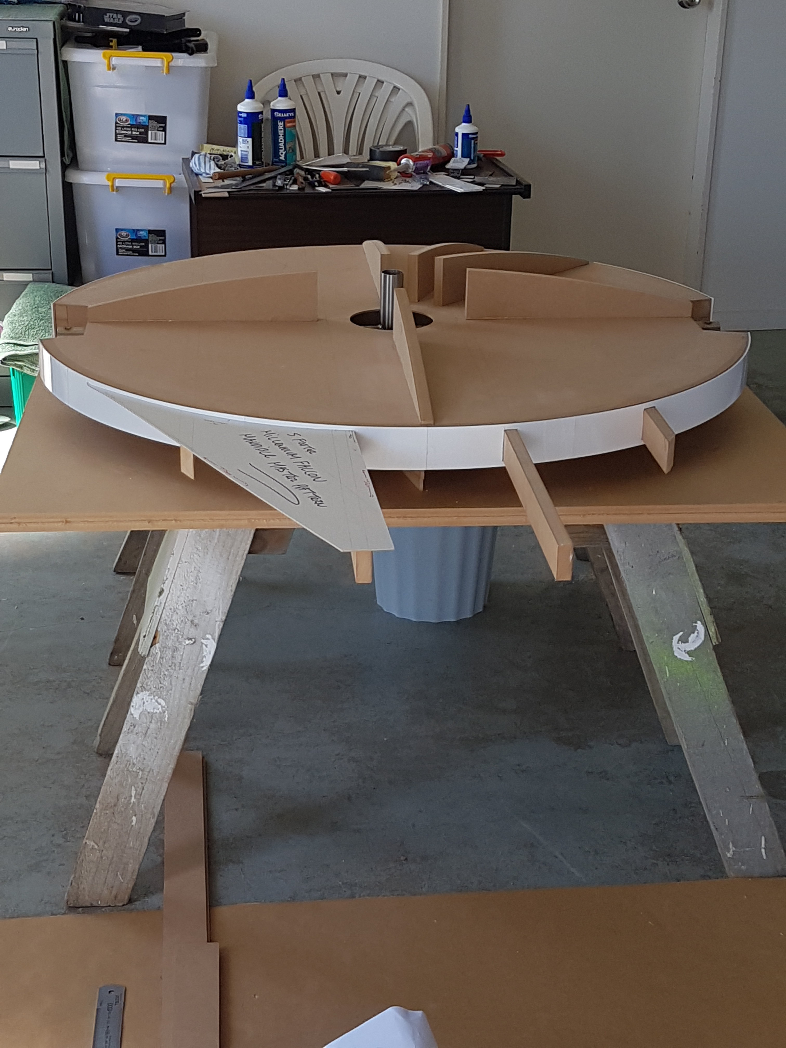

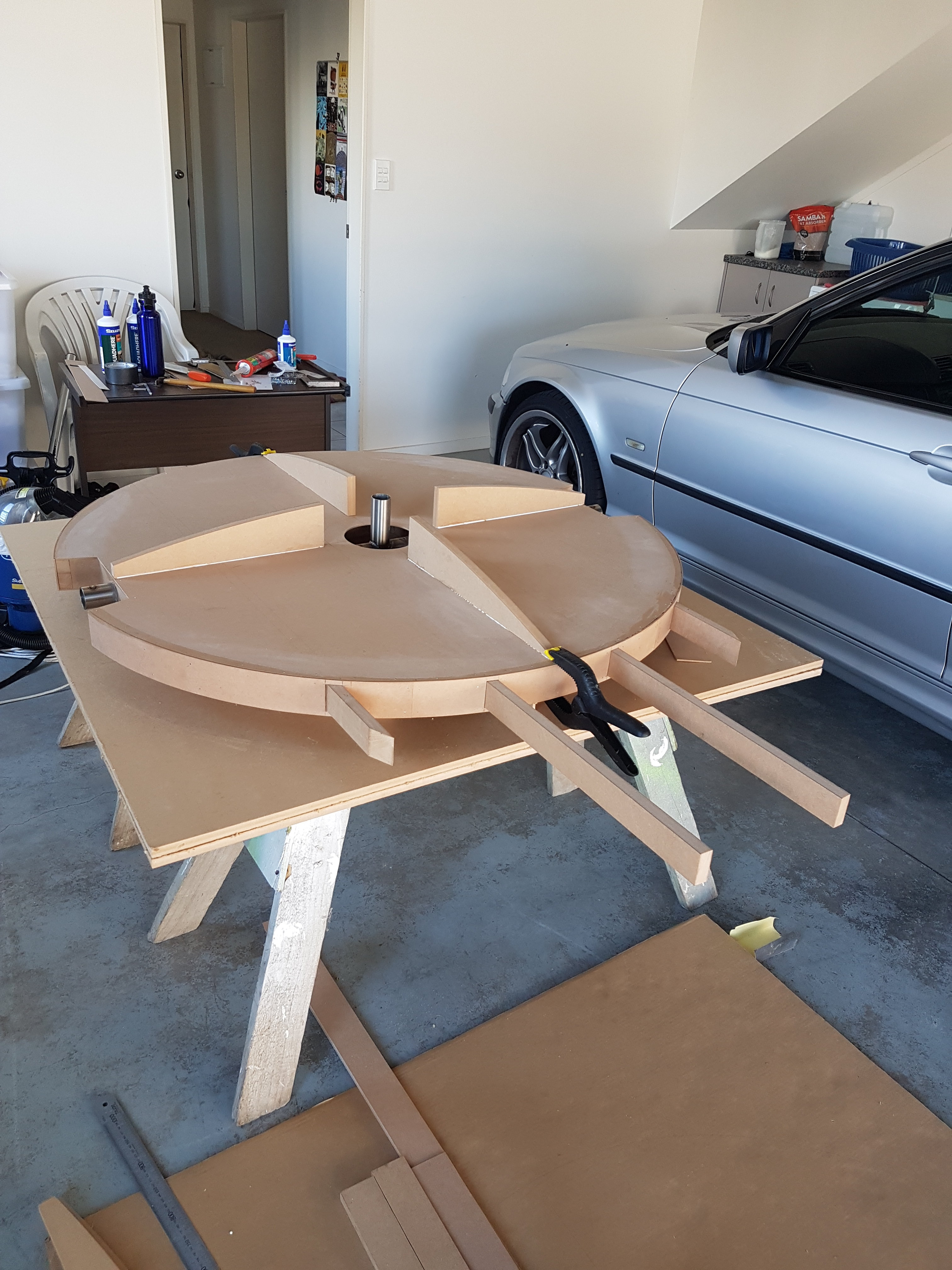

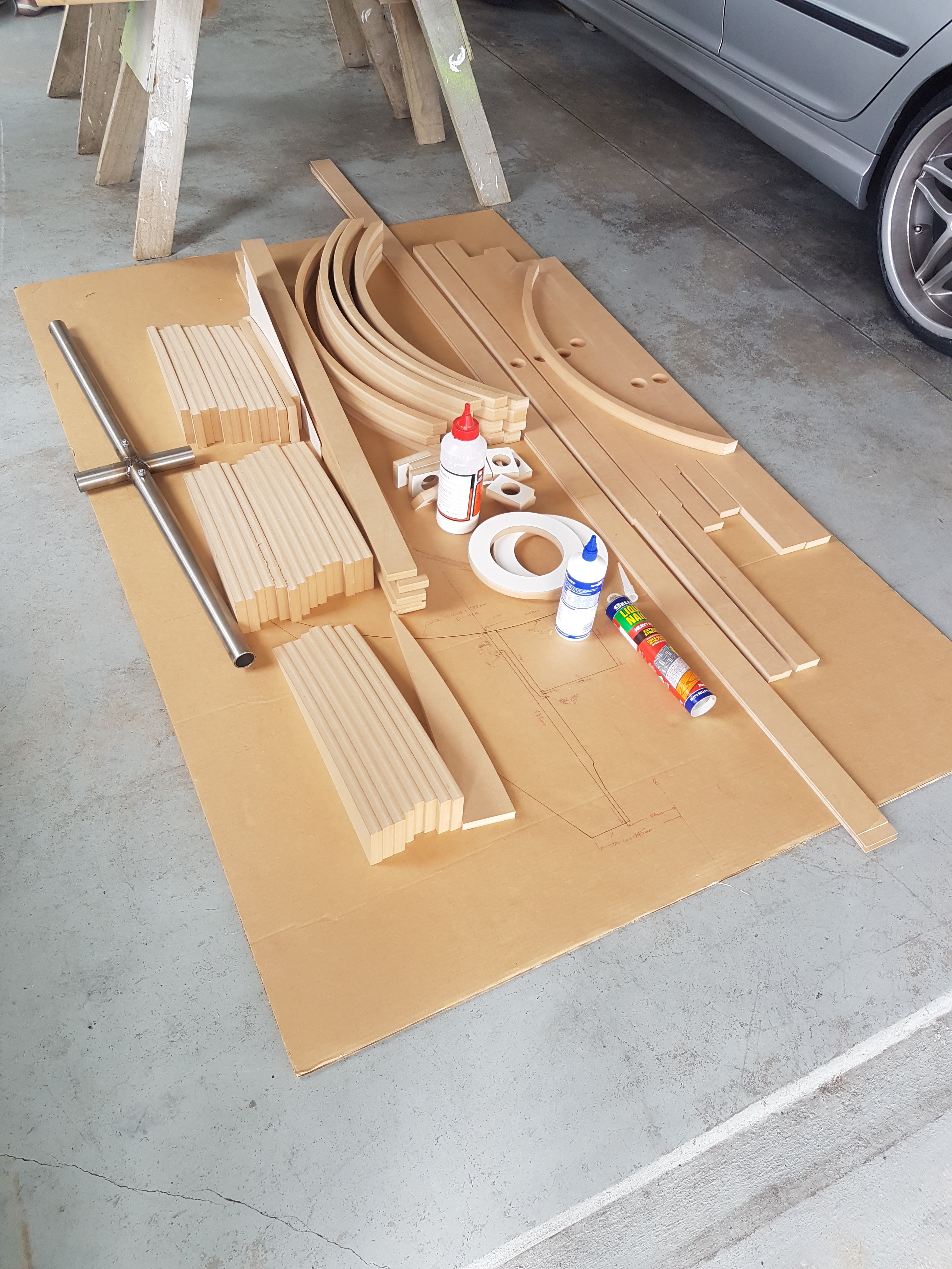

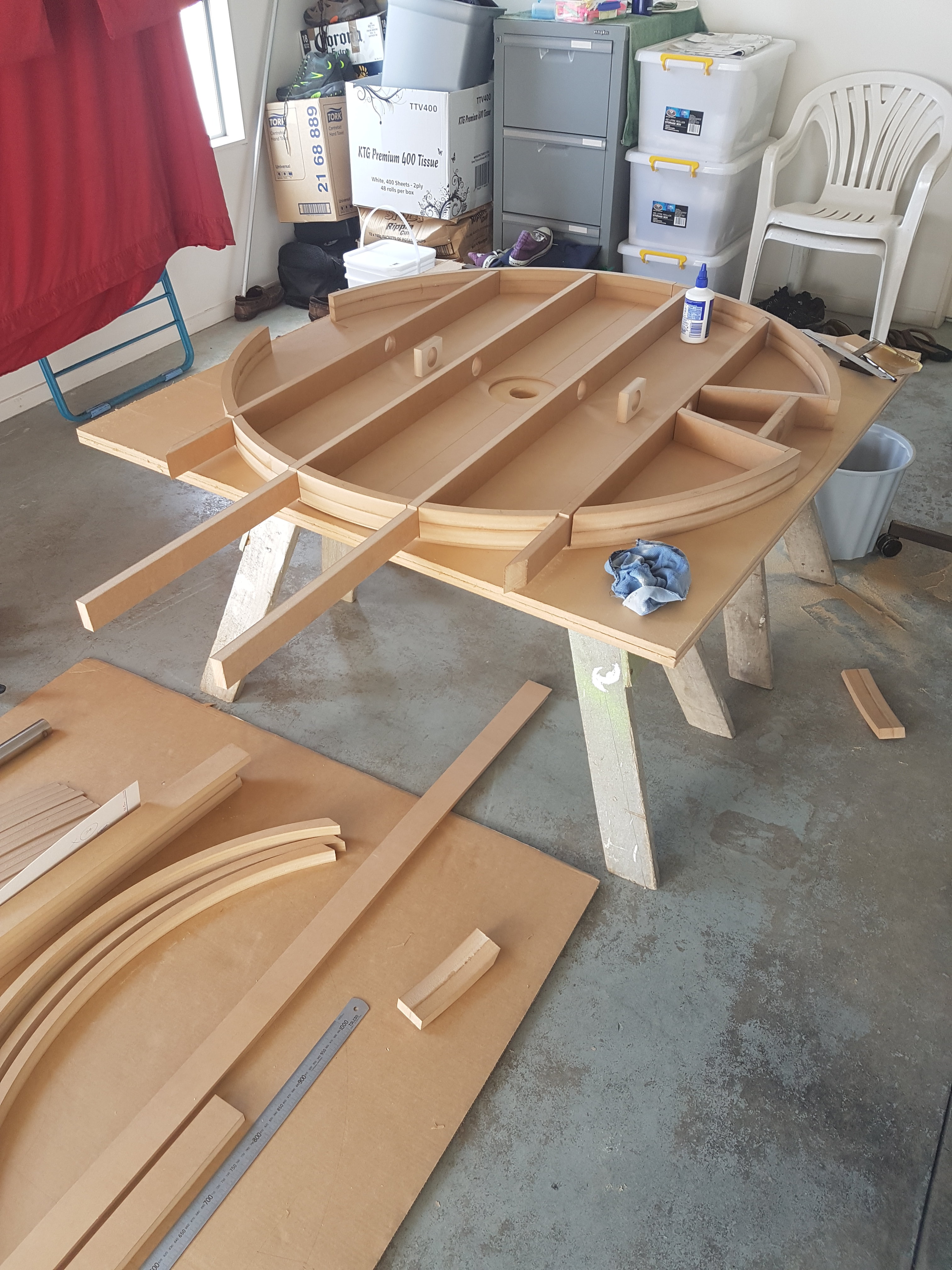

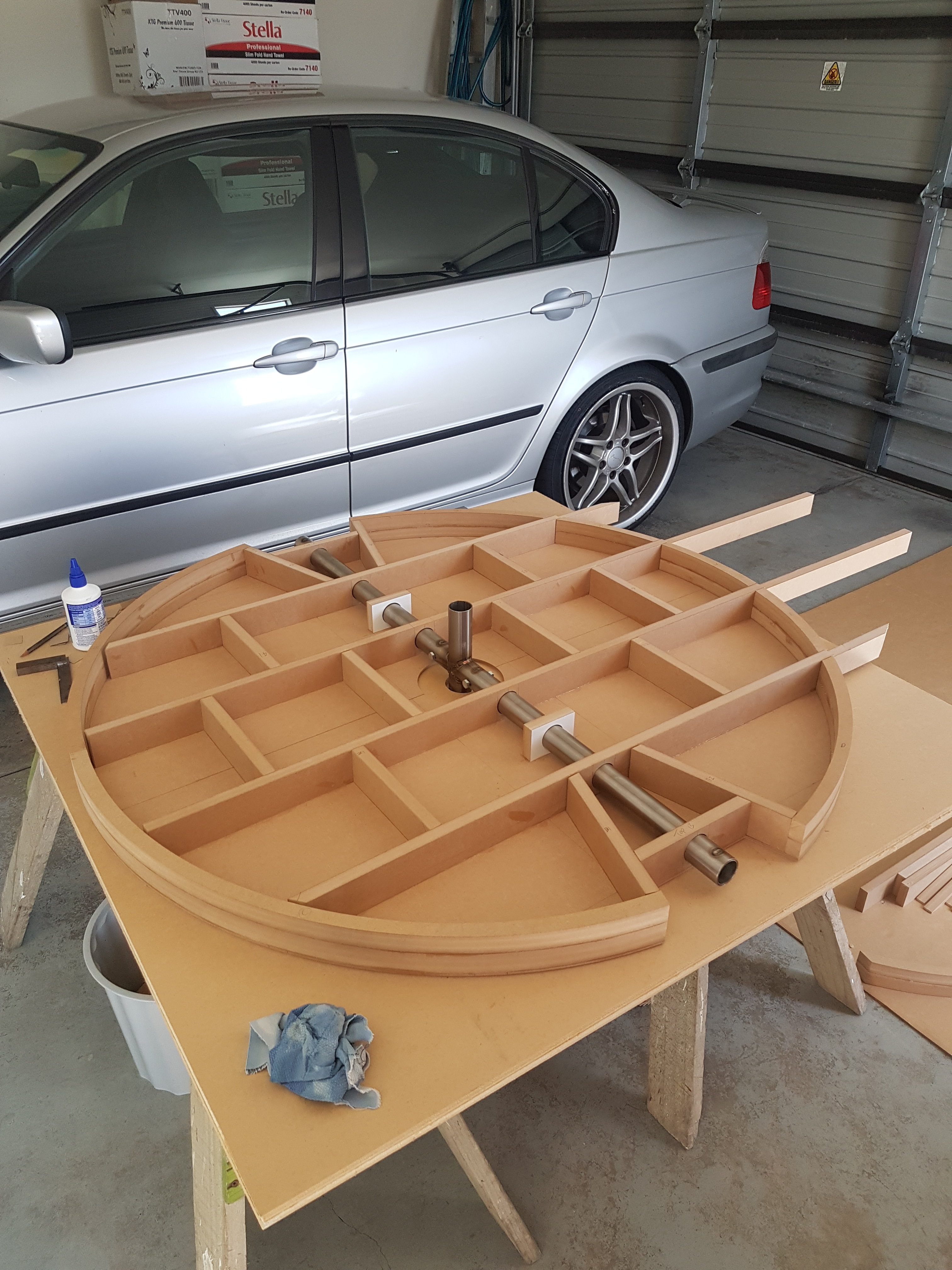

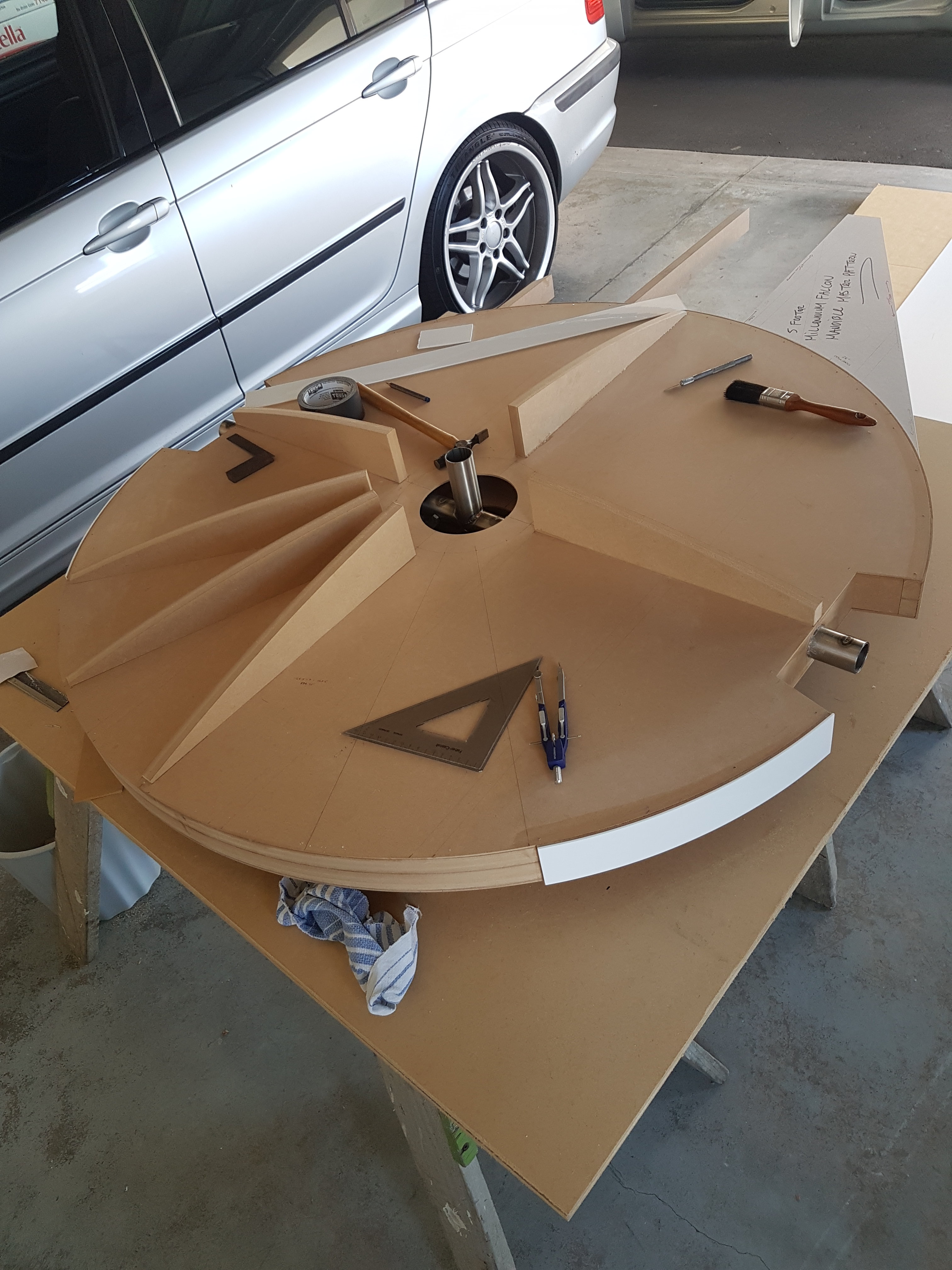

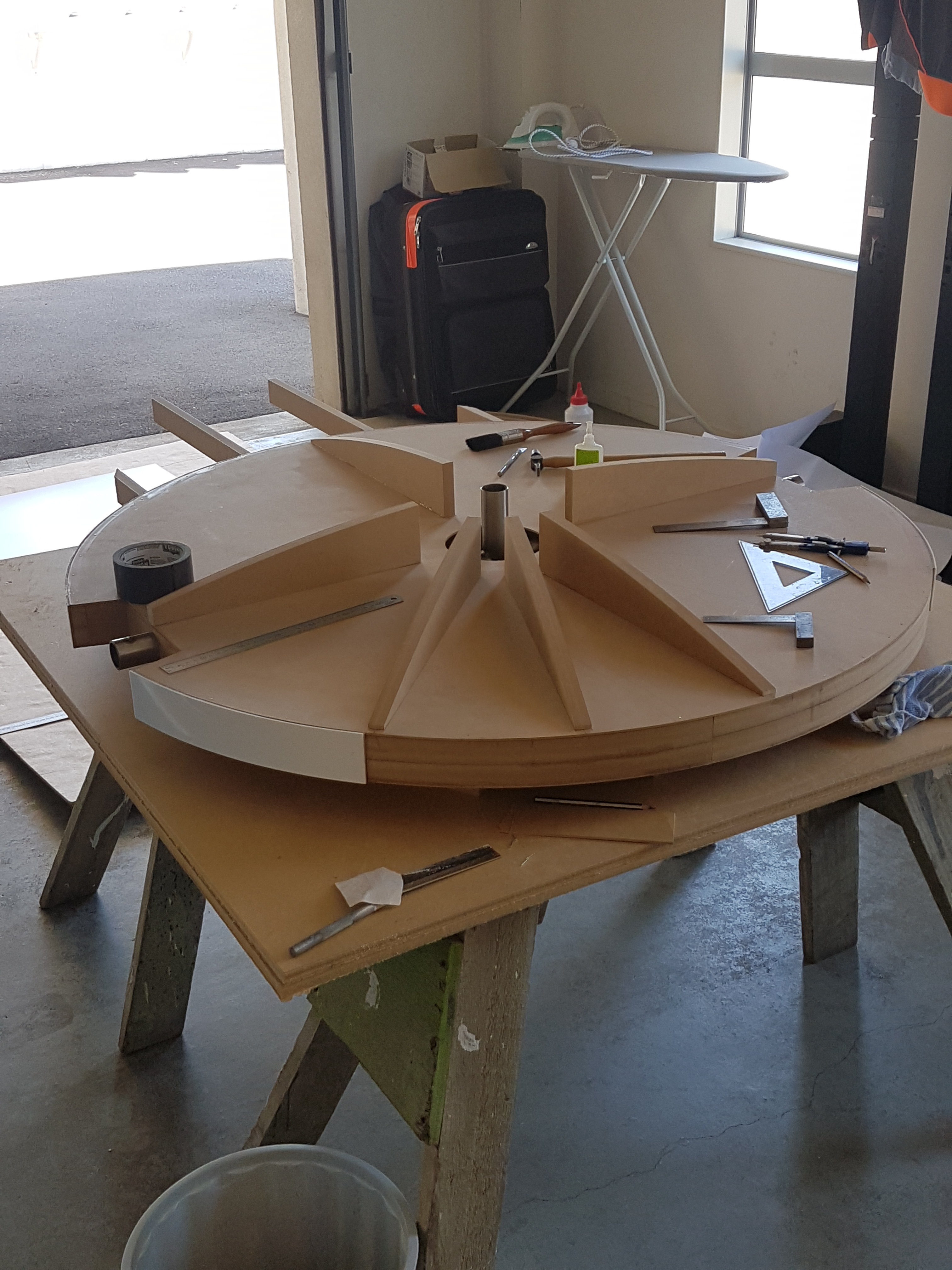

Here is my 'kit' I designed for my hull or 'core' & delivered just before Christmas. All parts are CNC'd from MDF & also had an armature welded up. So over the holiday break I began assembly & am pretty darn happy how it all fits & is taking shape. I applied a light coat of PVA to the sidewalls to seal the MDF for the styrene to attach to securely with CA. It's really hot here last few weeks, so drying time & bonds are real quick!. Next up this week are fitting the ABS dome sections, I say fitting, but won't secure them down until pit positions are finalized & positioned.

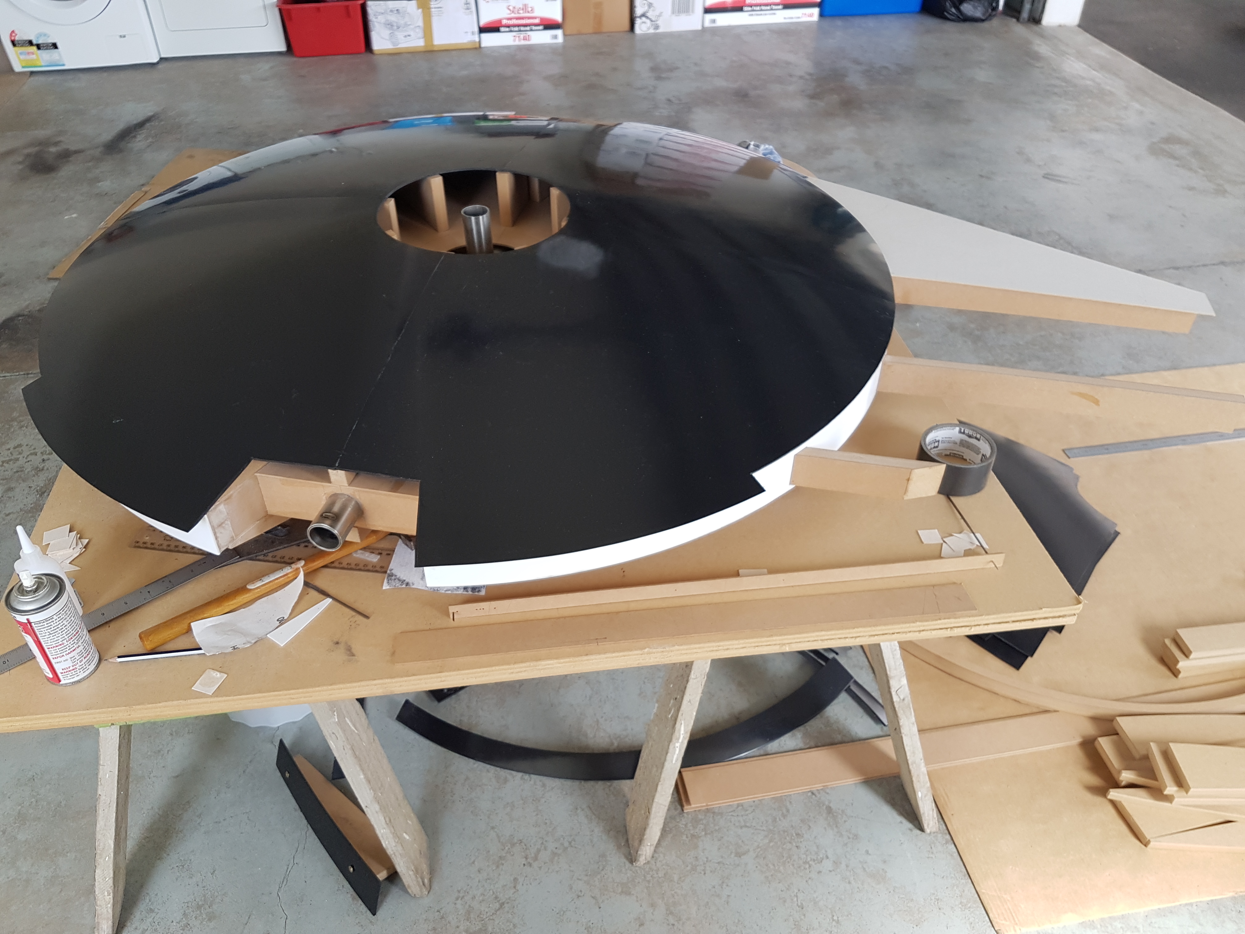

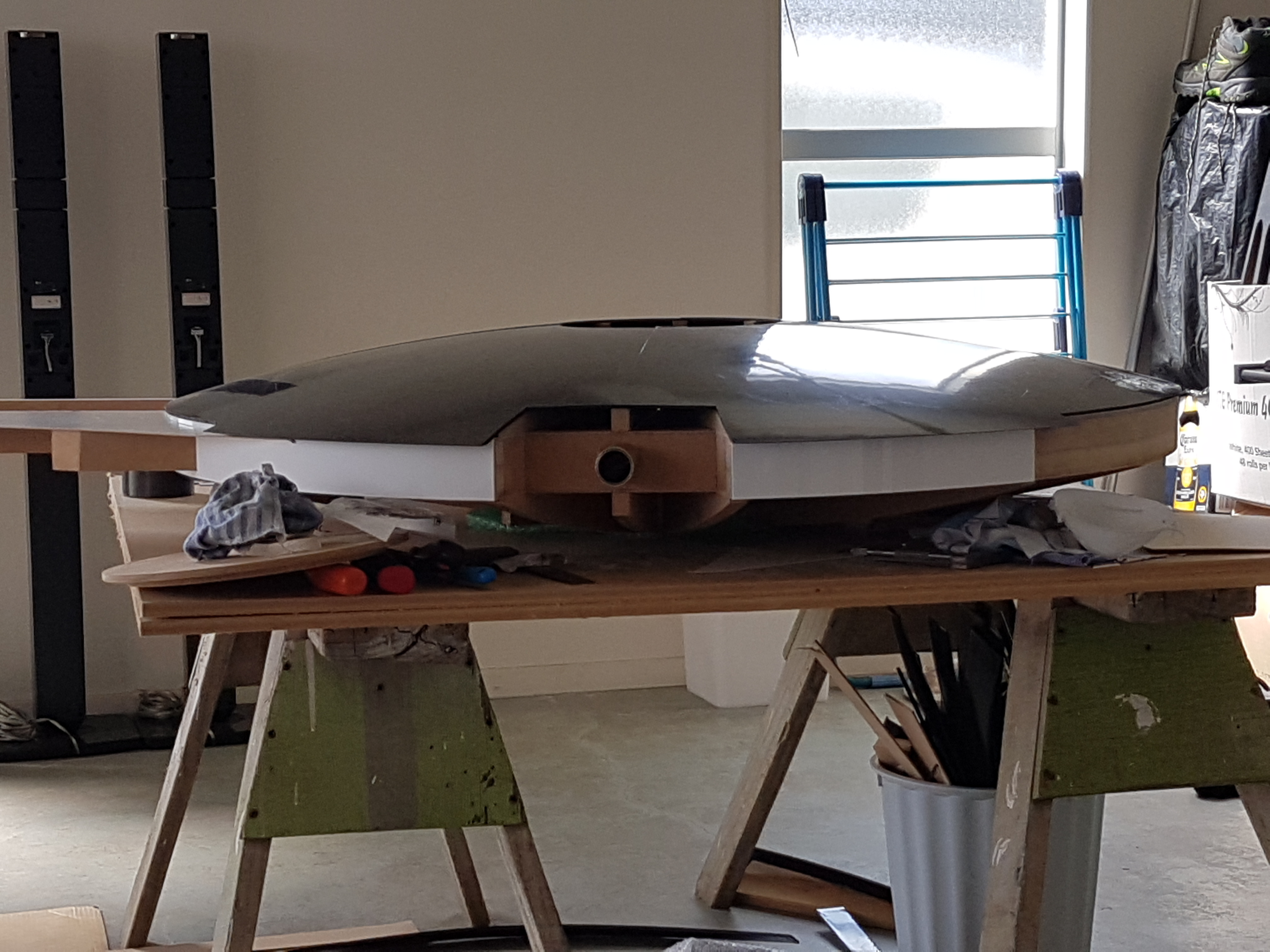

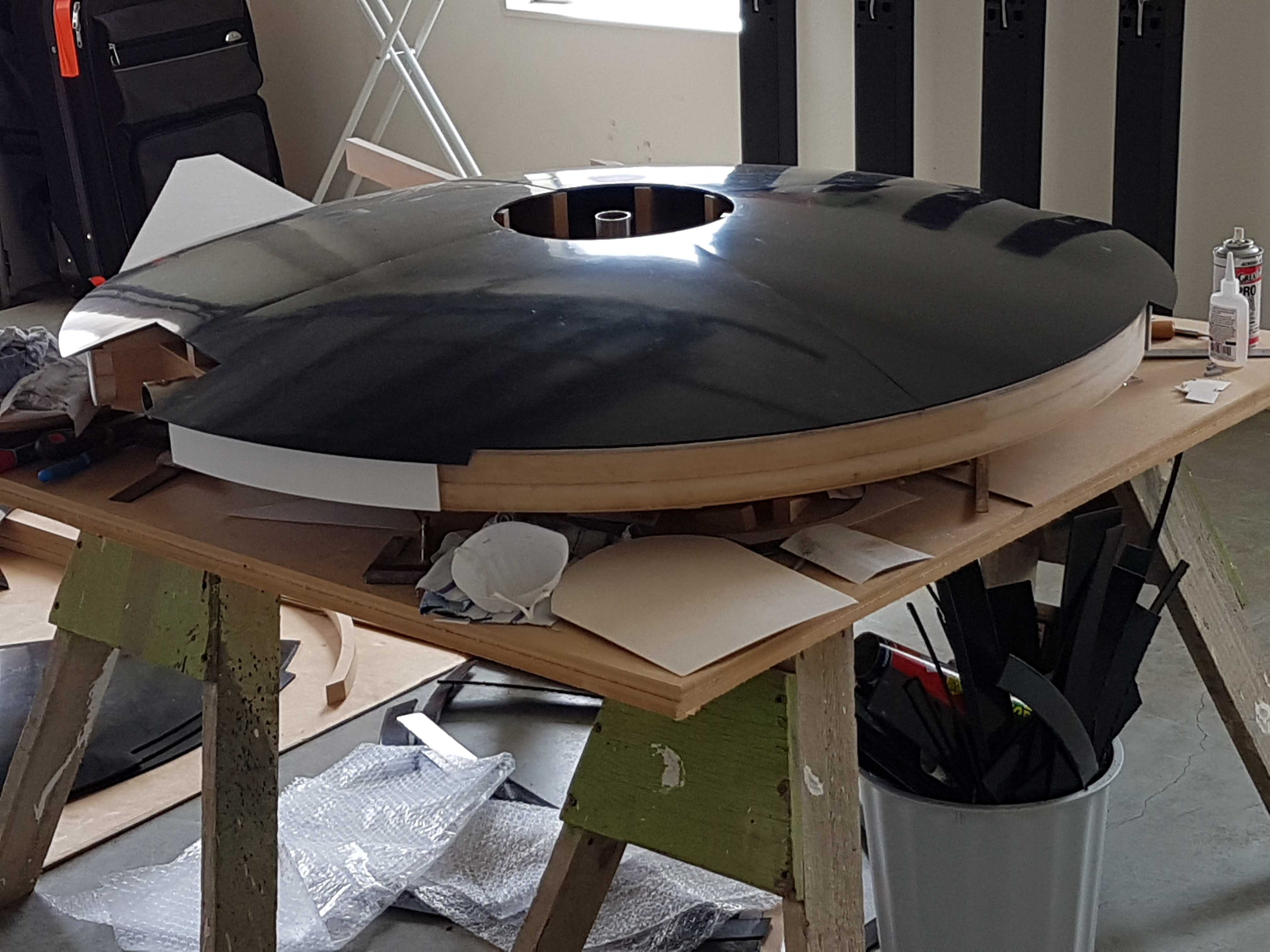

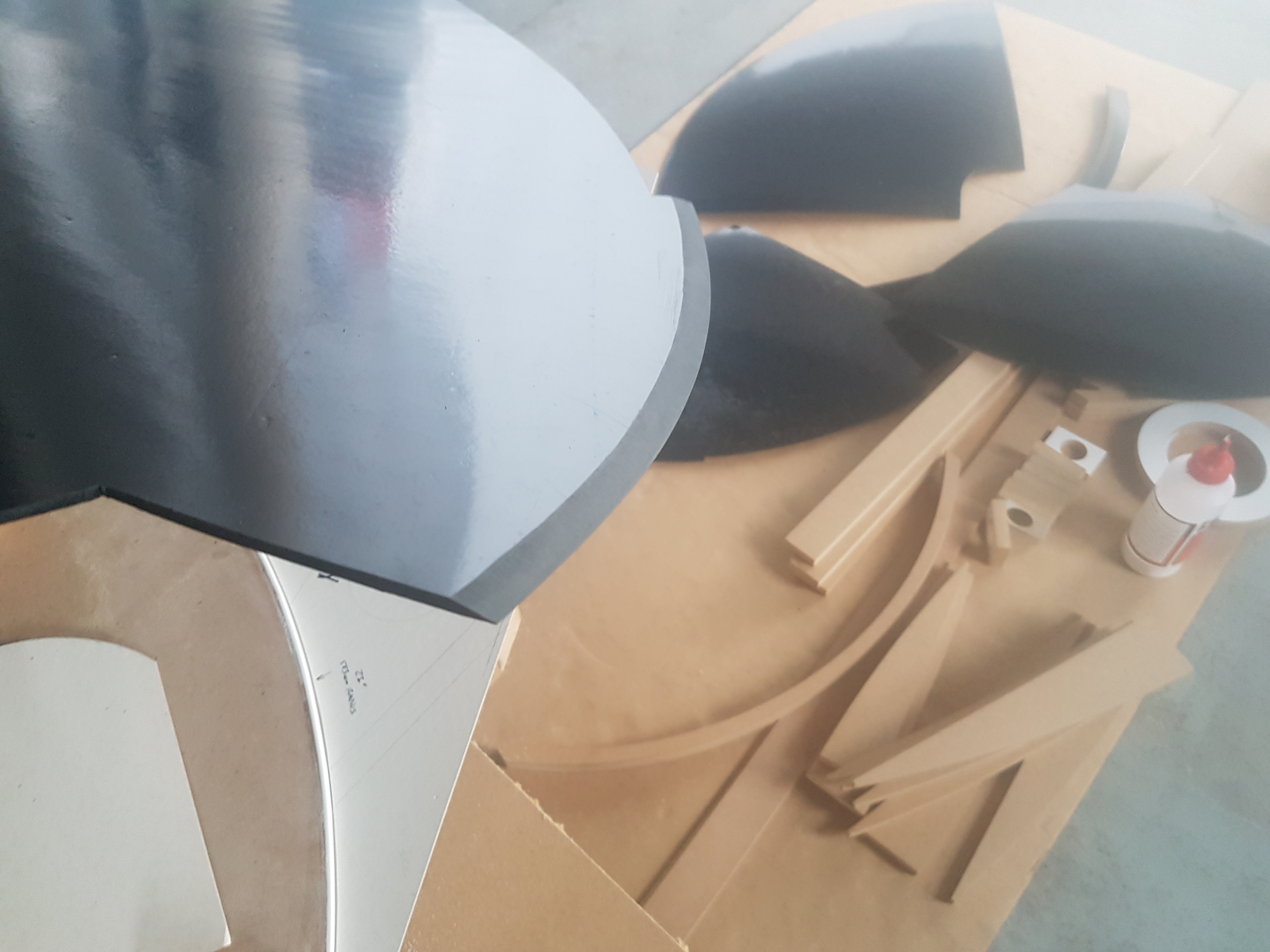

Progress on core/dome assembly. Underside domes all in place, still deciding if I will screw these down as well, the glue seems to be doing the job extremely well!. Very happy how the dome quarters behaved in sitting down nicely to the inner structure & seeing the overhang is amazing!. With the overhang, each underside lip has to be chamfered/routed flat to give a 0.75 - 1mm edge. I do this with a beam sanding powertool & finish up with files.
On to installing the rear engine lighting & diffuser this weekend & finish up the topside dome fitting. Then onto attaching the subassemblies & marking out pit positions & plating...the 'fun' part!.
