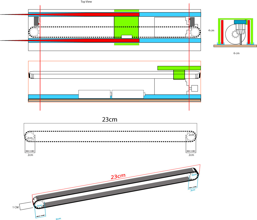

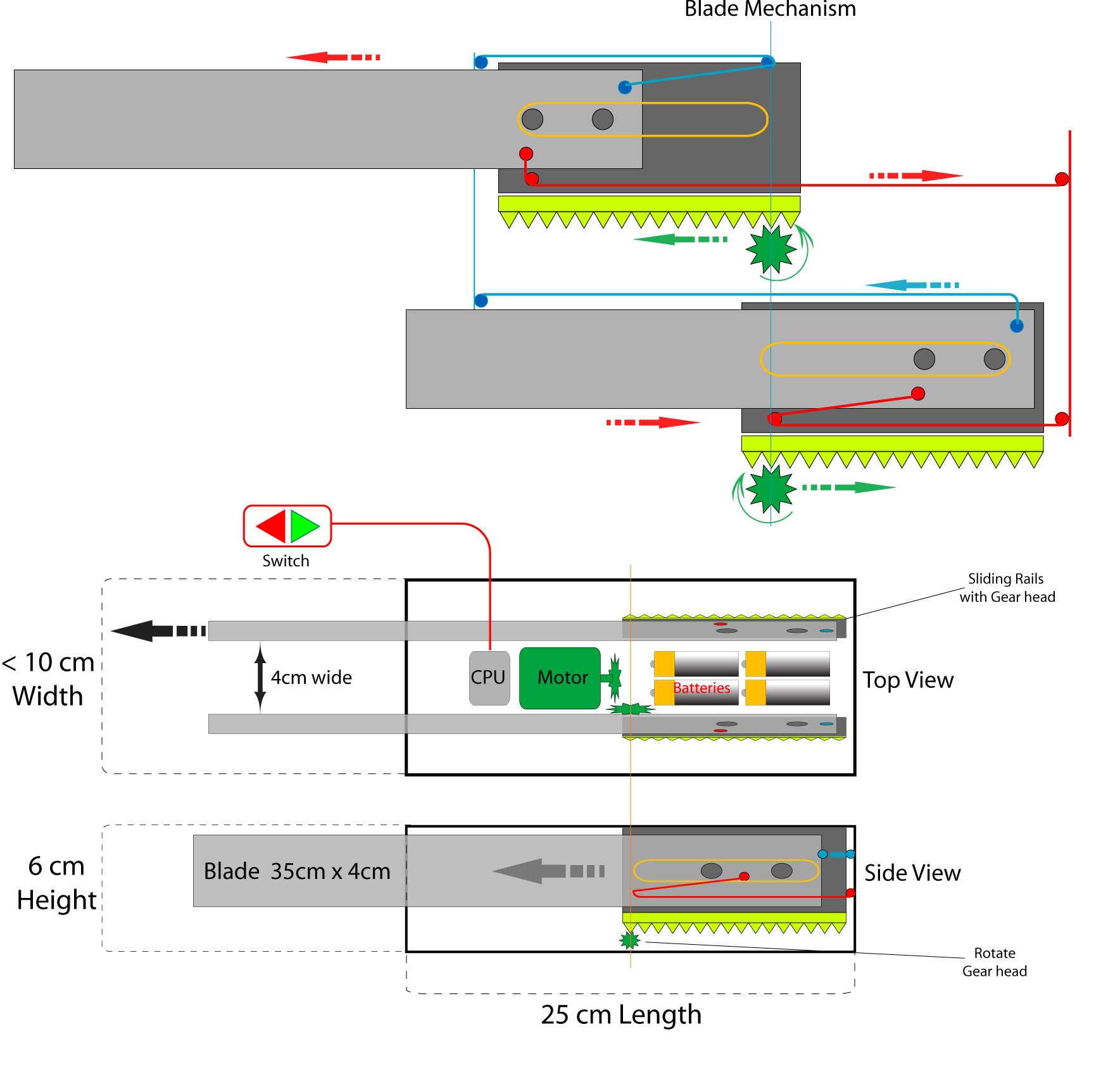

HI Jerome
Belt drive thing do you mean something like this?
This one uses a motor in between the blades and also hides small AA batteries in the center of the gauntlet to maintain good weight balance.
The trick is to make the housing fit on top a gauntlet with the battery holes underneath. The gray rectabgles are stop switches which cut off power to the motor
when it tripped. There are 2 of these.
The Blue is the sliding rack. The Green is the blade holder that slides across the entire housing.
I've also designed another system with the pulleys/ slider tray in the rack and pinion but its in theory and gotta figure out the length of the ropes to pull out the blade holder
all the way out.
I've designed these like a year ago and haven't found anyone that could make them. Perhaps We can collab on these so feel free to use the plans to develop something

That's somewhat similar to what I had in mind as far as the belt drive goes. There are a couple of potential issues I see with your design. It looks like the belt is acting as a retainer to keep the blade holder in place and there will be a lot of friction due to the height of the blade holder and the large surface area. You would also need a very high speed final drive- probably around 500 rpm due to the pulley diameter.
The way I envisioned it the motor would sit perpendicular to the belt at the end of the slide (or underneath it) so it would directly drive the belt pulley and a potentiometer would be geared to the motor shaft to give position feedback. I'll have to do a sketch to explain it but it's super simple.
