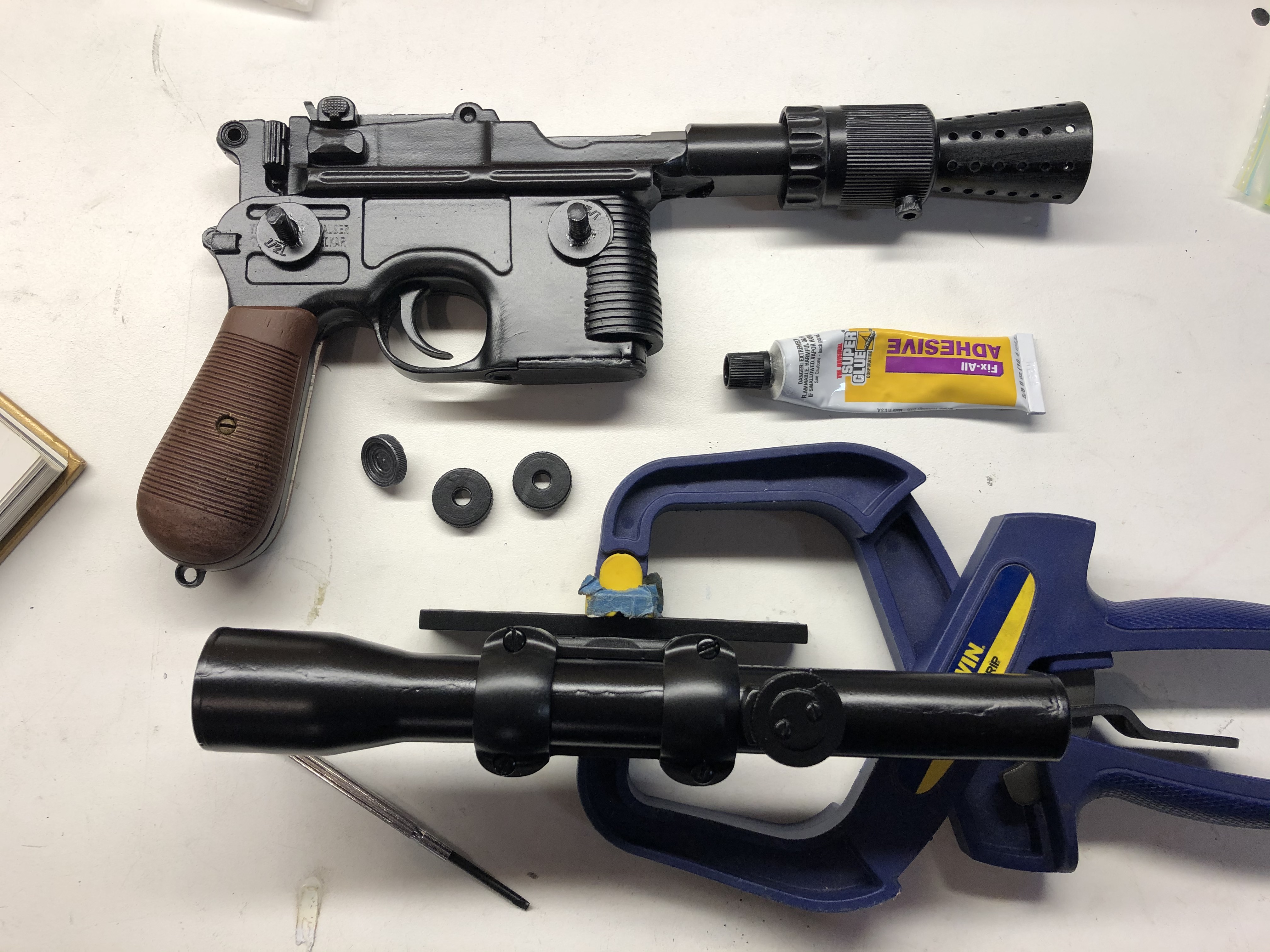

After hitting it with a couple of coats of flat black and then satin black, it's time for assembly.
I started out by sanding the inside of the grip area and the back side of the grips before applying the contact cement:
Basically did the same thing with the lower mount and cradle. I didn't like the "crinkled" surface on the lower mount, so I sanded it down to prep it for some more spray paint.
I used some rubber bands to keep the grips in place.
I used the spacers to mark exactly how far down the threaded rod was suppose to go and then applied some super glue to keep them in place. Once dry, I removed them, applied some contact cement and then replaced them.
I also sanded down the front the magazine area along with the inside of the grill before attaching it.
solid work! I especially like the grip finishing tips, i know i'm late on that one
I found it was easier to simply clamp the lower mount to keep it place while installing the scope:
The bottom of the scope and cradle were sanded lightly before applying the contact cement. Real screws were used to keep the rings in place. They were tight, so no glue was needed to keep them in place.
It was a little tricky making sure that the scope was straight, so I checked it from all angles while tightening down the rings. Double checking a reference photo from the Chronicles book, the windage knob should fit right in front of the forward ring.
Left it over night to dry and then mounted the assembly to the Mauser with the two knobs. A little bit of contact cement keeps them in place.
