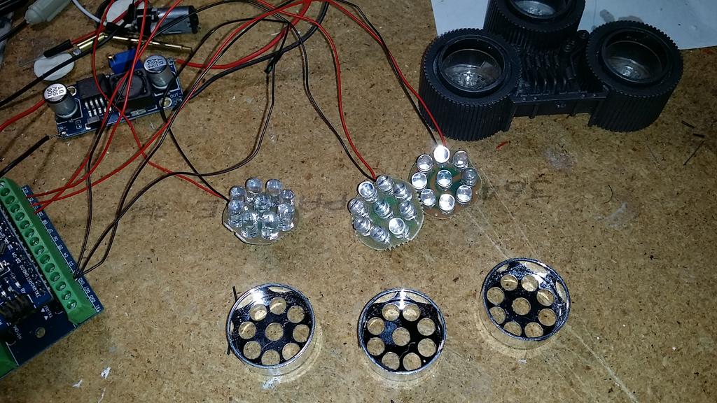

This is a picture of the LED array I am using (more on them in a bit)
And here is a video of the array firing up

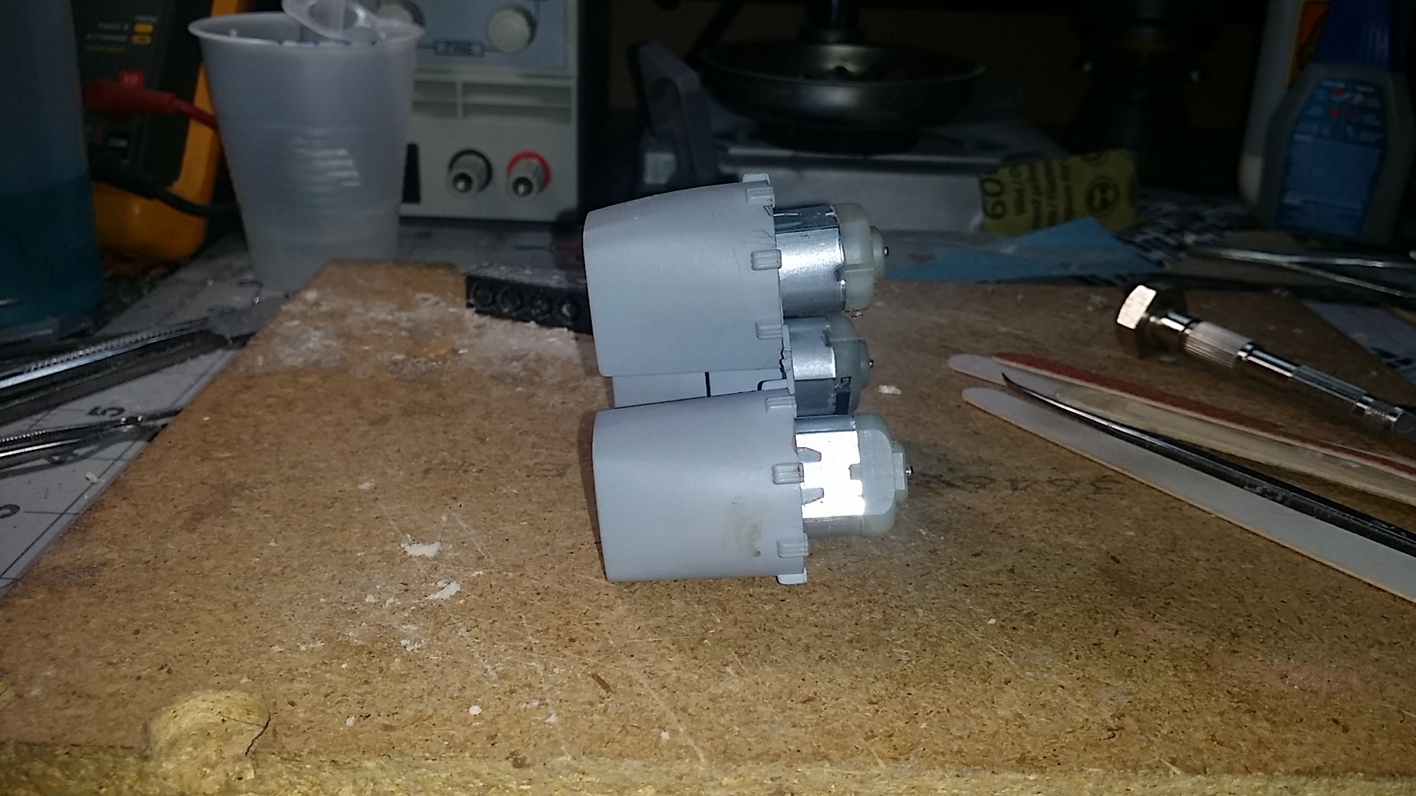

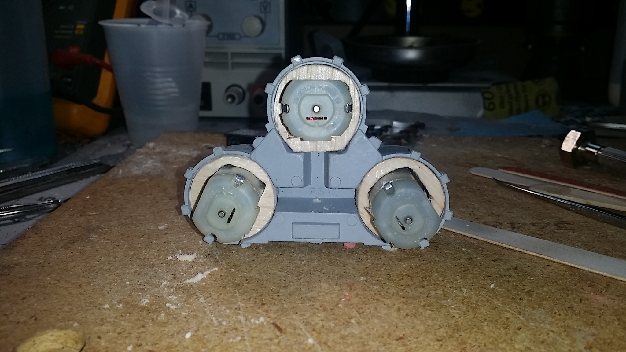

Turbine test
This is just a preliminary test. Nothing is soldered at this point and the turbine fans are just press fit on the motors. One of the wires came off the left turbine but I think this still demonstrates the effect I am going for.
Once the wires are soldered and the turbine fans permanently attached to the motors the alignment issues will be resolved and all three will spin. I set it up so the left and right turbines spin opposite of each other... I'll show that in a video when I get everything soldered and the fans epoxied to the motors. The turbines still need to be painted and weathered. This is just the first test run to see if they will work clearance wise and how it will look.

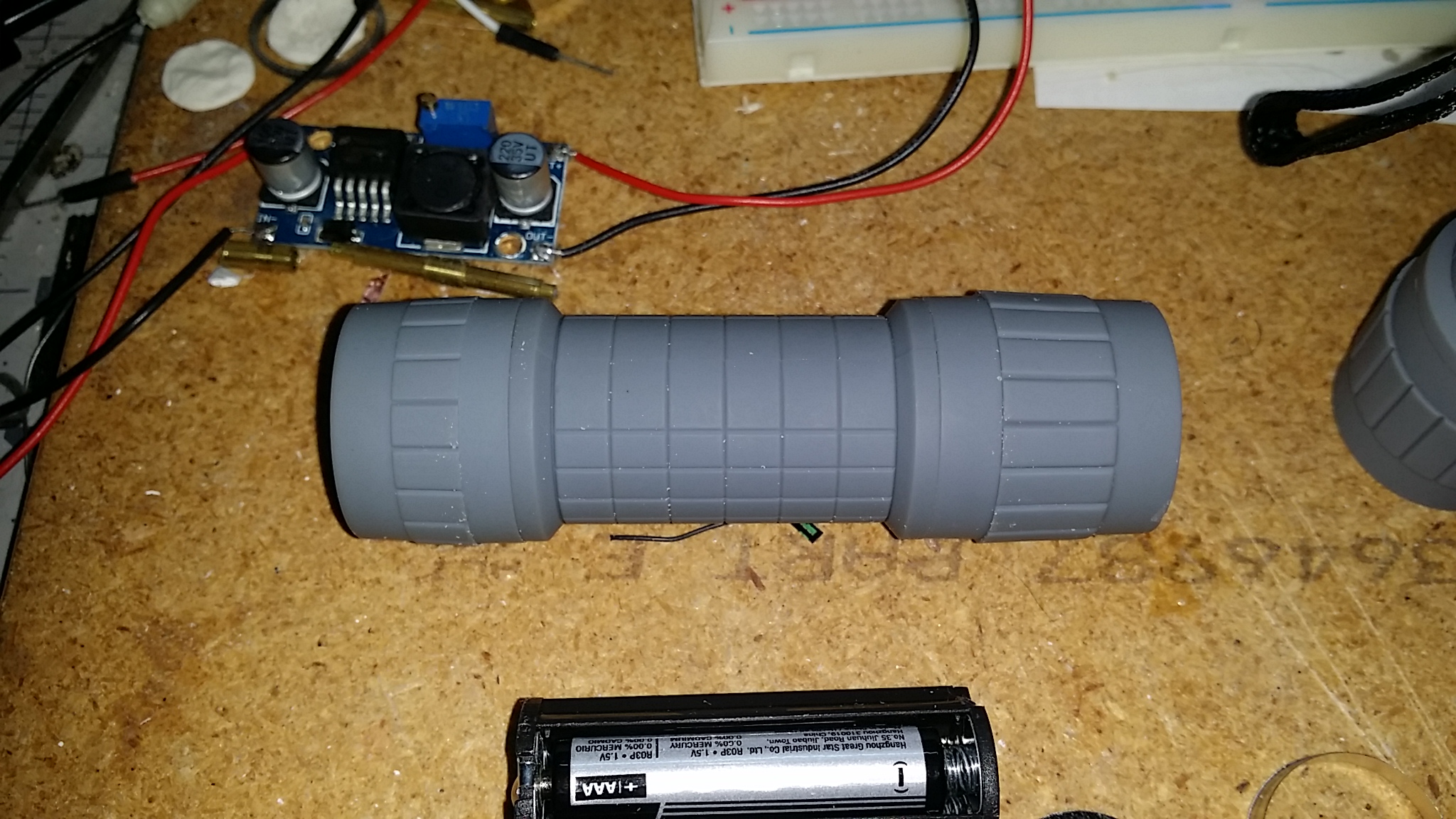

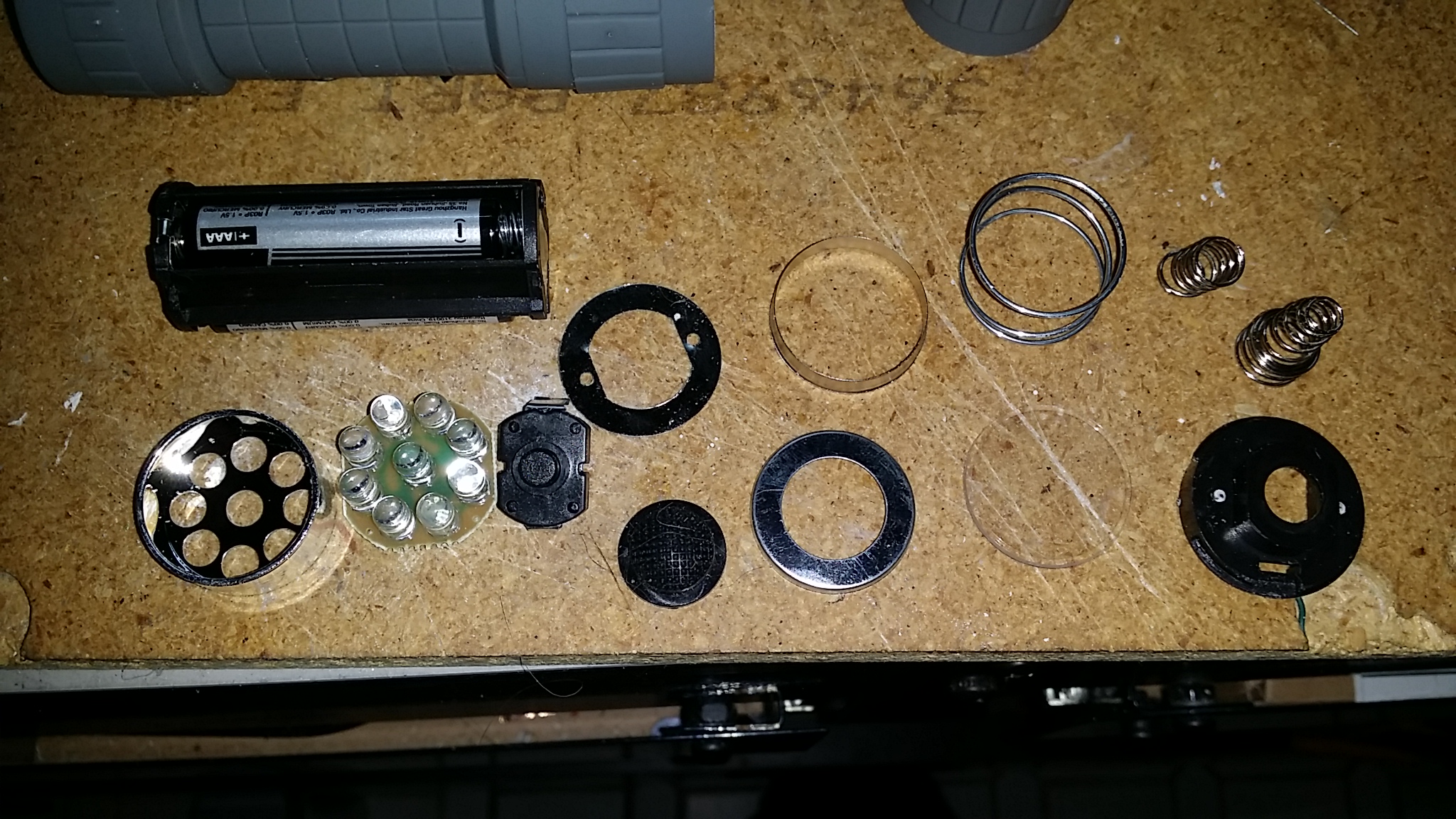

The LED arrays- you nailed it! They are from a $1 LED flashlight from Walmart,
This is the flashlight to get. They also have a metal one but I haven't taken one of those apart to see what's in it.

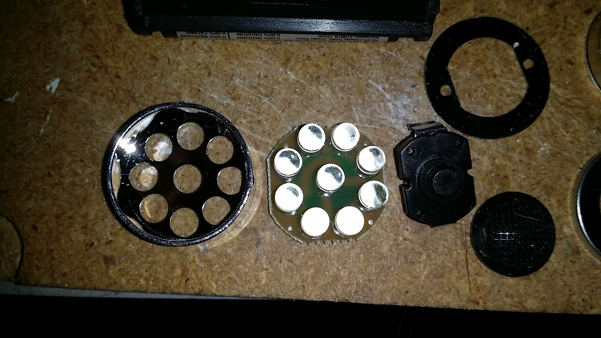

These are the parts when you tear it apart

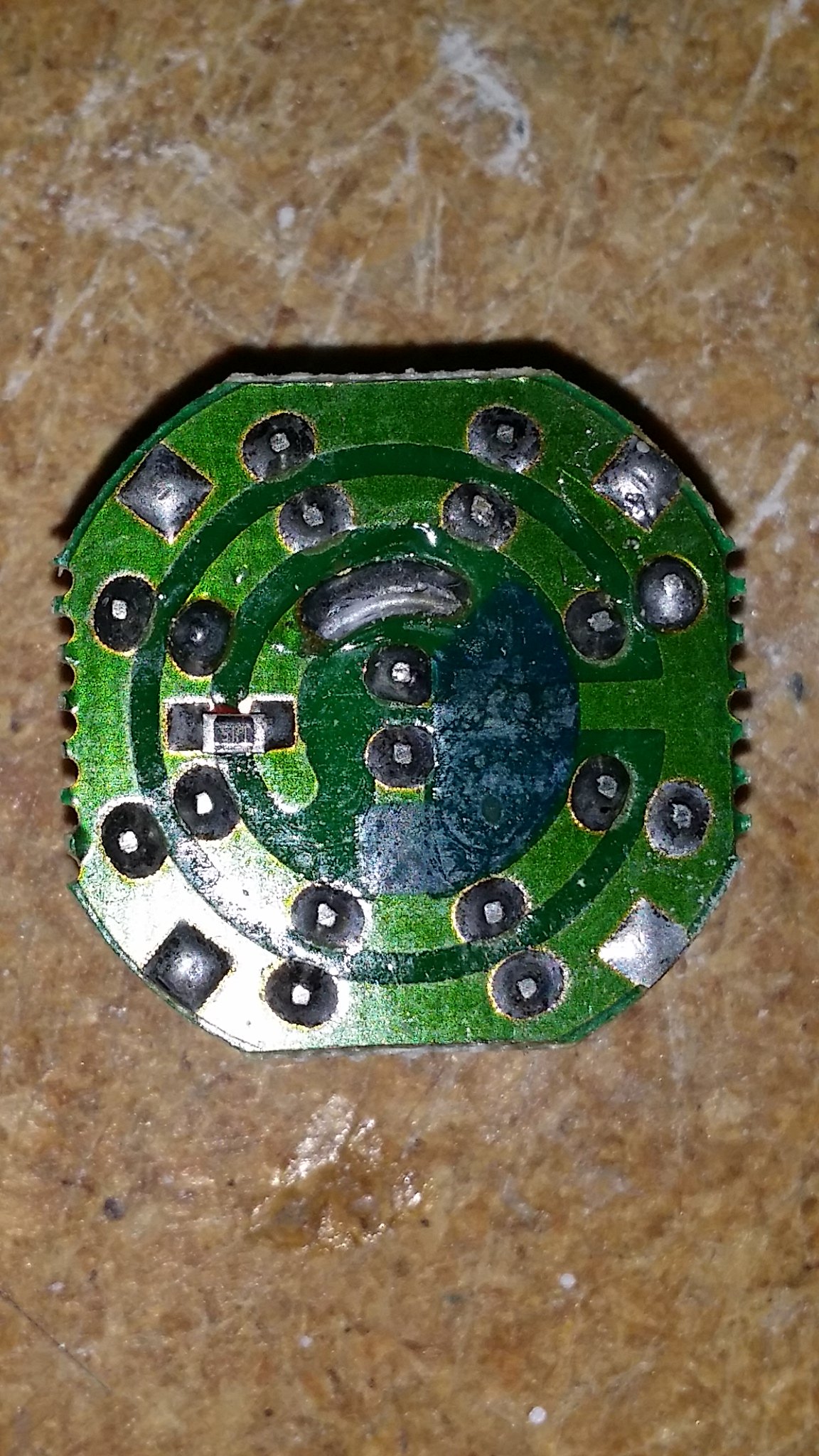

Closeup of the LED array, housing and mini switch
Here is a closeup of the back of the LED array

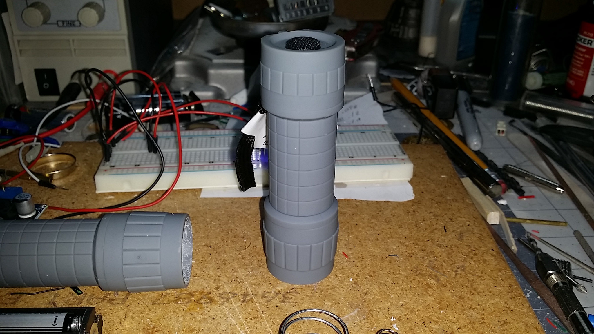

The case itself might have some interesting uses, perhaps for a kit base engine?
All that for a buck!
The flickering blue LEDs I got from HDA are what most people seem to be using. There is nothing wrong with the LEDs, they just aren't really bright enough for an engine effect, at least not for something like a Viper, which to me should envision pure raw power!
The LED array looks like it should be easy to modify and I will probably use some for a TOS Enterprise build... not the 350 scale of course.

The LED light array is 1" in diameter. What is nice about it is that it pretty much works like a single LED, I had no trouble connecting the array to an Ardiuno board and it is plenty bright running on just 3VDC. I think it gives a nice thruster/afterburner look.
