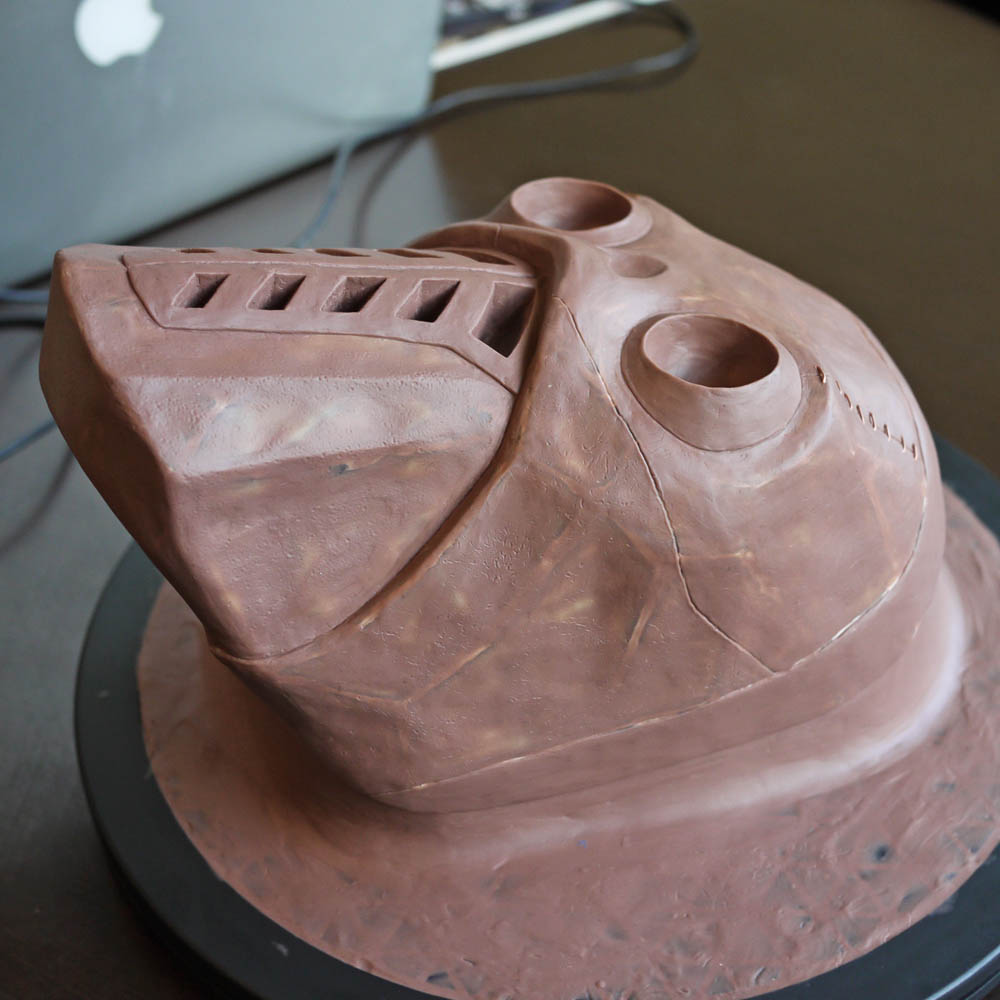

One of the masks I’ve always loved is the Bandit Steve mask from Borderlands 2. I’m in the process of sculpting this mask, trying a technique which I don’t think I’ve seen before (but wouldn’t be surprised if someone has used it).

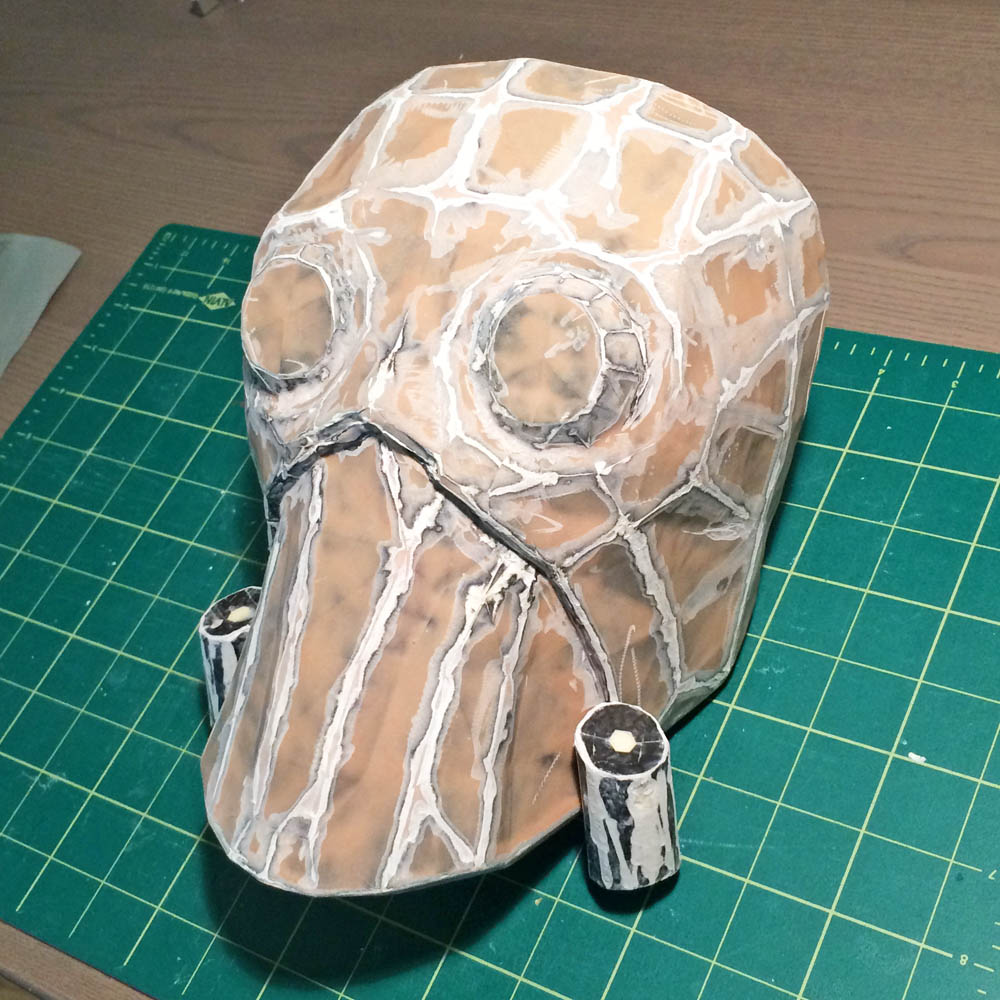

First I created a Pepakura model from the 3D game asset.
Then I applied rondo inside and out, and dremeled down the facet edges.

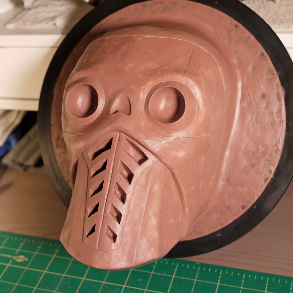

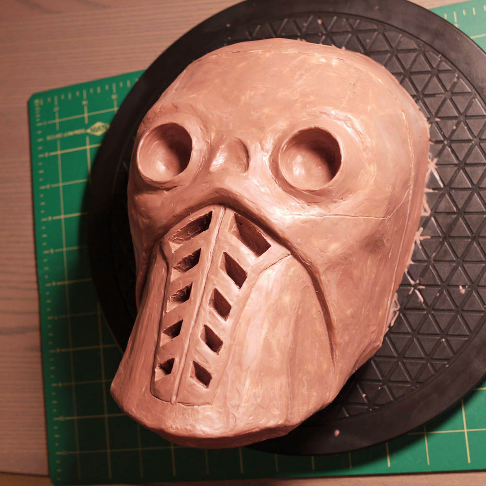

Then I added a thin layer of Monster Clay over the whole surface. Over that I am now building up the 3D details and adding texture. I’ve done something similar for previous projects using Apoxie Sculpt, but have been wanting to try a non-hardening clay so I can go back and tweak. The Apoxie Sculpt sands really well, so it is great for getting smooth, even surfaces on the original sculpt (instead of, say, having to mold the original, cast it, and then sand/smooth the cast). This mask doesn't need to be smooth, and the clay will let me experiment with textures.
Before adding the clay, I cut holes in the Pep model where the eyes and mouth vents are. Where there were holes, there are now clay divots, which I’m hoping will be deep enough to leave openings in the slush cast. I’m sure a bunch of dremeling will be needed to clean all of that up.

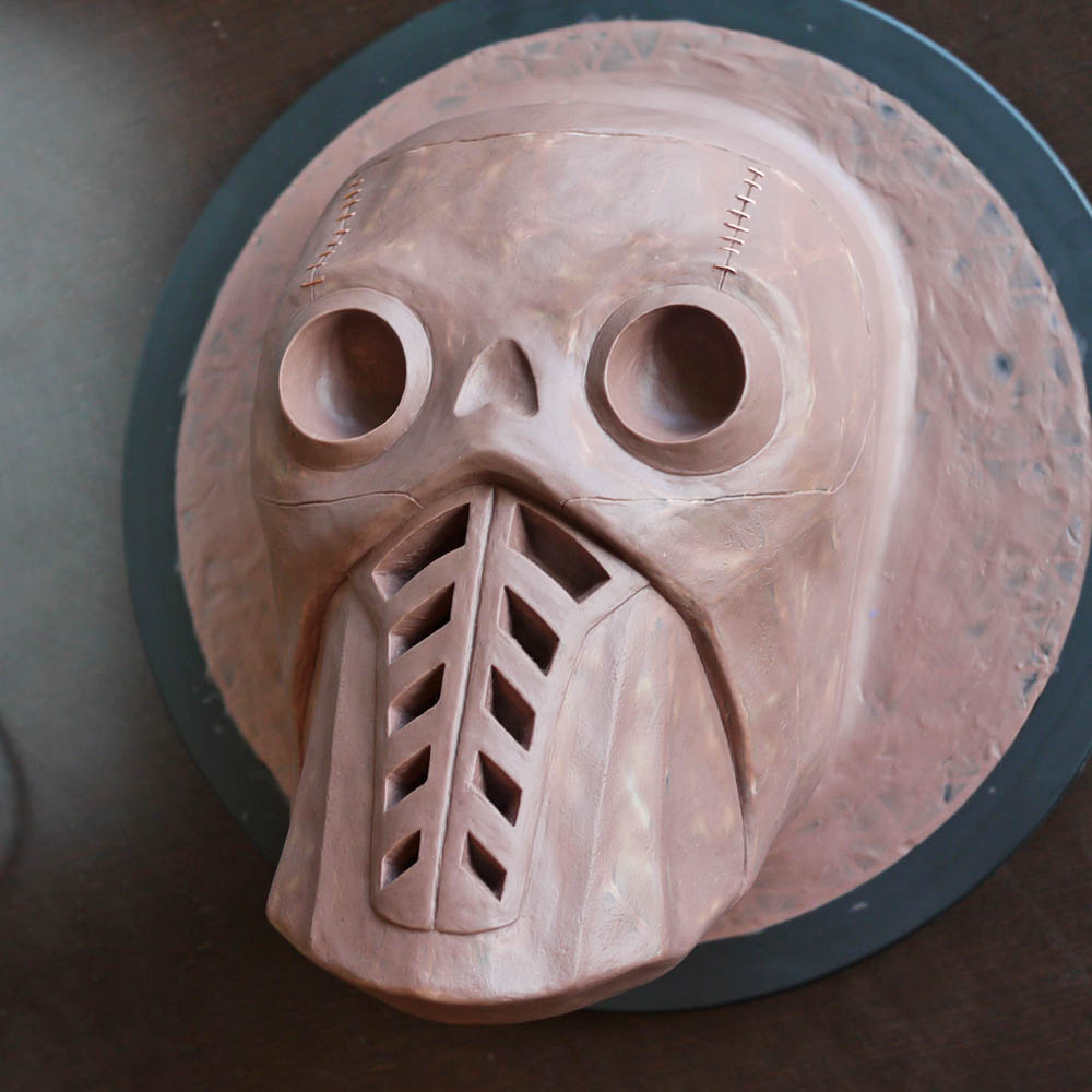

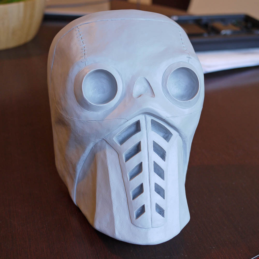

Here's the final version of my clay sculpt.

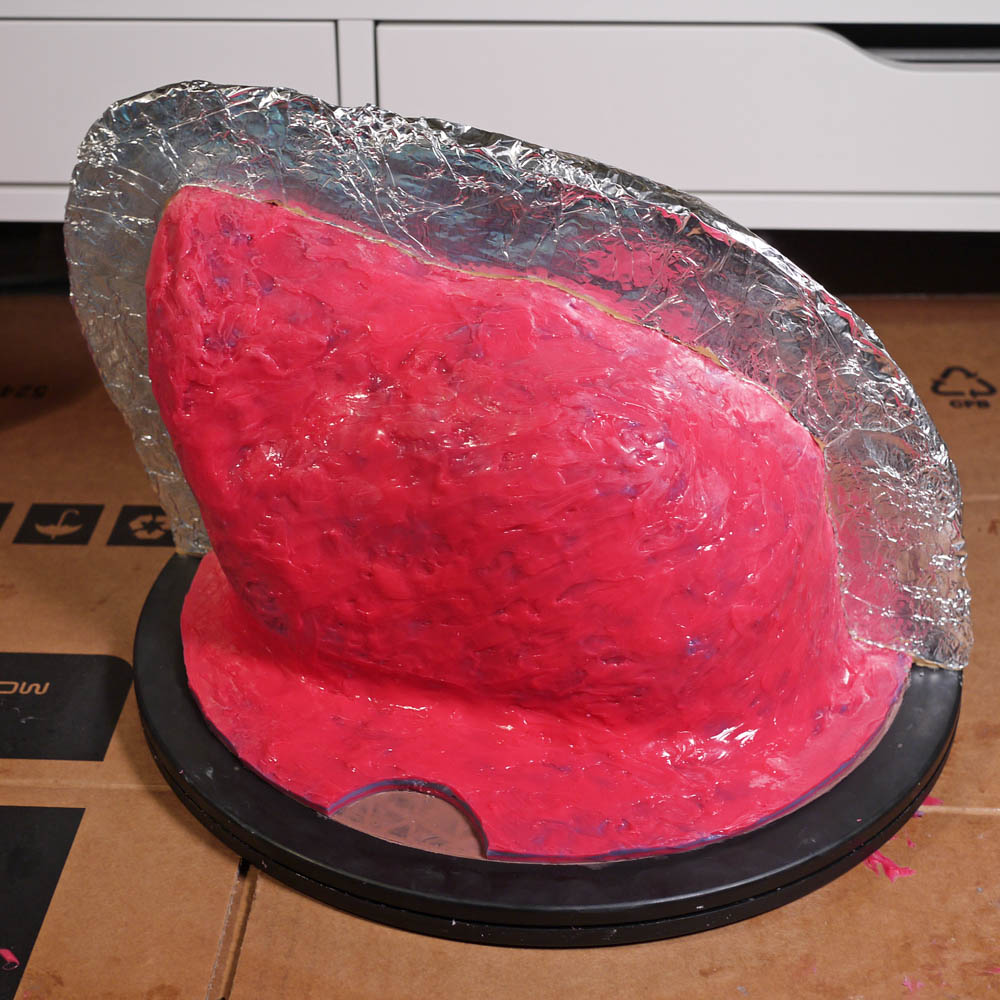

I hit it with some clearcoat, then molded with Rebound 25 and gave it a two-part Plasti-Paste shell. I ended up using 4 total coats of Rebound, about one trial size kit worth.

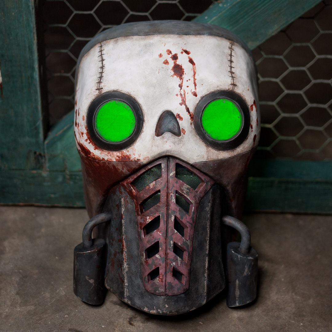

I guess I took my sweet time finishing this up. Several months later, here's the finished piece.

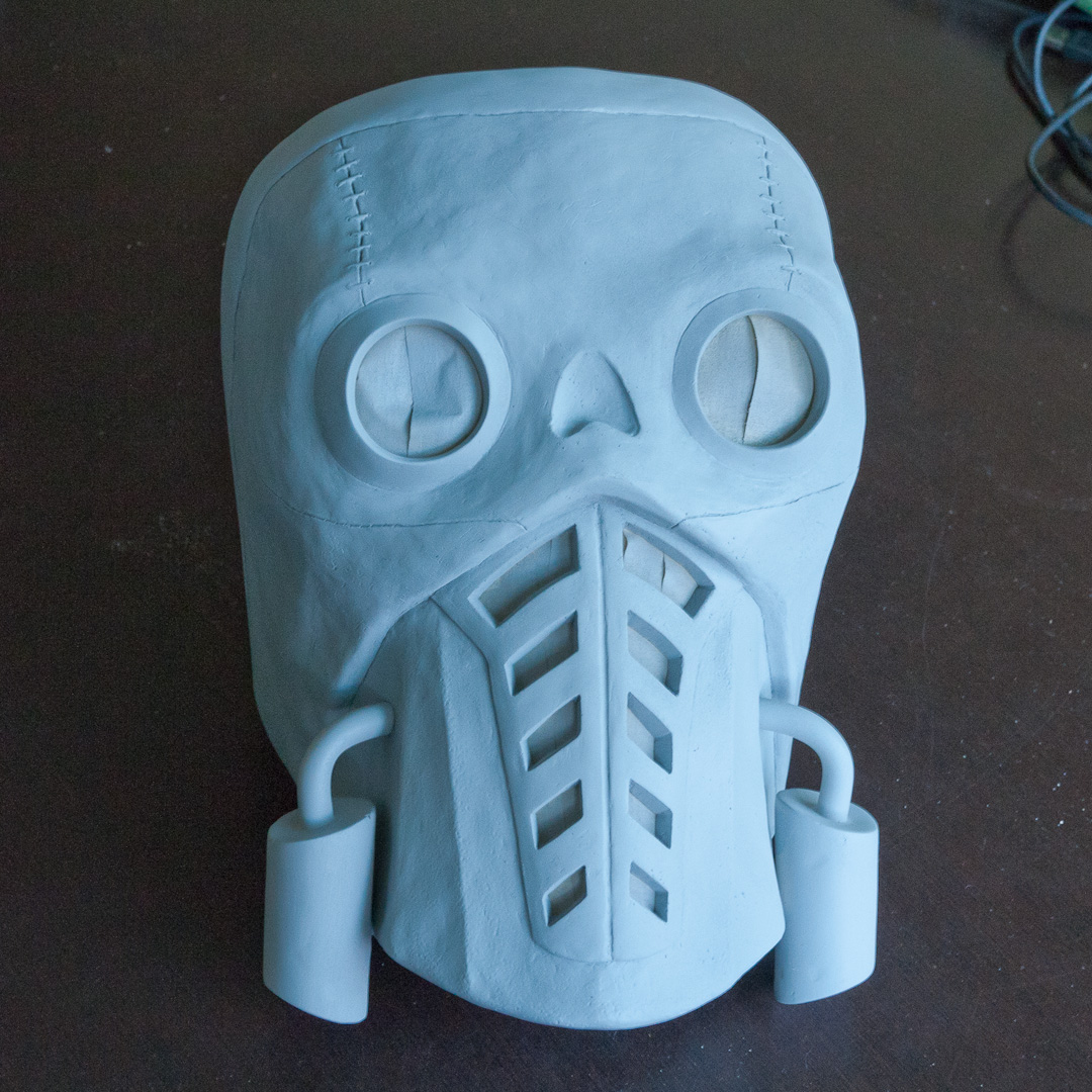

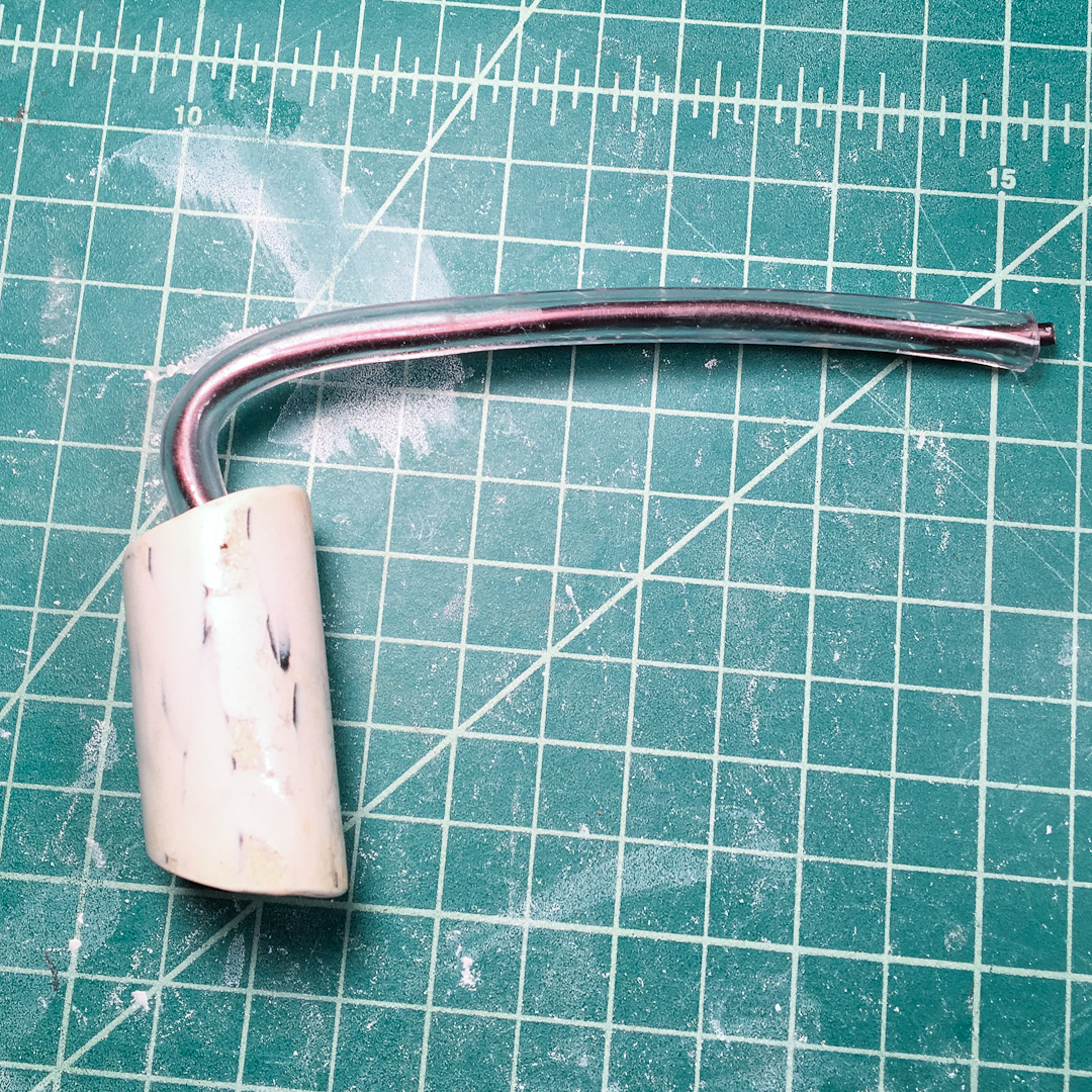

To make those little filter tube things, I just shaped some Apoxie Sculpt on the end of a length of vinyl hose. I stuck a piece of copper wire inside so it would maintain its shape. The shape is the same on each side of the mask, just mirrored, so I only needed to sculpt one of them, then mold it and cast two of them.

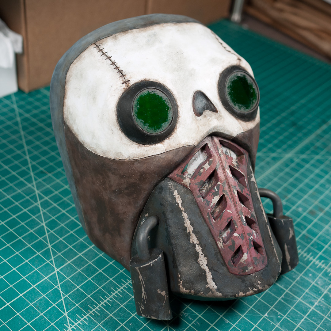

With the two filter tubes attached to the mask, I gave the whole thing a coat of gray Tamiya primer to prep for painting.
The paint is all brushed acrylic. For the grill area on the lower half of the mask, I put down a metallic layer first, followed by some dabbed on splotches of rubber cement, followed by the top coat. The areas with rubber cement rub right off, taking the top coat with it and showing the metallic layer underneath. For all the work, I think I could have just dry-brushed some metallic paint over the top coat along the corners and it probably would have looked just as good. At least I would have saved some metallic paint.
For painting blood, I've been using Tamiya clear red acrylic with some brown wash mixed in. I dab it on with a toothpick. This allows me to get some shapes and textures which are more interesting than a standard splatter pattern.
The eye lenses are green-tinted acrylic sheet, cut to fit. I have a light inside the mask and some opaque white cloth behind the eyes to get them to glow like that. That wouldn't work while wearing the mask, but it sure does look cool in photos.
