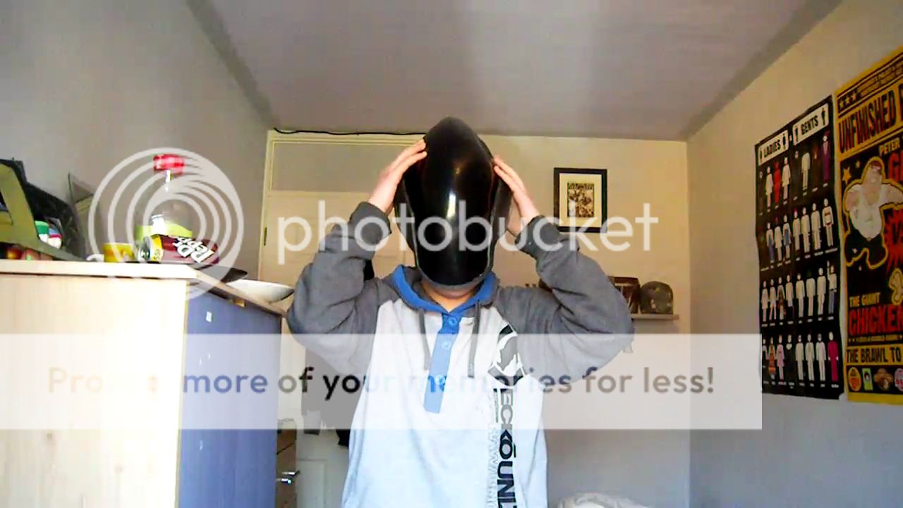

Here is me wearing the helmet. Despite having to do 12 coats of tint, visibility is about 80%. All thats left is to paint the helmet grey(ish) and some battle damage and that's it.
Here is a short video of me wearing the helmet. It is still incomplete; It needs painting and needs a neck guard and I kept the video short because uploads take FOREVER.
Click the image to play the video.
