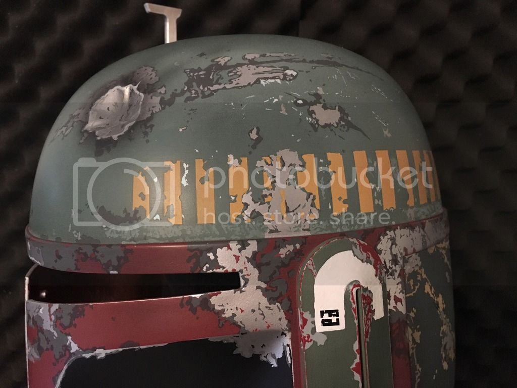

Made leaps and bounds on the mandibles this weekend and I'm pretty excited with my progress. I may get this finished before the Rogue One release and be able to wear it after all! Next is finishing up the back hat band, and front mandibles and upper cheeks with the light base grey color. Then it's just the ears, range finder topper, and those dreaded killstripes and killstripe area. Then it's all some light finishing weathering and detailing.
For the Mandibles and Hat Band I used another custom mix to create a faded light maroon base red. It was a very tricky color to create and took a few different mixes of spraying on silver coated plastic spoons to create color samples to compare. In the bottle and in liquid form this color almost looks like a dark pink but once it dries, it looks like a faded maroon. I also like to lightly mist watered down black on this in certain areas to create a bit of fade and weathering...I also like to do this before removing the masking as to not darken the silver or grey. It is very subtle.
For the grey damage I used the same grey on the dome and back panels which is Humbrol 79 (blue grey). One of my favorite colors and paints to use for topical work. It is very thick and needs thinner but allows me to get the perfect consistency for very small chip detailing.
For the purple, yes I said purple, which is the darker accent and contrast color you see next to the grey damage, I used another custom mix. This was difficult because it wasn't just about finding the right color but the right consistency to allow fine topical detailing. Once it lays next to the lighter maroon and grey damage, the purple pretty much just looks like a darker grey.
For some of the small red chips I used the same color I airbrushed on the mandibles but with a hint more red.

Killstripes are on! Removed the tape and masking fluid while the paint wasn't fully cured. If you wait too long then you risk the tape really sticking to the under layer of paint and potentially pulling up bits of previous layers so I use plastic bags to cover large areas and I try and avoid it being on there too long. This yellow paint becomes really rubbery and is not ideal for unmasking, I've learned that there's a sweet spot in the time frame to remove the masking...after the paint is still drying before it becomes rubbery. Then I'll let the paint fully dry and very very lightly use steel wool. The rubbery edges remaining from the unmasking will chip away.

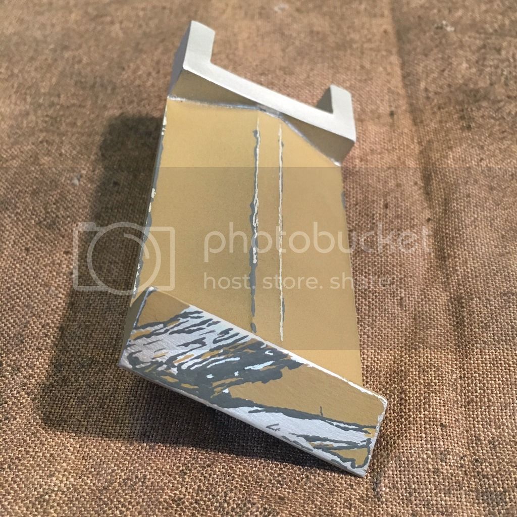

I've also been able to work on the left ear a little bit.
Re: Boba Fett (EMPIRE) Build Thread
Finished the left and right ear! For the small black markings I tried Superjedi's dry rub transfers. I have to say I am impressed with how close they are to the real deal in size and detail! Saves a lot of time painting them on but still stressful trying to make sure they are in the correct position. Well worth hands down.

Finished the killstipe side of the dome including the dent and the carbon scoring. Attached the ears and the range finder stalk. I will do the RF topper and the last of detailed weathering today. Then I'll dull coat it and call it quits on this bad boy.
