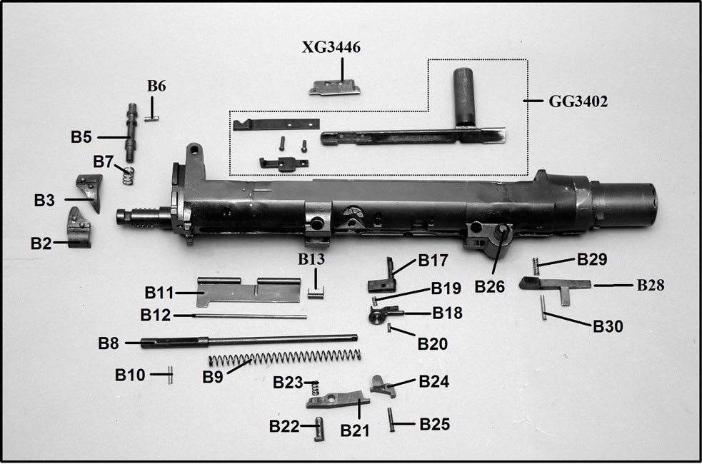

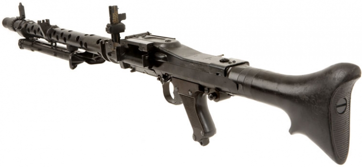

he ejection port and ejection port cover not on the plans . Part B11 is the cover, B12 is the rod that connect the to the recvicer and B13 is the spring. The ejection port is on the bottom of the receiver. when the gun is fire the empty casing will push open the port and fall out of the gun. Next the Mg 34 could use 50 round drums that connect to prong of feed tray. the Prong are left side of the blueprint but on the top view of plans they hidden under the top cover. They should be long and out from under the top cover. your MG34 is the MG 34/41 you can see how long the Prong are in the last pic
