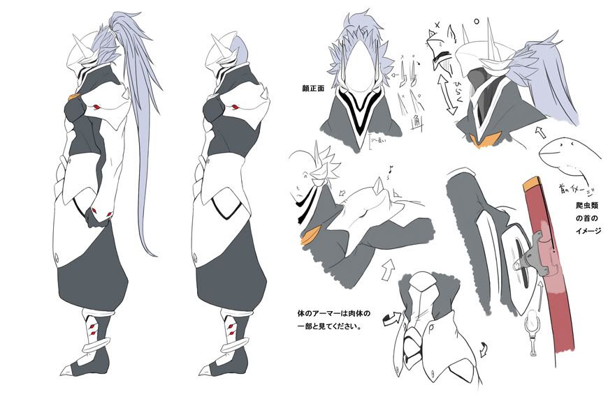

I decided the best thing to do would be to make a mask that would set above my eyes. Then I would see out of the neck. I figured the neck would look longer than it should so I would have to cheat the proportions so it would not stand out .

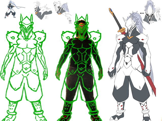

To make sure everything lines up correctly when I start my build I took a picture of myself and drew over it.
I figure I can widen the shoulders so the head would not appear so large, and raise the shoulders. Also the wider shoulders narrows the waist a bit. Another trick to narrow my waist is to have the waste guards a bit higher and tapper in for a V shape.
So far the plan is to use EVA foam for the helmet, collar, and feet. The rest I want to work in foam ,and cover in latex. I want the body (especially the black area) to appear almost as if it was bare black skin. I am going to try and make this costume looked very muscular. Not a bulky look, just ripped.

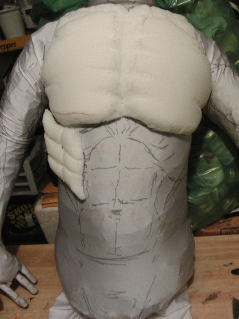

To make sure the costume was built to fit, I along with my brother made a duct tape dummy.
Next I put on a white zentai body suit. While looking into a mirror I drew on the body suit where all my muscles were going to be on the costume.
After that I took the zentai off, and put it onto the dummy.
Next I got some tracing paper and traced the muscle patterns from the dummy onto paper so I could cut them the correct size into the upholstery foam.

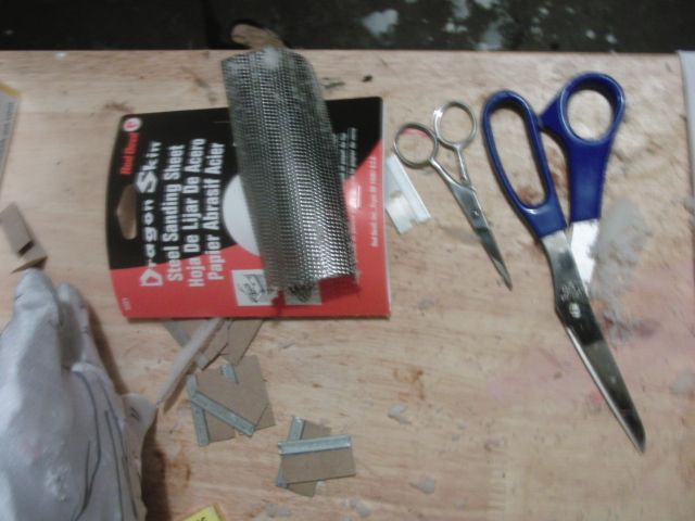

Using these tools in order from right to left, I cut the foam and shaped up some of the muscles; Big Scissors, cuticle scissors, razor blade, and steel dragon skin sand paper.
This is what I have so far.

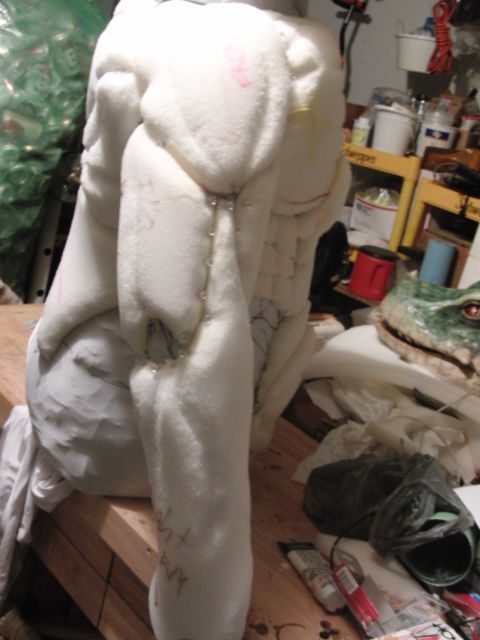

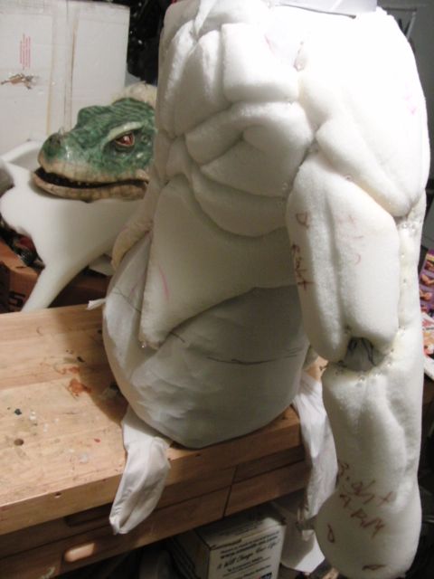

Here is what I have pinned on the body.

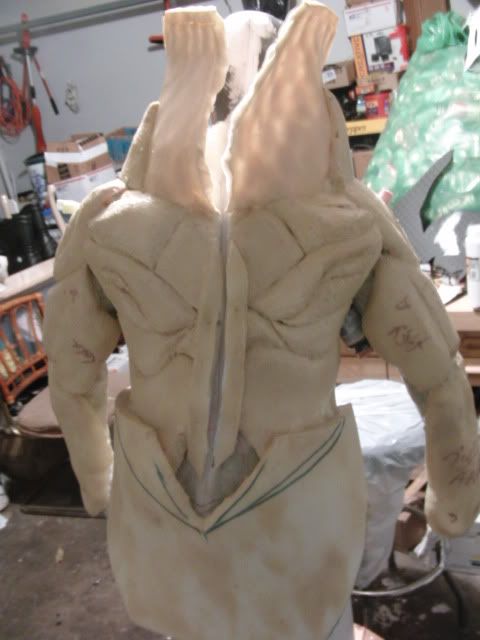

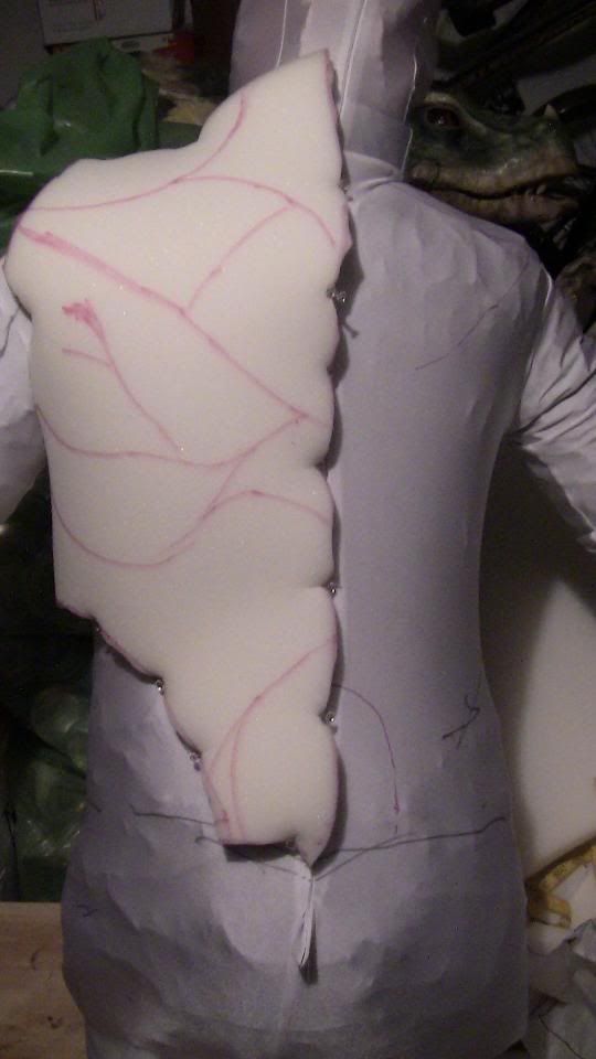

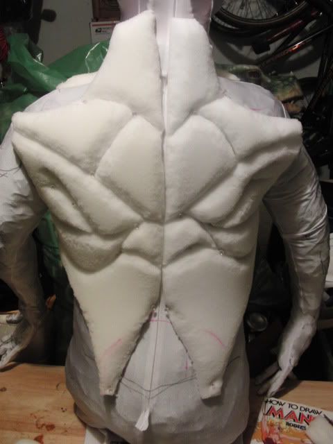

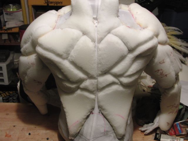

I decided the back will just be two parts. My knowledge of back anatomy is not great. I am using reffrence, but the back changes a lot depending on how the arms are positioned.

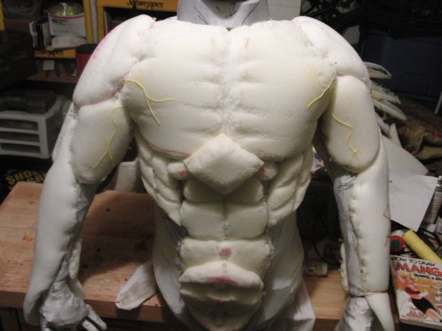

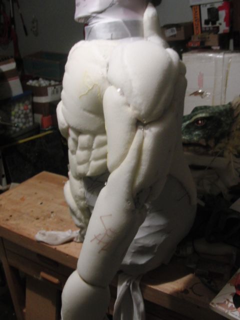

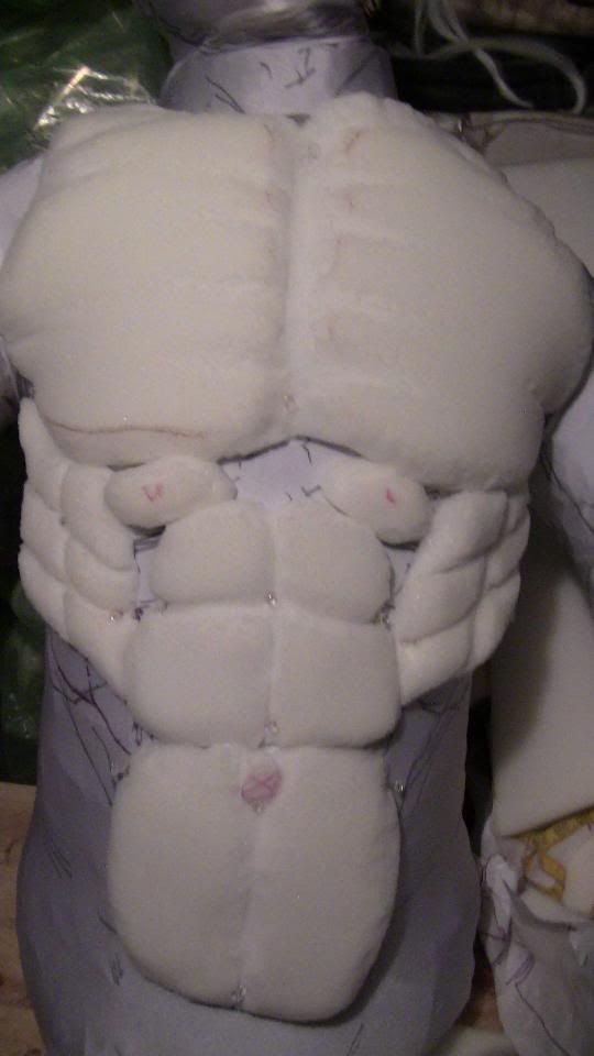

Got the chest done.
The top of the arms and biceps are added.

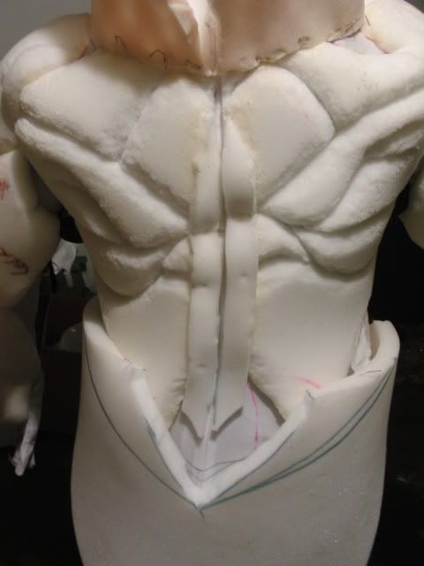

The back turned out pretty good. Having each side be a big peice really saved time. It is not perfectly scymetrical, but it will be covered.

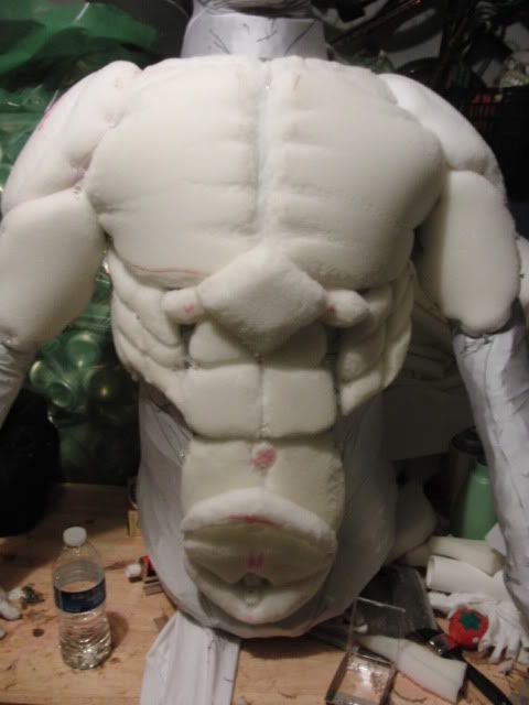

I managed to get the arms done, and I also attached all of the foam to the body suit. I used rubber cement, and spray glue to a attach the muscles. More rubber cement than spray glue, because I ran out of spray glue. :p
I satisfied with how the anatomy is coming together. I got some string and used it as veins. When you unravel it a bit it really helps sell the effect.
The foam muscles I took a big short cut with. I used one piece of foam and carved some muscles into it. I am really thinking the next time I make a body I will be using larges sections of foam. It really speeds things up.
You can notice that I did not cover the elbow. I think that having the elbow area exposed will help with the mobility of the build.

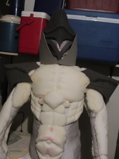

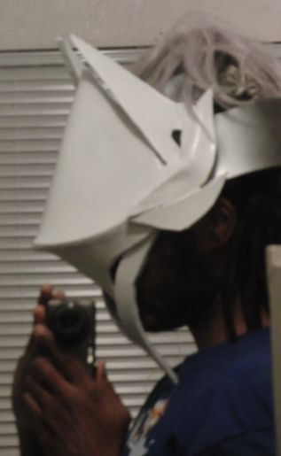

At the moment I am making some paper patterns for the armor. Once the paper templates are made then I will start the EVA armor.

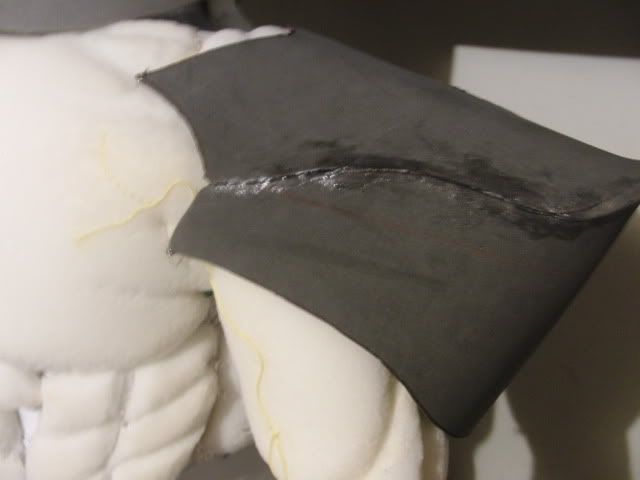

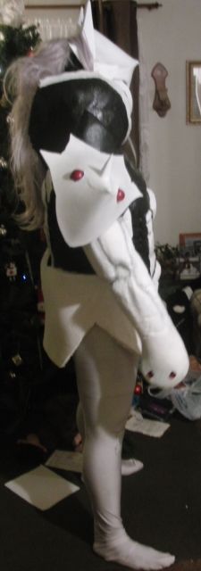

I got the shoulder pads made. Not finished. I still have to put the eyes in. My brother says I should make them light up. Not sure if it would look right just having the shoulder eyes glow while the others didn't.
I am not sure how to attach the armor to the body. I have planned on pinning the armor onto the body. Then when I add the latex onto the body, I would add it to the armor too. Then they would bond to each other. If anyone has another idea I will consider it but I have 13 days to get this done now :confused

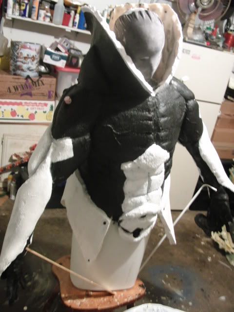

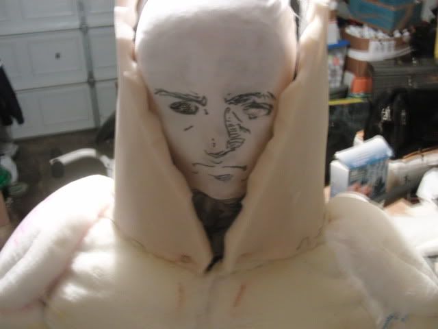

Here is what it looks like with the helmet, neck, and shoulders attached to the body.
I think the head is a bit too wide. So I am going to narrow it down.
Not sure if the neck should be EVA. I have a lot of white, red, and black fake leather. I could use that for the neck but I don't know if it would keep form.

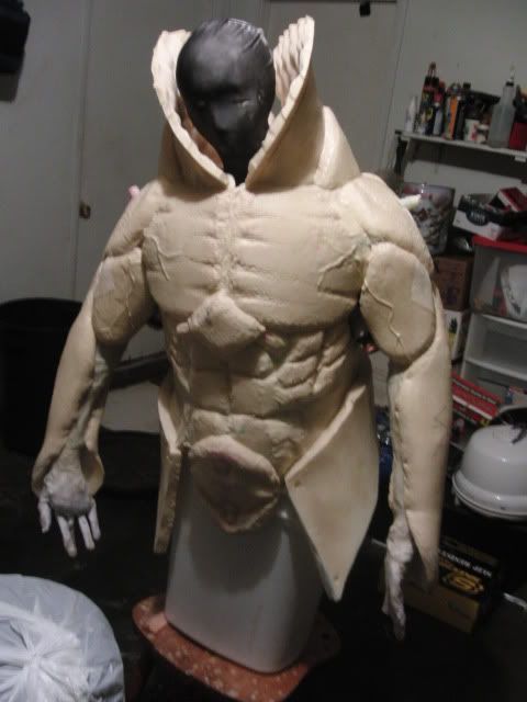

I ended up using some thinner foam for the collar.
I finished the bottom of the torso.
I added some back details.
I am pretty close to adding the latex. I sealed the upholstery foam with spray glue. I am close to brushing the latex to it. I covered the bigger gaps between the foam with really tough paper towel.
I don't know if I can start adding the latex now or if I should finish the shoulder armor.

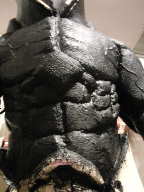

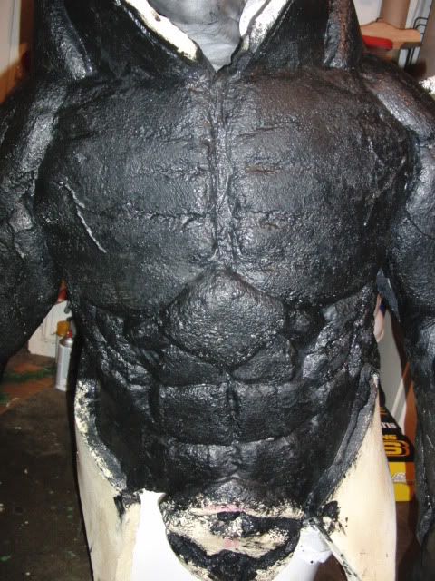

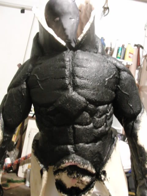

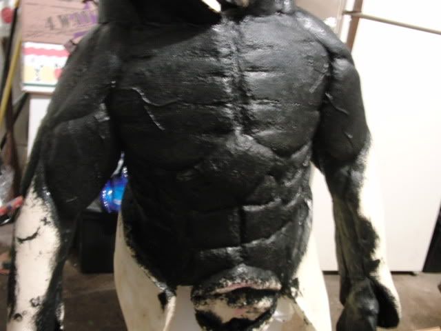

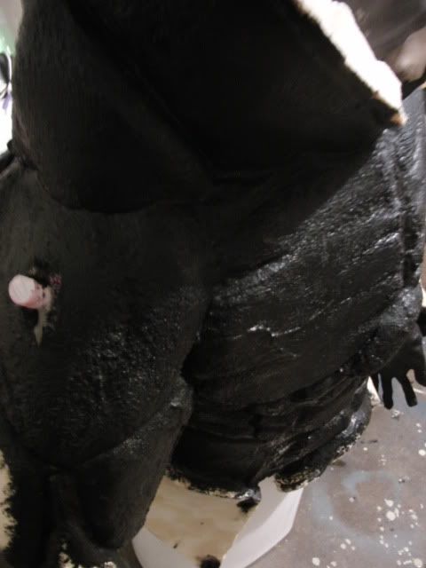

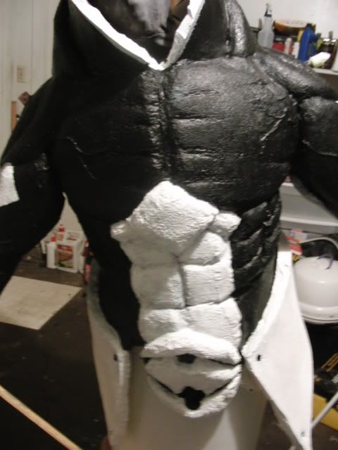

I sprayed the outside of the foam all over with a big can of spray glue. Then added the 3 layers of liquid latex to the foam.
Tonight I added the black latex from monstermakers. I figured this would work well as a base layer, for the painting, and re-enforce the latex.
I added lights to the shoulders so that the eyes on the shoulder armor can light up.
I cut the thumb off of some gloves and covered the bulb to diffuse the light.
I didn't know the black latex was going to be this shiny right out of the jar.
I only bought the smallest jar available but it is going far.

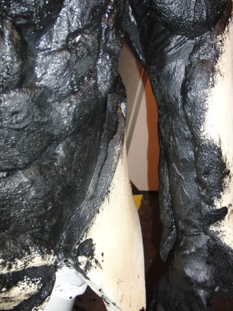

I added veins to the wrist before adding the latex with a hot glue gun. I accented the string veins on the chest the same way.

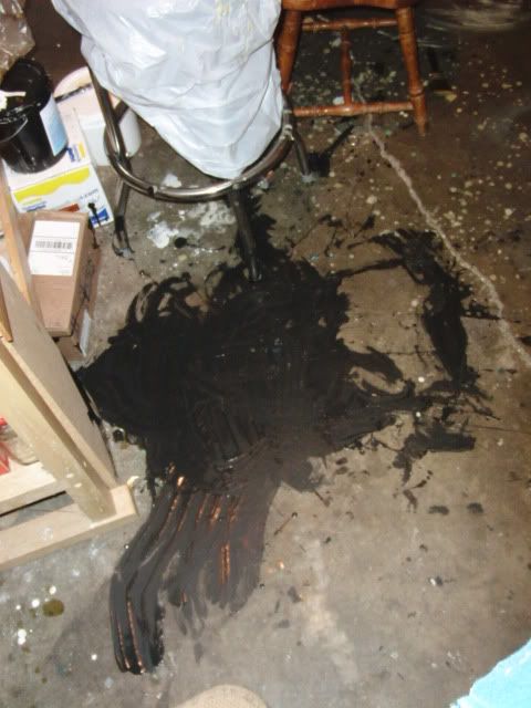

I knocked over the jar of black latex; Opps!
I was able to scoop most of the latex up with a sheet of card stock and put it back in the jar.

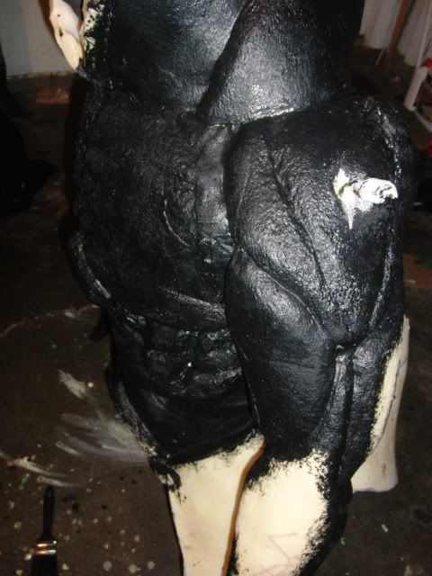

I clean the latex that got on my hands off with the glove area of the costume. I figured that would be enough to color the gloves without bogging them down with latex.

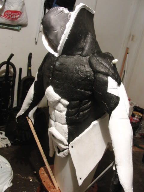

After that I had some white acrylic paint and some latex I had mixed up and added the white areas.
Now that the base colors are down all I have to do is a bit more detailing to them. Next I will add shading to the white areas.
I have decided I want the black areas to look like bare skin. So I am going to add mottling to them. I will do this with a slightly blue black latex over the raised areas with a sponge. Next I will paint thin black veins onto it.
Not sure I want to break out the air brush this time. I may uses it for the armor's shading, but all that airbrush cleaning takes time. So I will try and avoid it.
After all the painting is done I will add a clear coat to the black areas for sure. Not sure about the white.

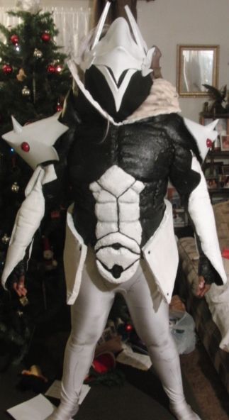

On a side note this costume was a failure. It looked better on the dummy than it did on me. I told my brother to give his honest opinion and he said it looked bad on me. Here are the test photos.
The mask turned out good.
The body looked super stubby.
I bought a cheap body suit and the zipper broke.
The collar, and back would not close.
Swing, and a miss. I ended up throwing it all away. :p
