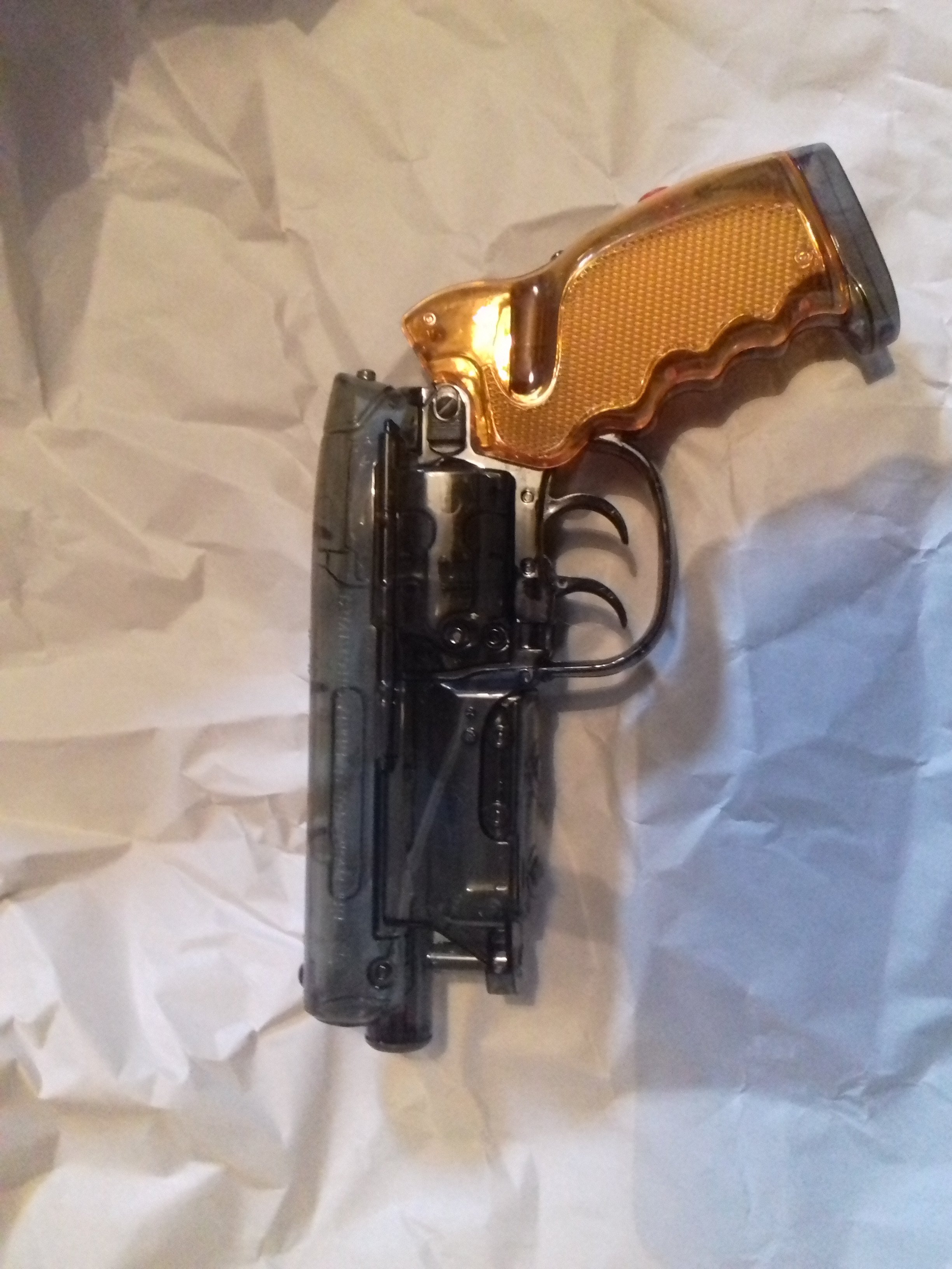

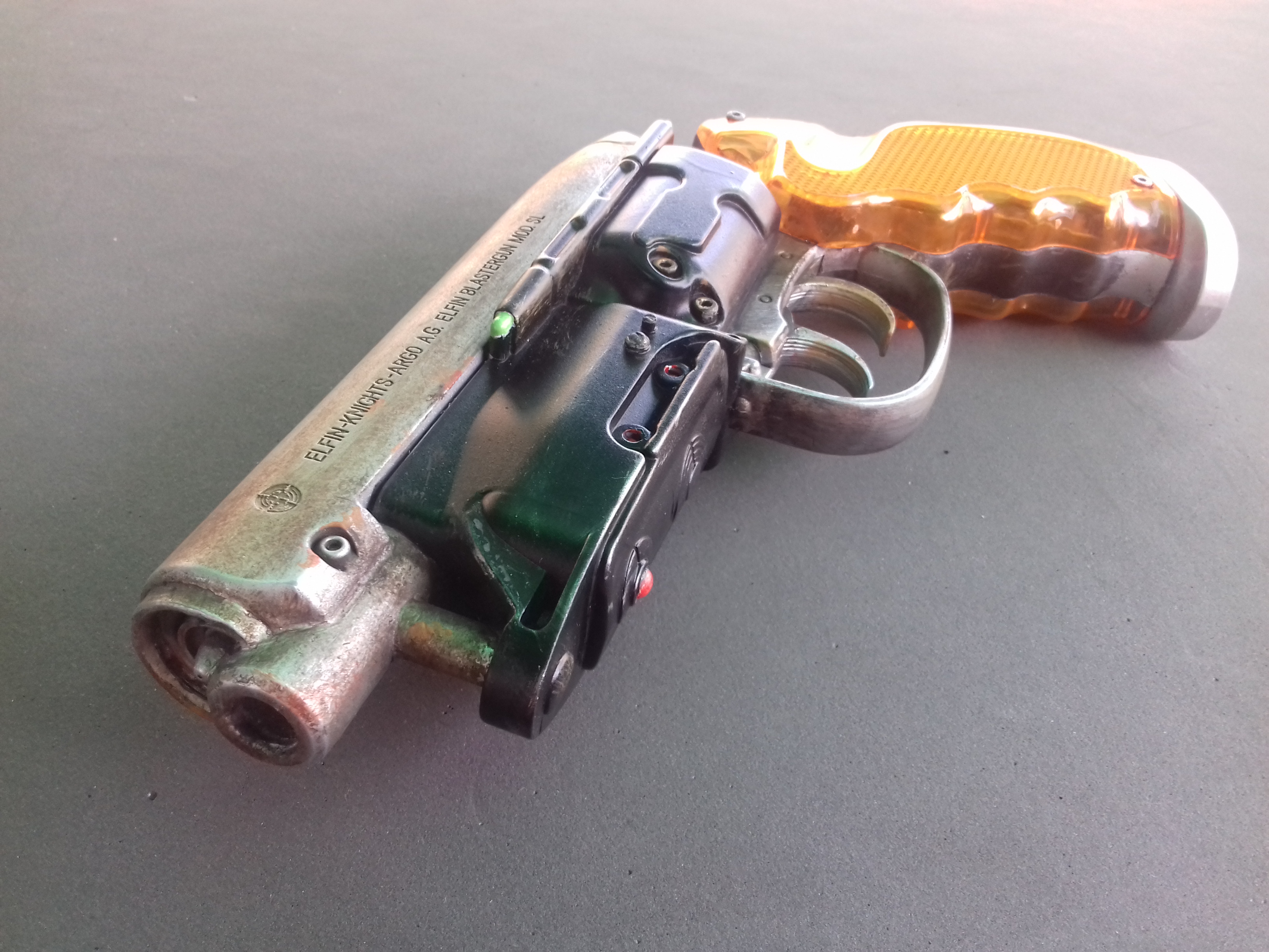

Being a great fan of the original movie, when I discovered people like Adam Savage and Bill Doran, watching their videos inspired me. When BR 2047 came out, and I saw the water pistol version of Deckards blaster - I had to have one, and following Bill's great video, and adding some mods of my own, I turned one of these -
into this
You can watch a photo-comp video of it here if you want -

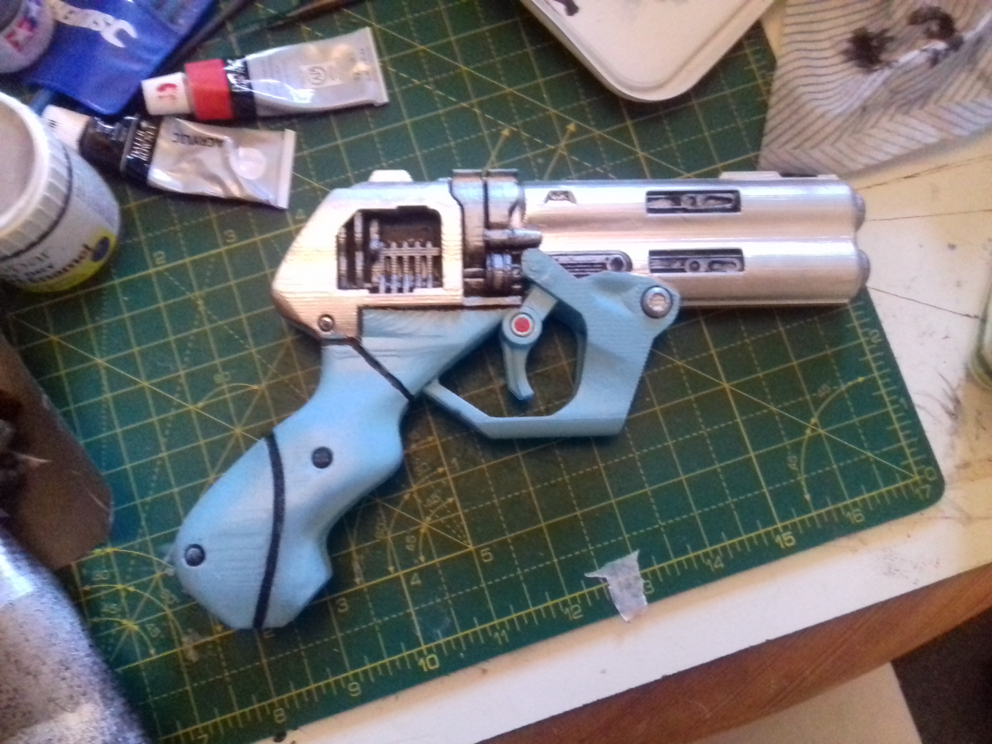

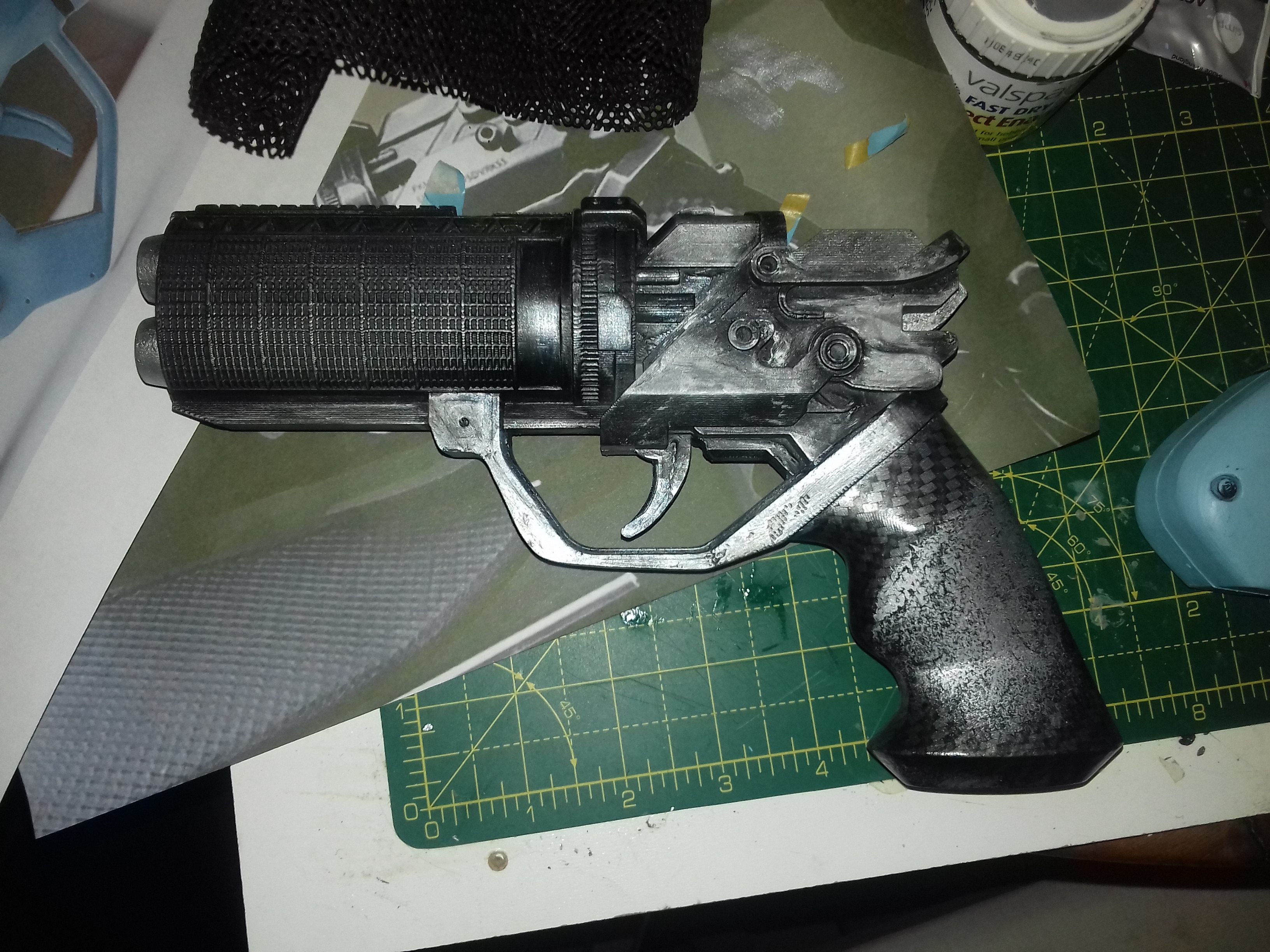

So then, after being gutted I couldn't take it with me when I went to see the Secret Cinema Bladerunner event, (which was amazing! btw) I decided to add to my collection with a couple of 3D printed models of Agent K and Luv's blasters. Still working on these -
Tried water transfer printing to get the carbon fibre look, but some of it dissolved when I did a topcoat.

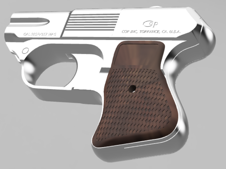

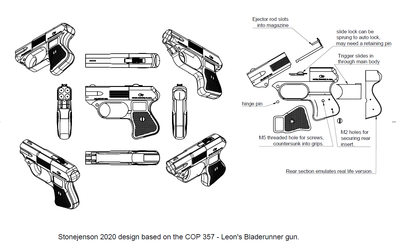

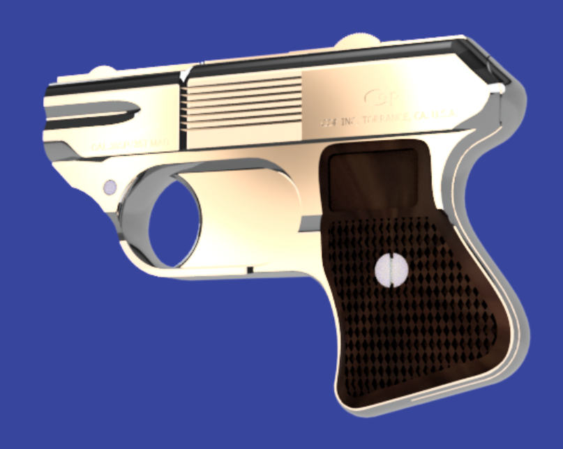

So I decided to design one myself in Fusion 360.
Getting the body curves right, and the complex curvature of the grips, with an as close to knurled texture as I can was hard work, but I'm pretty happy with the results. I'm going to get it organised for 3D printing, and it's more then just a body and grips. Yes the barrel will pivot, it has an ejector rod, sliding lock (which with a small spring and a pin will operate like the real thing. The trigger too could be sprung, and slides in through the back, where the rear section slots in, again kinda lije the real thing.
