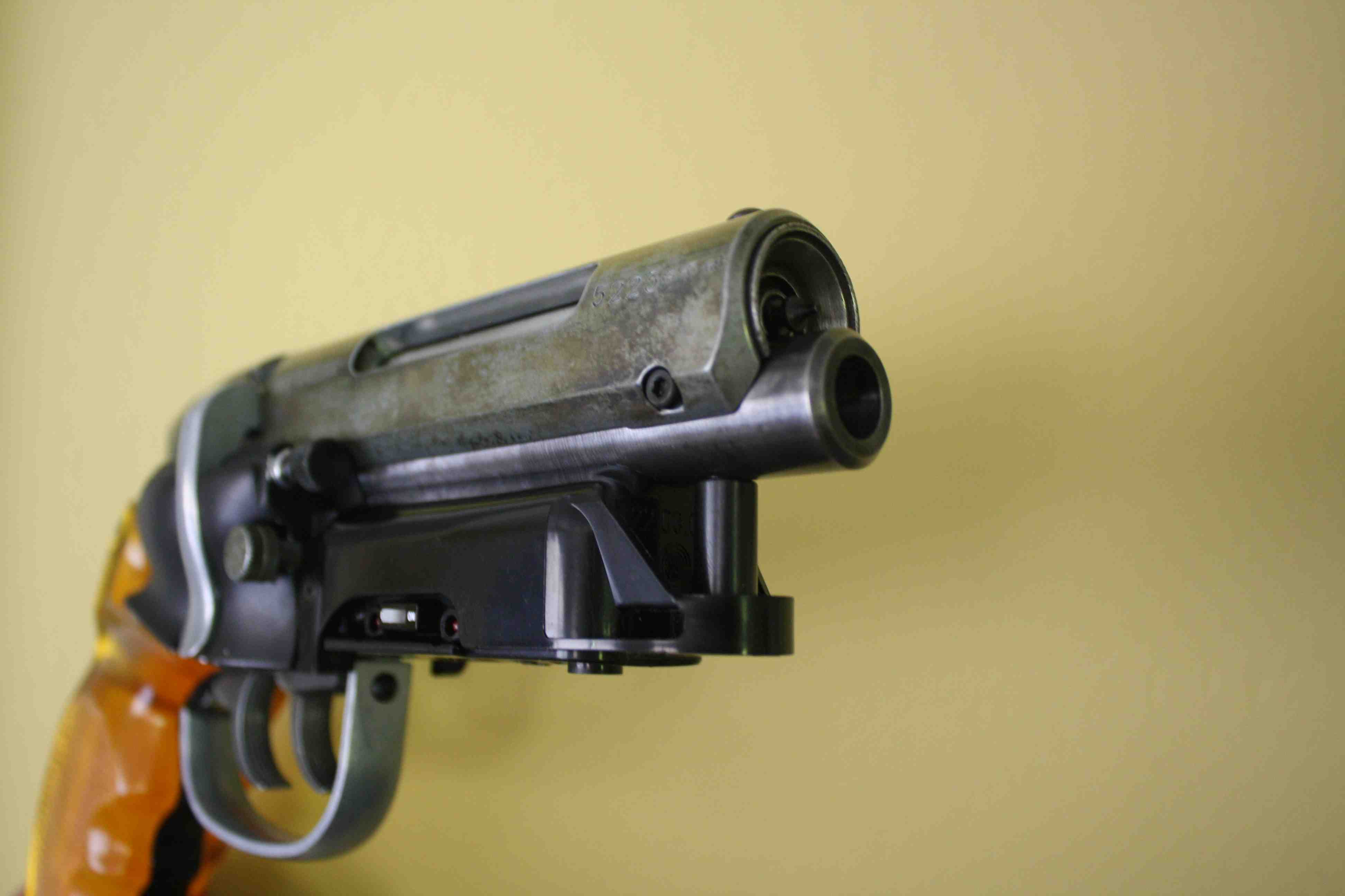

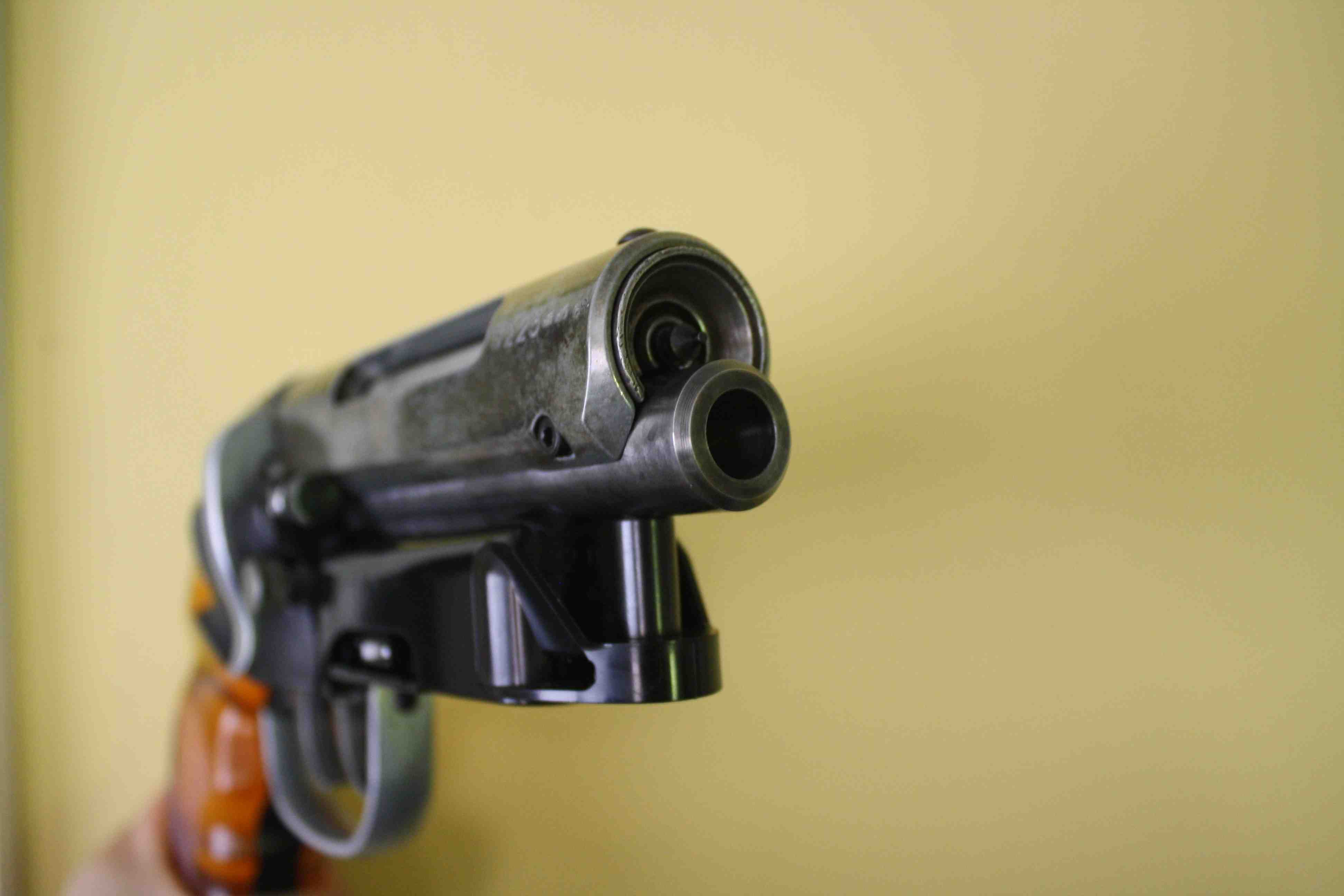

Dave's steel Barrel was a perfect fit!

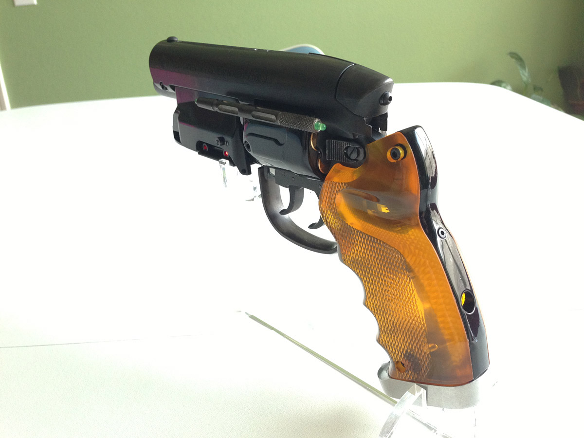

Just finished mine!
Still need to wet sand the paint to give it a mirror finish but aside from that, it's all done. Easier than I expected but still ran into a similar issue where the tiny thumb release pin flew out and I spend 15 minutes trying to find it on the ground
I opted to blue the metal parts then steel wool'd most of if off. I like the semi 2 tone look of the world con so I was going for that
