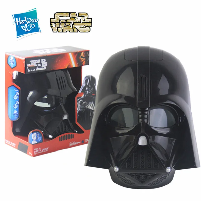

Hasbro has made THIS:
Kylo-ren-Mask-Voice-changer-Mask-Roleplay-Star-Wars-The-Force-Awakens-Darth-Vader-Helmets-Stormtrooper.jpg
and still used that sculpt for the Black series helmet. Im still confused why they went that direction.

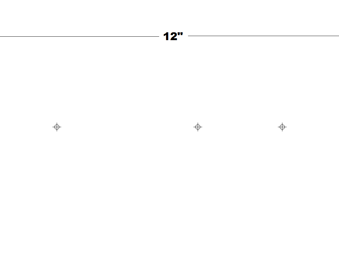

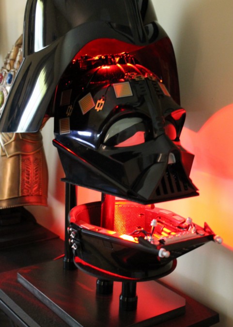

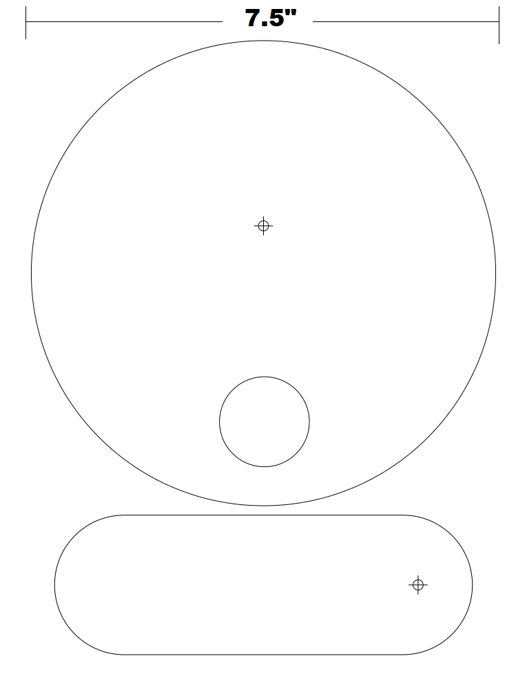

Here's what I did for a stand:
I'm not planning on modding much on the exterior, accepting that as is. Do plan on working a bit on the interior, add to the details a some. Other things take priority right now, but didn't want it in the closet and forgotten.
Did a MDF base (on top of foam), used black 3/4" PVC pipe/caps, and cut hardboard to shape for each piece.

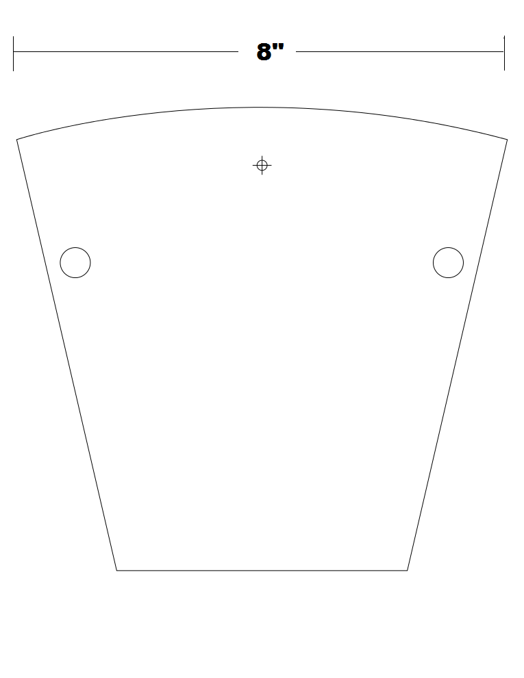

Here's the templates I made if anyone wants to do similar (single measurement is for scale, should be able to print them 1:1 and it be correctly sized):
Base:
Face:
Neck & Dome:
The PVC was cut to the following lengths:
Neck: 3.5"
Face: 9"
Dome: 22.5"
Looks great :thumbsup I plan on doing something similar for mine so the templates will come in useful. Is that a Marvel Legends Infinity Gauntlet in the background as well I see?
Thanks. I figured they could provide a jumping off point for some folks. I still plan on doing a bit more to the base of the stand, just not sure what yet.
Yep, that's a gauntlet I got and refinished a couple of weeks ago. https://www.therpf.com/showthread.php?t=282510&page=7&p=4439220&viewfull=1#post4439220

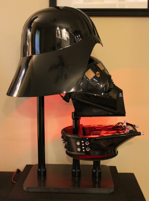

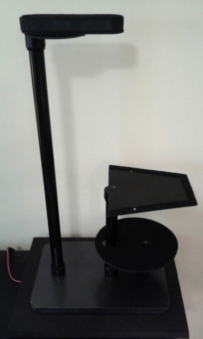

Thanks for sharing. This looks great. Would you mind sharing a pic of the stand without the helmet?
Sure, here it is without the helmet:
The dome and face part on mine looks odd because my initial estimates were slightly off. Had to add height for the dome (why it's thick) and extend the plate for the face (why the back end is barely catching on the PVC cap. I adjusted these for the templates.
Also, forgot to mention, painted the hardboard black after cutting, and then used adhesive backed felt for the parts to sit on. Not really to protect the helmet, but to keep the paint from lifting when removing the helmet off.
That is great! I wish i could pull that off, but I don't have the right tools. Darn it. Wish I could buy one like that.
I cut the pieces with a laser, but hardboard can be scored and snapped. You can slightly adjust the shapes (straight edges where rounded). It needs to be scored more and doesn't give a clean edge like say acrylic, but the rough edges can be sanded. The PVC can be cut with almost any type saw (since the ends go into caps, they don't have to be perfect). The only other thing needed is a drill and something to cut the MDF (if that's what you wanted to use for the base, but could use several different materials).
Thanks for the tips and insights and photo. Very helpful.
