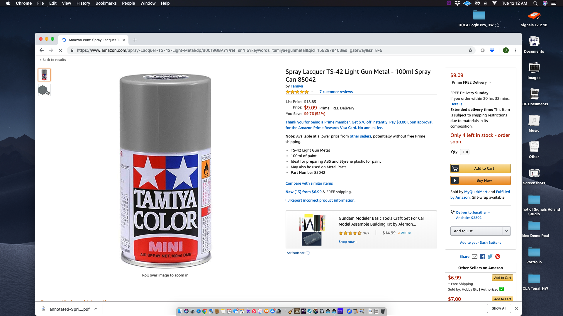

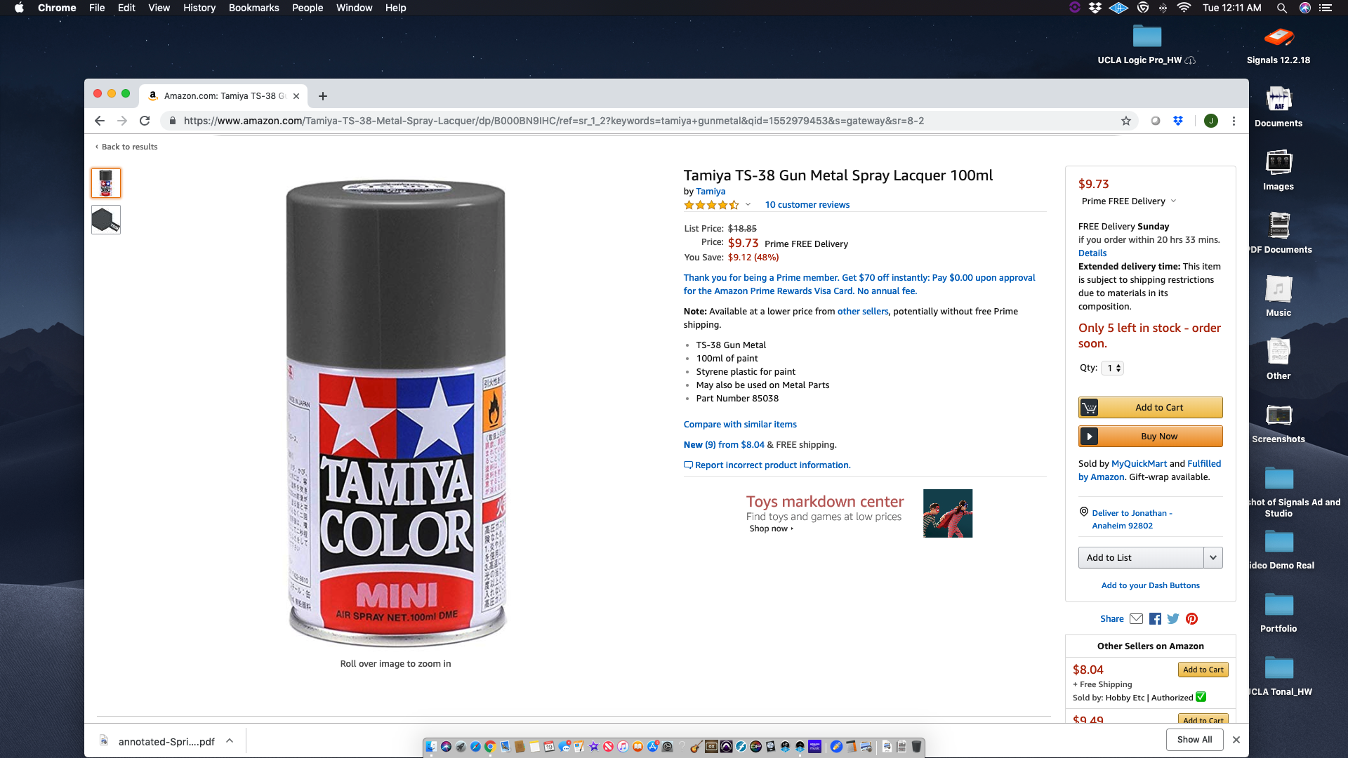

I just ordered metal mesh for the grill and am going to order the red lenses tomorrow. As far as paint goes, what are you thoughts on these? (The darker for the face mask and the lighter for the cheek)

The two colours should be black and gunmetal. There seems to be a debate over how dark the gunmetal should be though - some folk prefer to replicate the colour on the actual prop (lighter), whereas others prefer it to replicate the on-screen look (darker). I'm firmly in the latter camp and so I used a dark gunmetal so you don't immediately notice that the helmet is not all black - it was decades before I realised Vader had a 2-tone colour scheme after all!
I used car paints for mine. The exact colours were Gloss Black and Ford Graphite Grey for the gunmetal panels. I tested Tamiya Gun Metal and found it a bit light for my taste. I also found the car paint to be much more durable.

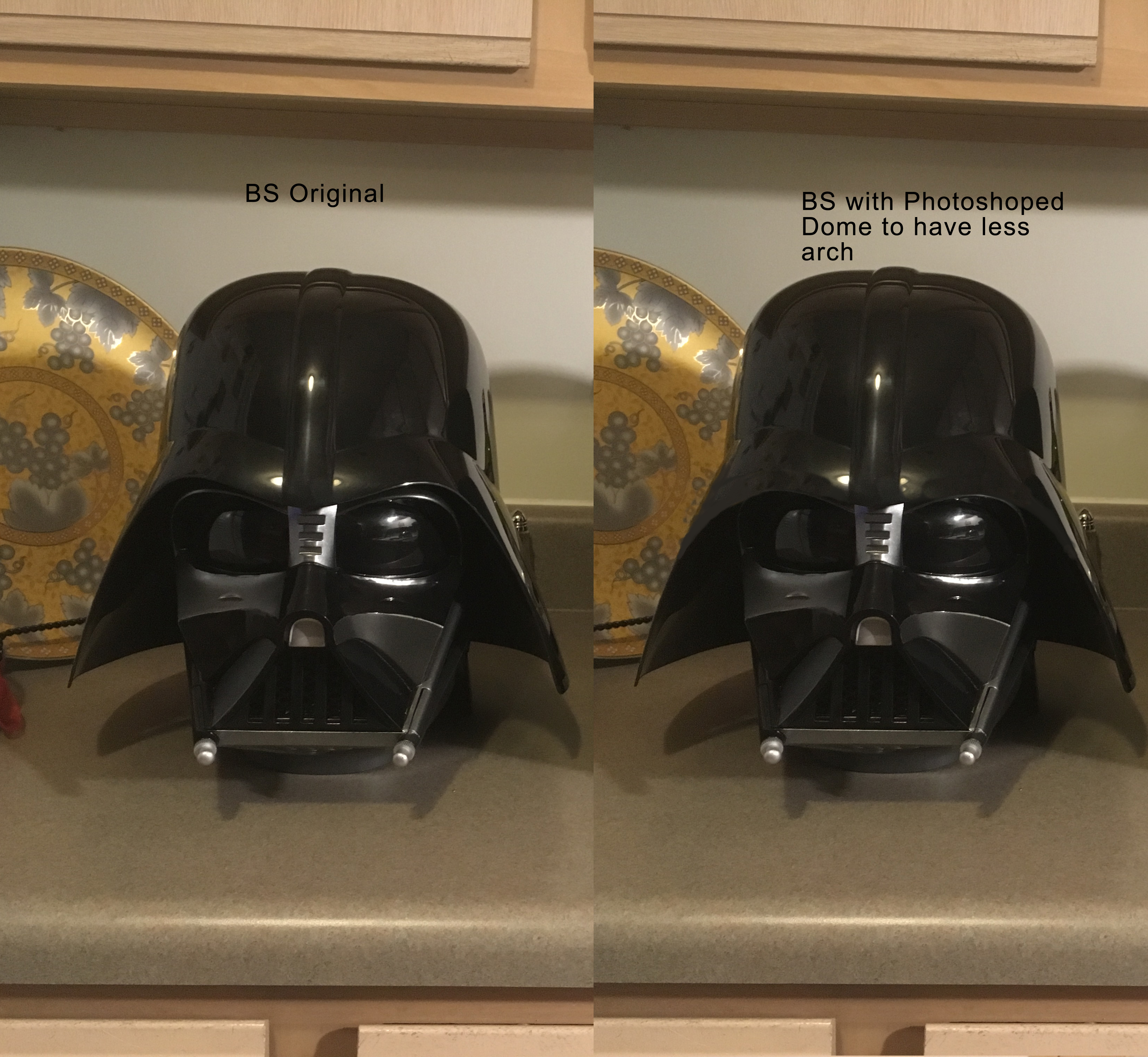

I wonder, are you going to fix the cheeks? Like in addition to the left cheek needing to be curved up, both cheeks look pretty sunken. And are your going to do something with the eye shape? And possibly the sides of the mouth? And lastly would you do something with the round part of the dome it looks kinda short and weird. If you would do all that it would make a huge difference!
In a word...no! This thing is never going to be anywhere near accurate to the film prop. If you tried to modify all that then you'd have nothing left of the original helmet and would be better off starting with something else. I'm just making it look a more acceptable and a bit more in proportion - hence the lengthened neck. For me, it's a man-cave ornament (and a very nice one now) that's all.:)

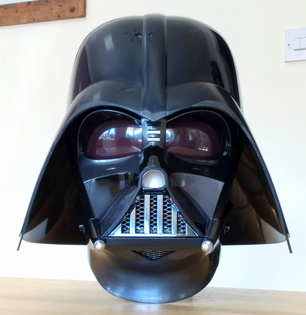

Been working on my dome 'skirt' extension. The first stage, adding the extra plastic, is done. Got lots of filling, smoothing, sanding, shaping etc. to do now.
This is a bad photo taken in poor light but it gives an impression of the overall helmet with the longer skirt,
Honestly This thing is looking amazing! I mean the skirt extension makes it look do much better! It's amazing that a small detail like that would change the look tremendously.
Thank you frogfreak and you're right, the longer skirt does transform the dome in the same way the longer neck transformed the mask. I suspect Hasbro made them as small as they could get away with without completely ruining the look. As you quite correctly mentioned in your previous post the top of the dome is a little squat. It does look better in real life than in photos though - I suspect most are taken on phones which have quite a wide angle lens and so distort things. Oddly enough the short dome doesn't seem so noticeable with the longer skirt added. I was afraid it would make it look worse but that doesn't seem to be the case IMO.
