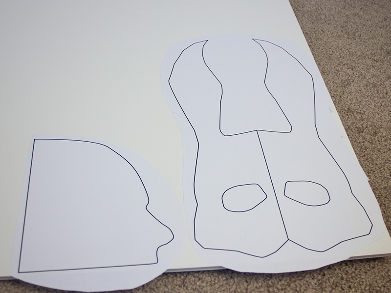

I first started in illustrator using some references from the game and pictures of my face to scale the dimensions of the mask, then printed them out and spray adhesive them to foam core.

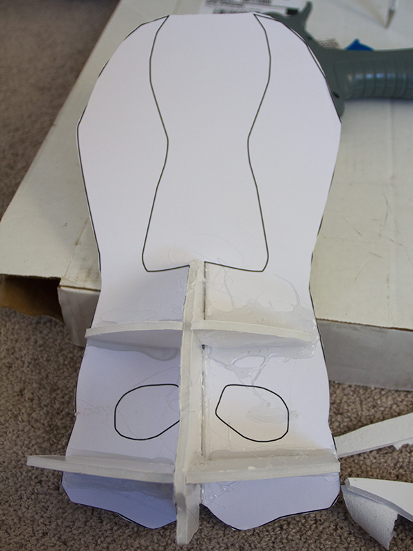

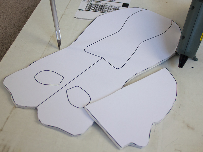

I then cut those out and hot glued them together to make a form.

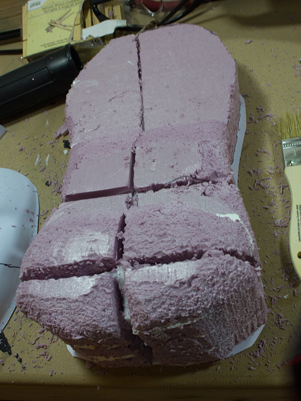

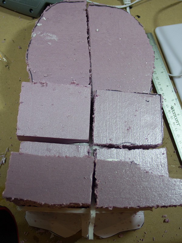

I then filled it up with some insulation foam and started sculpting it into shape.
My next steps as far as I know so far will be to continue
sculpt
bondo it up
then add Epoxy Sculpt to add detail
Silicon mold and master mold it,
Then slush cast it...
But as I am not feel super confident on what i have so far I might abandon it and start over with pepakura.
Any thoughts or suggestions are welcome.
