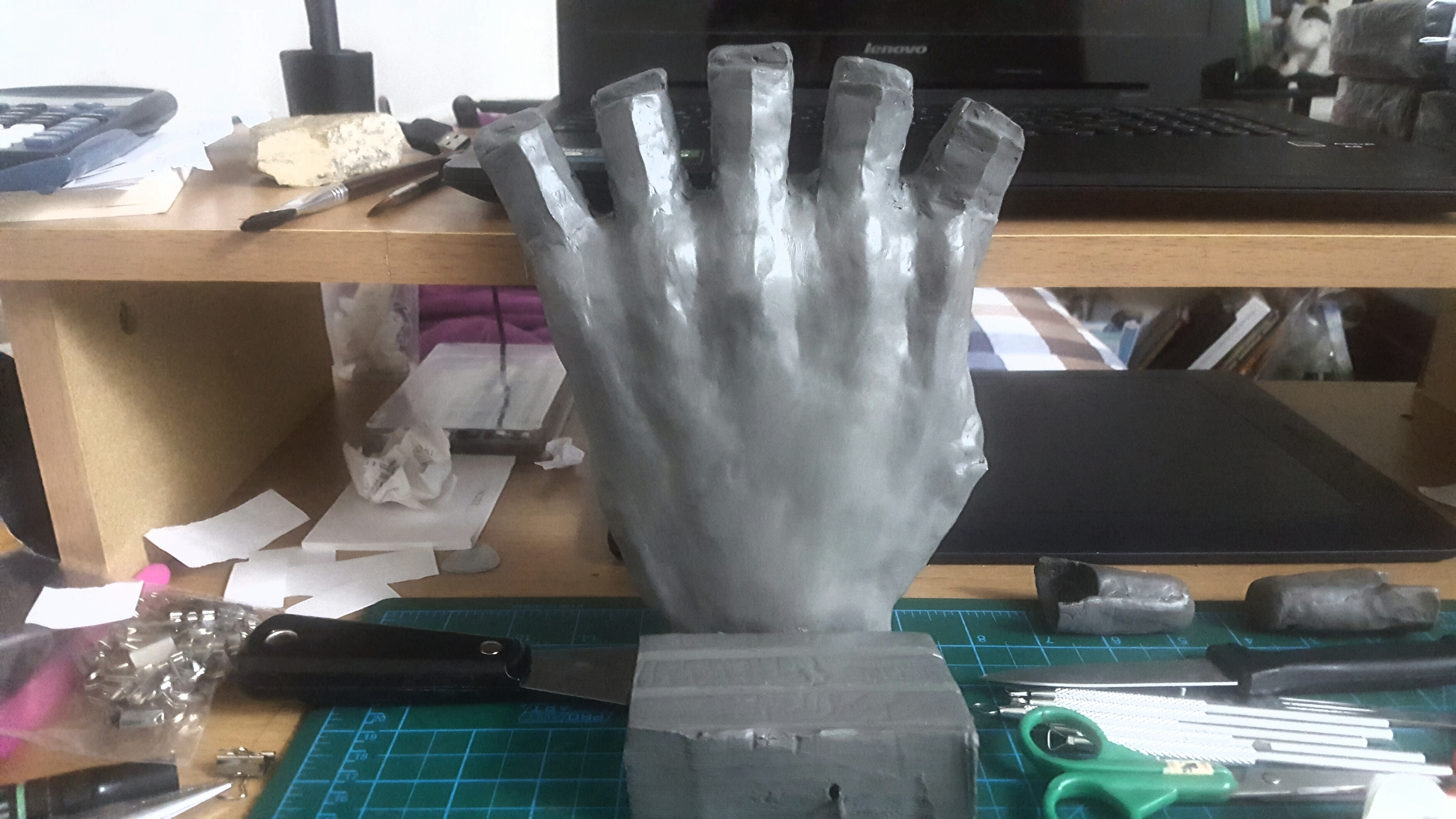

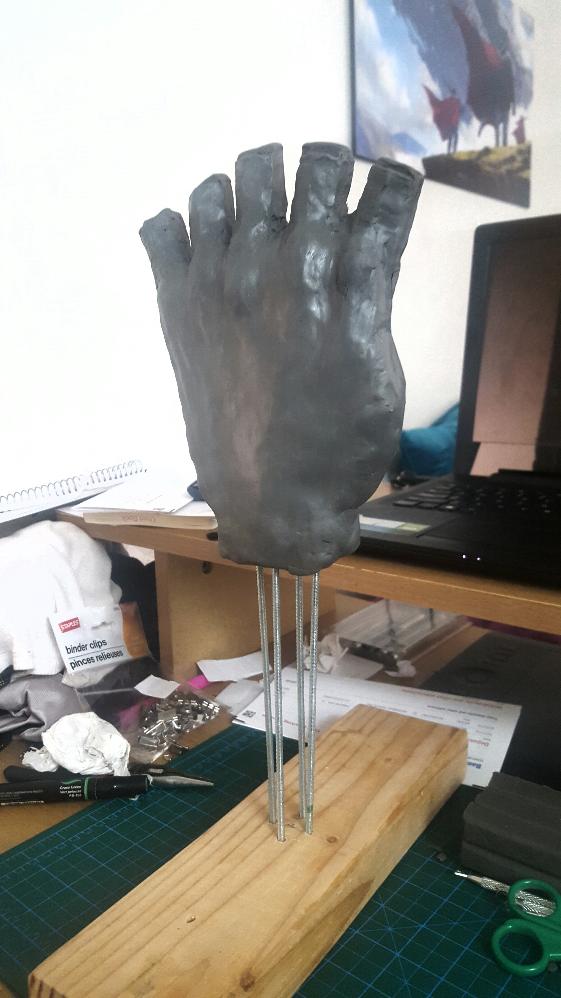

So I've started a build of Billy's sentient gauntlet in Adventure Time, scaled to fit Finn's hand, not Billy's as shown here. Here are my initial clay sculpts.

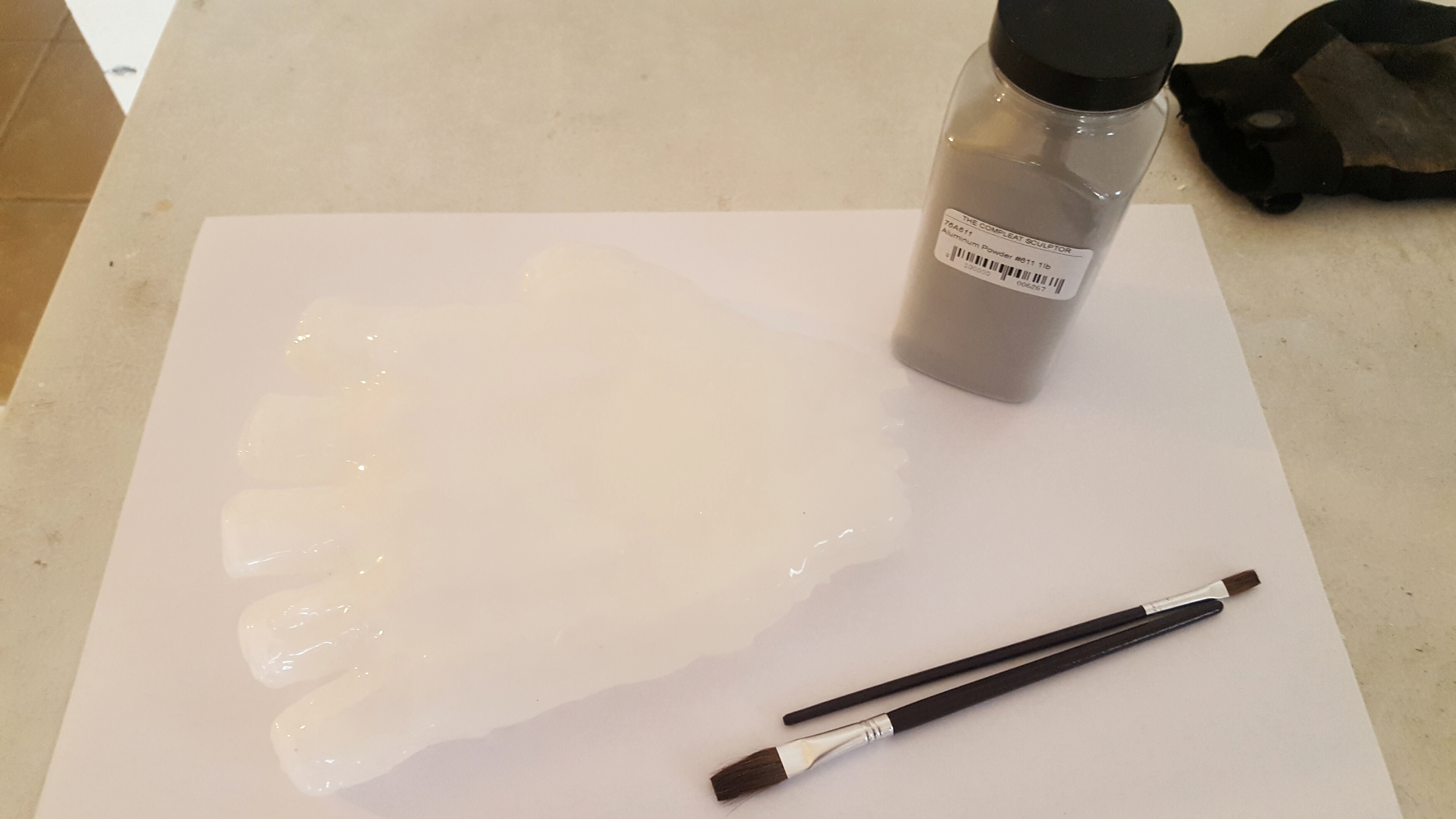

I was an idiot and forgot to take pictures of me brushing on the silicone onto my clay sculpt, but by now I've created a fiberglass mothermold.
This is me getting ready to brush on aluminum powder into my silicone mold, which I kept colorless so I could see the aluminum powder better. I will be performing a combination of cold casting+rotocasting with the gauntlet's center piece, and right now I'm making sure I get it right. Since the mold is so deep and a 1-part mold, I need to do a lot of planning before I begin pouring in my urethane. I chose Smooth-On's Onyx Slow, since I'm almost guaranteed to require a long work time with such a deep cold cast.
Any advice on how to proceed would be appreciated!
