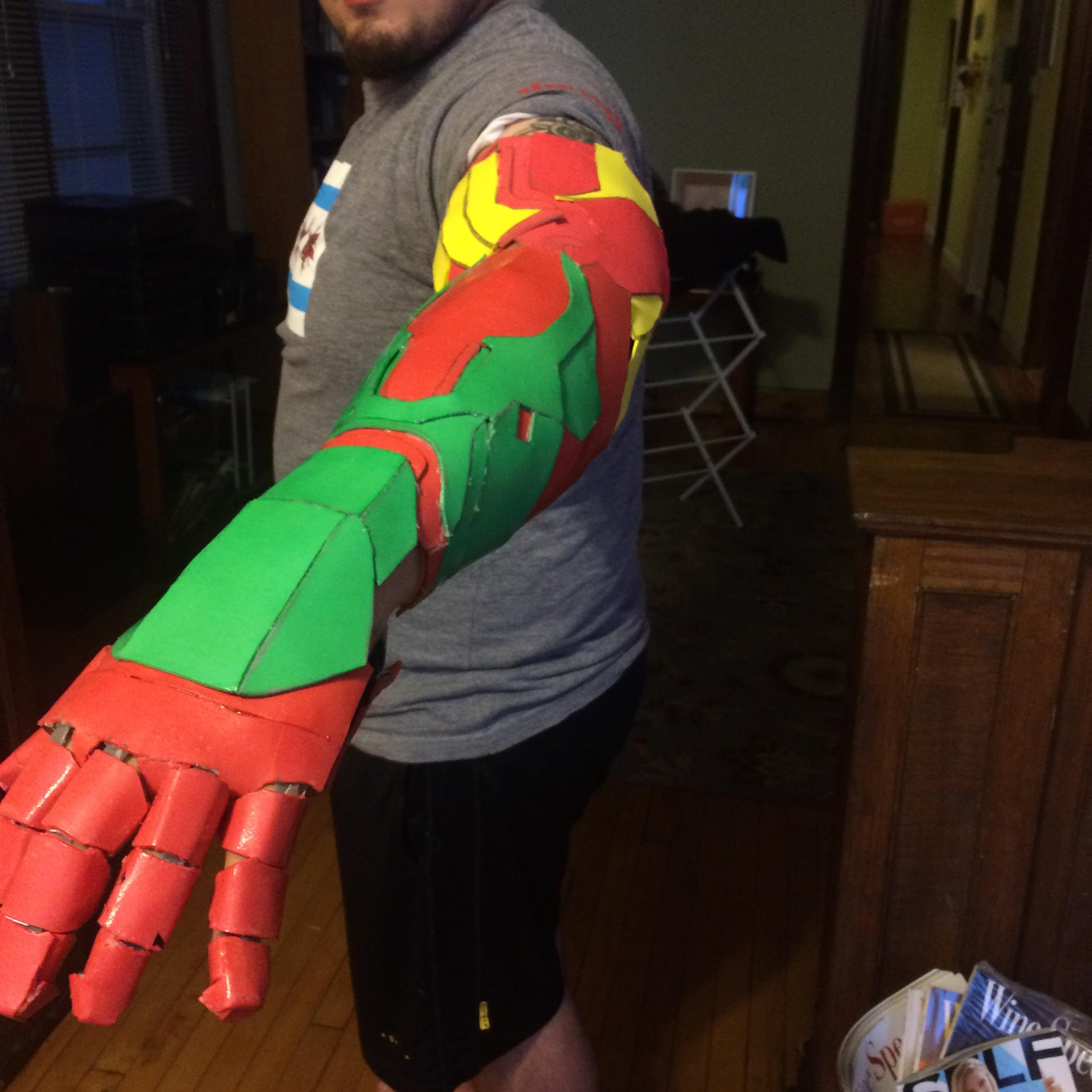

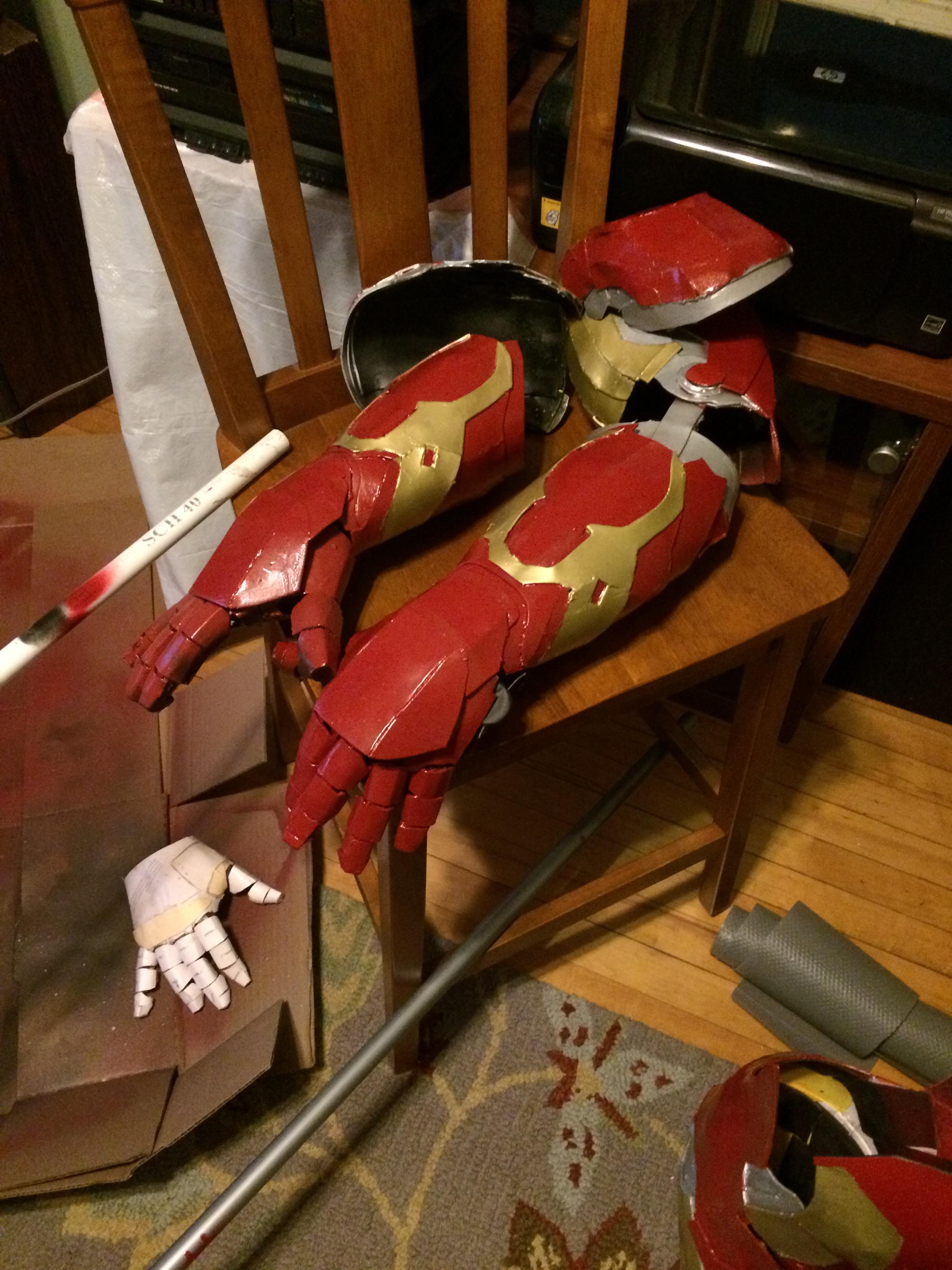

Anyway, back in May of 2015, I started building my Mark 43 suit from Age of Ultron.
I want to thank Helagak and all that have contributed to his files, I used those as well as free handed some stuff.
Before I began, I didn't think that it would be too difficult, but I was wrong. This is actually my first build ever and I just happened to choose one of the harder models to build.
Anyway, I have been working on this on and off for the last few months.
For Wizard World Chicago in August, I had the hands, forearms, biceps, shoulders, boots and shins done. I was going for an Ironman 3 Tony dungeon escape look.
Then I took time off for life, and once more, I began work on the chest, neck and back and then, more time off.

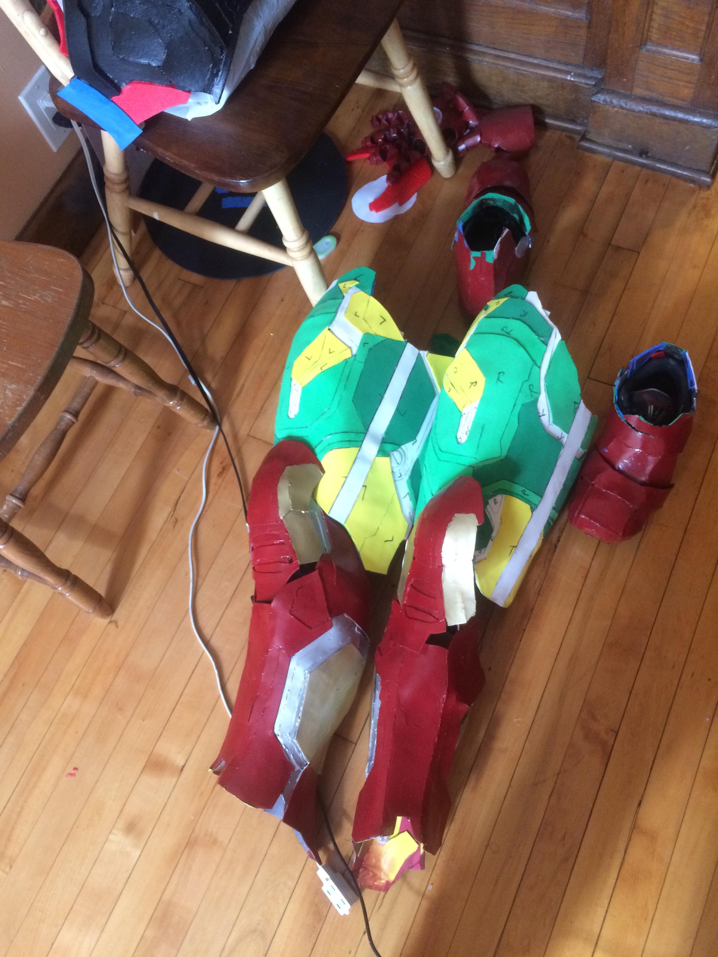

Come January, I wanted to have the full thing ready for C2E2 in March, so I started working on the thighs, cod and abs. I got the thighs done, but rookie mistake, they didn't fit very well, rookie mistake number 2, I didn't want to fully remake them so I cut and pasted some extra foam in each to make them a bit wider.
Then, from here on out, this became a speed build. I got all of the main features of the abs and cod cut, and I decided to free hand the rest and build it into all one piece, another rookie mistake, I didn't cut an opening in this, I made it wide enough to slide on.

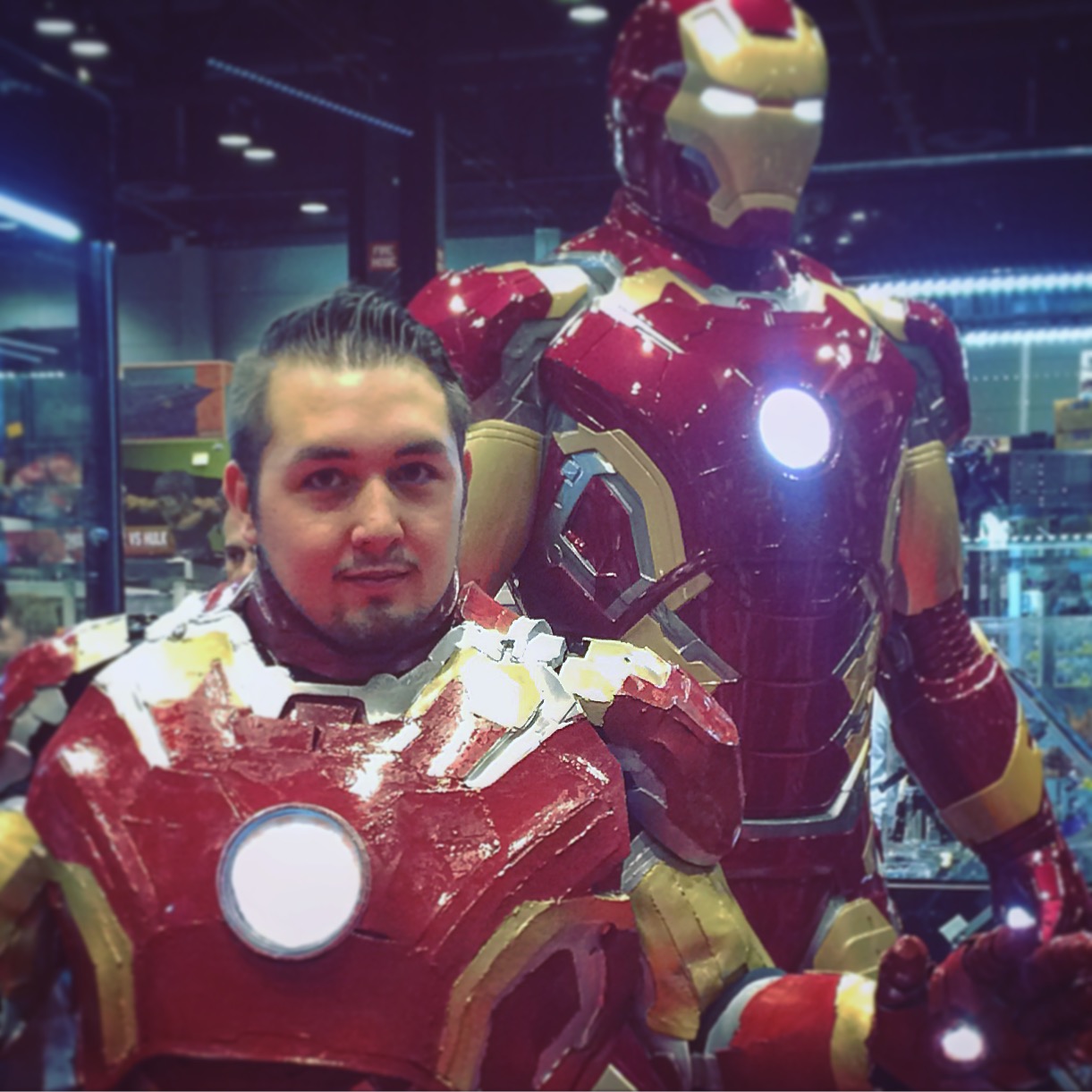

I finally finished, wore it at the con, I realize now some issues that I had, but I would call it a success.
Things I would change:

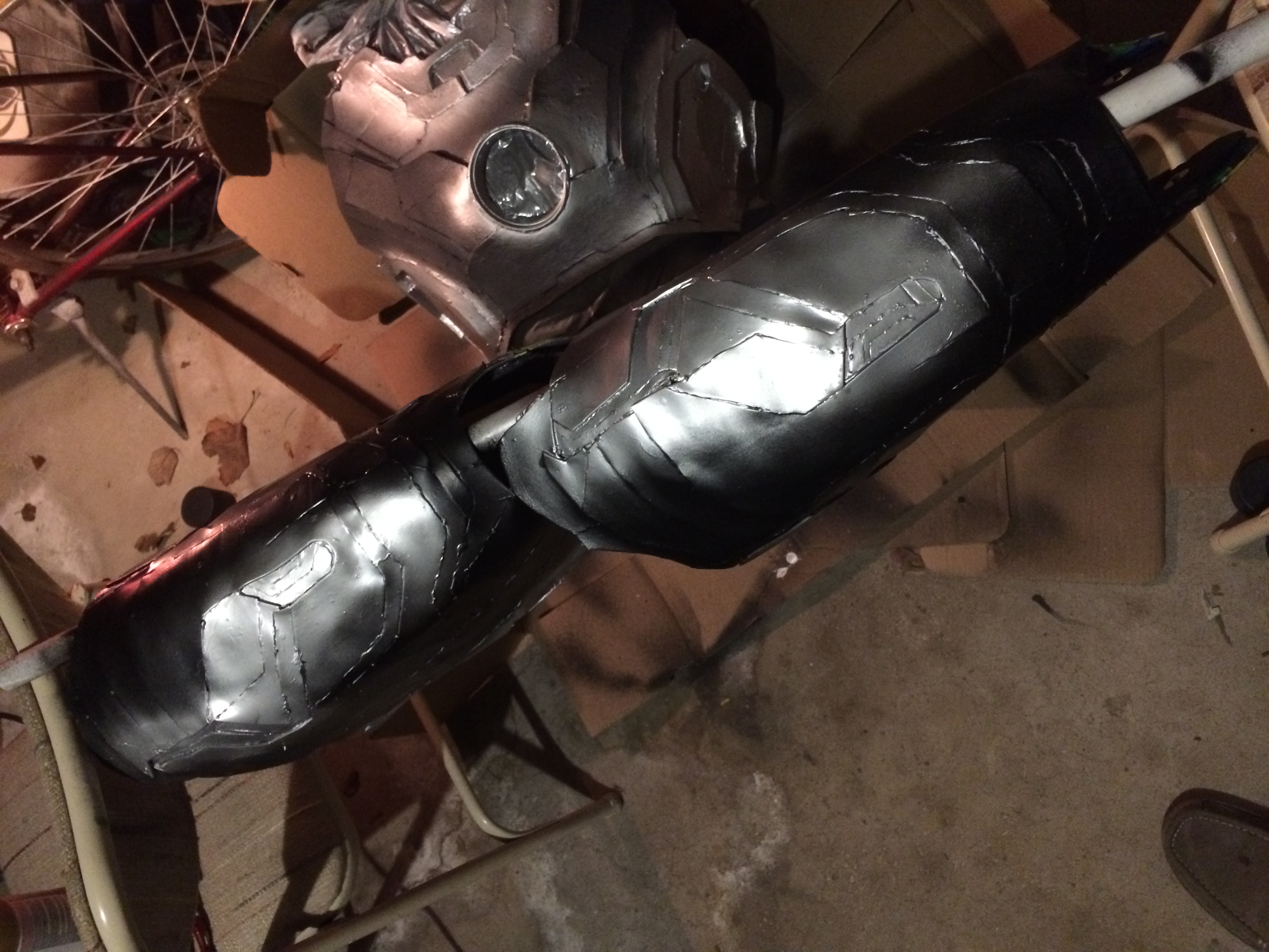

  • Make the straps for the thighs shorter, the thighs were sitting too low and basically engulfing the shins. This also caused my magnetic knee joint to not function.
  • I would make the abs/cod able to open from the side or sides for easy access and also, so it could be tighter.
  • I would make "suspenders" for the abs to keep them up, especially since they are supporting the legs.
  • I would add cloth to the inside of the neck, it started to chafe after a while.

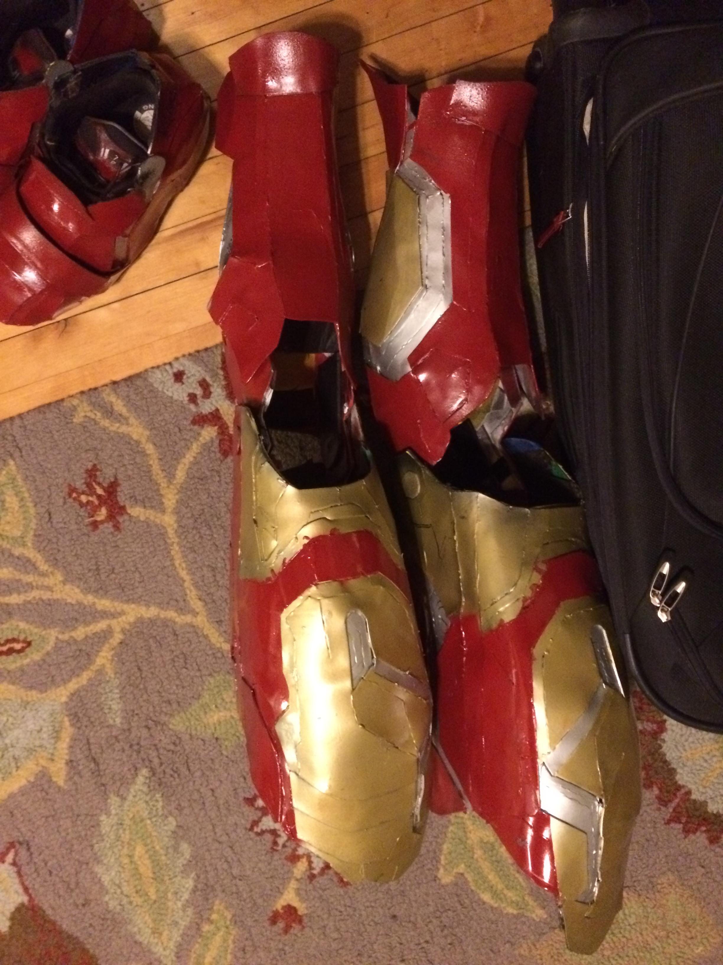

  • I would remake the boots so that they could open up, letting me tie the shoes hidden inside, my feet slid around too much and that was putting pressure on my ankles.

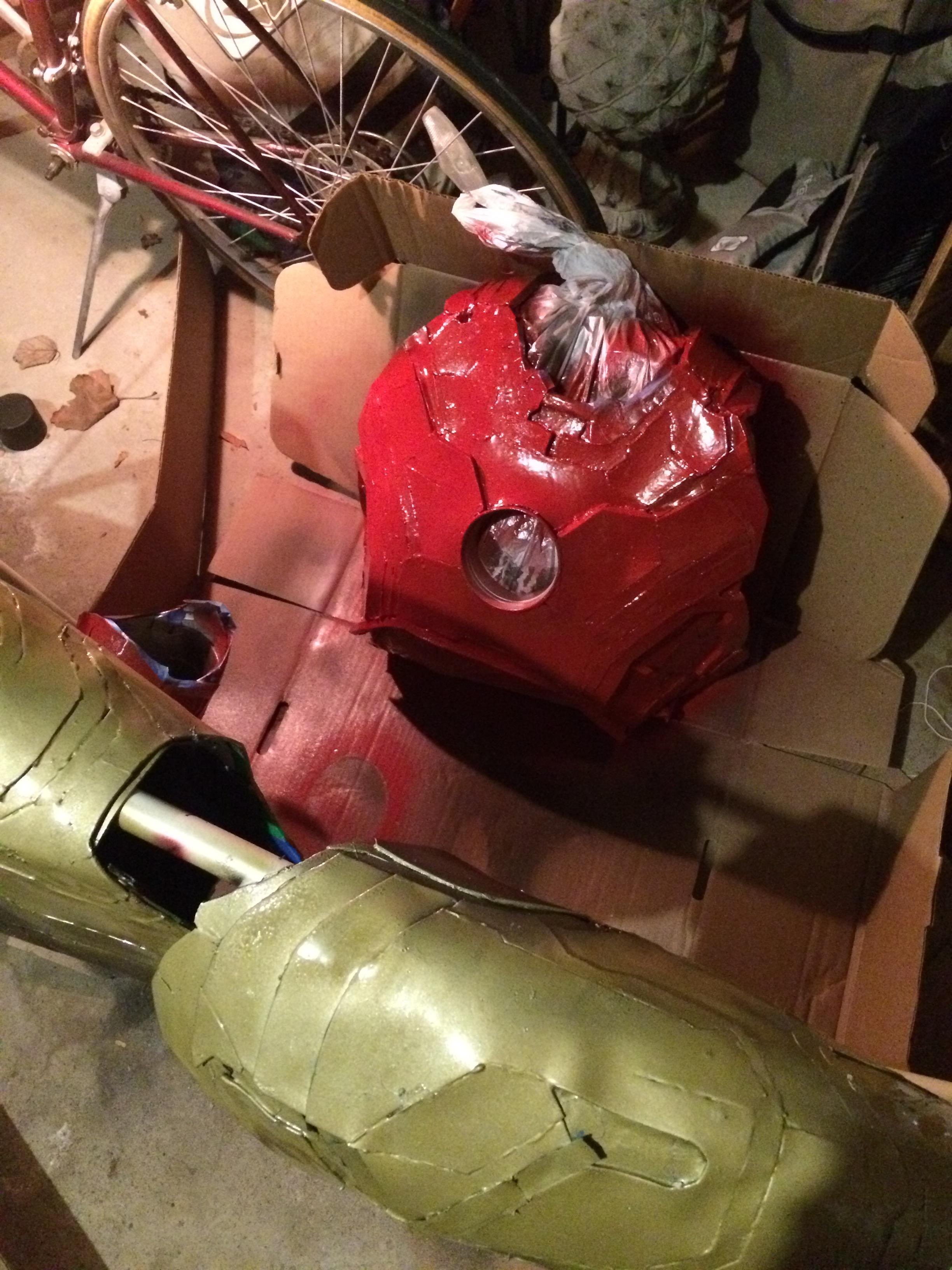

  • First of all, I would definitely use thicker foam, I used foamies for everything but the chest. The chest was a coleman rolled work mat. I think I would rather go with thinner puzzle mats next time.
  • For the repulsors, I used Energizer Magnetic Lights. I would like to try something different, like disassembling a tap light.
  • I would make and wear a helmet, it just wasn't ready in time.
Let me know what you think
