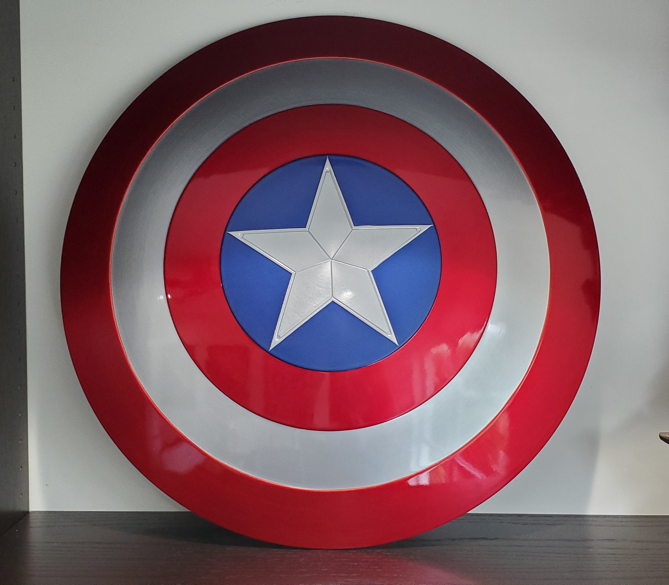

Here is the Cattoys ABS one. Which despite certain flaws looks great ratio wise, and the center on that one is about 9 1/4 inches on a 23.5 inch shield.

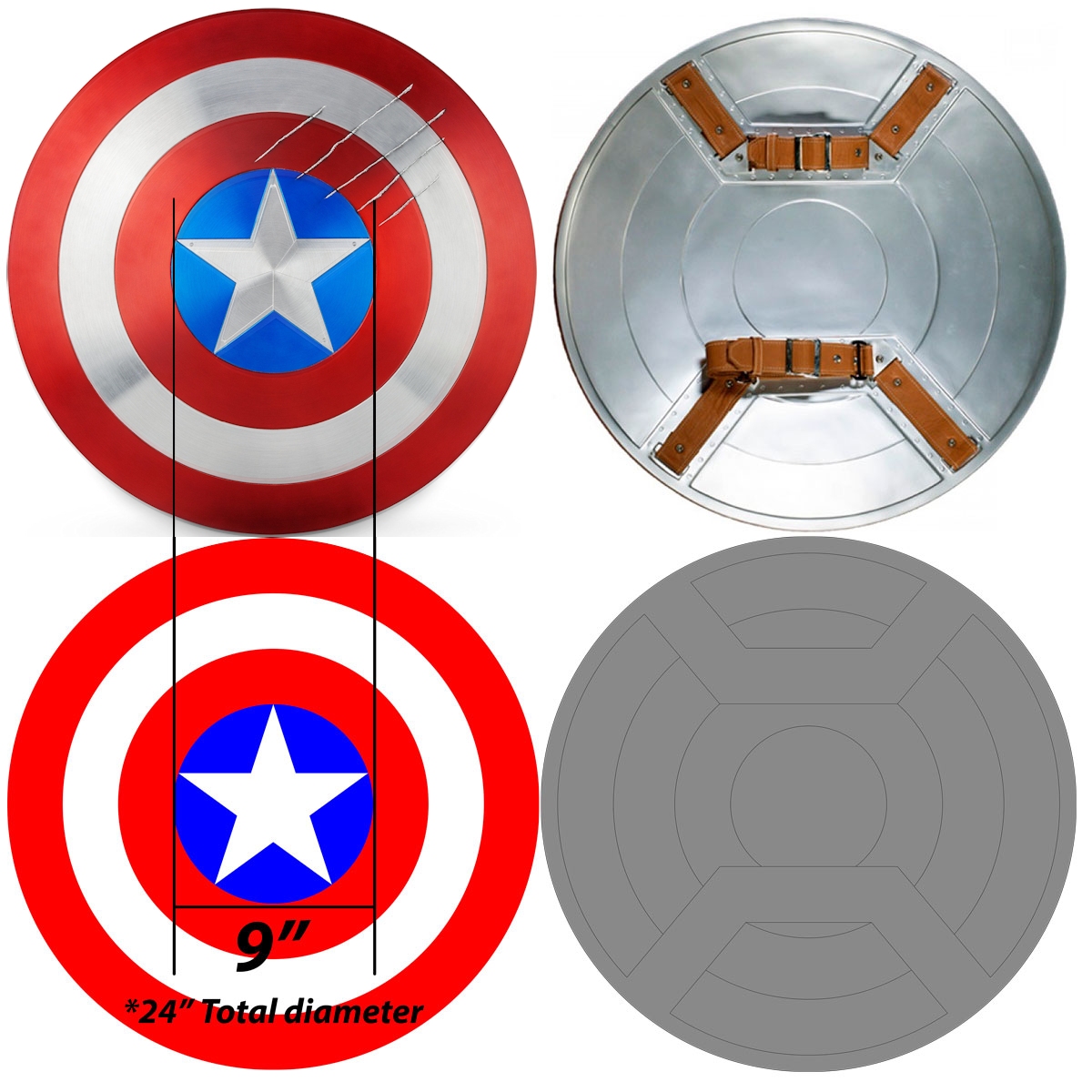

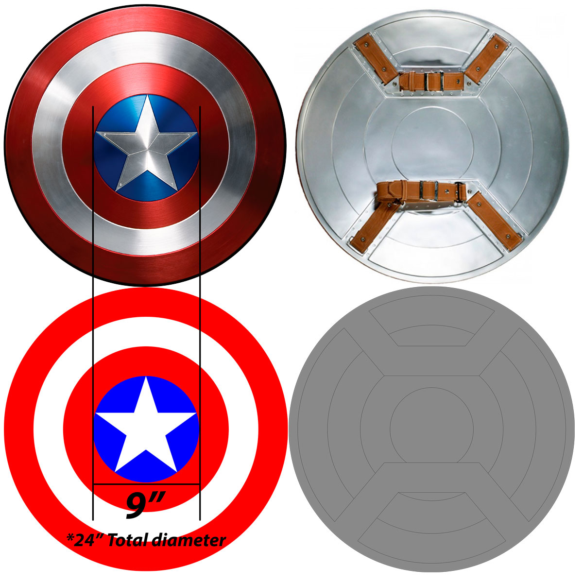

Whipped this up a while back but thought I'd post it here since we're talking about it. If I were a designer or fabricator I wouldn't measure proportions as percentages as opposed to real measurements as seen here.
So my 2 cents on the hero proportions are a 9 inch star disc in a 24" total diameter, with the rings equal width based on the remaining diameter not taken up by the star disc. Made the vectors in illustrator and the measurements/proportions do work out based on the references

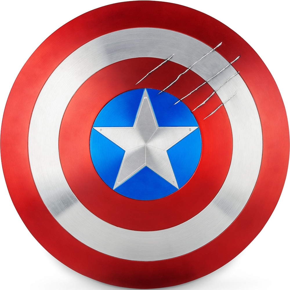

Here is what I am going off of: This dead on shot from the Marvel Masterworks shield. I cropped it to within a 1 pixel edge on all sides and resized it to 1000 pixels. When I do that the blue area, both side to side and up to down (confirming there is no distortion in the image) equals exactly 385 pixels (38.5% diameter for the blue portion). On a 24 inch shield. giving or taking a pixel, that works out to be EXACTLY 9 1/4 inches
Also, your proportions example is inaccurate because you actually have a thick black pixel ring around the top shield which is not part of the actual shield, making the blue part represent smaller in your bottom image as a result.. I took the Masterworks one and overlaid it to be the exact same size as your bottom and top one to remove the black ring distortion, and you can see that the blue portion is slightly larger than the 9 inches, hence 9 1/4.

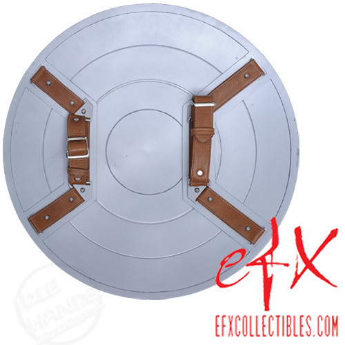

I think we should try to get in contact with someone who has an eFX (remember still casted off of production pieces) or a Masterworks and have them take measurements, because we're not taking into account any lens distortion caused by different focal lengths used to photograph these references.
See here, the outer silhouette doesn't change much but the inner proportions differ greatly:
That’s a stunt shield. Different to hero shield. For starters it’s a 24” Shield
And exactly- the shield is curved, iPhone lenses. There’s a lot at play
Yes it is a stunt shield but it has that gap on the second ring on the back that the hero prop has, which indicates it was casted off of the original, giving us a fairly accurate representation of the hero's proportions still

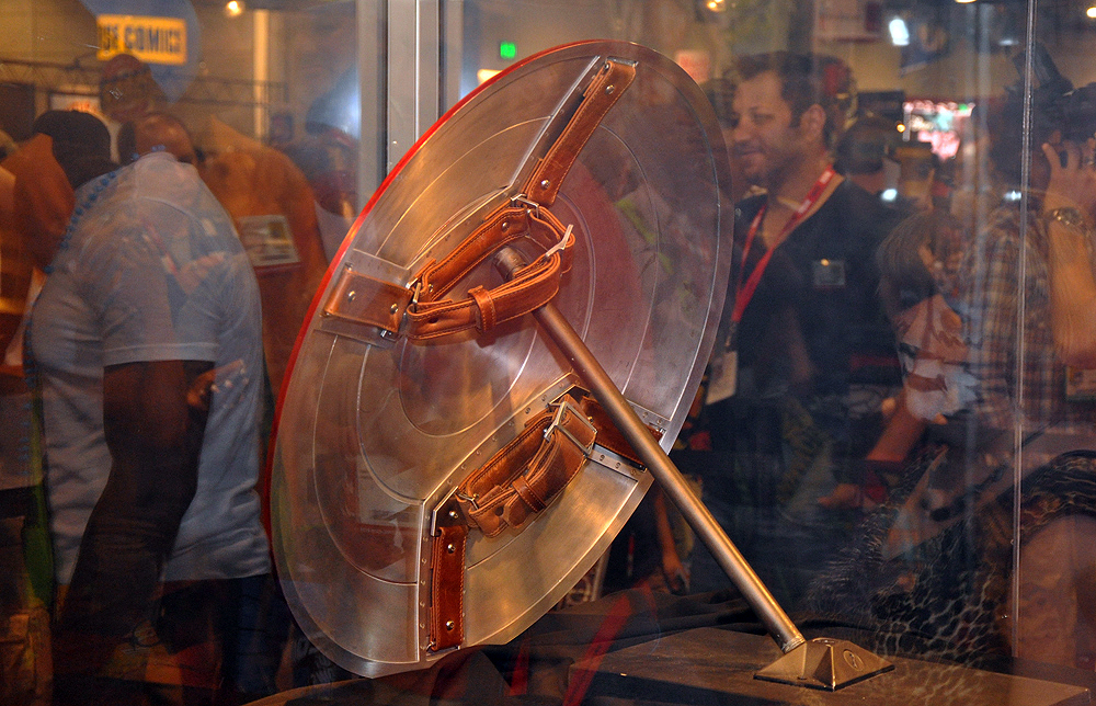

Watching the few unboxing videos on YouTube, you really notice the thickness of the edges. Almost all the replicas are way thinner, with the exception of the efx, King Arts and Beast Kingdom shields.
I'd like to propose that a potential definitive replica, which I will officially dub "The Ultimate Hero Shield" should definitely have the correct thickness. The key is first discovering how the original shield was manufactured so it can be reproduced exactky.
