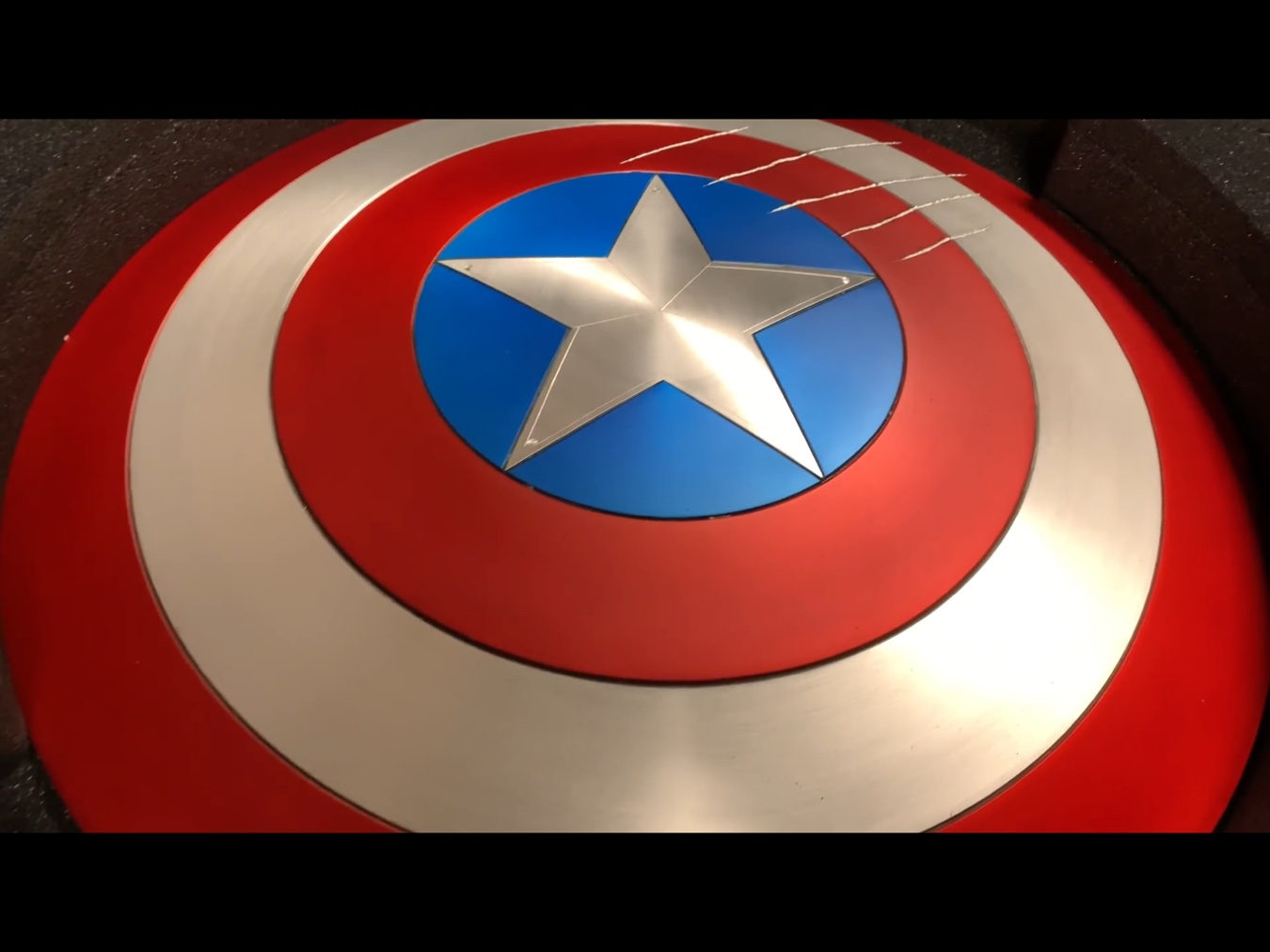

I'd be impressed if so. I think they were like $4,500. And of all versions, they went with the scratched one which made no sense to me.
Of all the possible variants: clean, weathered, battle damaged... Black Panther claw marks would be my last choice.
And the claw Mark's never existed on a physical shield, it was added digitally. Makes me think they did the claw Mark's so it could never be passed off as an original.
This is why it's so critical to make the only true Hero shield replica.
I've said this before, if the Masterworks edition was a normal version, I would of invested in one without question. The claw Mark's were that much of a deal killer for me and likey many other potential buyers as well considering the shield is still available to purchase!

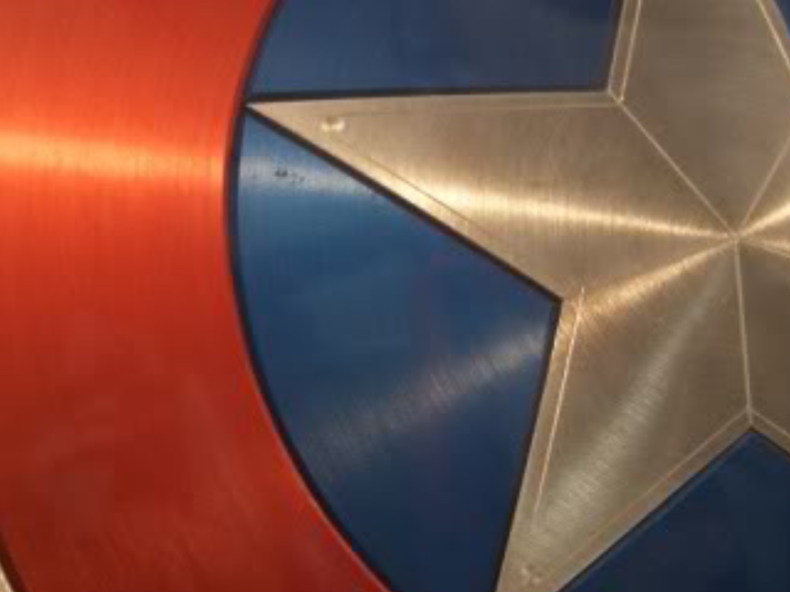

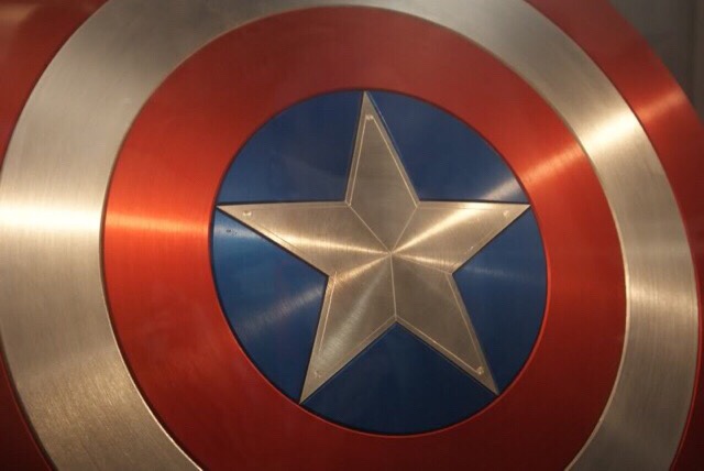

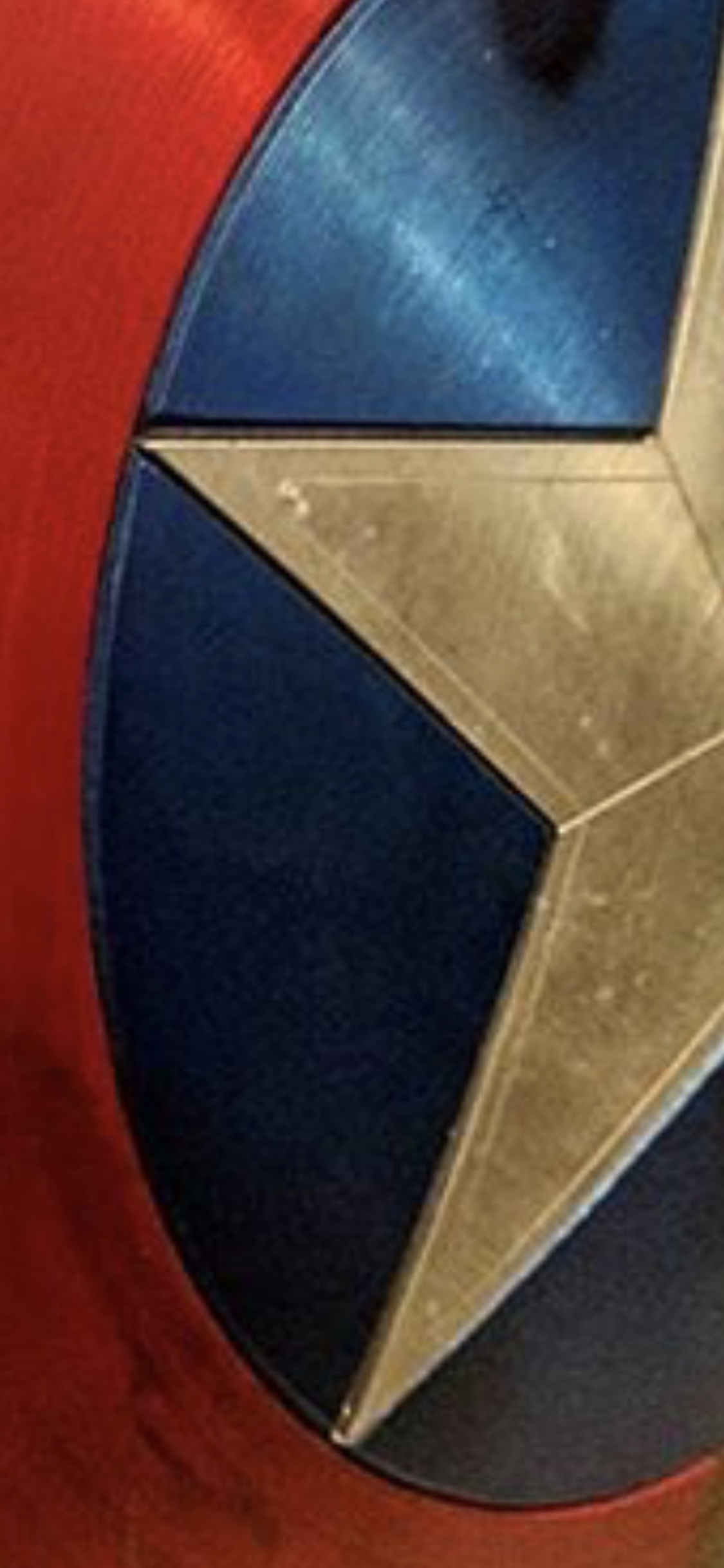

Here’s some close ups of the first avenger shield where you can see that the star is actually a separate piece to the shield that has been stuck into the machined out star section. (Not a raised section)
Yeah so counting the bracket & straps as one piece that could likely make the shield four pieces in total:
- Bracket
- Main body (red, silver rings)
- Blue disc plug with machined star-shaped recessed front
- Star
Plus some magic to make the edge seam look like the bracket and body are one piece

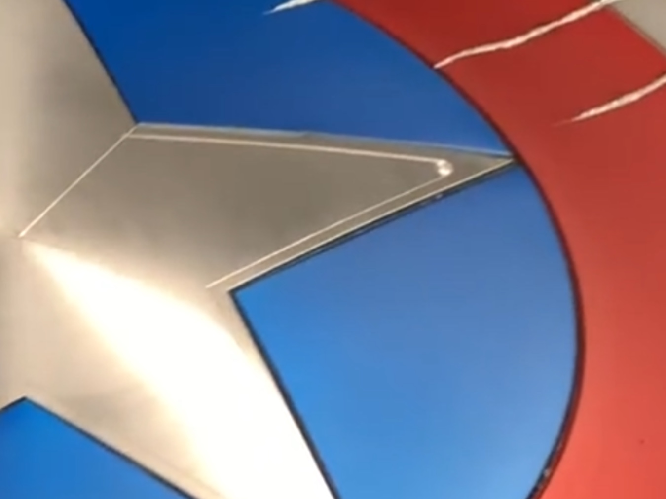

Looks to me that the masterworks is made the same way
You can see on that the right hand point of the star is slightly curved different to the shield. Also the star points don’t recess into the shield (which they would if it was just a machined outline)

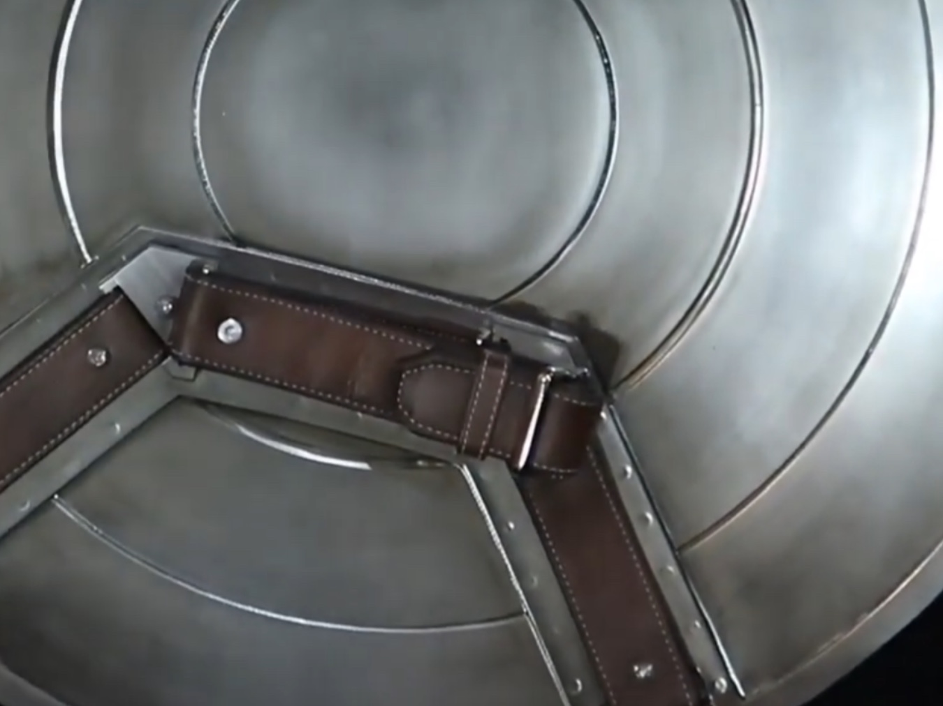

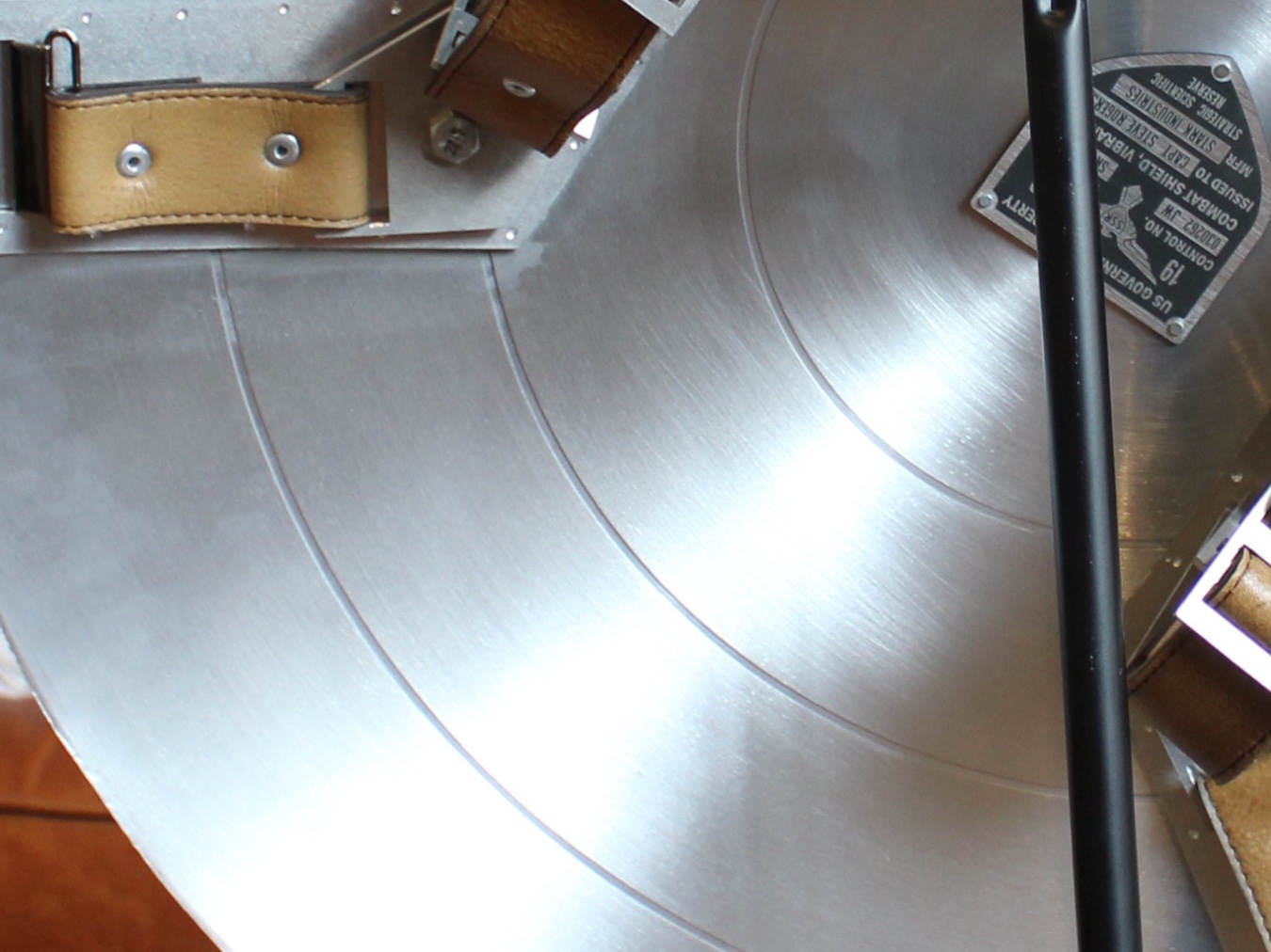

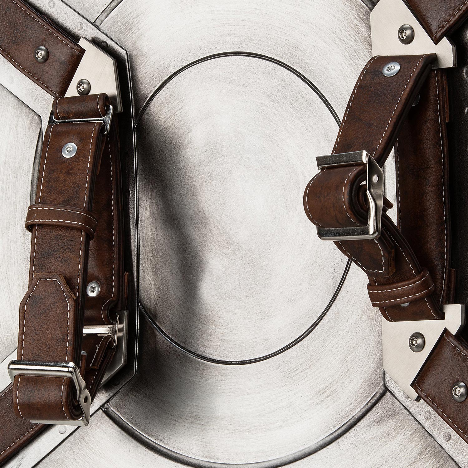

It looks like. To me the masterworks has a cast back. (like the king arts)
Not machined like the TFA shield-
Here’s a machined back- noticeably different
I mentioned this a page or two back, the back of the masterworks is definitely cast from the same hero that the eFX shield is cast from (or rather, the same hero that the stunt was cast from and then that stunt was used by eFX?) based on that gap in the second ring
I mentioned this a page or two back, the back of the masterworks is definitely cast from the same hero that the eFX shield is cast from, based on that gap in the second ring
