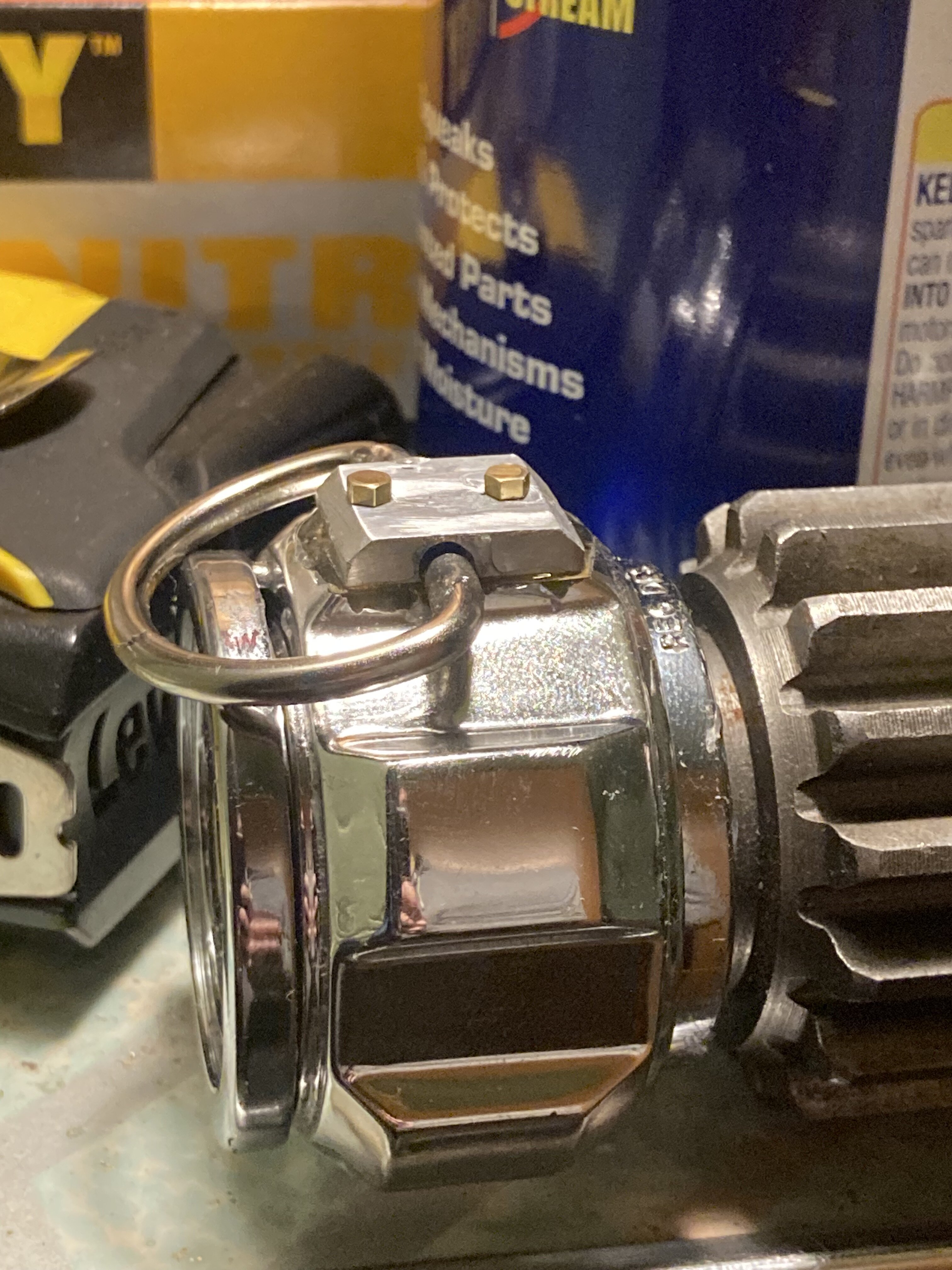

Remember this sink knob? I just used it on a custom saber and made my own "repair" for this cube break. The plastic was a little too soft to tap reliably, so I used glue. I used a belt sander to flatten the cube and drilled a piece of aluminum for the D ring. I then used the same belt sander to thin the aluminum so the D ring hole was only 2/3 in the aluminum and 1/3 in the plastic.
The little hex screws are essentially glue pins I guess, but it doesn't look half bad. This was re-chromed by a shop out west. Originally they were yellow bidet taps with chrome shoulders, and i sent the rings somewhere to do it for cheap.

Granted, my hand made pommels are virtually worthless, but that's why I don't drill all the way through the cube to mount the D-ring. I usually just put a "dimple" on either side of the cube and cut out the center of the ring. Not entirely accurate, but far less risky.

I really like this fix. Very true to the sw world
