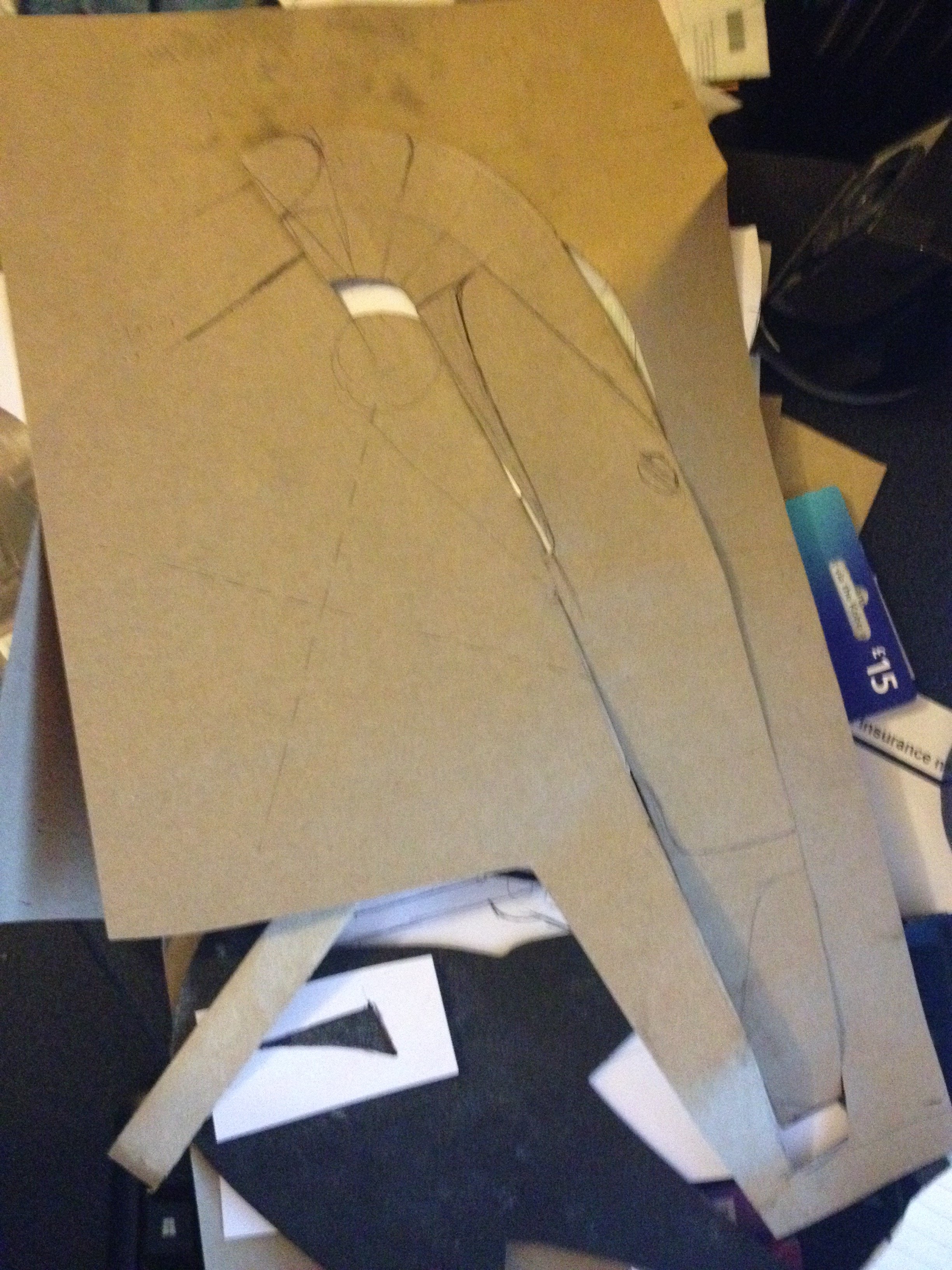

So I started out by drawing a template for the helmet, and marking out the rough proportions of a full size battledroid head.
If anyone is interested, I'll see about posting the templates/dimensions online after I finish up with my builds :)

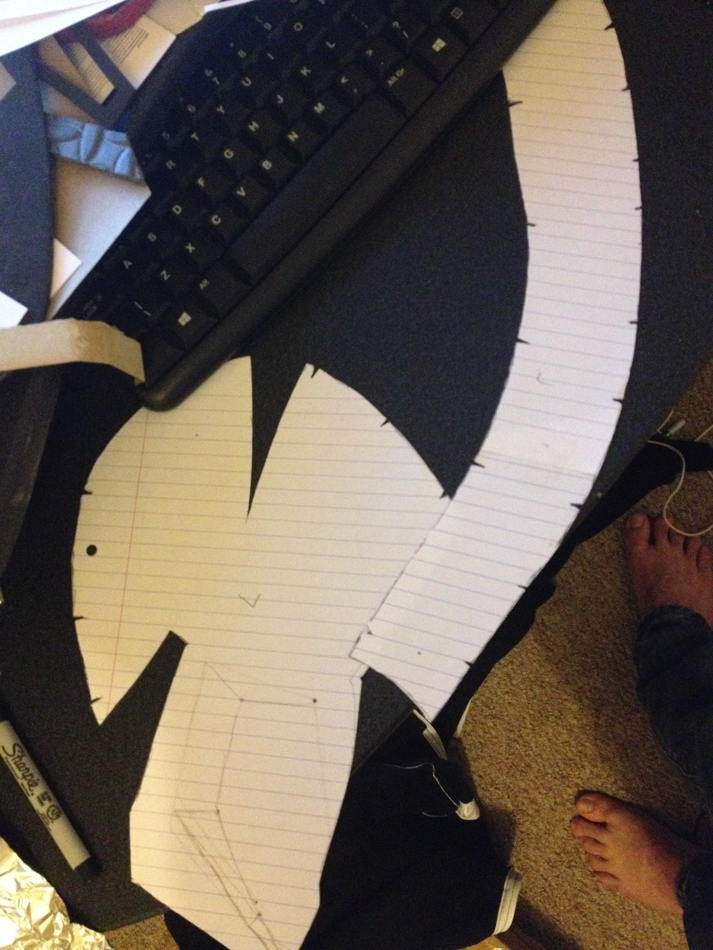

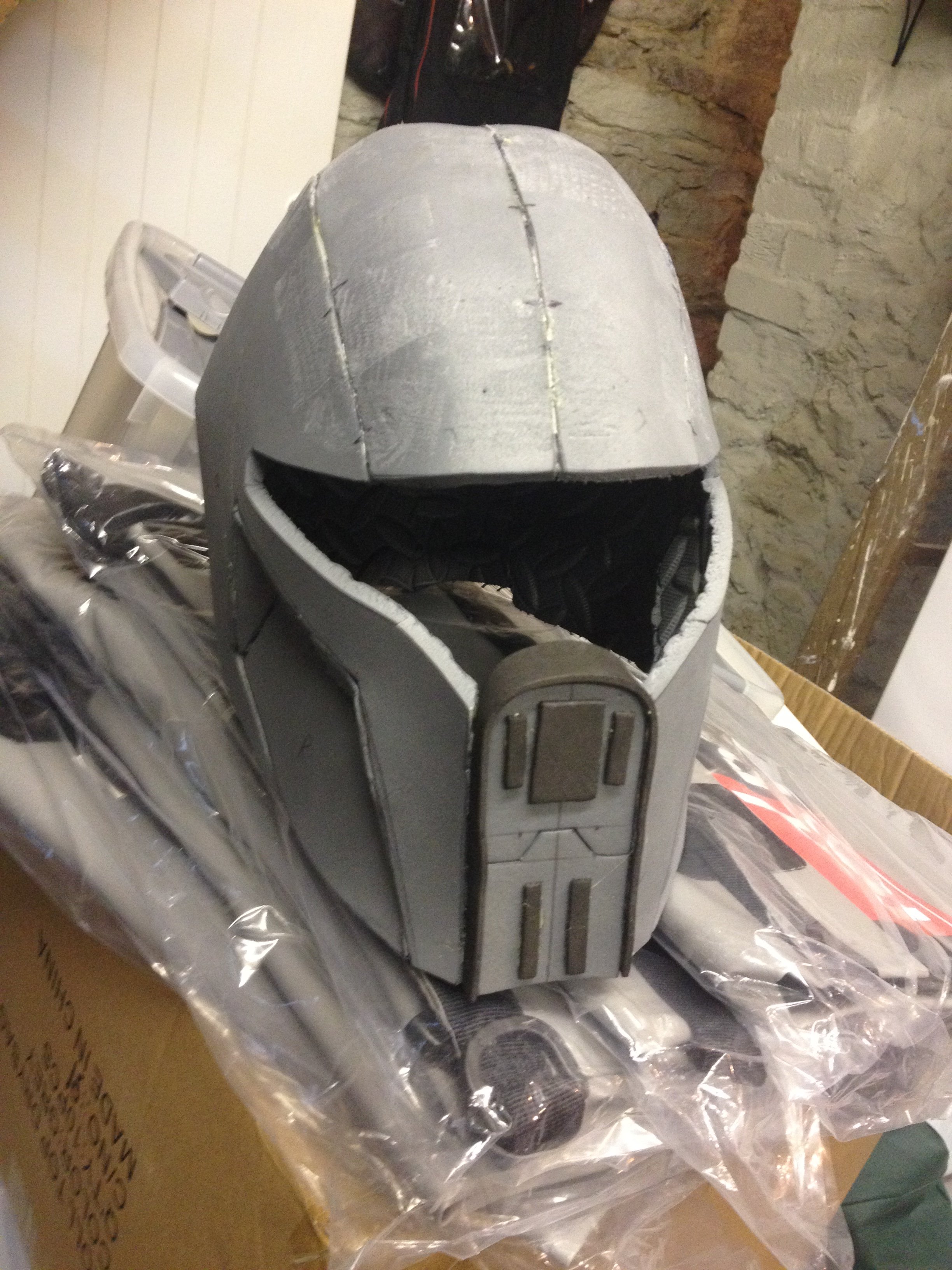

Now onto the helmet! After cutting out the template I cut out the foam according to the template, and heated the foam to get the bend before joining pieces.
This is my friend in another helmet I am working on right now(magneto), because I forgot to take pics when the mandalorian helmet was in this phase.

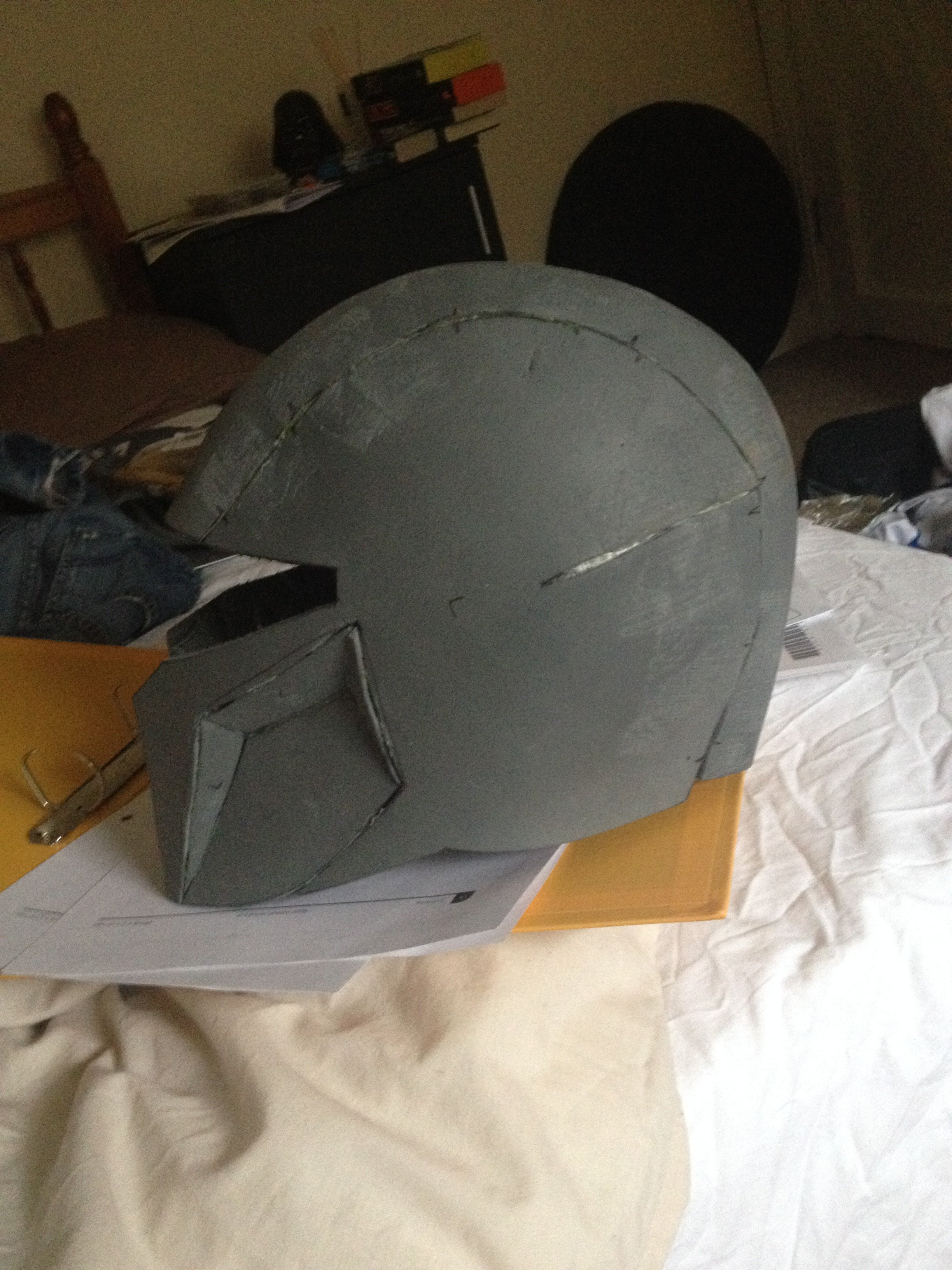

After joining the four pieces I realised that I wanted some cheek indentations and so made more templates for those, allowing me to fit indents in my helmet.
I encountered a brand new problem - the cheek indents stopped my helmet from fitting properly with the visor width that I desired. I took inspiration from scout troopers, and made a ventilator style mouthpiece out of craft foam and floor mat.

I decided to add a few more details before coating the helmet such as an elevated ridge:
The most recent of my failures was calculating how much resin I needed, and how long I had to work with it before it hardened. Needless to say, I wasted about half a bottle. I managed to slap two coats of resin on with what remained, giving the helmet a nice smooth finish.

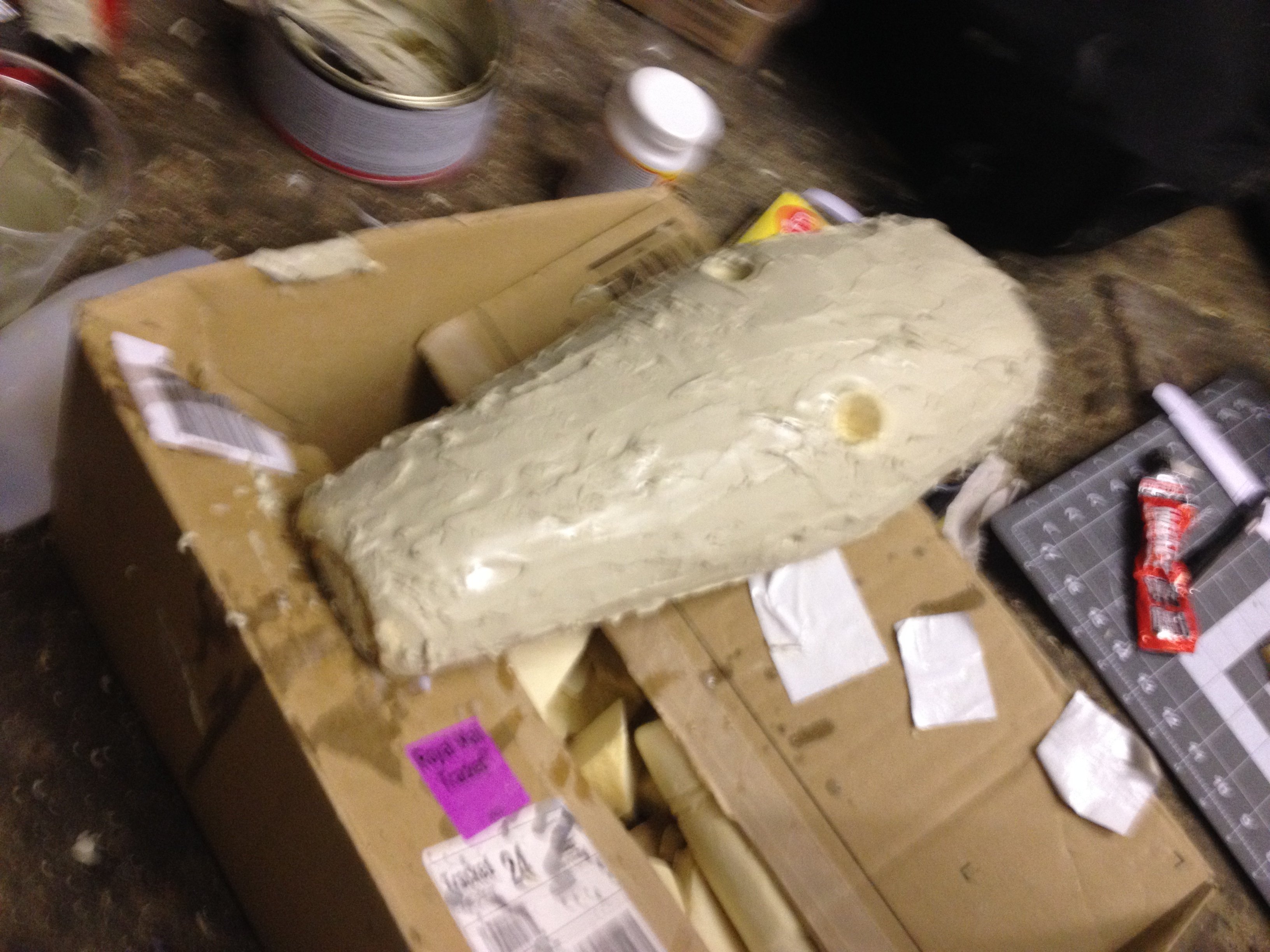

Final stage was filler again, using the majority of the tin:
I'll post updates as soon as I get this done! I hope that this filler will work out - I've never actually used it before so I've just been following people's guidelines aha

Okay, so I've run into a problem. The filler is still soft in most places, even though I left it overnight! Is this because the hardener wasn't mixed in properly? And is there a fix? Like maybe diluting the leftover hardener and brushing it over the top? I leave tomorrow for six months so I really need this done by tonight - thanks :)
Edit- it is 9 Degrees here, could that be slowing down hardening?
Okay so I have just had a very productive/unproductive two hours(depending on how you look at it).
I attempted to add hardener to the surface of the filler and left that for half an hour, with a heater pointed at the head and helmet, but that didn't help at all.
Instead it left me with a huge mess to clear up.
I scraped off the majority of the filler and scrubbed off the rest with a warm sponge. I then spray painted silver over the resin which gave me a rough idea of which areas were most lumpy. I have just finished sanding the helmet's lumps and wil soon be applying the next coat to check for lumps. After that comes the visor!
Photo 01-01-2016 16 39 00.jpgPhoto 01-01-2016 16 38 56.jpgPhoto 01-01-2016 16 28 43.jpgPhoto 01-01-2016 16 28 39.jpg

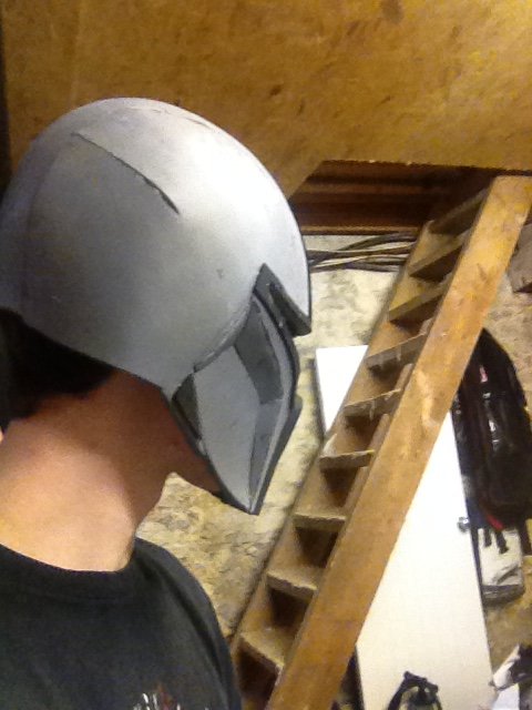

A long way to go on the helmet, but it is slowly getting there. While sanding I filed through the resin on some parts which exposed the foam and made for uneven painting. I kind of overcame this by using an extraordinary amount of battledamage (most significantly at the rear). I realise that the colours aren't the best, but I'm trying to save money for uni next year and a can of spray paint is still quite a lot for me, especially since I already had some lying around!
Now I just need the visor done. For a first helmet it could have been much worse, but I managed to learn what not to do :D
