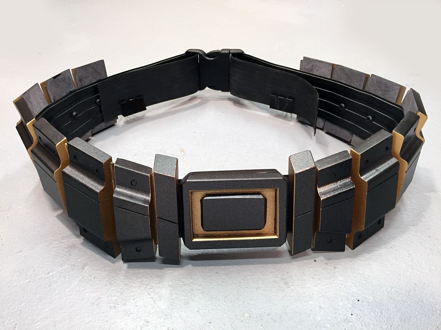

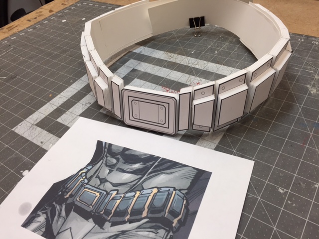

This illustration of the new Rebirth Batman has always spoke to me. I don't much care for the utility belt design of the new suit, but THIS artist (Howard Porter) did something really interesting with it. I guess I wasn't the only one. I was recently commissioned to build a belt based on this illustration.

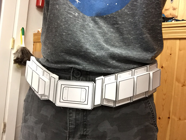

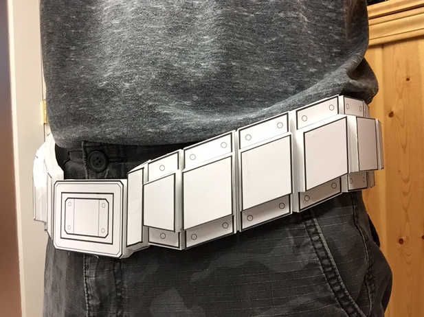

I'm starting by working up the design in Adobe Illustrator. Then I transferred the drawing to foam core to mock-up the general scale of the belt.
So far so good.

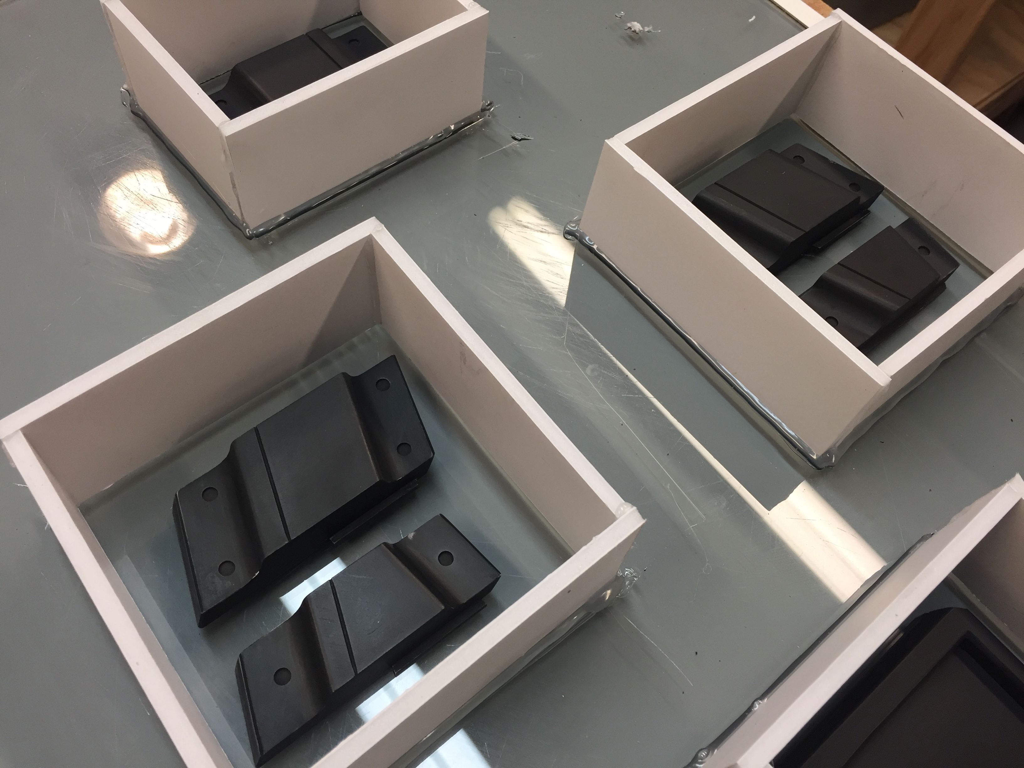

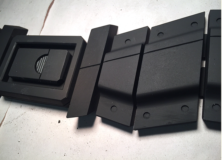

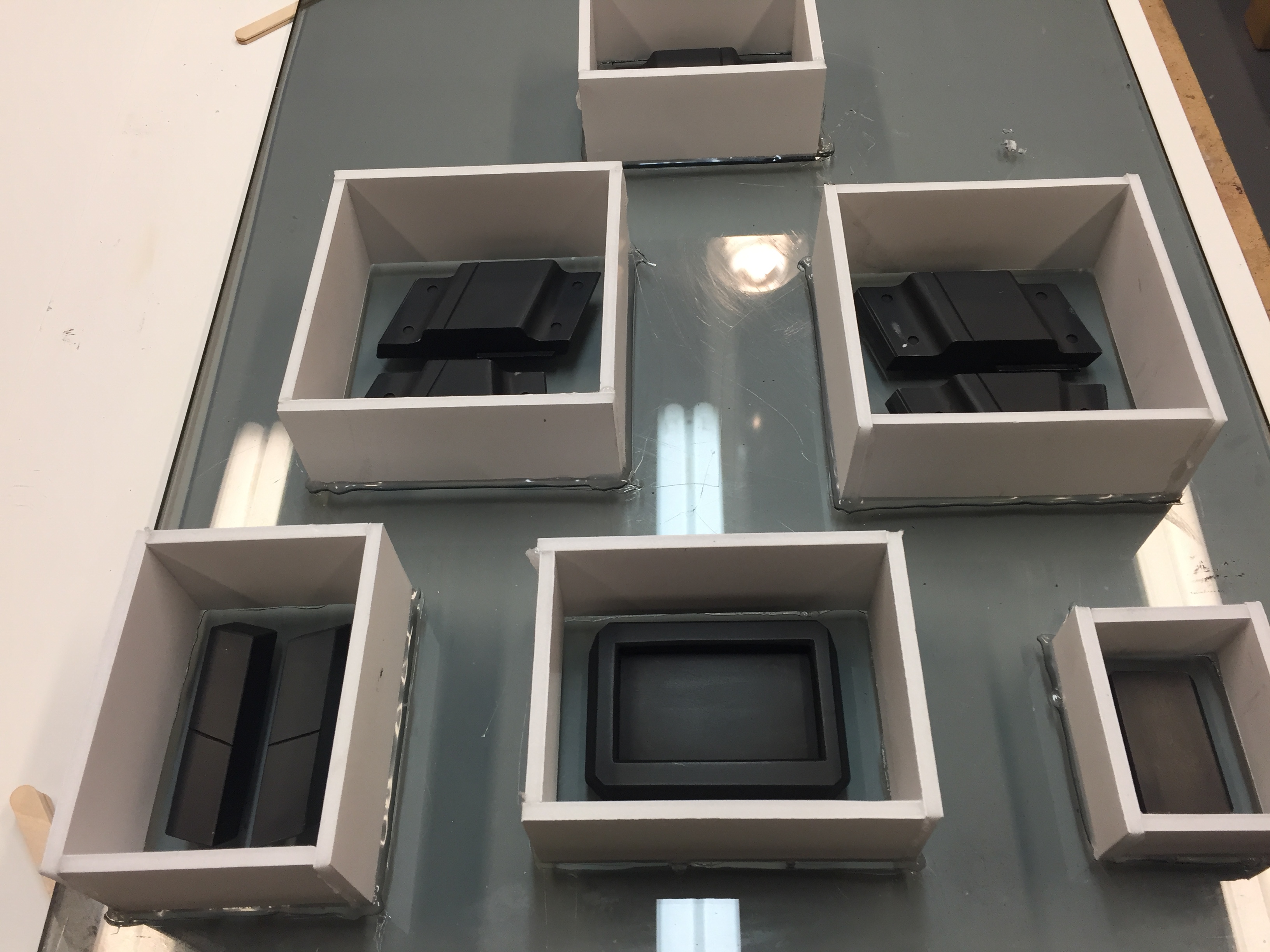

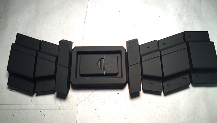

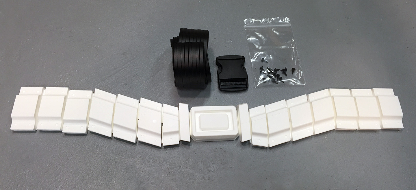

I little final refinement. I changed my mind a few times on the inner buckle "button" ... opted for a simple approach. Everything was cleaned up and put into foam core boxes. I use Smooth-on Mold Star for the molds. Hopefully I can pull a few casts out later tomorrow.

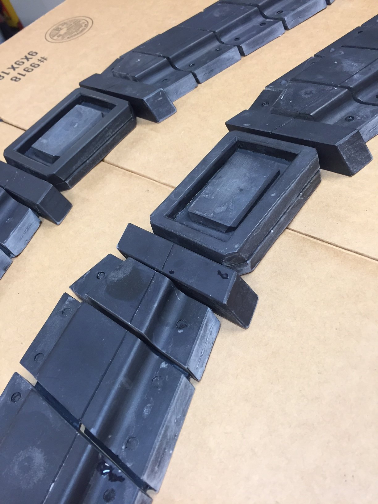

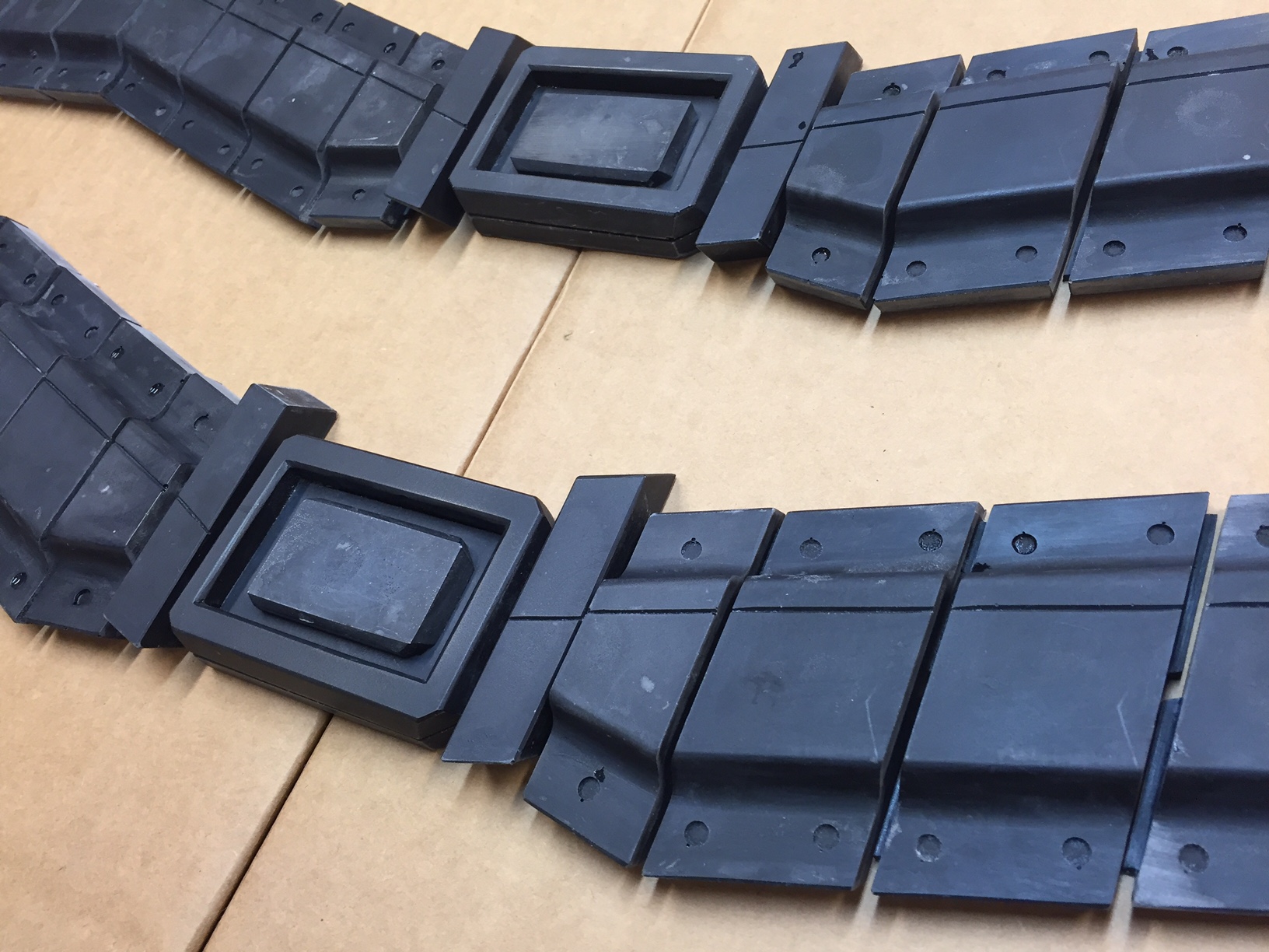

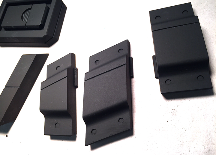

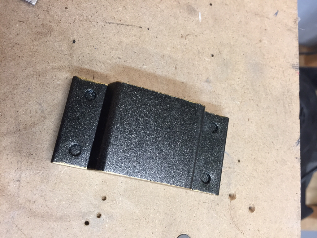

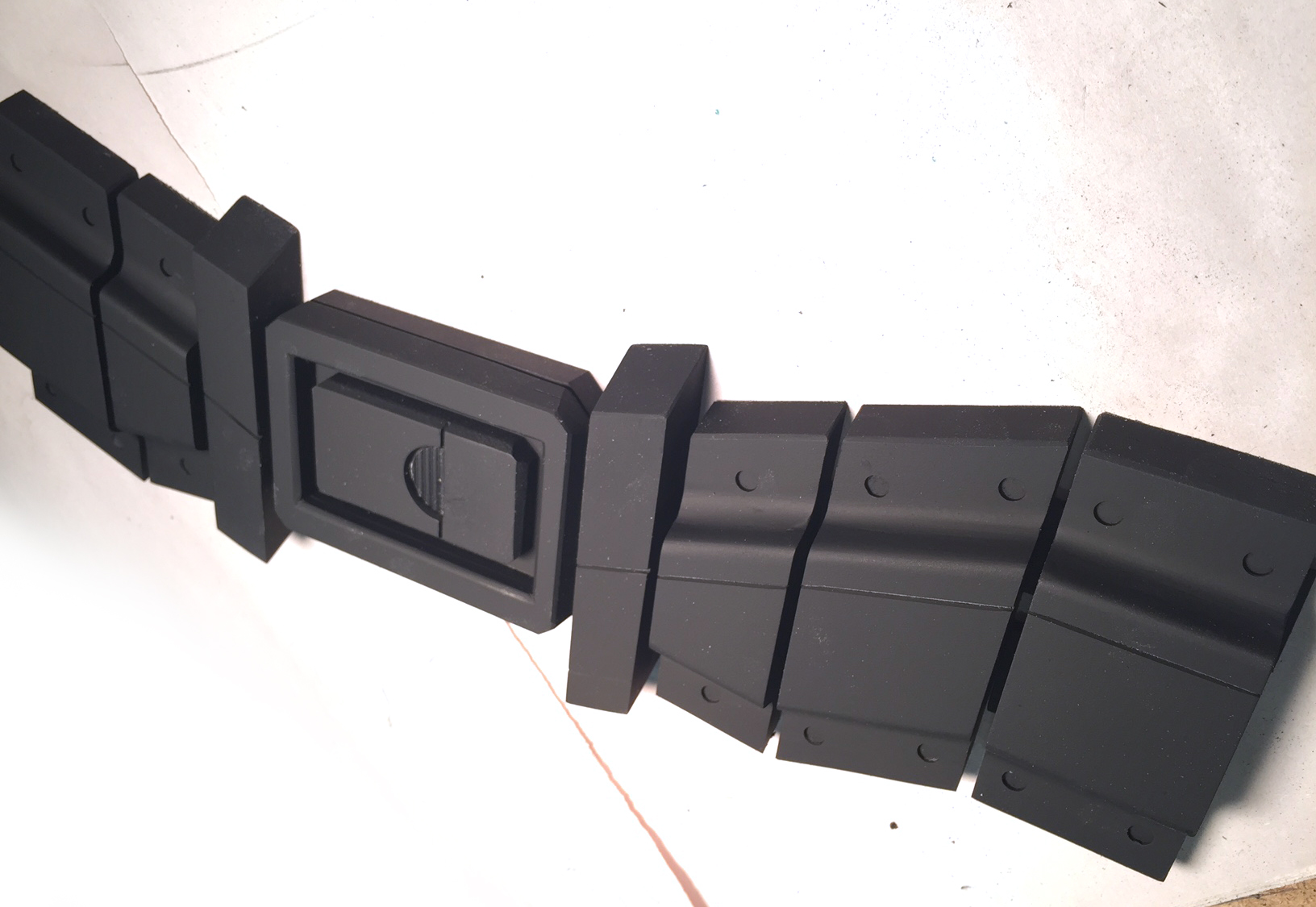

My God I totally hate SmoothOn Onyx black resin. I thought it would be cool for all the belt pieces to be black, to better hid any paint chips. I heard some people have issues with it. I appear to be having EVERY SINGLE ONE. It's a very fast curing resin, but what makes it challenging is it is also a VERY HOT curing resin.
If I try to pour a thicker cast – like more than a half inch – The resin forms big blisters on the face of the cast, wrecking the cast.
As the casts were curing I was seeing the resin contracting and pulling out of the corners of the mold, leaving gaps cast. I can literally see this happening as the resin cures.
So, to finish all the pieces I had to do 3 pours per mold so it didn't blister and on the last pour I had to wait for the resin to contract out of the corners then quickly pour a tiny bit on new resin into each corner filling the void. It took me 2-3 times longer to use this stuff.
I switched to my standby of SmoothCast 300 tonight and I was able to pour each mold full in one move, everything cured perfect.
I don't know who this black stuff is for, but it's not me.
