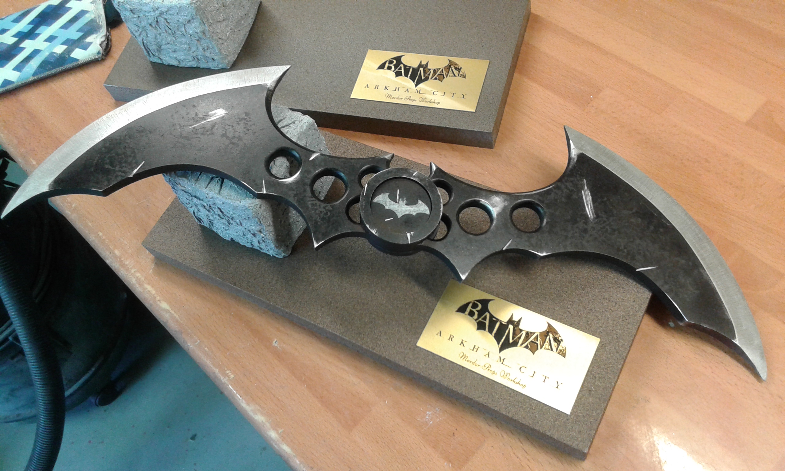

Here my last commission. I´m happy with the result and I´m thinking a second run.
First I drew in Corel Draw the pieces. A friend cut the pieces in metacrilate by laser. I shaped the edges with belt sander and I added some scratches.
The paint job was simply. Primer coat, black base and silver edges and scratches by dry brush. Some dark red oxide by airbrush and final weathering with sponge.

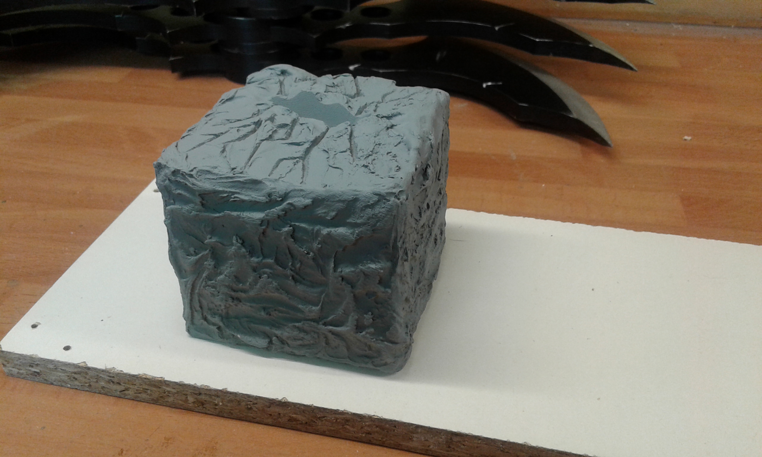

For the display I used a wood block covered with bondo to add some texture same stone. I mold it in silicone and cast in polyurethane.
Final assembly over MDF wood painted with grain paint texture. I added a little license place laser engaved.
