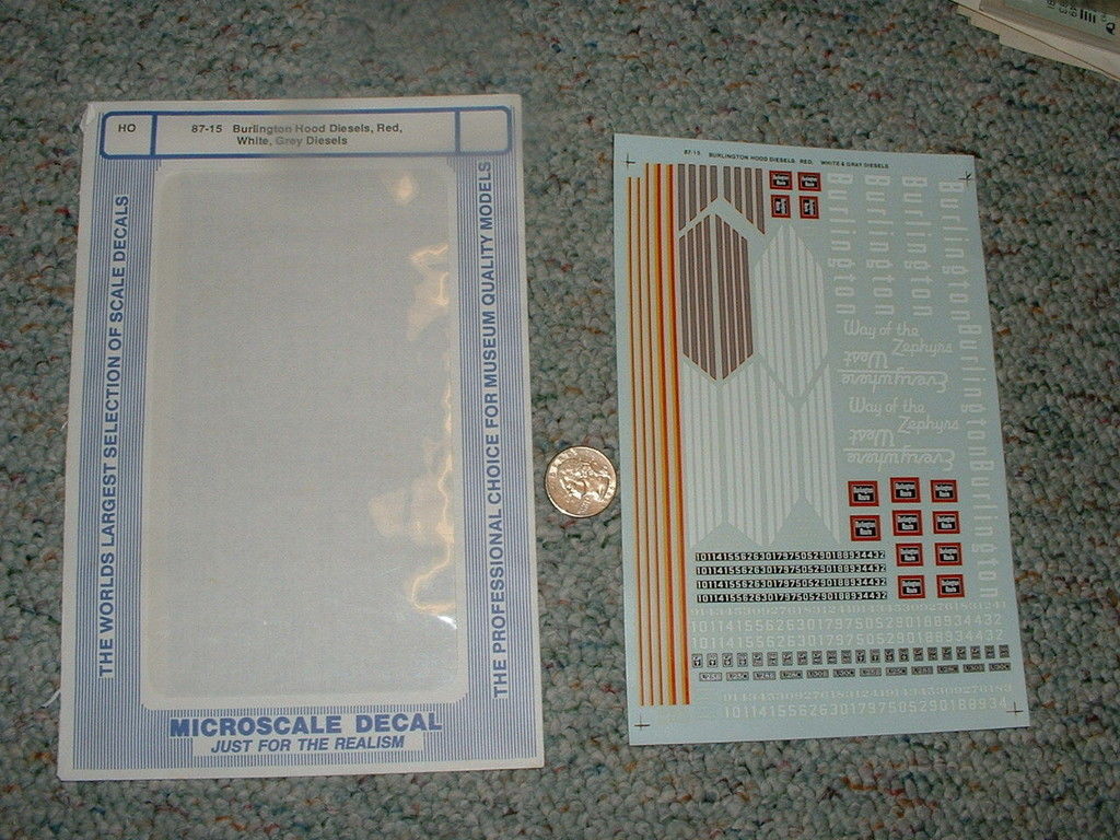

Attached is an example sheet from Microscale. Almost certainly not the correct one.
Mike, back in the '70's the available MS sheets would have been numbered in the lower triple digits, certainly the double digits; that is one contraint I use when searching these sheets for matches. Of course, over the years, designs may have been 're-issued' or reused on higher number (aka later) sheet releases, so it is not a problem either way. In this case, the warning stripes have been repeated on several locomotive data sheets. I also make note of the date ranges supposedly covered by the sheet, i.e. when a sheet says something like 'Southern Pacific locomotives, 1970-1993', we know that *specific* sheet would not have been the sheet used, however, because of the 1970's coverage, there may be included retread designs from an earlier sheet, which certainly helps track the original source down.

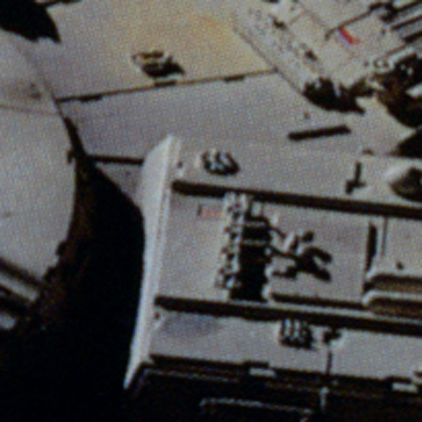

#7e: The residue area apparent in some current images does not seem to match the Champion decal shape nor do the various contemporary images really look like a Champion logo. More like a square yellow block, such as those found on the railroad car data sheets.
[I have to agree that the #7e will have to be considered an unknown for now, the glue residue does look square rather than rectangular like the Champion logo (I had thought maybe it was not stuck down properly originally and that was why it might have fallen off early)...But I do seem to see red in there and in some shots black, so just not sure? 'S' logo maybe? I will show some pics here for others to look at and maybe someone will see something we are not??]

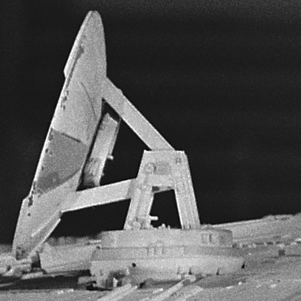

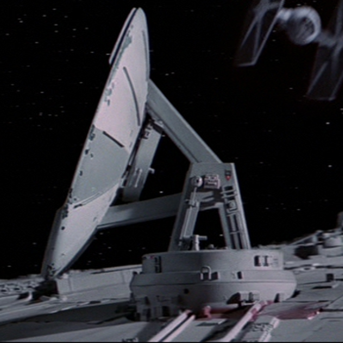

#9e: Found on a movie screen capture, but the details of the A frame didn't match the current images - until I realized the current state of the model has the dish & mount has been rotated 180 degrees and the dish 'flipped'; so it only appears on the one side of the A frame (I initially assumed both sides, but the large 'block' detail was in the way...) I also thought it was a larger size, but it really looks the same.
[I tried to find images of #9e, best I could do was a screen capture and a couple from my archive...nobody takes pictures of the other side of the dish, I guess?]

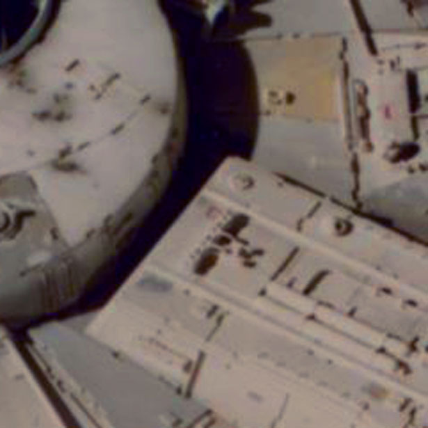

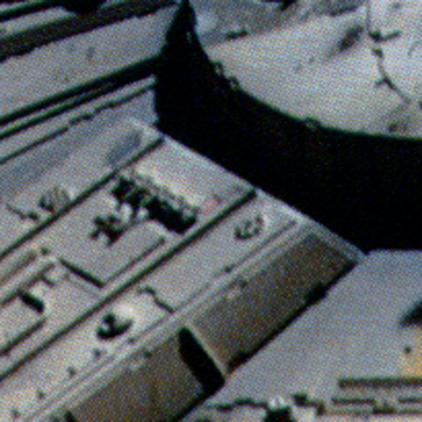

rbeach84; said:
#12: Would need to cite specific evidence that there are different thicknesses of the yellow-red stripes; some images appear to present two variations, but the visible detail is small and somewhat blurry. I suspect that the variation is due to the camera effects than to an actual difference. Since we believe all came from the same Microscale sheet, they should be consistent (unless there were two different scales involved.)

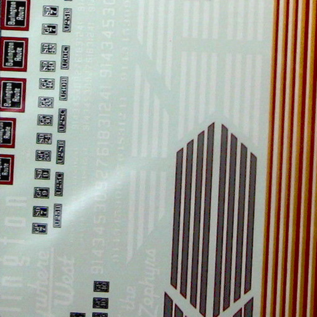

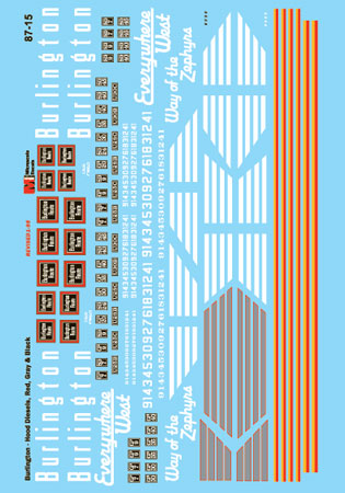

[No, I am positive that there are two thickness of #12...the best evidence is that sheet they come from (Microscale HO #87-15 Burlington Hood Diesels, Red, White, Gray Diesels) has both thick and thin versions on it...and I see it when I lay my designs against the different areas when measuring...so, ya, I'm sure]
imurme
View attachment 454588View attachment 454589View attachment 454587
[ The middle one above is the one that best shows the square decal...]
View attachment 454581View attachment 454583View attachment 454582
[The first one shows the square & triangle at the top right corner of the A-frame. It is also, I believe, the only time I've seen that side of the mount; usually it is only the side.]
View attachment 454578View attachment 454579View attachment 454577
imurme
[Okay, I believe it! (Talk about not looking at things closely enough! That's what I get for going from memory.) But, with so many missing, how to nail down the specifics?]

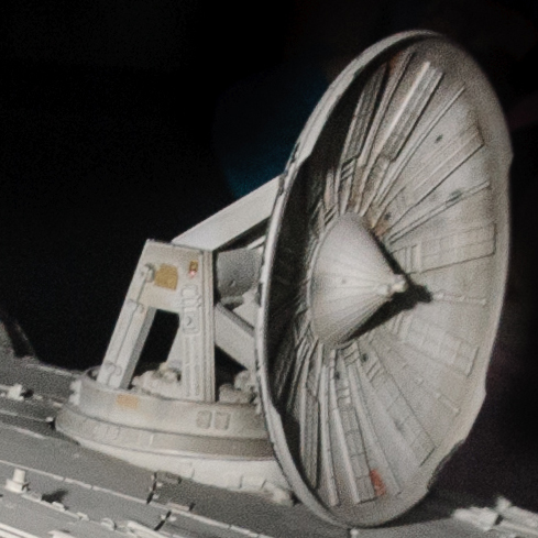

Ok here are some down and dirty shots.
Remember this is a decal test bed comp Hasbro RMLF. Altho it is a combination of both 5ft and 32 studio versions, mostly 32.
There are some decals that do not belong were they are positioned, along with some size issues.These have been corrected on the revised art.
