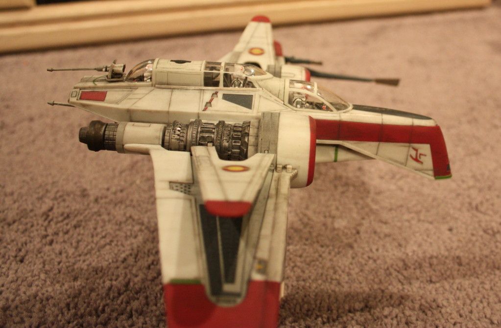

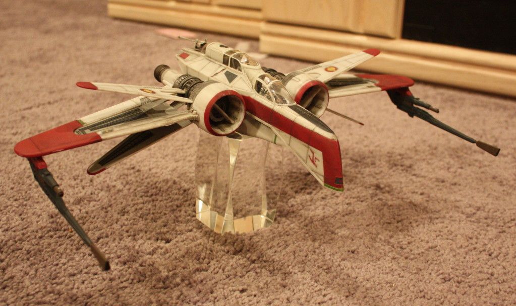

Revell ARC-170 easy kit
http://i359.photobucket.com/albums/oo32/blakeh01/Star Wars models/IMG_3796.jpg
http://i359.photobucket.com/albums/oo32/blakeh01/Star Wars models/IMG_3794.jpg
