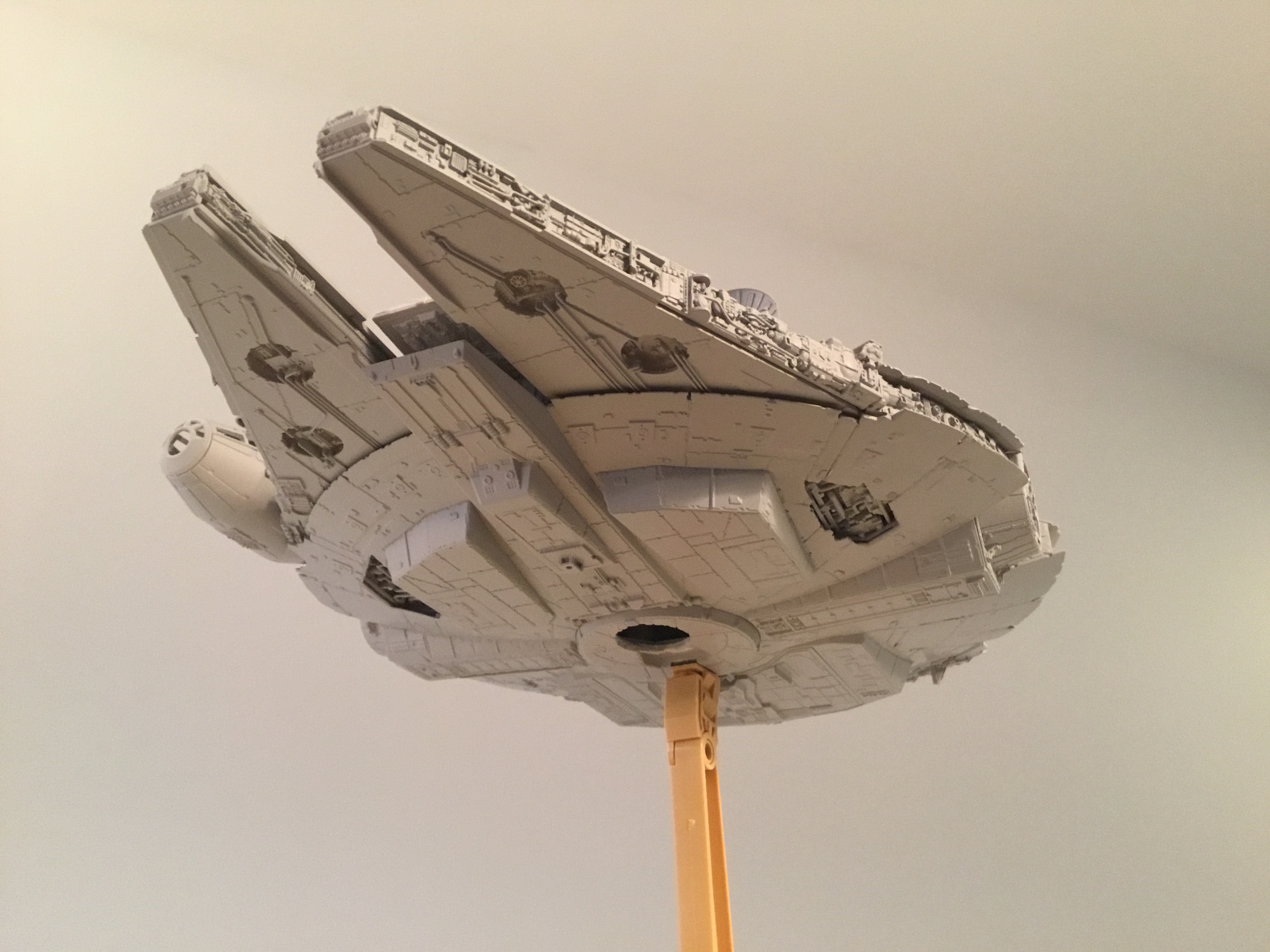

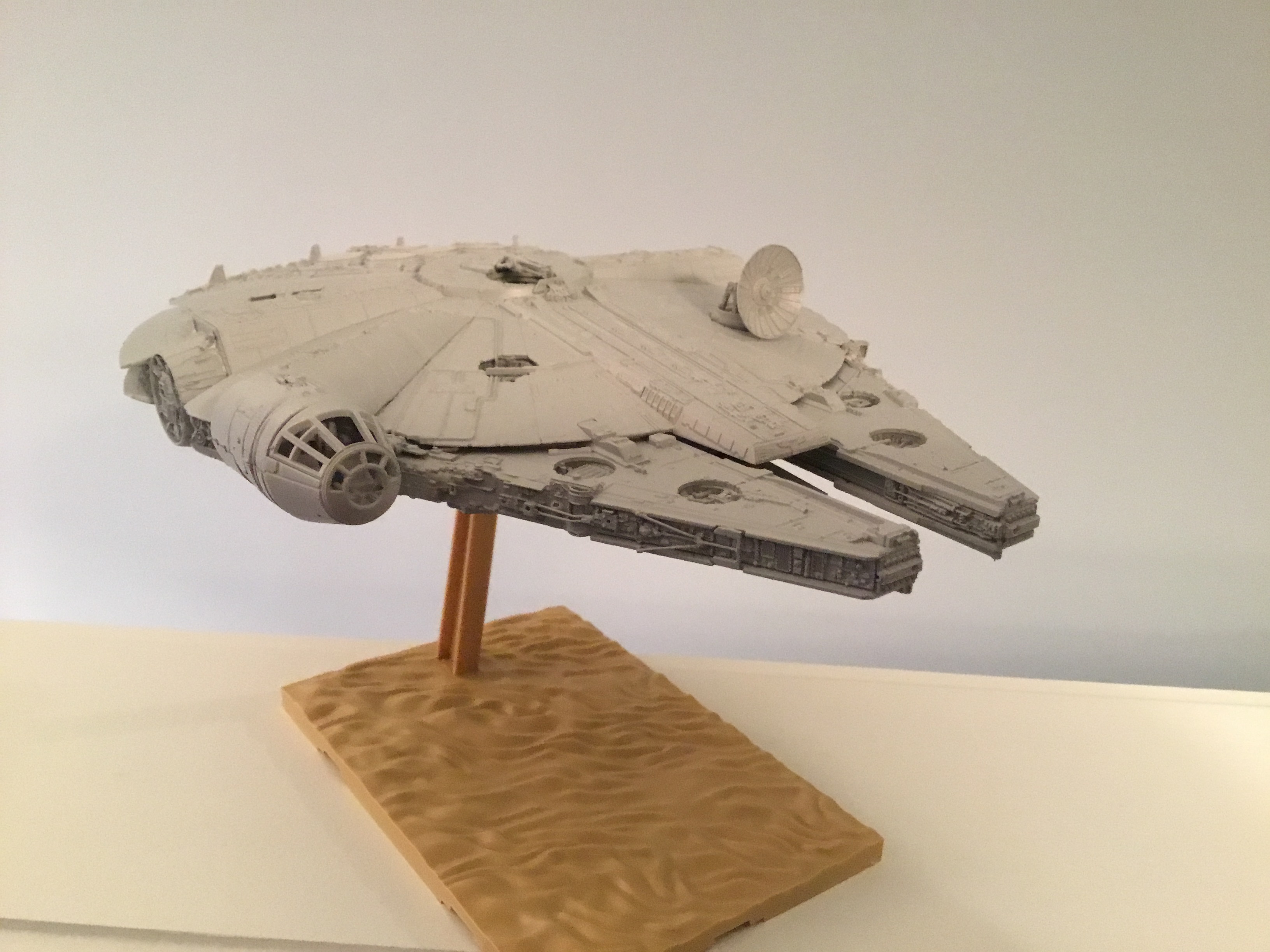

Bandai 1/144 ROS Falcon kit as ESB/ROTJ era Falcon? That's my goal. And I seem to have reached it. Now it needs a few friends in its scale...
My build has been on hiatus for quite some time, but I’ve used nkg’s amazing parts (as well as reworking details like the underside pits and some of the hull plating) to convert the kit into an ESB version. So, it IS possible, but it just depends on how far you’re willing to go.
Landing gear wells are not accurate width/length... whatever, I was doing in-flight anyway. I can fudge it or re-scribe it a bit.
Since I've determined the general look of this kit is of the 5 footer, I'll be be 'adjusting' the lower access pits to those
of the 5 footer. This calls for some surgery... I'll also have to move the 'guts' of the pits in more towards the center. Luckily, this will be the only major accurization I'll need to do. Basic templates:

Scaling down some tunnel greebles, dish rings or sidewall piping is simple.

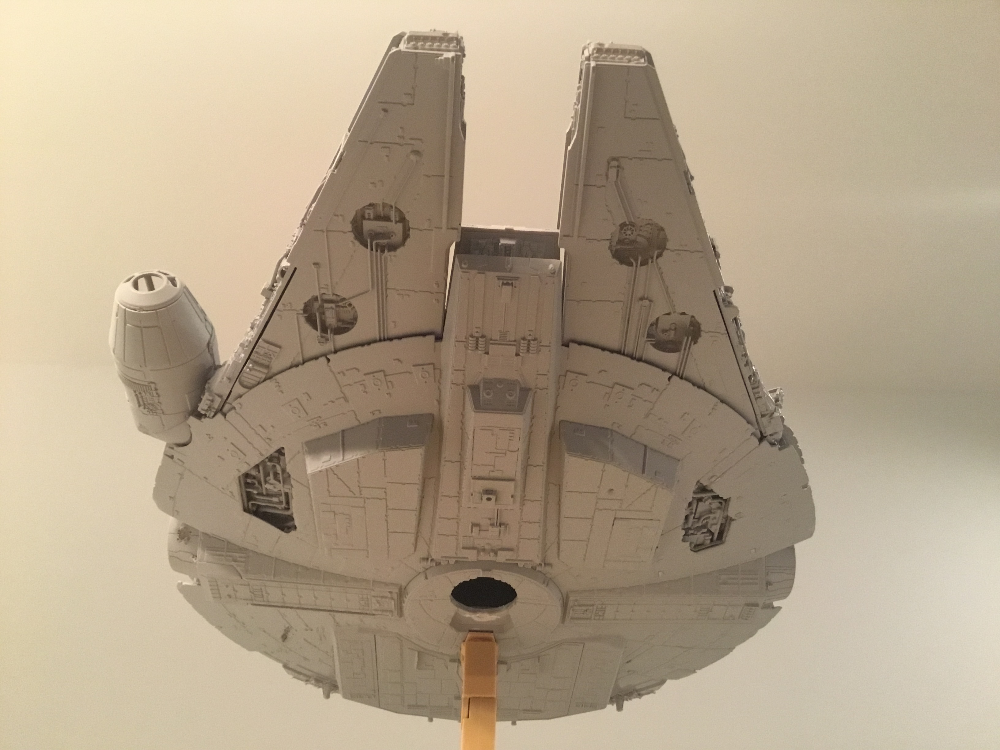

The method I used was carefully Dremeling off the hull plating around the pits in the areas which needed to be modified, creating the new pit shapes from thin styrene, then adding new hull plating from paper-thin styrene on top of that. And lots of filler putty/sanding and thin coats of primer to blend it all in.
And from the pictures you provided you did quite the professional job of it man! I may be using similar techniques myself depending upon how the subsequent scribing goes as I am using thick styrene for replacement bits...
The trick is using a small, square file to cut out the notches around the perimeter of each hull plate, rather than trying to scribe or cut them out with a knife.

The pieces are glued in, when dry I take care of the final tiny cuts & some minor scribing.
also, looks like I won't have to move the 'guts' very much at all, just take out some piping.

No, this is the ESB/ROTJ five footer. And yeah, it's a little tedious, but it's really just this- the rest of the kit will be a breeze.
Here's the pit walls mainly finished, and the guts trimmed to fit & stripped of some excess piping.
The hardest work is behind me, the rest is just fun.
I didn't realize this kit came with Chewie, cool. The next biggest figure will be Han, the next 3PO, and the smallest Leia. Also gonna sand down that ring on the dish center thingie.
