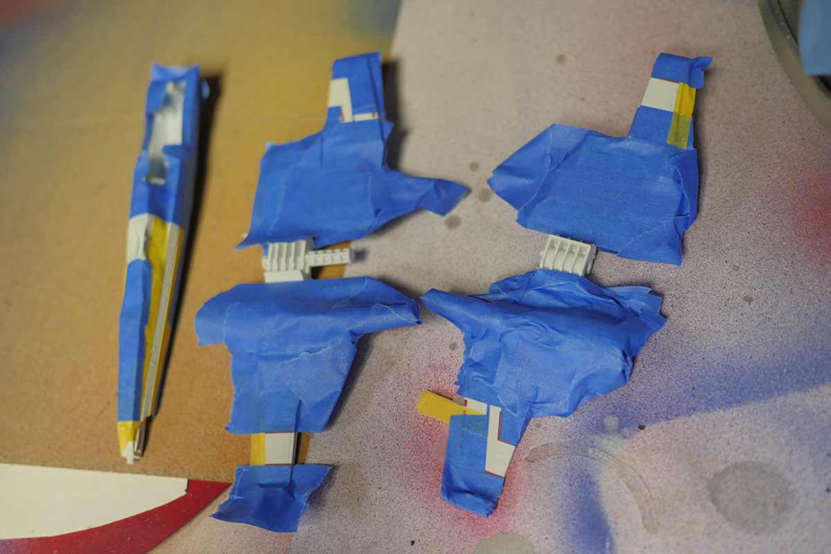

This is a genius use of the stickers. Anyone using this technique for masking?
https://www.youtube.com/watch?v=Sh3_bEU-K2A
I just used this technique on my Red Leader T-70. If you look closely, you can see the masks underneath the blue painters tape.

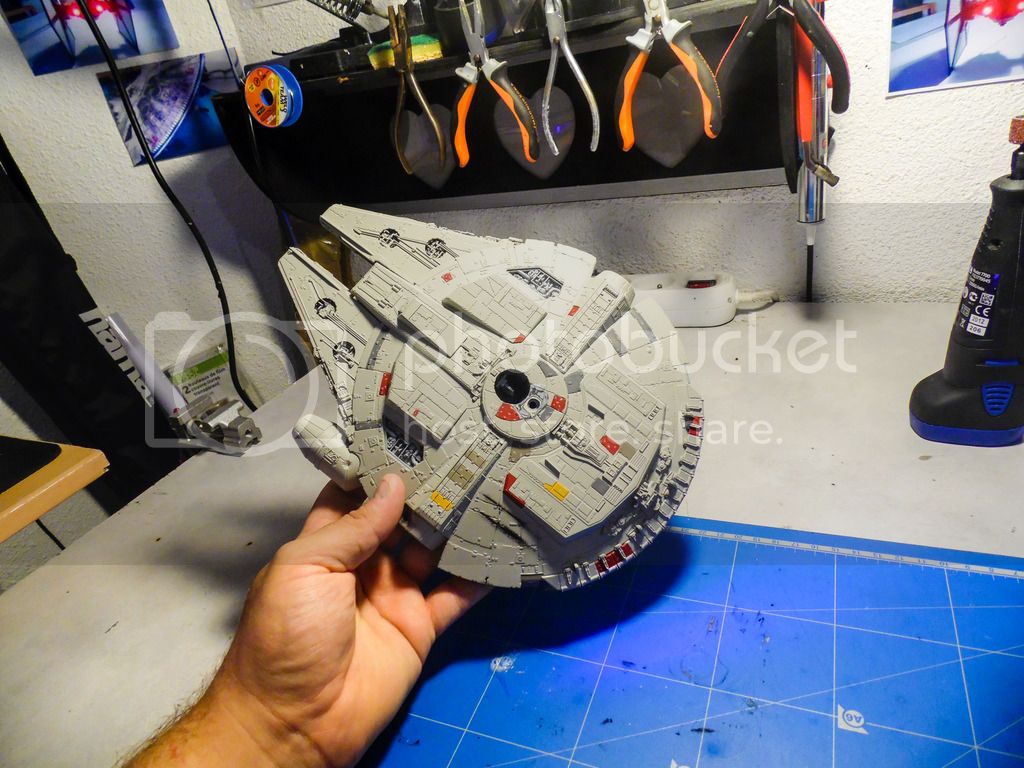

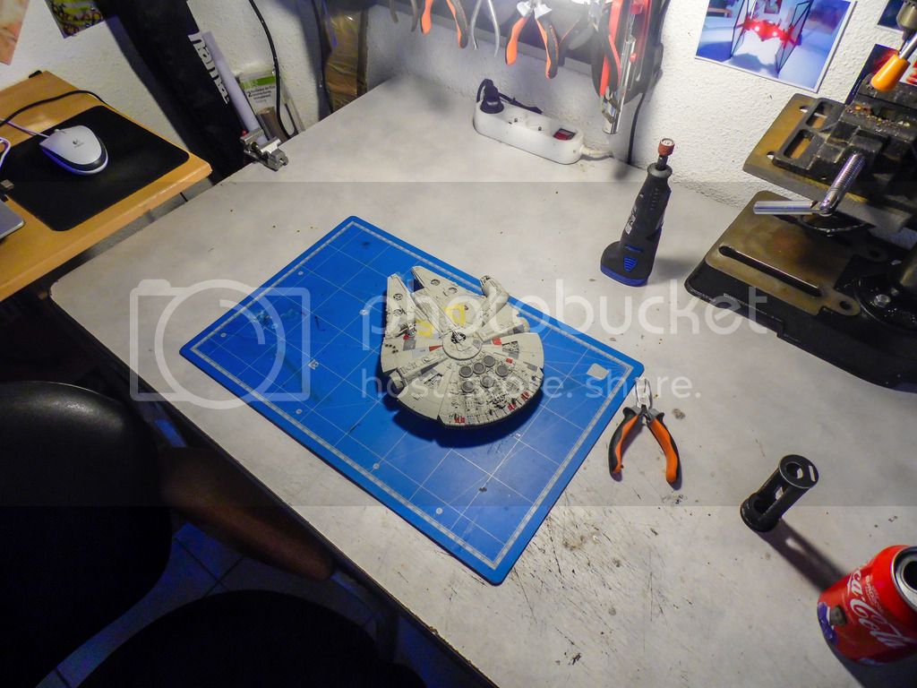

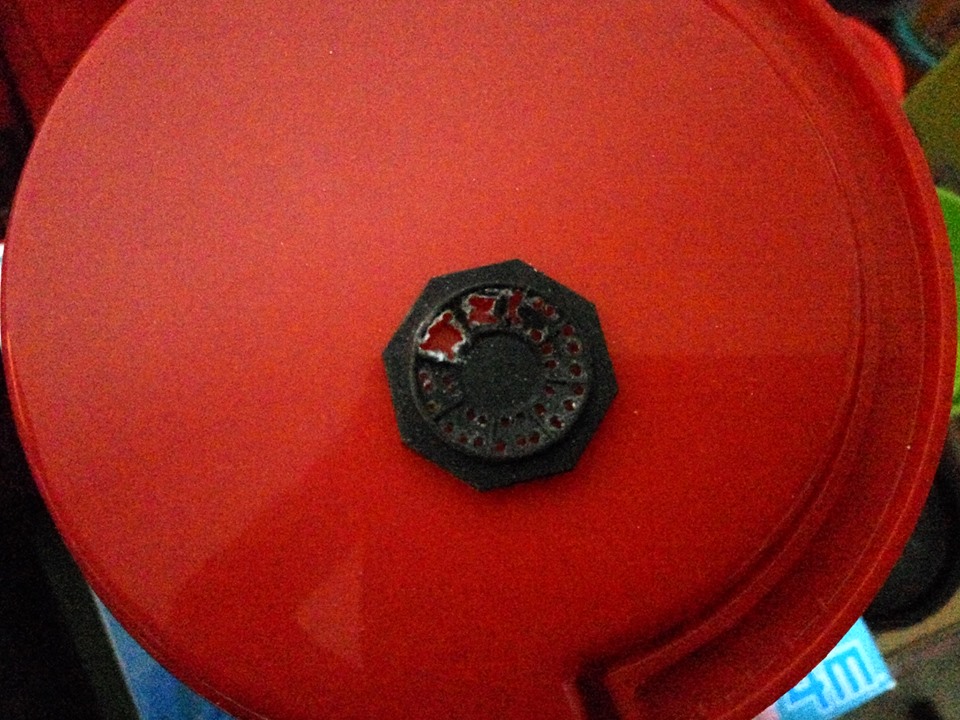

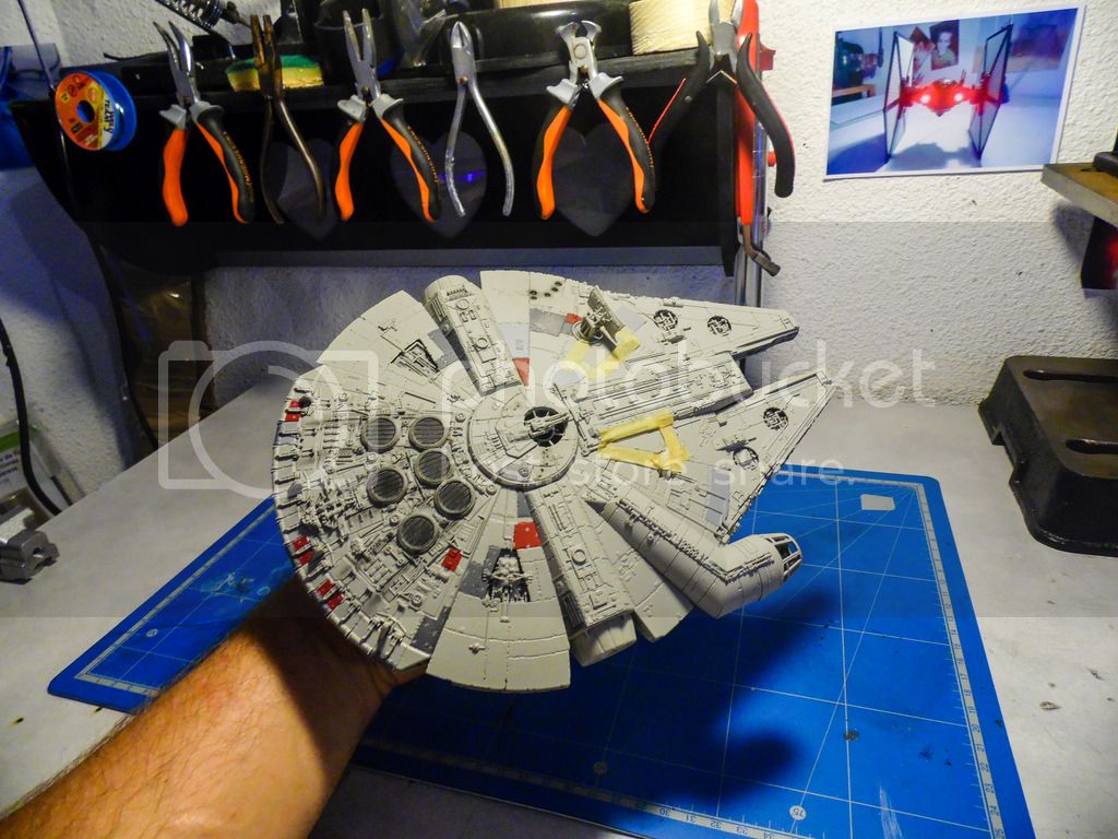

been working on my bandai falcon since last November (on and off) and was doing some paint work on the engine exhaust. Tried to put in on the hull to see how it looks and found that i could not snap it in place. Am i putting the wrong grills on the wrong spot? cant be cos it wont fit any other way. what could be wrong? is anybody else having same problem?
Scrape any paint off the attachment points. I painted my Bandai Speeder Bike before assembly and had similar problems. These kits are so well engineered and the tolerances are so tight than even a thin coat of paint can cause problems.
That sticker thing? That's when you say, duh, why the heck didn't I think of that. This isn't a model with stickers; it's a model with precut masks.

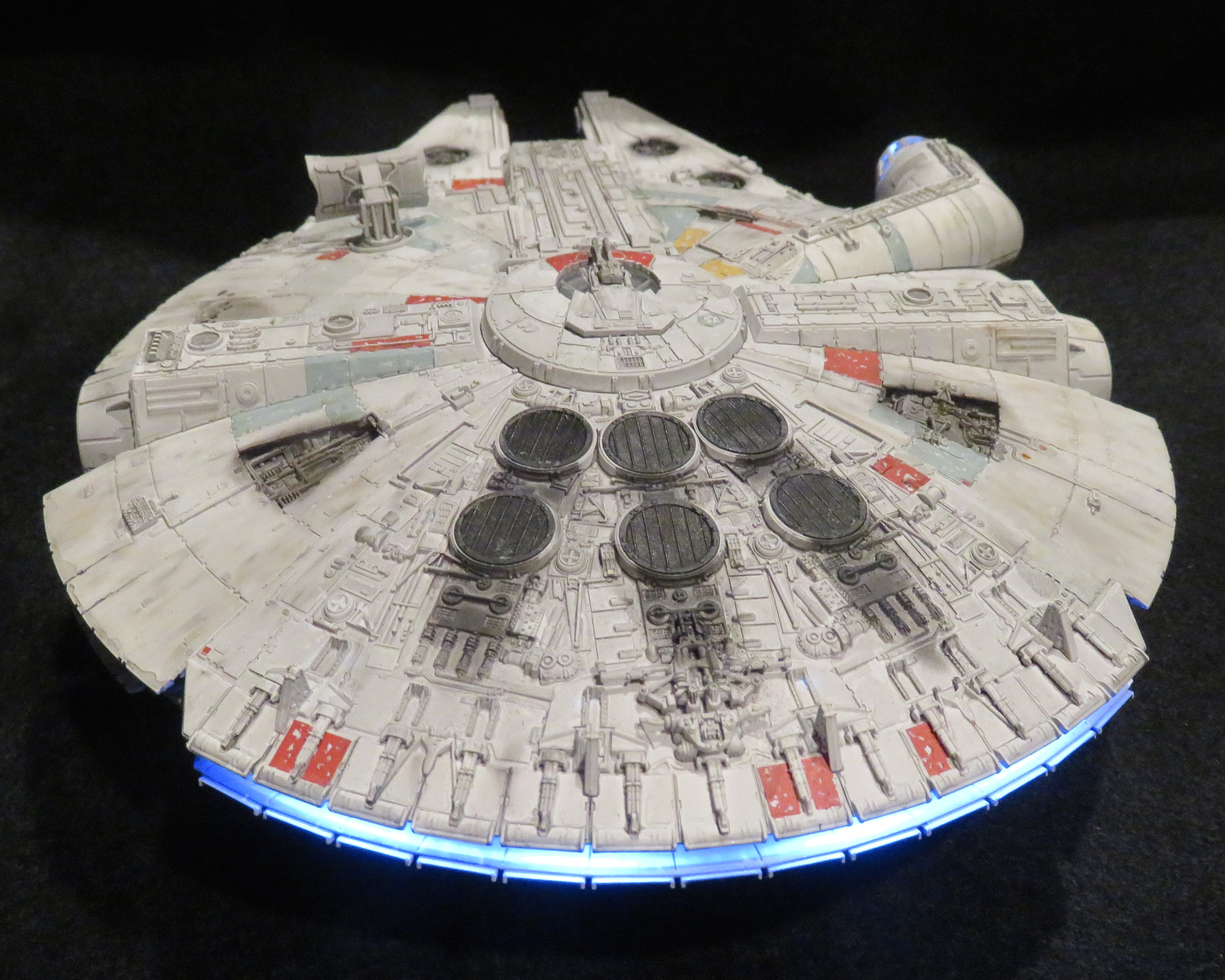

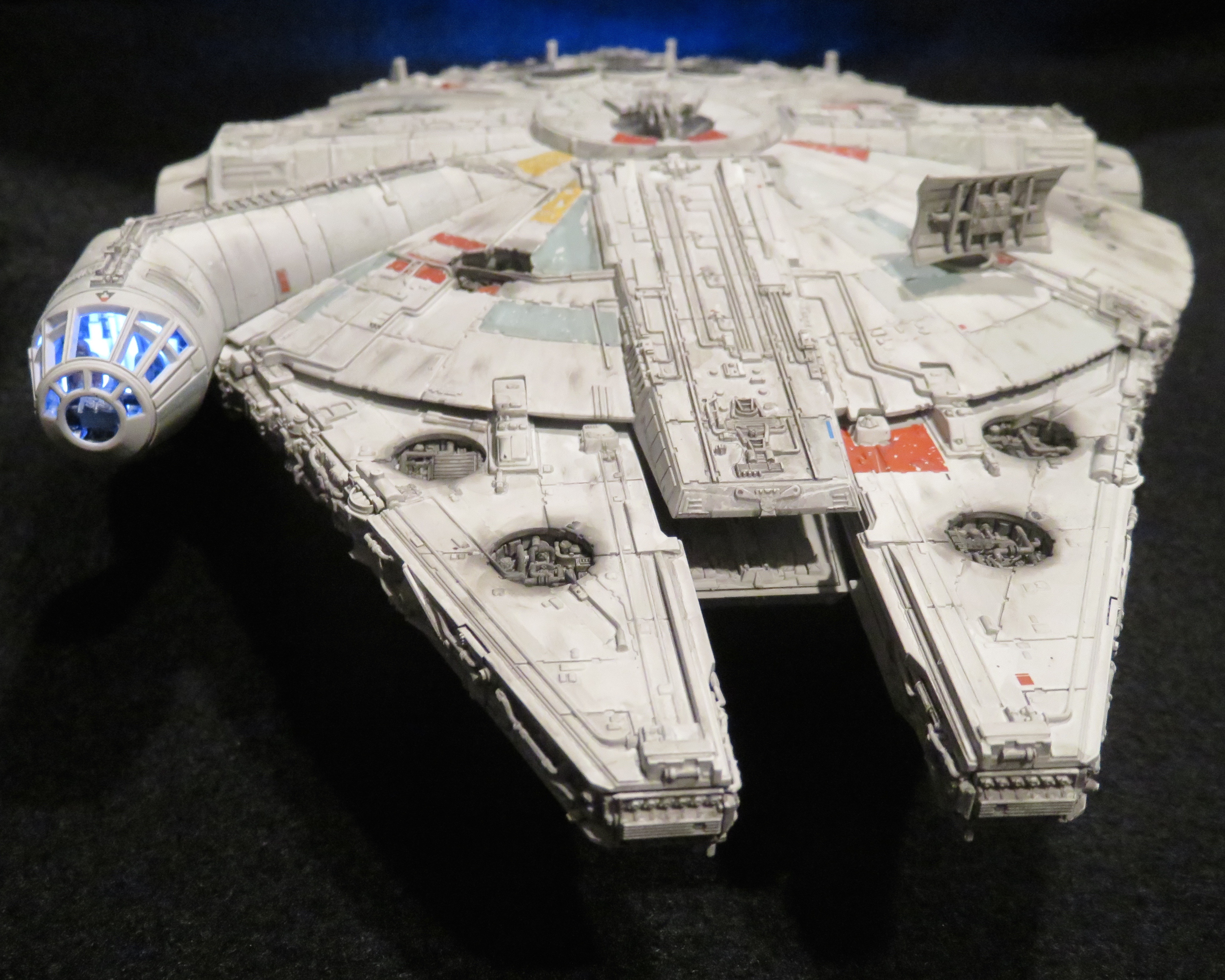

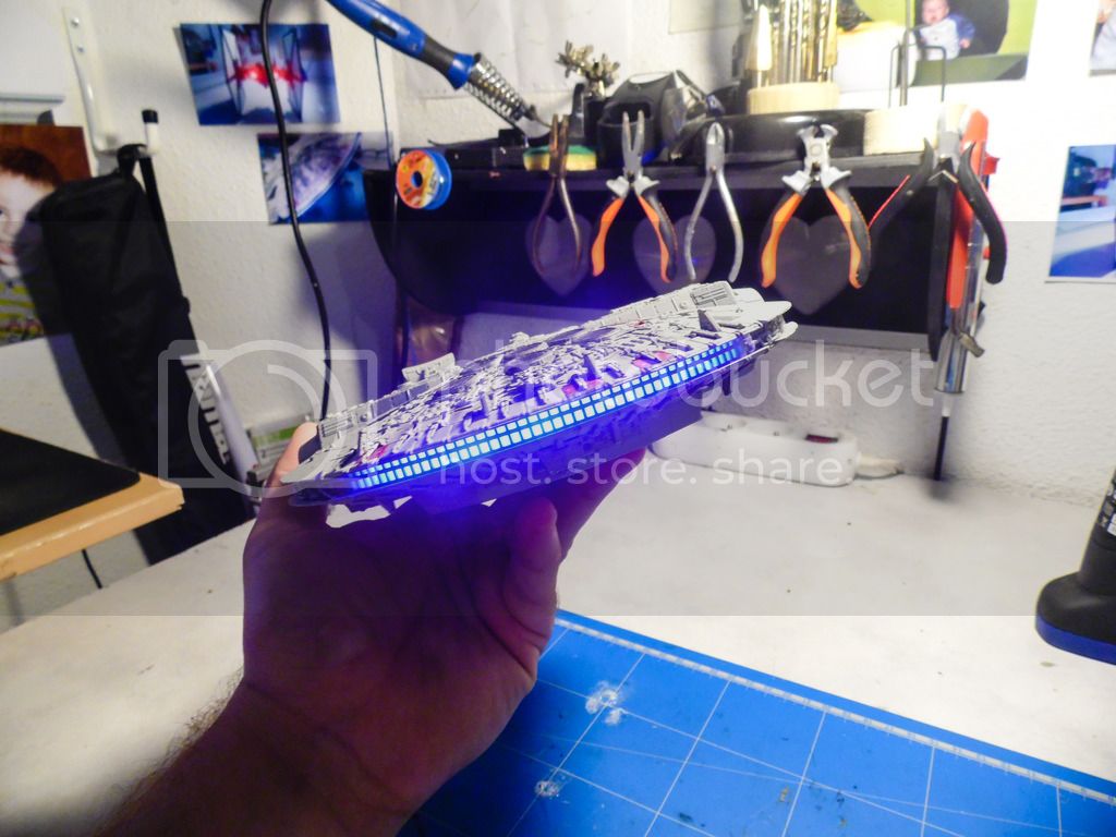

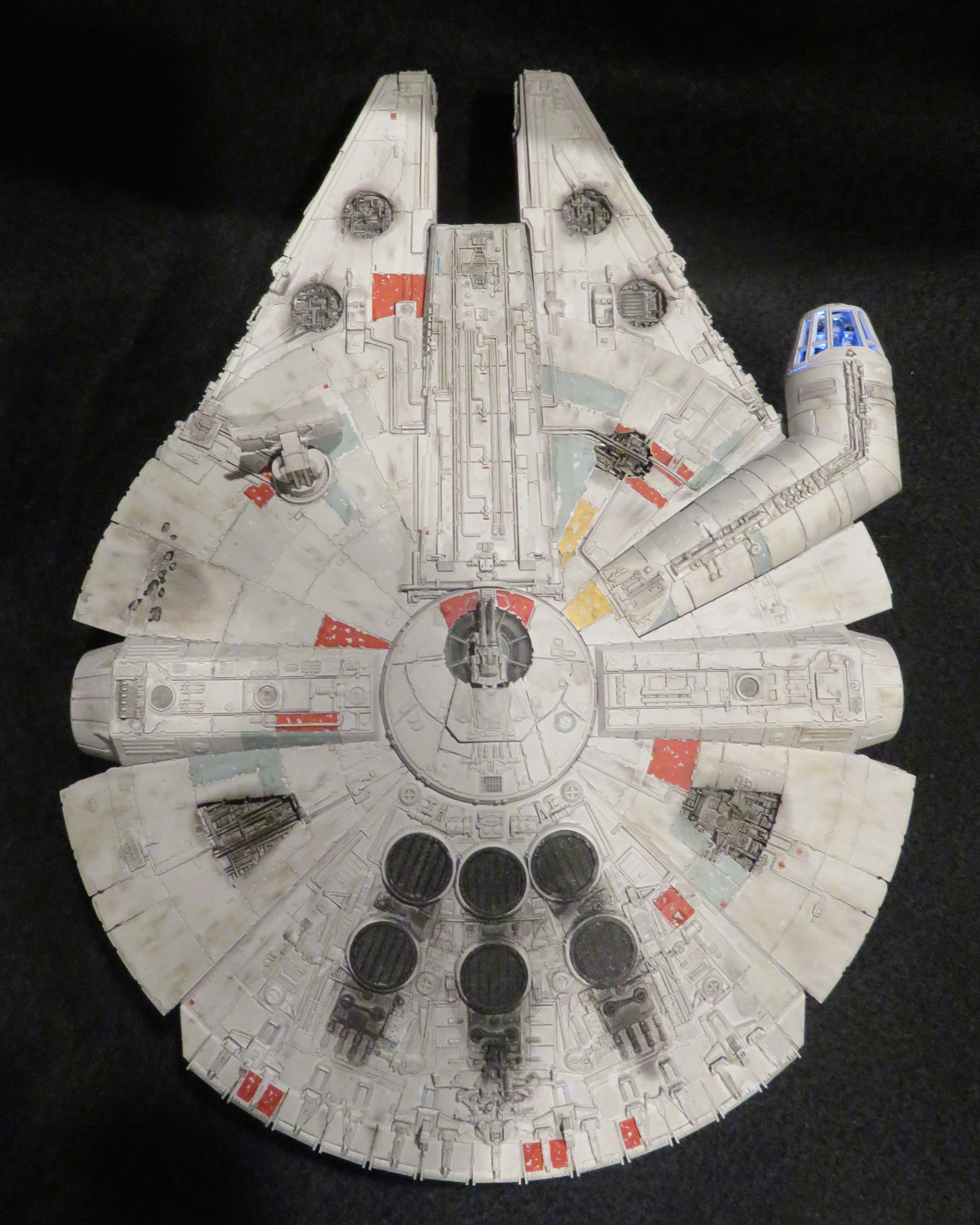

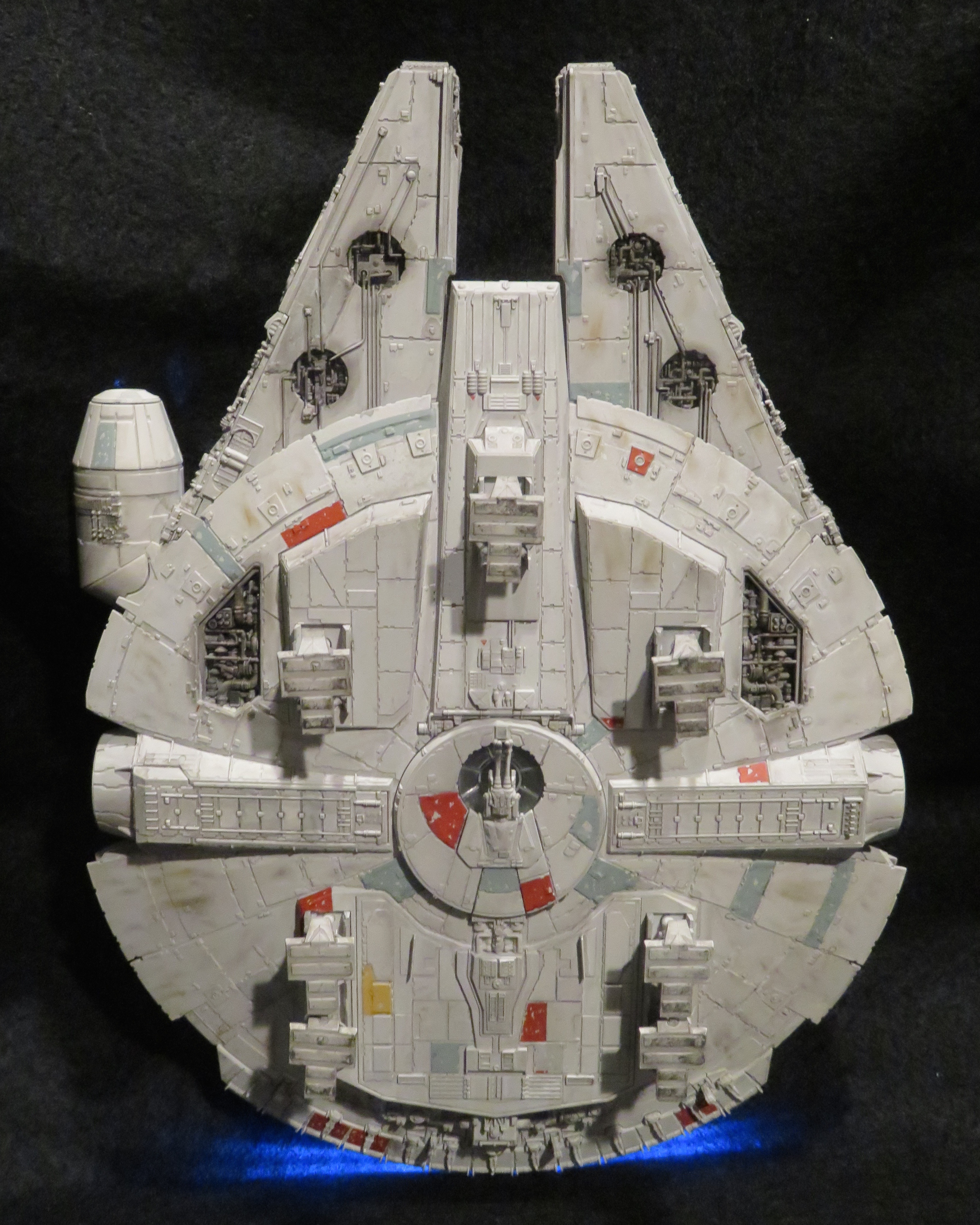

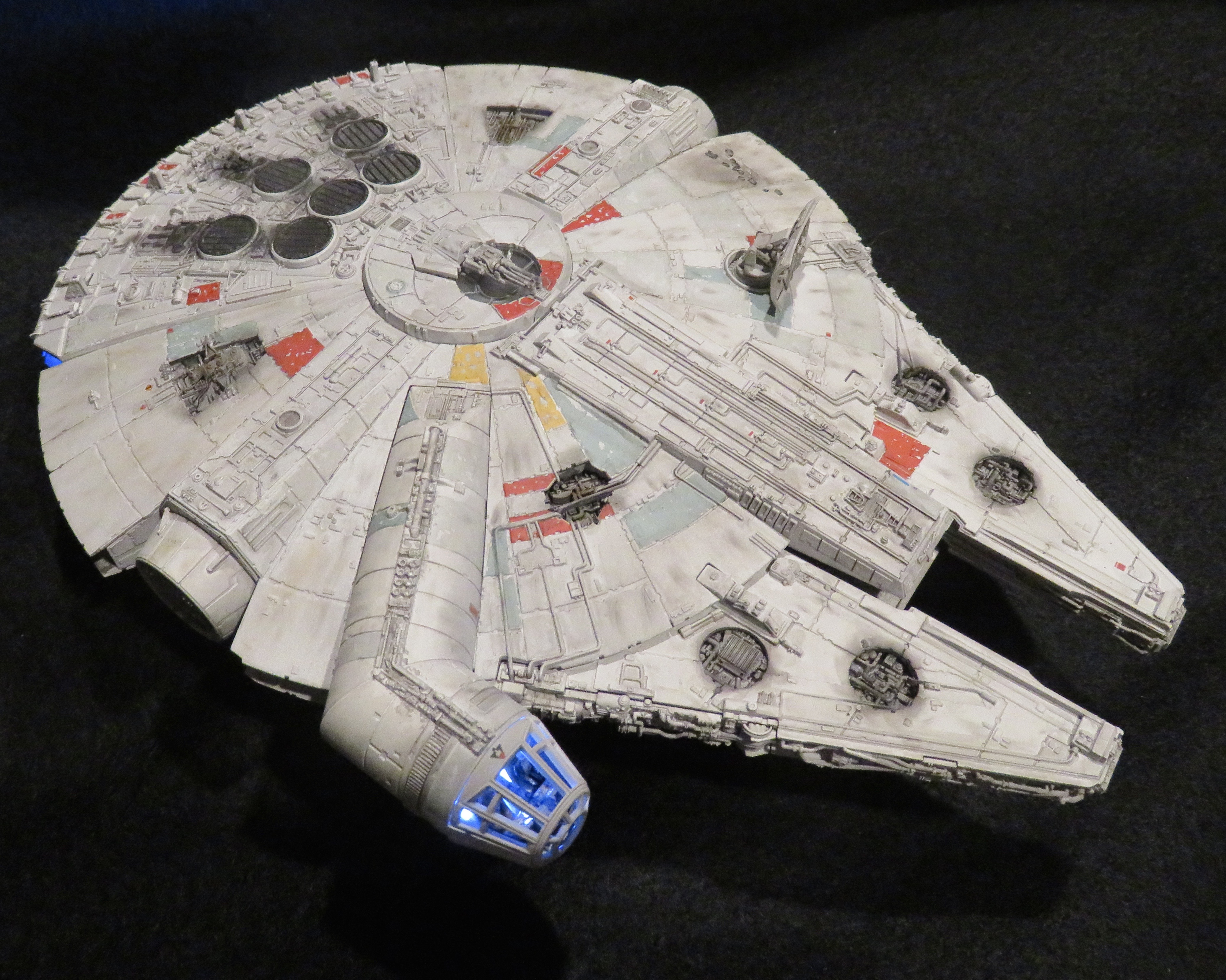

I've only been building models for about a year, started with the Deagastini Falcon and quickly discovered the Bandai kits, and decided to build them in between shipments of the Big falcon for practice weathering, etc.

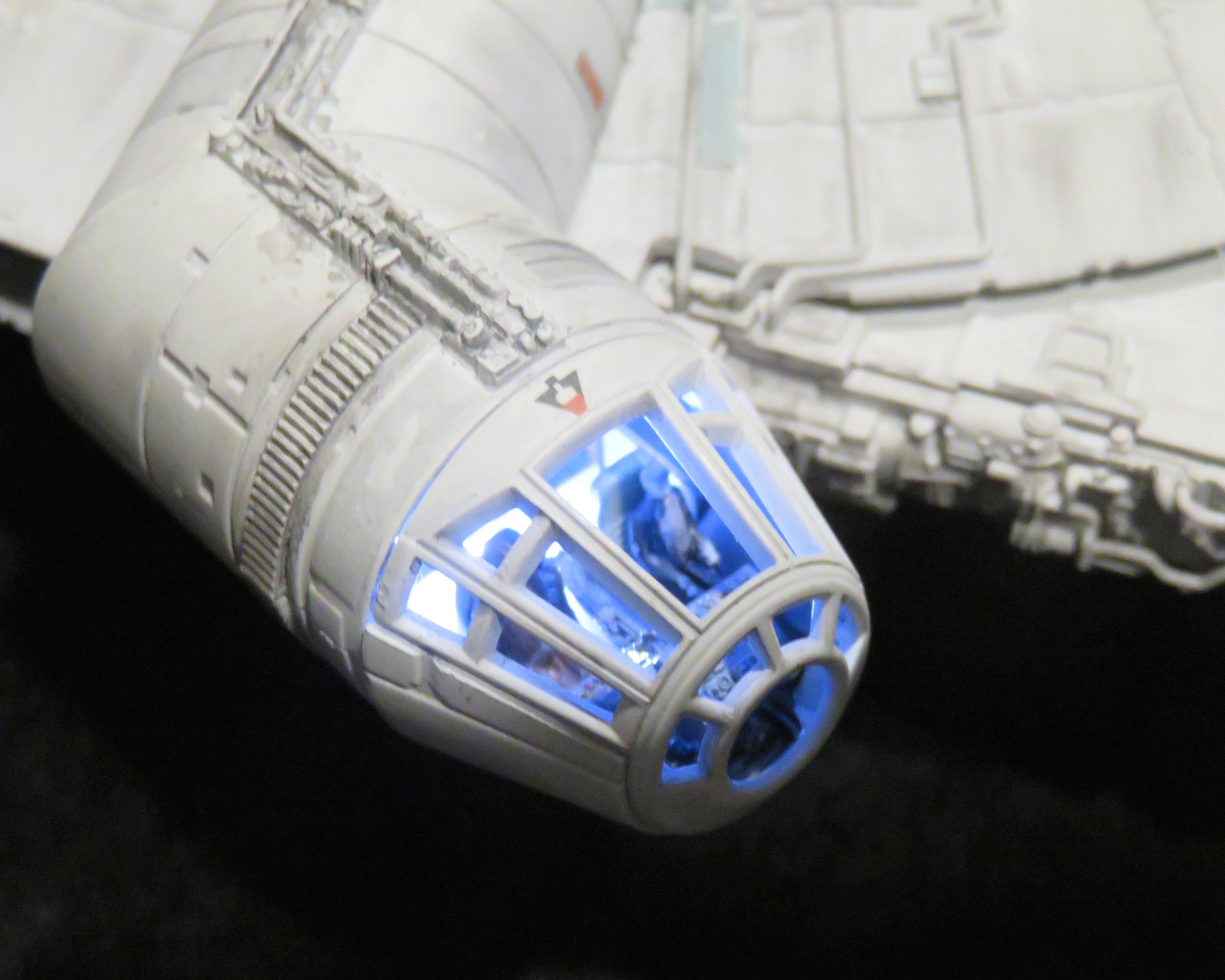

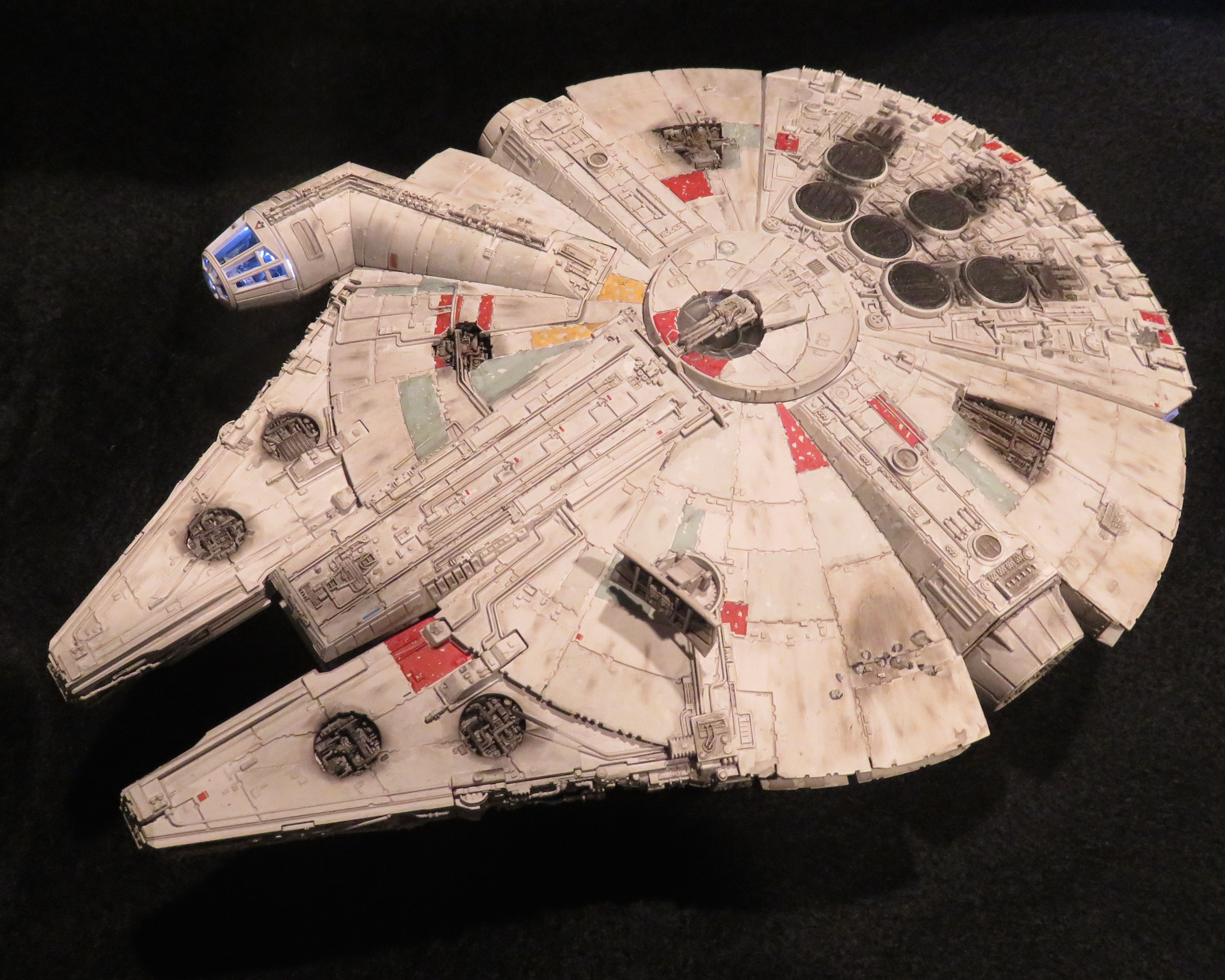

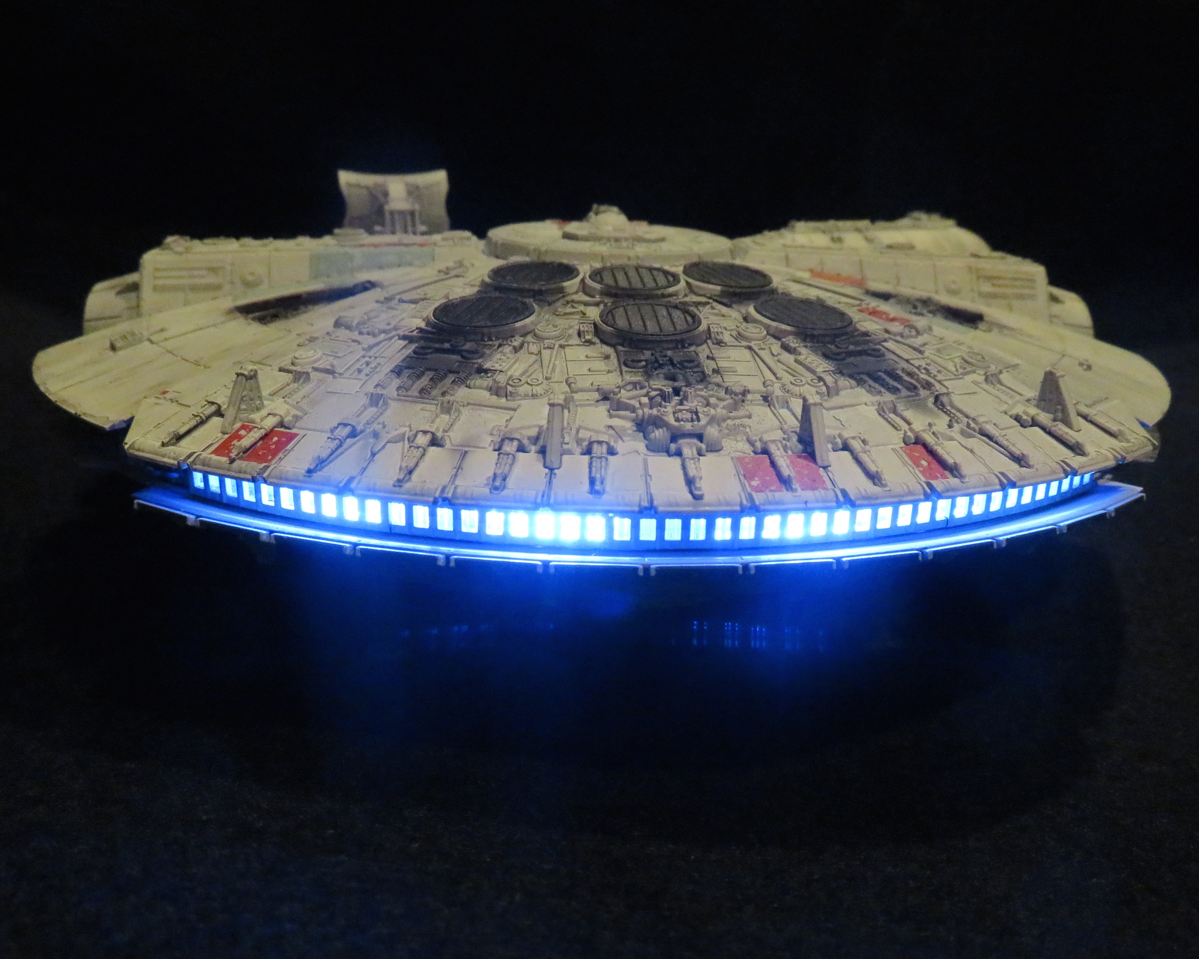

The Falcon is my 7th Bandi Star Wars kit, and the oneI put the most effort into, even added LED lights to the engines and cockpit. Think I am finally ready to call this one done...what do you think?
IMG_2592.jpgIMG_2594.jpgIMG_2596.jpgIMG_2598.jpgIMG_2600.jpgIMG_2602.jpgIMG_2604.jpgIMG_2608.jpg

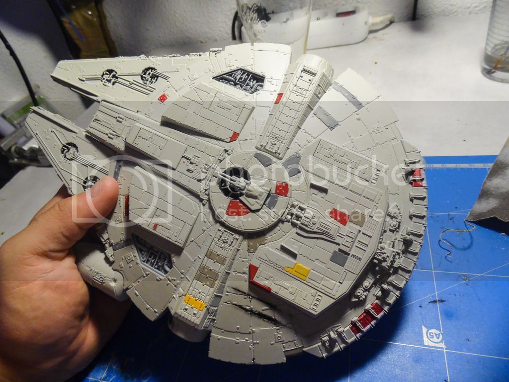

Weathering is now done on the top side. First time with oils. I think it came out pretty good. Going to paint and weather my bottom after the top dries.
Hard to believe the pile on the left turns into the ship on the right!!!

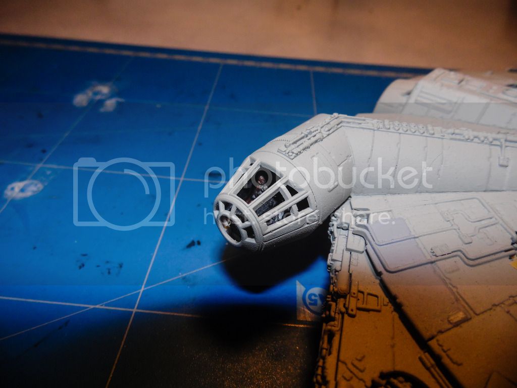

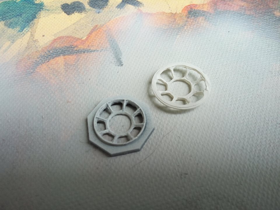

I wanted to out an idea i found on youtube about someone using a 1/72 tie fighter cockpit frame to replace the 1/144 MF gun turret window frame. I had to go this route because i had totally botched up one of my gun turret windows trying to make it 'windowless'. If it hasnt been mentioned, i hope this helps.
13686763_10154090379081195_1446902335380939024_n.jpg13681014_10154090380771195_5838540079416617848_n.jpg13769626_10154090381811195_860318014823409308_n.jpg
The Bandai Tie fighter kit comes with two versions of the frame so i used the windowed frame and saved the windowless one for when i build the tie fighter.
Second time around i was more careful and took my time. Last foto is comparison of the original MF gun turret window and the Tie cockpit window.
You will have to sand down the outer ring quite a bit for it to fit and then gun turret assembly to snap into place

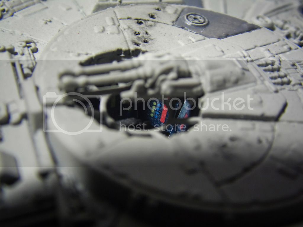

Another tip that i am trying is using stickers to detail the gun turret bays and cockpit. I found a jpeg of the gun turret bay decals and printed it on postage sticker paper. The bandai kit gun turret bays are tapered so i had to cut each panel and place it in separately to fit.
View attachment 646595View attachment 646596
I gave it a nice thick gloss coat so it will be more noticeable once the window frame and assembly is put together

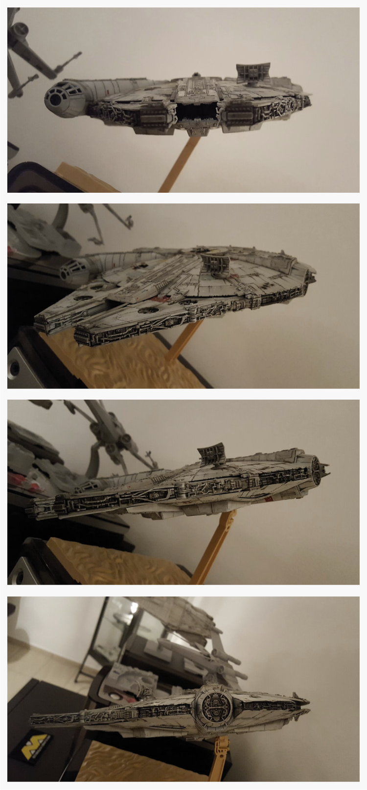

the streaks have been made with oilpaint by "502 Abteilung / Starship Filth" and a fine brush.
