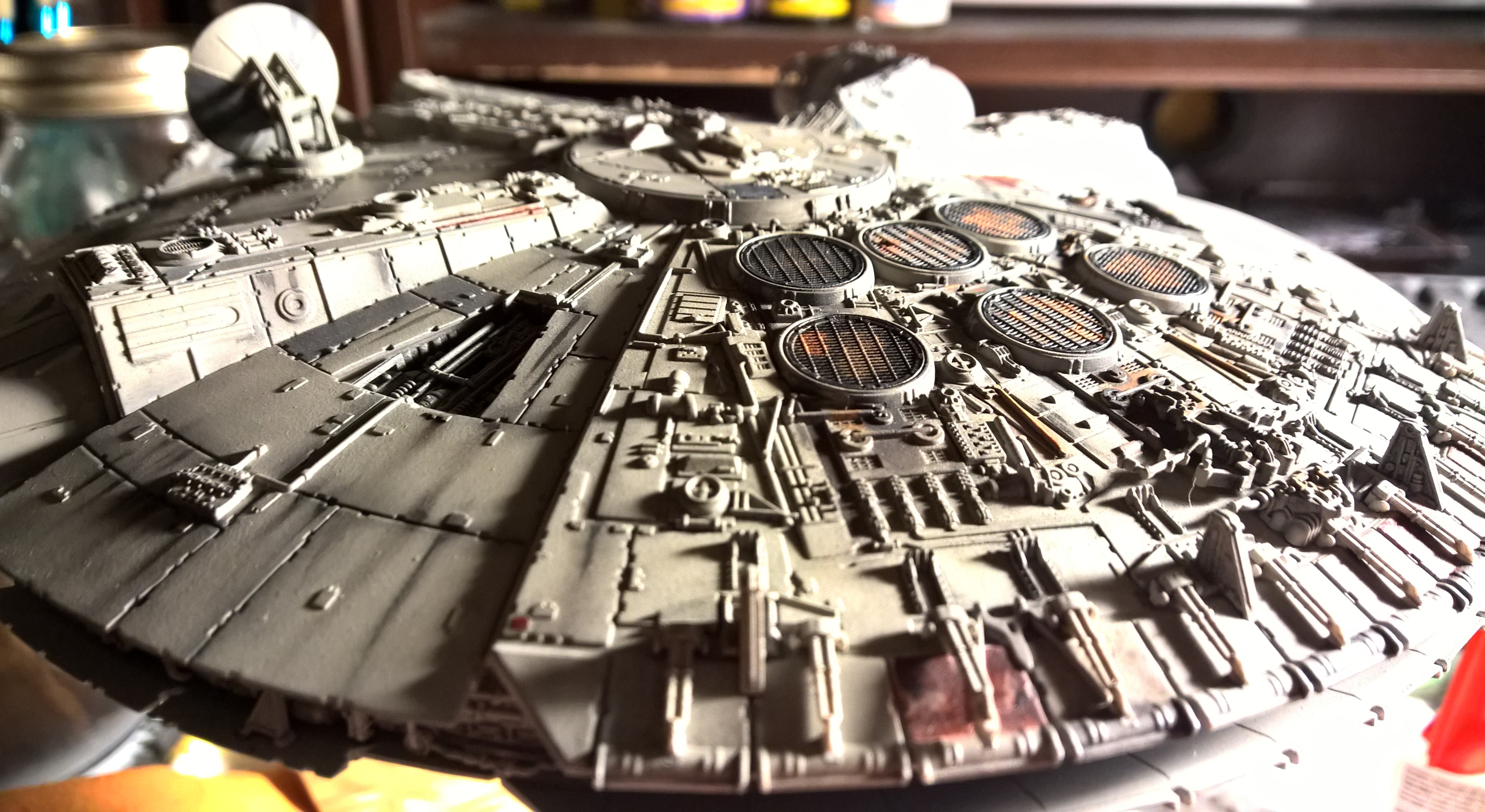

SO I'm starting to look at the photoetched engine grills. First off, I love the way photoetch looks.
Secondly, I hate working with it. I made the huge mistake of using Plasticine to keep them in place while painting....as you can see below
My next question is about Glue. I understand that you need to use crazy glue on this stuff, but what's the best way to apply it? I've never enjoyed using the stuff. It's not really thin enough, if you ask me. Also, I would love a way to clamp them all together. Is there anything this stuff won't stick to that I can use to sandwich it together? Saran wrap? Tin foil?
Because I'm gonna start weathering soon I figured that I would need a sacrificial lamb.....
So I gave the first fine molds 1/144 the ol' easy-off treatment

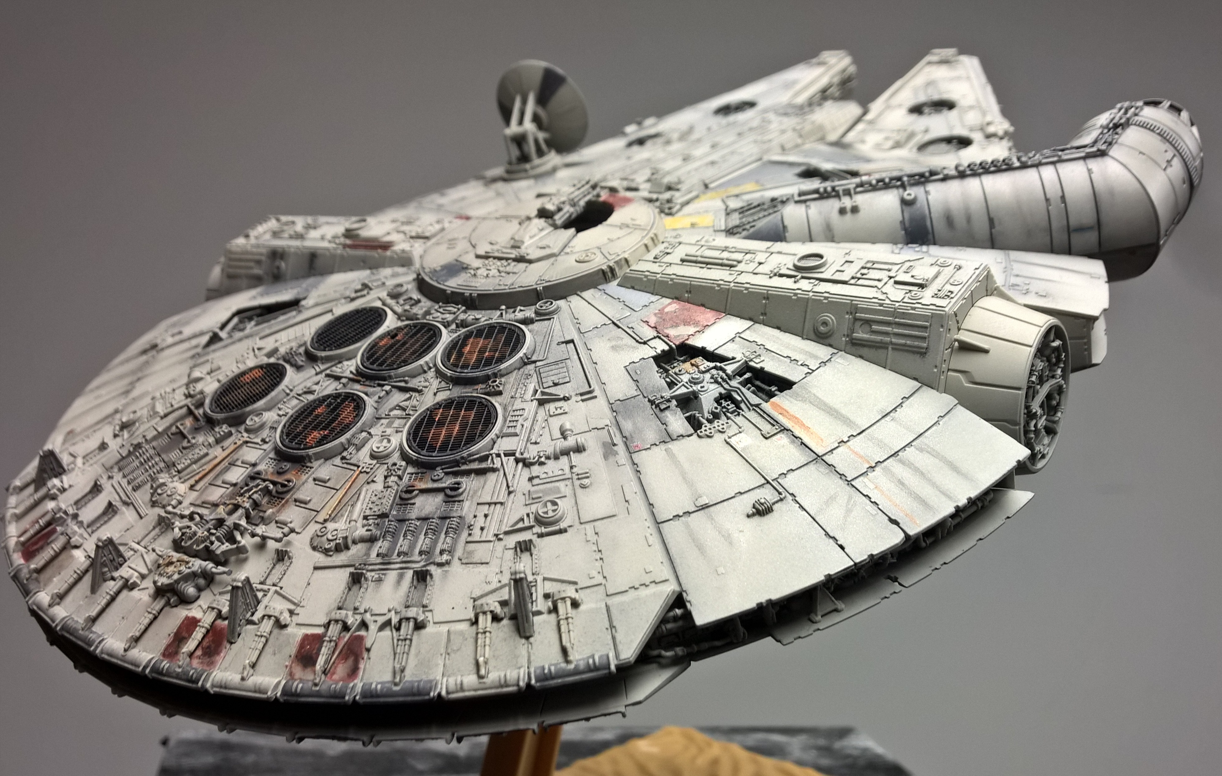

Finally getting close to finished with my first Falcon build. I've never done an MF before, but this little kit has been fun. Even with such a small kit,the weathering and finalizing takes quite some time.
Looks fantastic!!!
Because imho, the streaking can make or break a falcon, what is your secret???

Thanks, man! The secret is OPR... Oil Paint Rendering and layering. A few techniques I picked up from a very talented artist/modeler, Michael Rinaldi. Check it out here. That guy is fantastic when it comes to detail and his paint jobs overall.

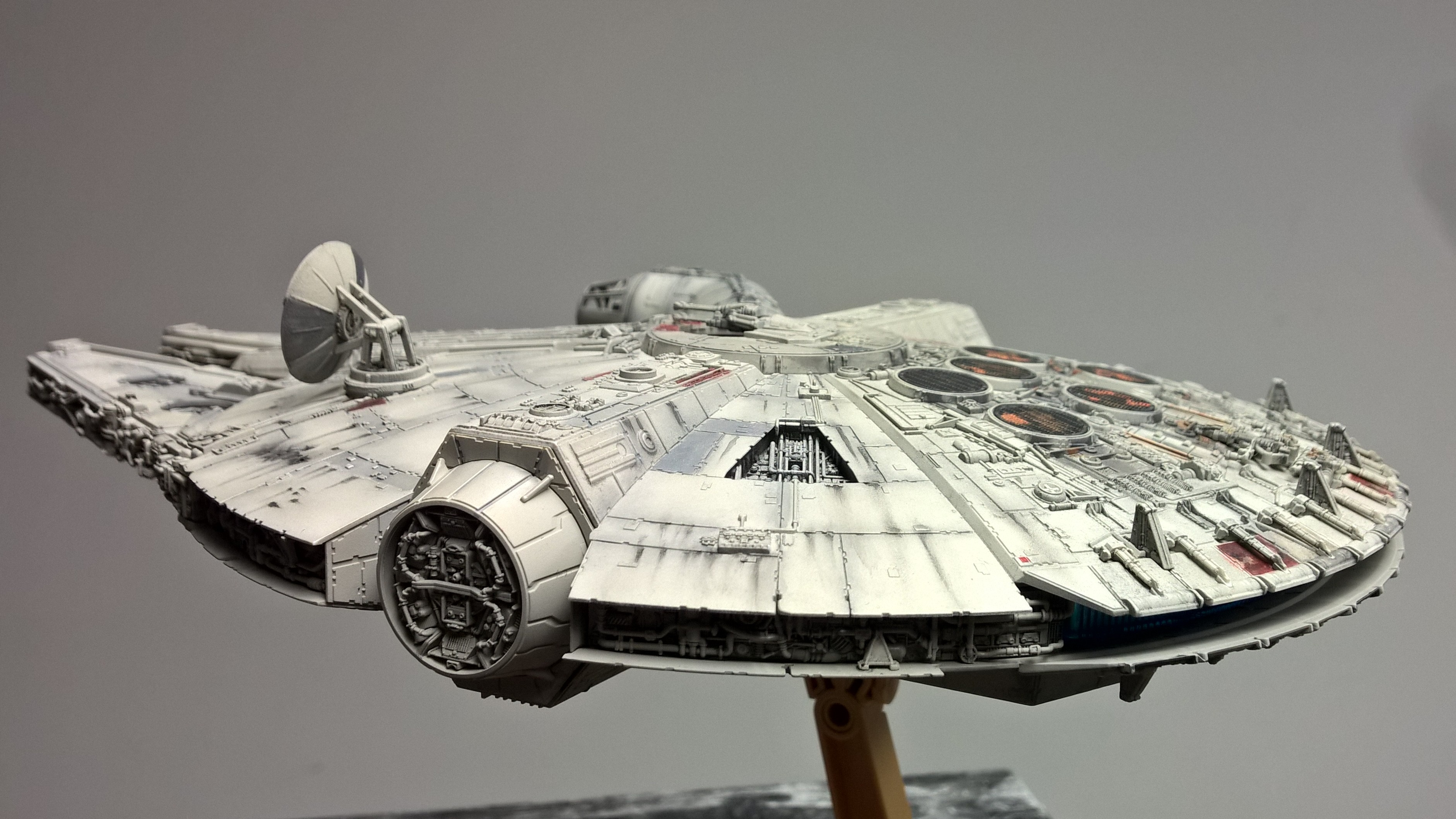

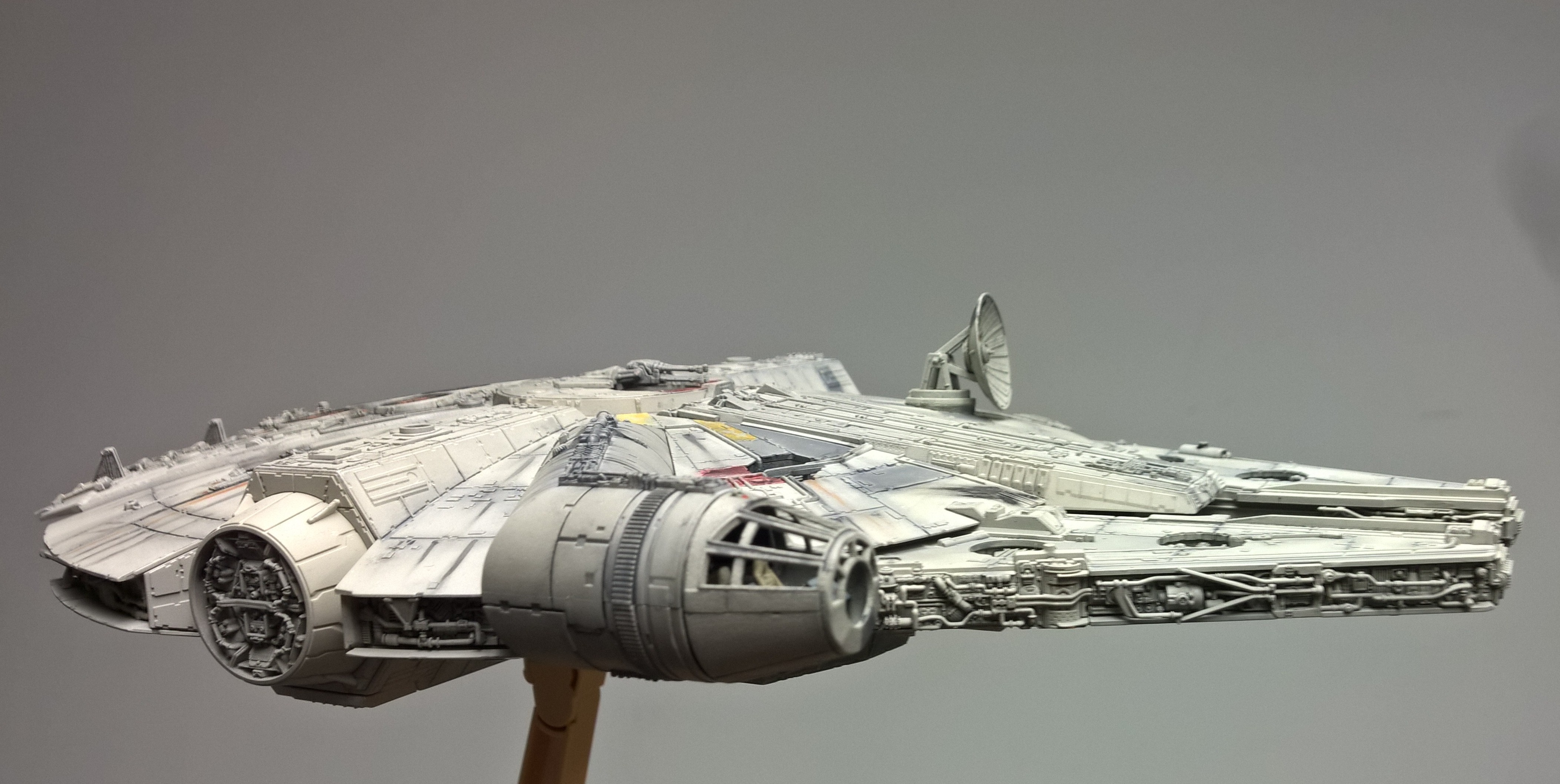

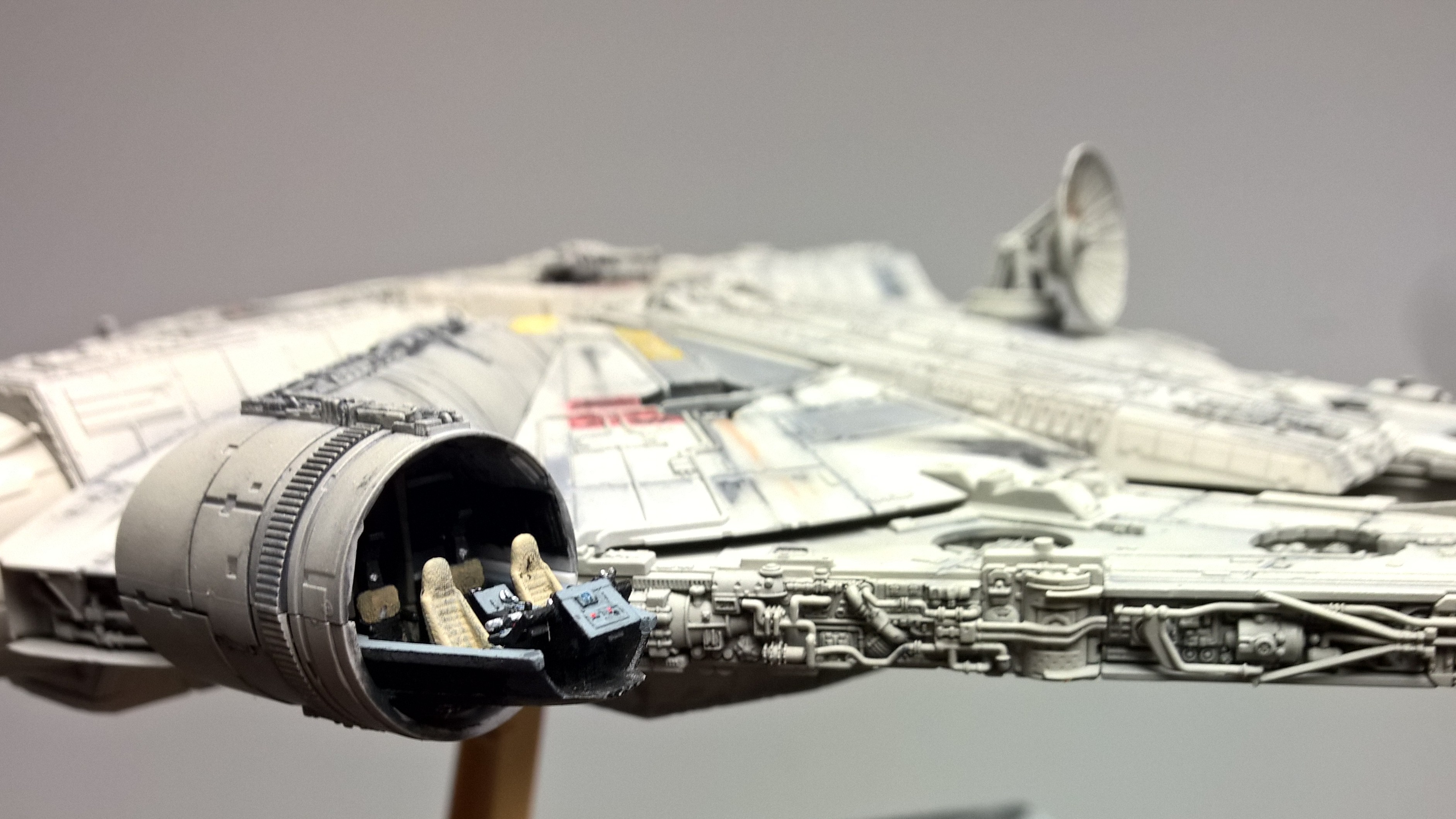

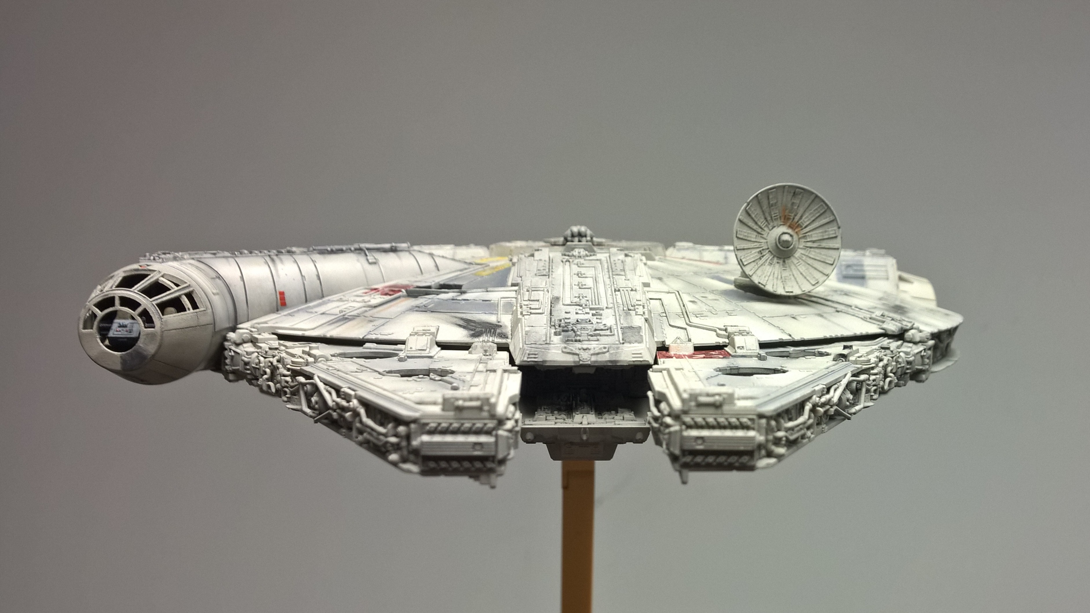

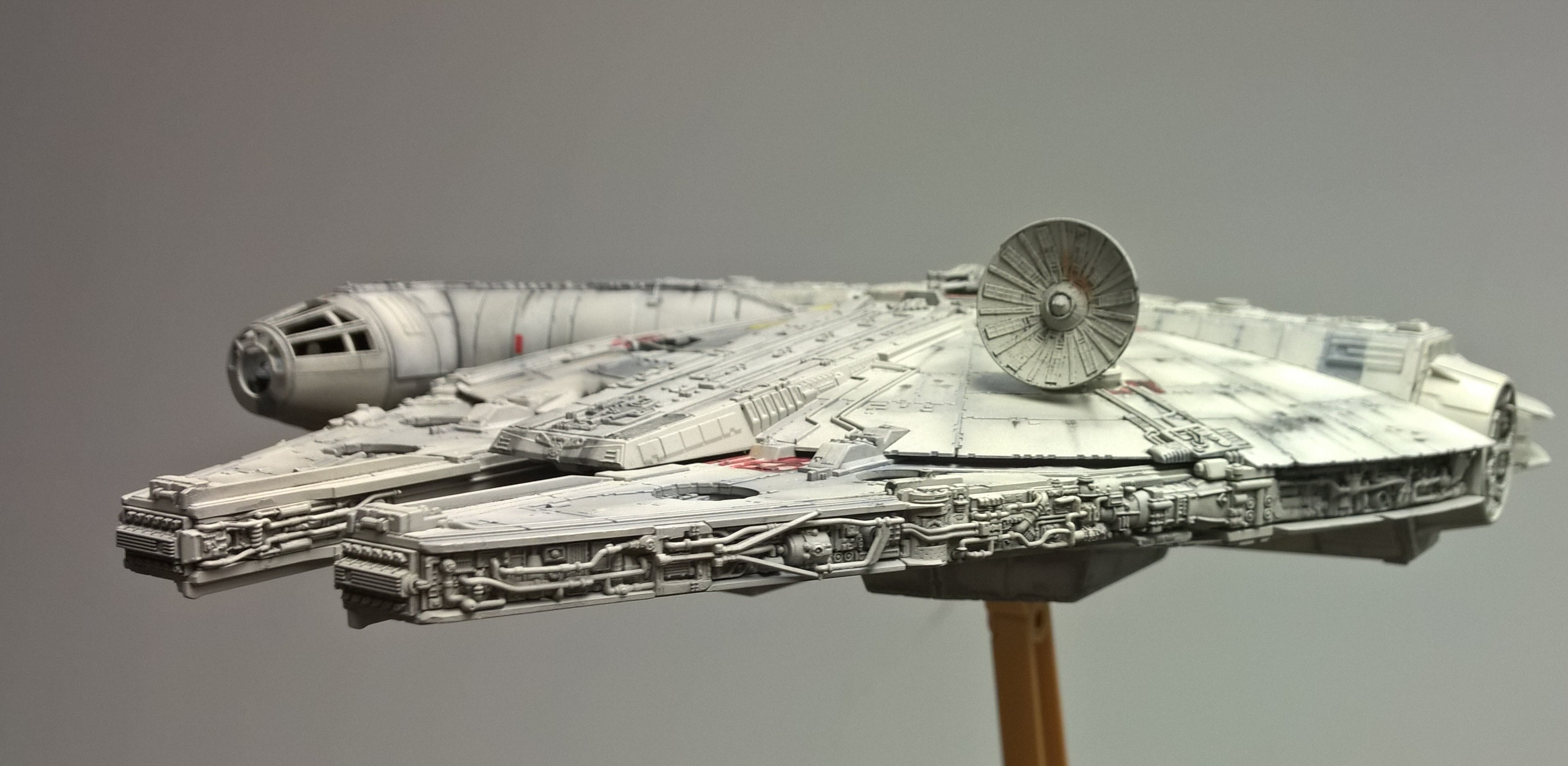

I've not finished the base, but here's my take on the Force Awakens Falcon. The model was primed in Citadel black from a rattle can, with a couple of light base coats of that rare beast Tamiya AS-20. For the panelling I used the supplied water slides, with lots of coats of Microsol. Everything else was completed with multiple pin washes in brown & black, with a couple of spots of soot airbrushed on (it was my first time using an airbrush, so be gentle!), and finally the streaking was a built-up mix of brown & black Gundam real touch markers (these blend up so well, and are very forgiving if you have an incident!).
Looking at some of the other builds of this kit online, it seems to be all too easy to end up with a model that's a little too dark, so I tried to keep the weathering subtle to keep the overall base colour bright. Adding a touch of brown to any black washes also helped to keep the tones warm after the harsh black primer coat.
