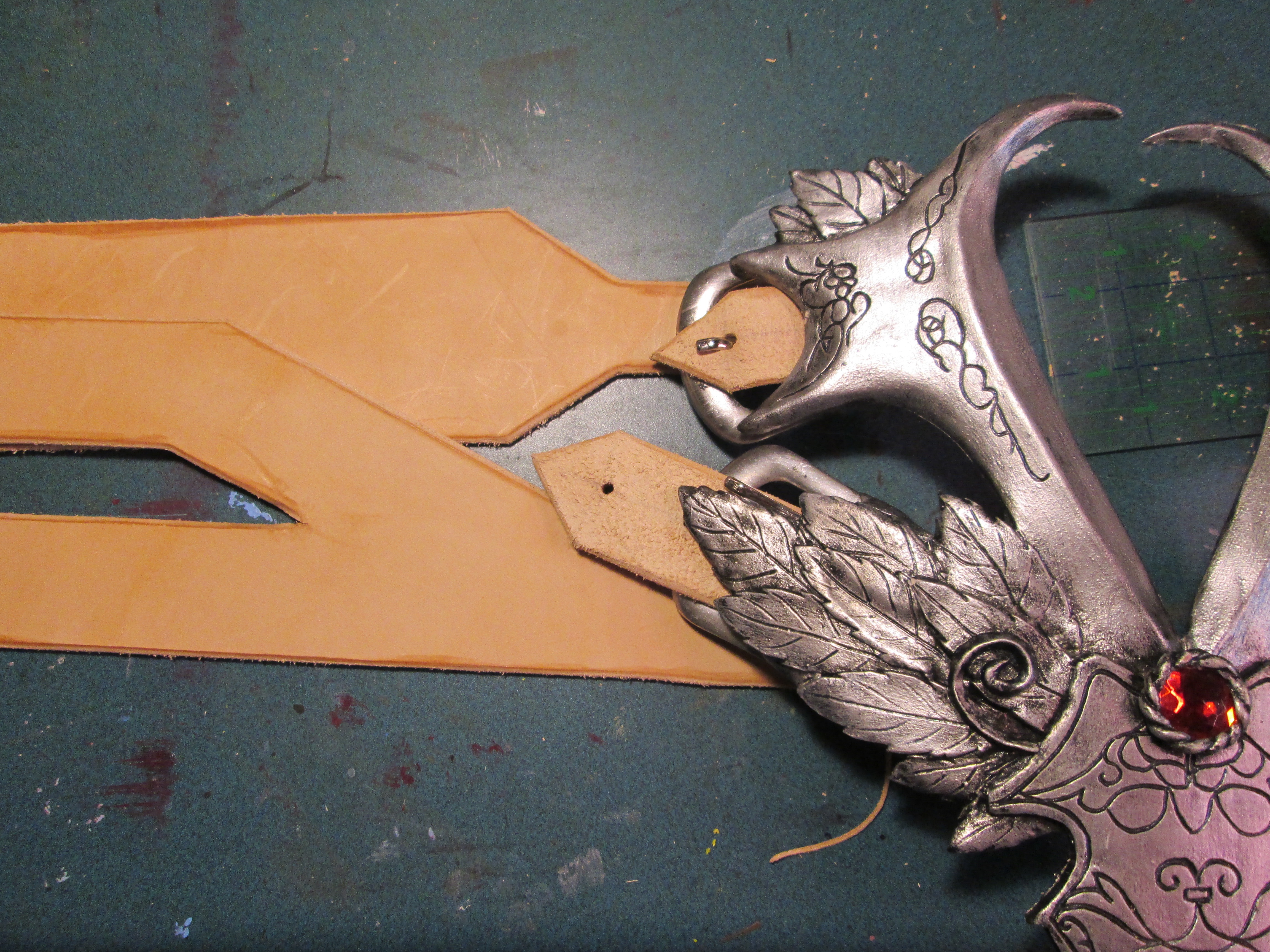

The first step in my upgrade was the belt. I detached the old belt pieces.
Here you can see the construction of the buckle.

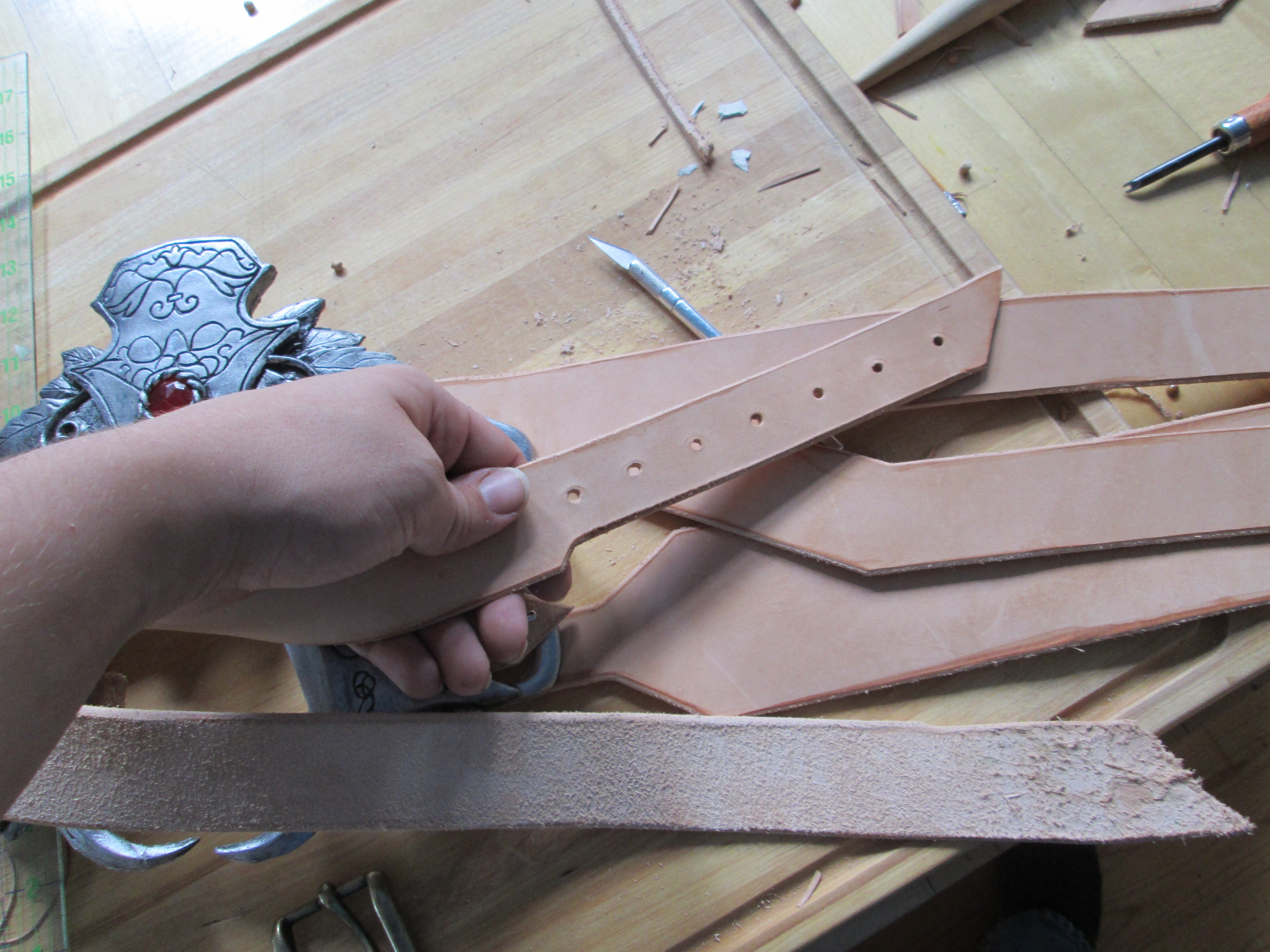

From top down: the original vinyl piece, the denim piece cut out for sizing, a practice leather piece cut out, and the final pattern traced out on new leather.
The final cut out pieces.

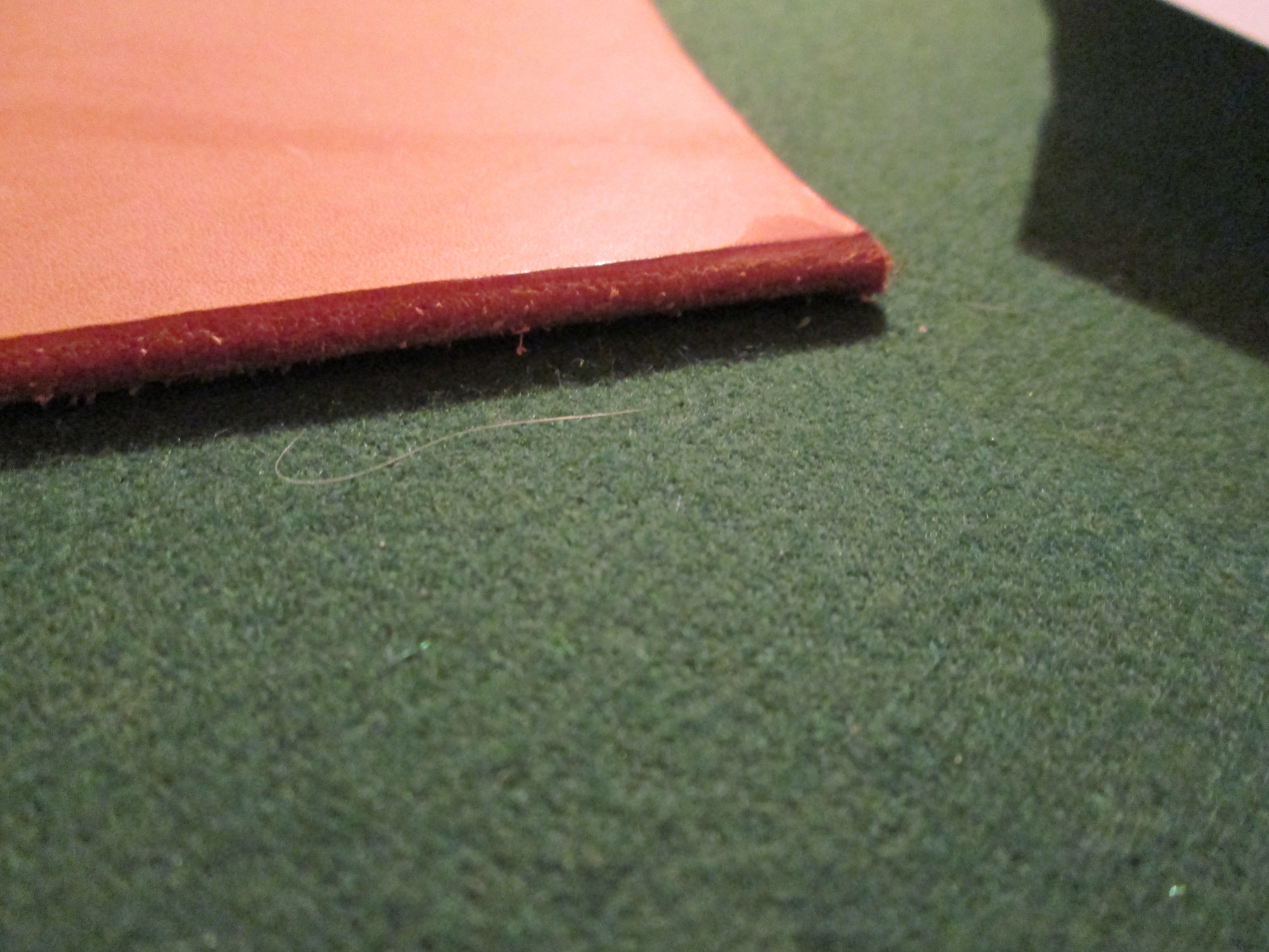

The edges are wetted and slicked down, for a nice finished look.

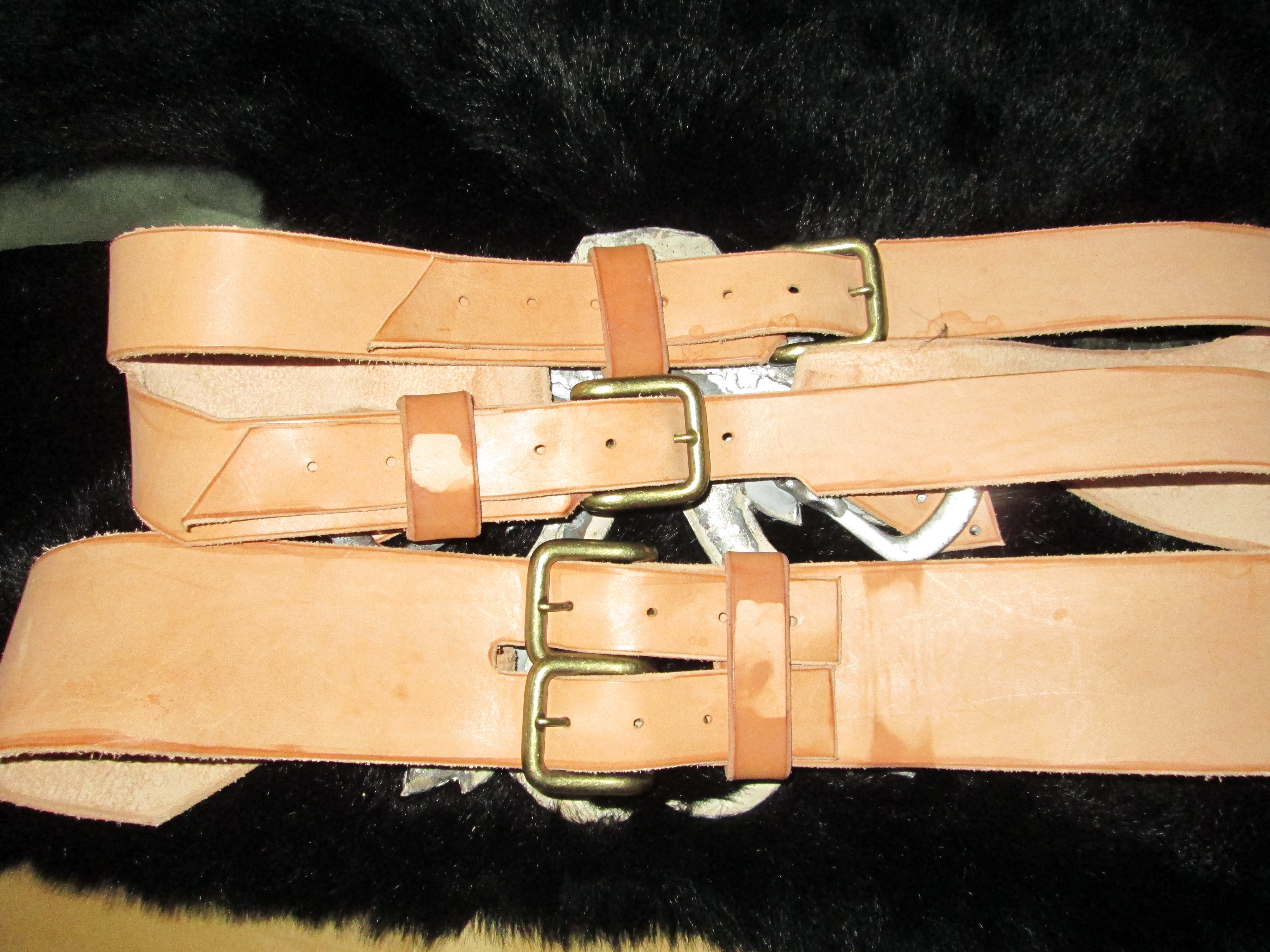

Here is the buckle with leather attached! Next, for some hardware...

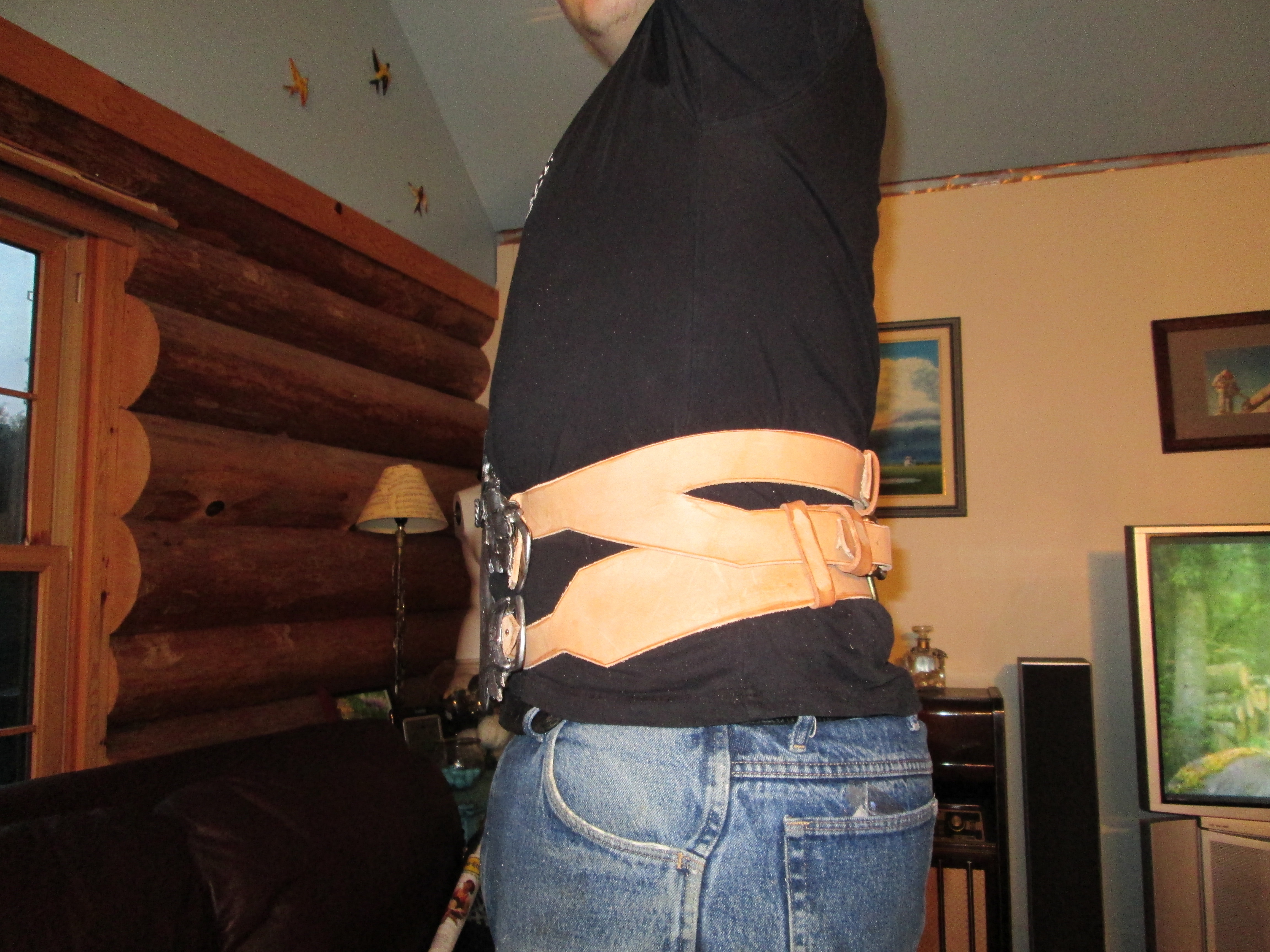

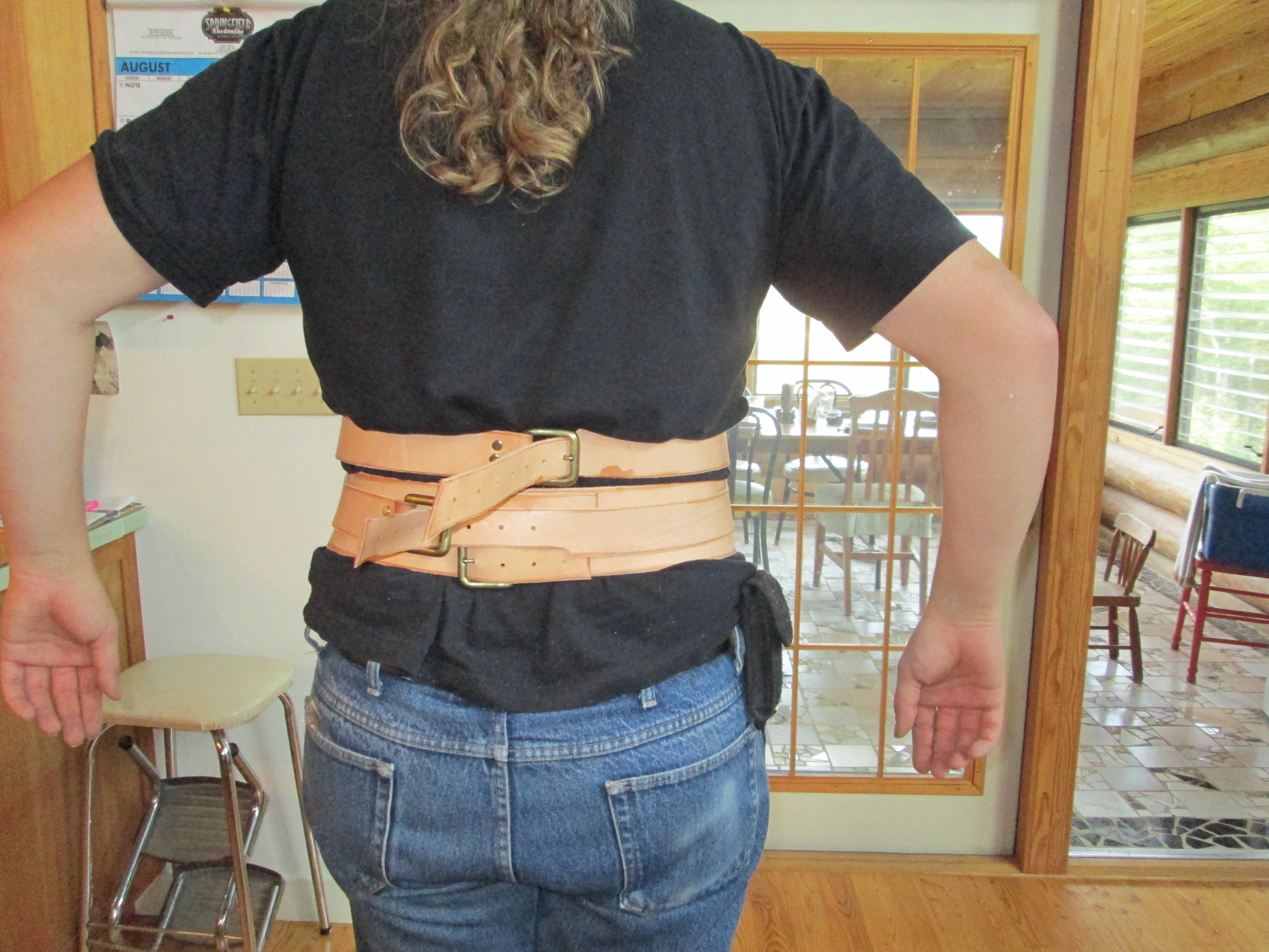

Now the belt is wearable!
Now to get those loose flaps of leather under control:
This is as far as I can go on the belt, until I get the boots, so I can match the dye. Next up: spaulder!

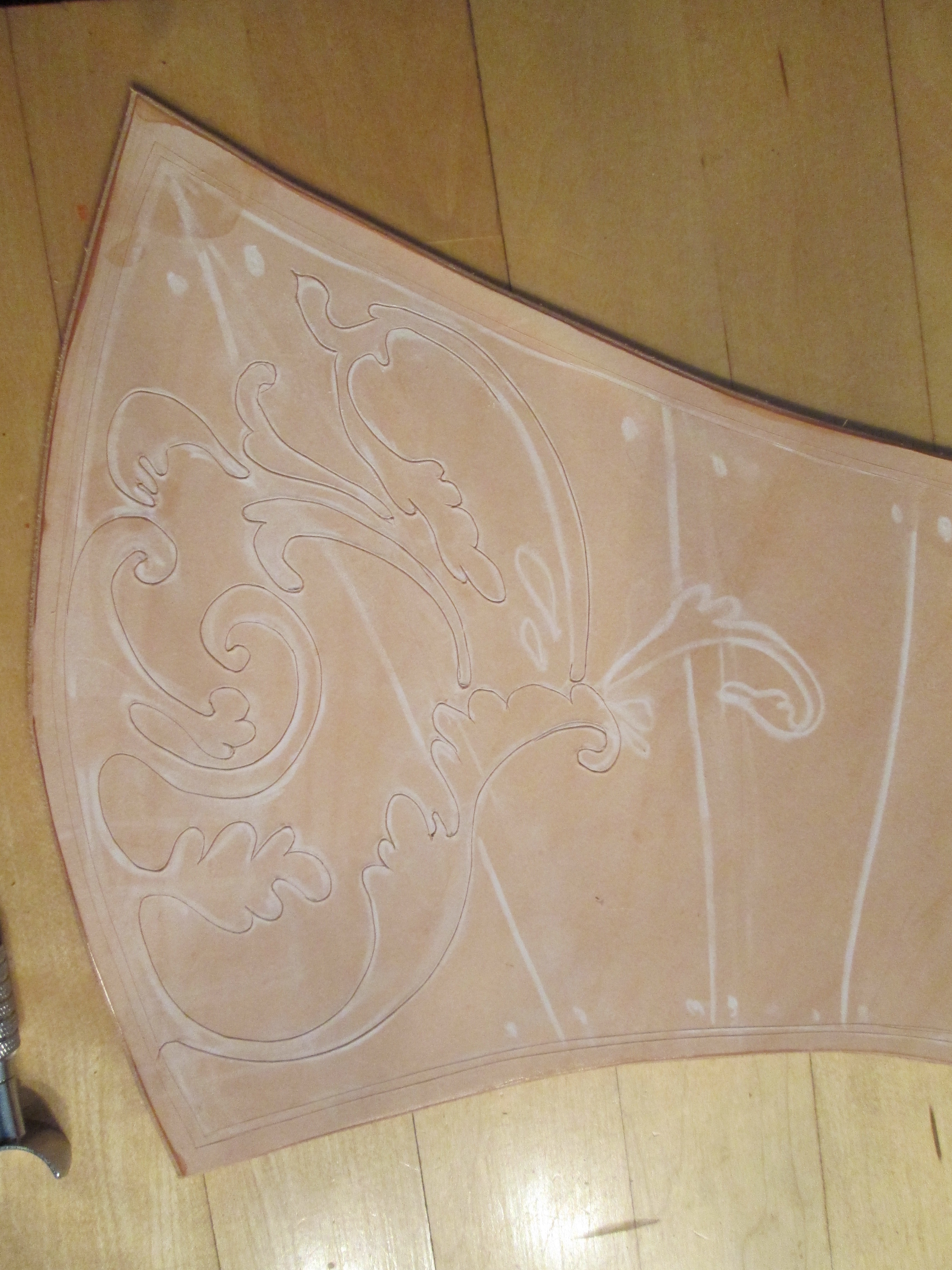

The edges were slicked down, and the pattern drawn on in chalk. The pattern is taken directly from the video game.
The pattern is traced with a swivel knife, wetted, and pressed down with a butter knife.
The straight line are meant to be different section of the armour, I think. I pressed a hard line with the edge of the butter knife, and went over it with the round end of the edge finishing tool. This gave it a nice segmented look. Unfortunately, my studies will keep me busy until christmas break, but I will update then, on my progress!

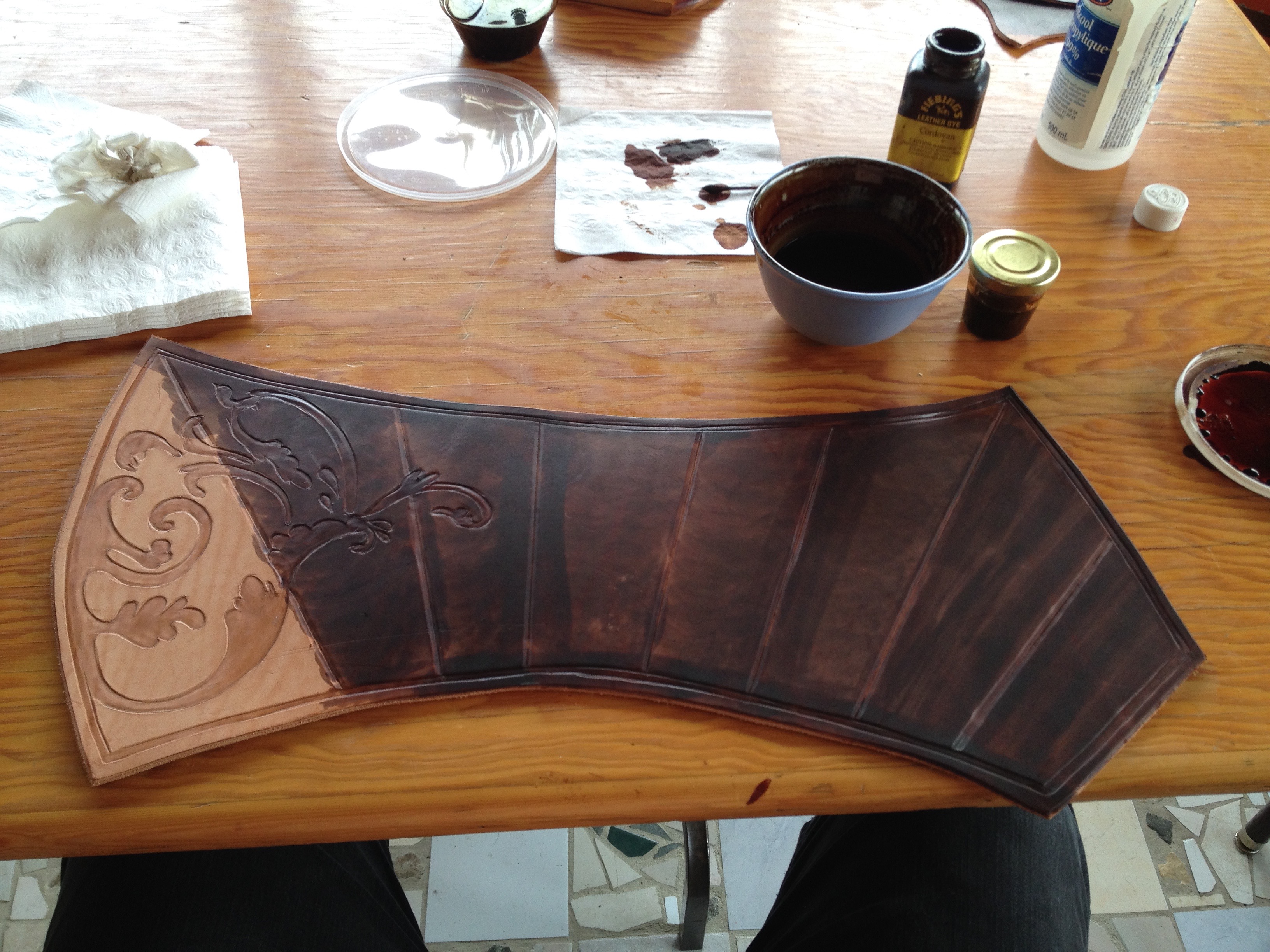

Here's an update. Been really busy lately with school, so I haven't worked as much as I wanted to. But I have the spaulder dyed, riveted, and cape attached!
Dying the spaulder! I used cordovan leather dye, and at first I tried to do a light-ish coat. As you can see, the colour went on a little splotchy, which is what always happens with leather dye. You have to get it pretty inundated for it to get nice and even. So I did another coat:

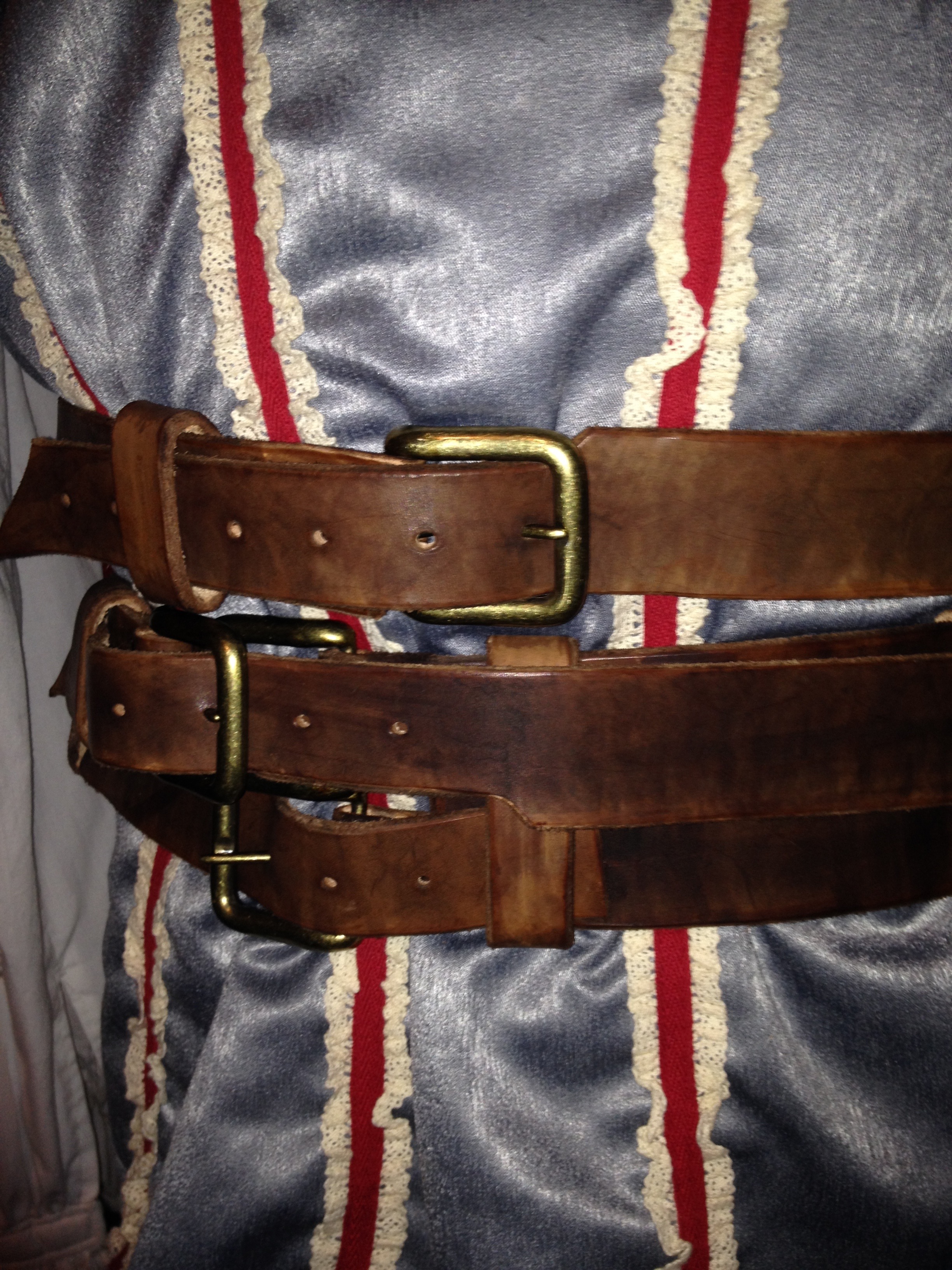

I liked the look of that much better. While I was dying the spaulder, it was time for the belt to get dyed as well:

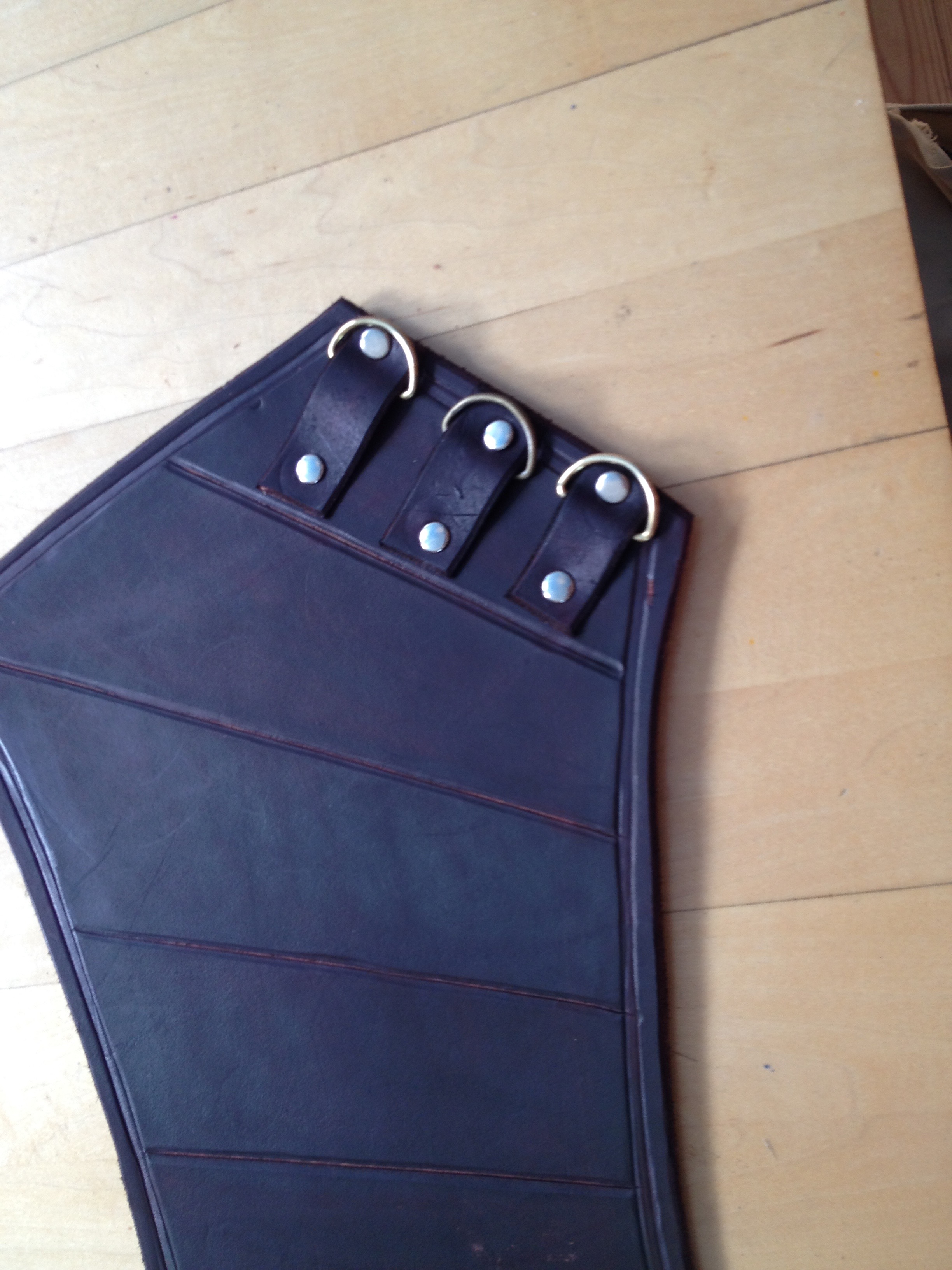

Now for the hardware on the spaulder, and re-attaching the cape. The previous design was good, just D-rings riveted on with flaps of leather, and the cording attached to that.
Now to attach the cape, more rivets! A thin strip of leather on the other side sandwiches the cape in, and the strip is riveted to the spaulder.
