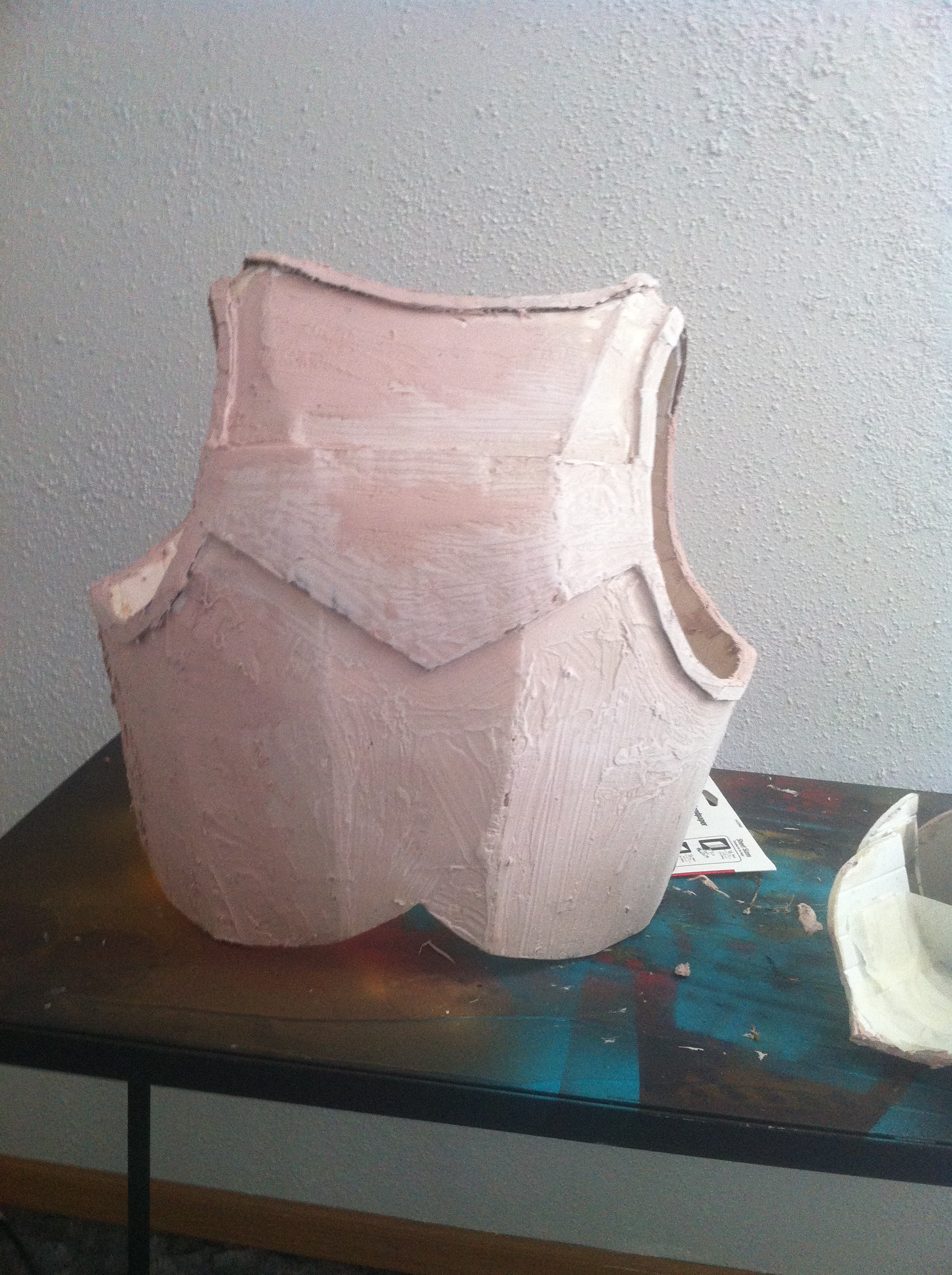

This is the chest piece, made with a base of foam board and the brown is obviously cardboard. Pretty simple!
Next step is resining, and bondo, pretty (if not labor intensive) easy so far.

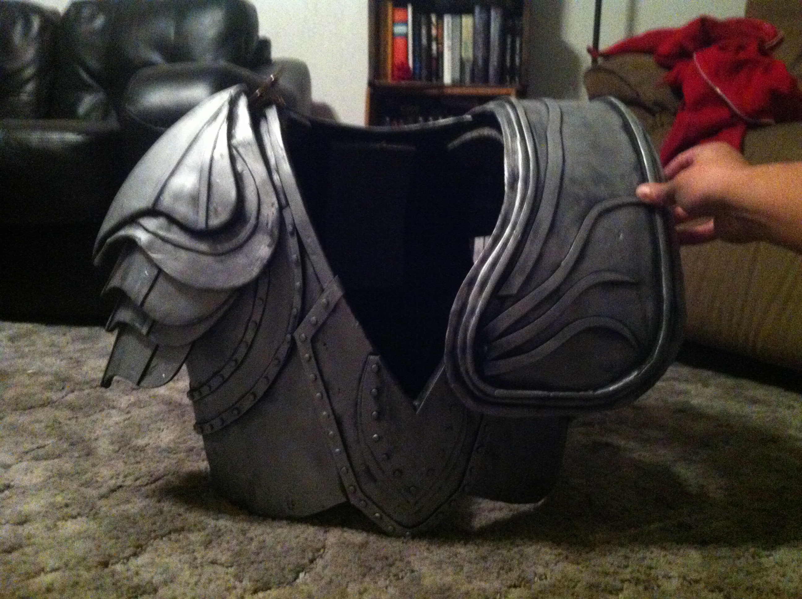

After a few coats of truck bed hardener, and a nice round of dry brushing, you're left with this!
Pretty Nice so far.

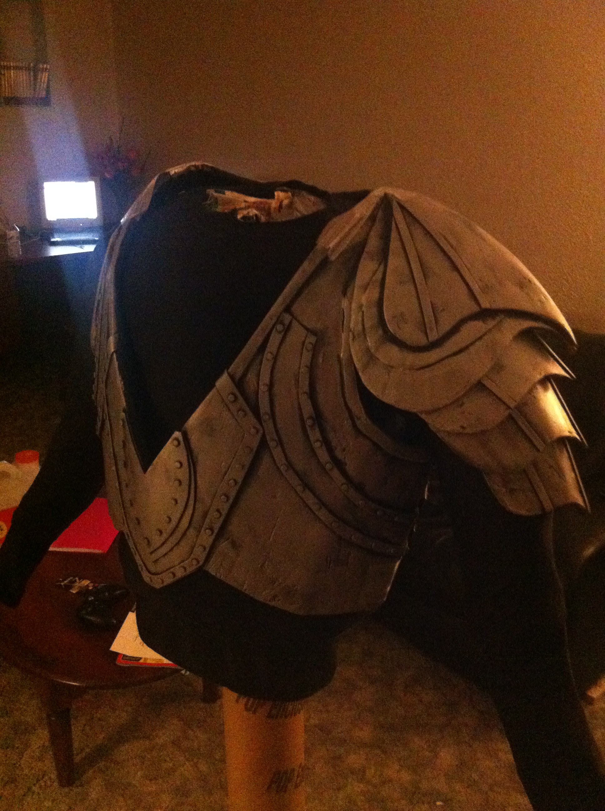

And one more thing, the other pauldron, its very strange.....more of a football shoulder pad then an actual
"pauldron"
And thats where I'm at with the armor everyone, not bad..could certainly be much better...but it looks ok to me!

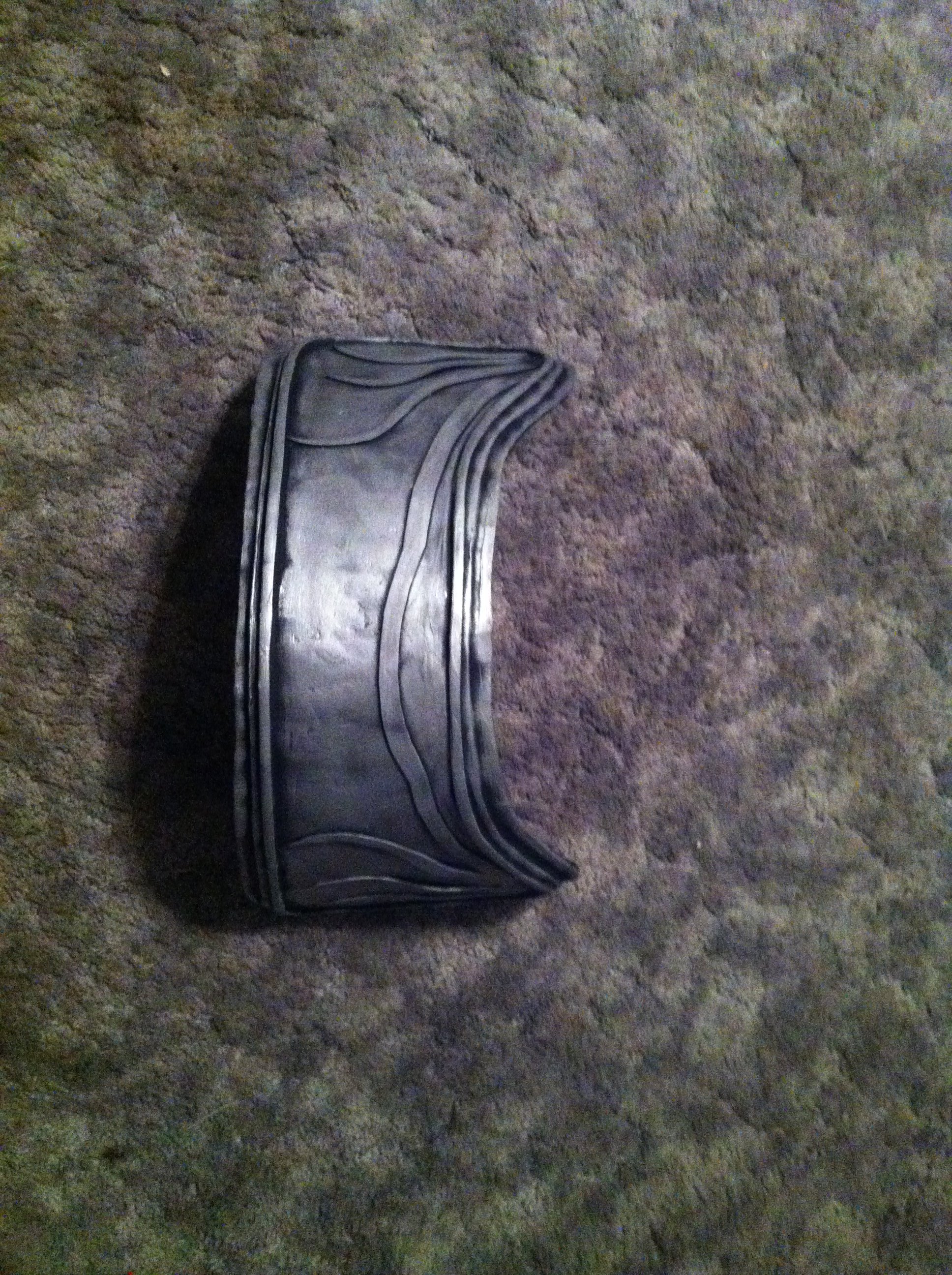

Alright ladies and gentlemen! I have some updates on the armor.
Right bracer 57.89234% complete....just need to cast up the hidden blade in the picture, and fit it for the straps and buckles!

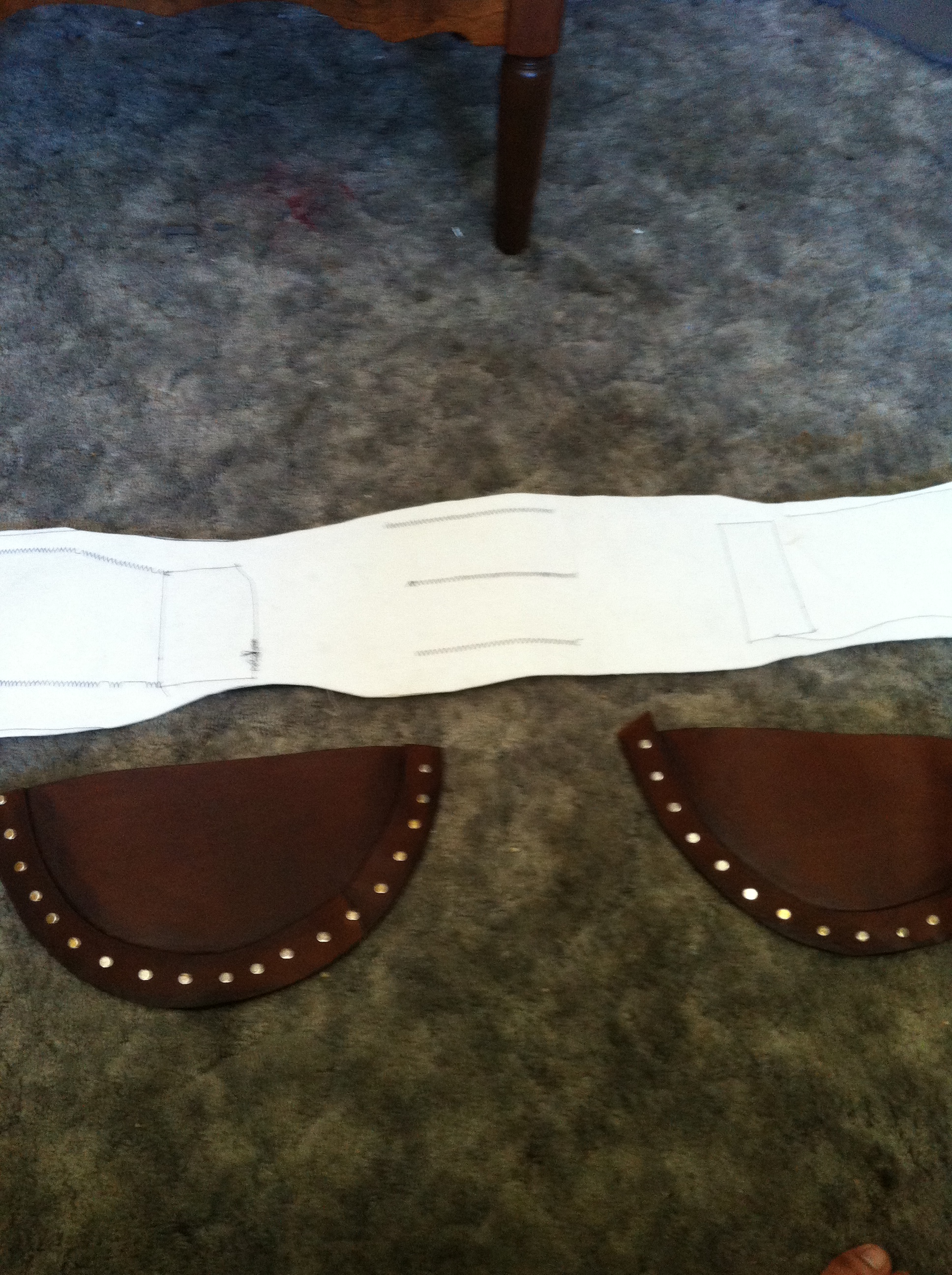

I am returned, and I have brought with me pictures of my latest exploits.
These pictures are of the iconic right bracer the protatanist wears during AC: Brotherhood.
I've also started on the cumberbund, I havent wrapped and glued the red to the backing.
