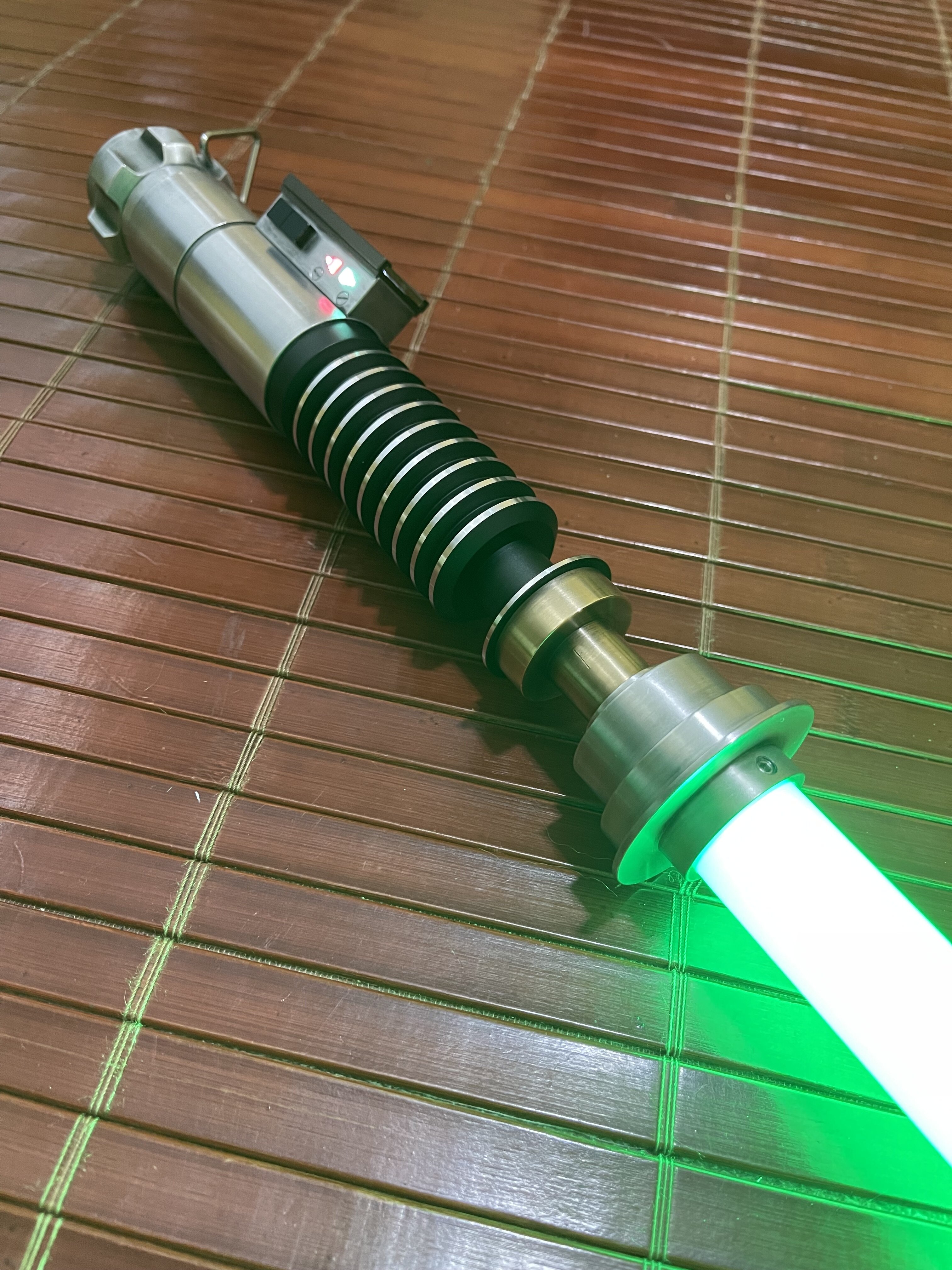

Looks great.
You can dial back the weathering quite easily with some steel wool or scotch bright if you’d prefer it not be as weathered.
I bought the same version that you have and I removed much of the weathering on mine so here’s a few pictures of what you can do if you desire. Also this has Starkillers updated pommel which I weathered and buffed.
I followed your lead and removed some weathering. I used steel wool and some automotive scratch polish. I am much happier with the look.
I also used a ratchet screwdriver with star bit to help get those setscrews tighter.
Now that I have taken care of those little annoyances, I think I am ready to purchase some fonts.
Looks great. Yea I don’t think it was ever as weathered on screen as they made it. But when you dial it back some it looks right on.
