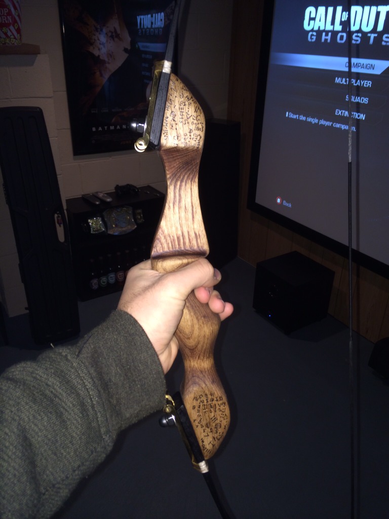

Used Hobby Lobby's Artificial Sinew "Natural" 228312 for the cord on the chock, then did a quick black acrylic wash. Most of the detail is lost in the bright sun.
The symbols were burned with a wood burner kit from Hobby Lobby.
https://s20.postimg.org/q1rnlrrdp/Stained_grip_w_chock_limbs_mounted_n_sinew.png
I eventually replaced the original knobs with stainless steel that I brass plated with a torch.

Correction, I used 220 to remove the logos and rough up the risers before repainting them flat black.
I removed the original wood stain from the grip using various grits. I think I started with 60 and worked my way finer.
Never removed all the original stain. Some remained in the larger open pores in the curved areas. That is a durable finish whatever it was.
Thankfully, what remained integrated well with the weathering plus there is alot of other details to look at and help distract from my laziness.
