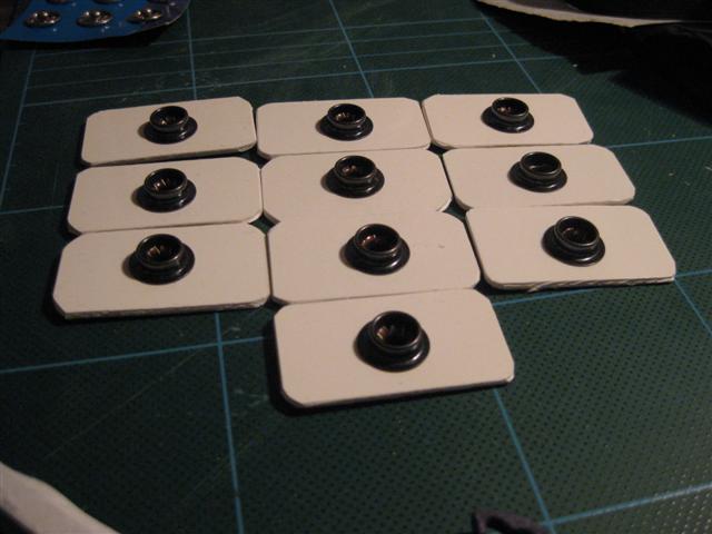

Instead of some of the stormtrooper snaps, you can use leather snaps which hold MUCH STRONGER, and can be a bit of a pain to un-snap, but if your point is to hold it on, get yourself some line24 snaps. You can attach them to a piece of fabric, leather, plastic, then attach that to the belt with glue, epoxy, etc.

On the snaps, you don't push the snap through your belt or armor. You attach it to a separate piece and glue that piece to the belt / armor.
How it is done on a stormtrooper.
