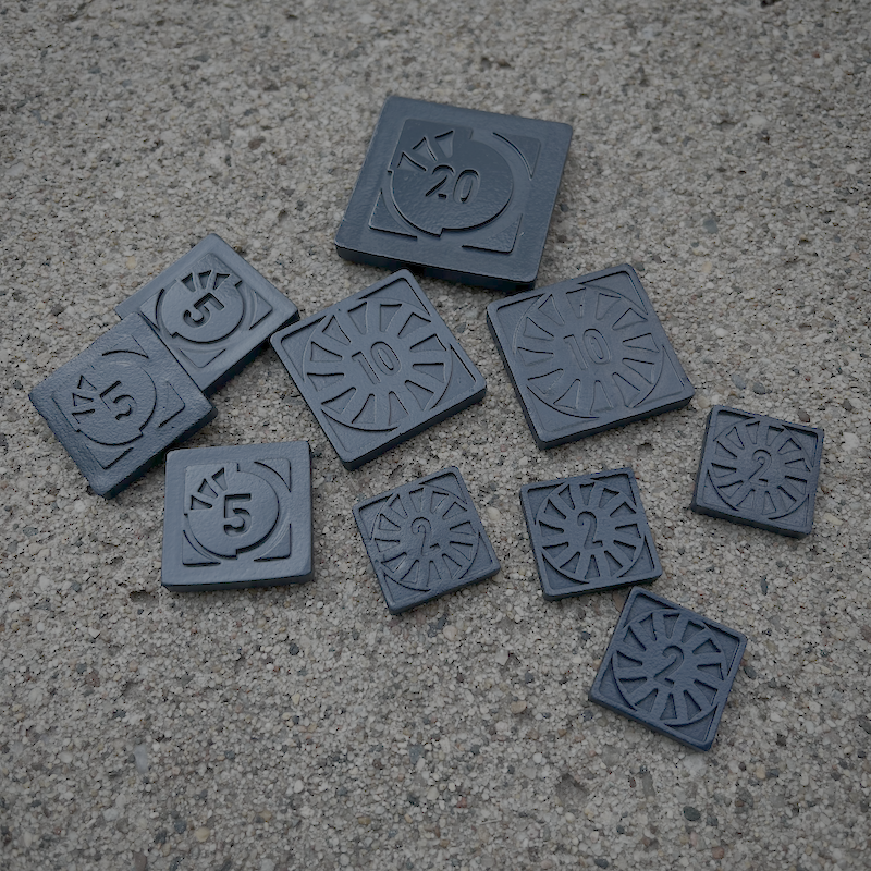

Also working on credit tokens, so thank you so much for this really excellent photo!
I've been using screenshots I captured from Adam Savage's visit to the set (season 2) on Youtube. This gives me some sense of scale; I've been working on the assumption of 32/23mm square for the 20/5 credit pieces, but I'm thinking to bump it up to an even 35/25 respectively.
And now that I've been comparing these to one another (I'm using Inkscape to compare measurements) and to the shot of the chits in Adam Savage's hand (as well as trying to think like a person who's modeling these to 3D print them and cast them in pewter, as they did in the show), I'm thinking that the size of these is more like: 40mm square for 20CR, 32mm (but maybe actually 30mm, for "round numbers" reasons) for the 10CR, 25mm for the 5CR, and 20mm for the 2CR, and they look to be 4mm thick (at the edges; for the 20CR and 5CR chits, the raised sections add a little, which I'm going to need to account for).

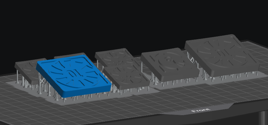

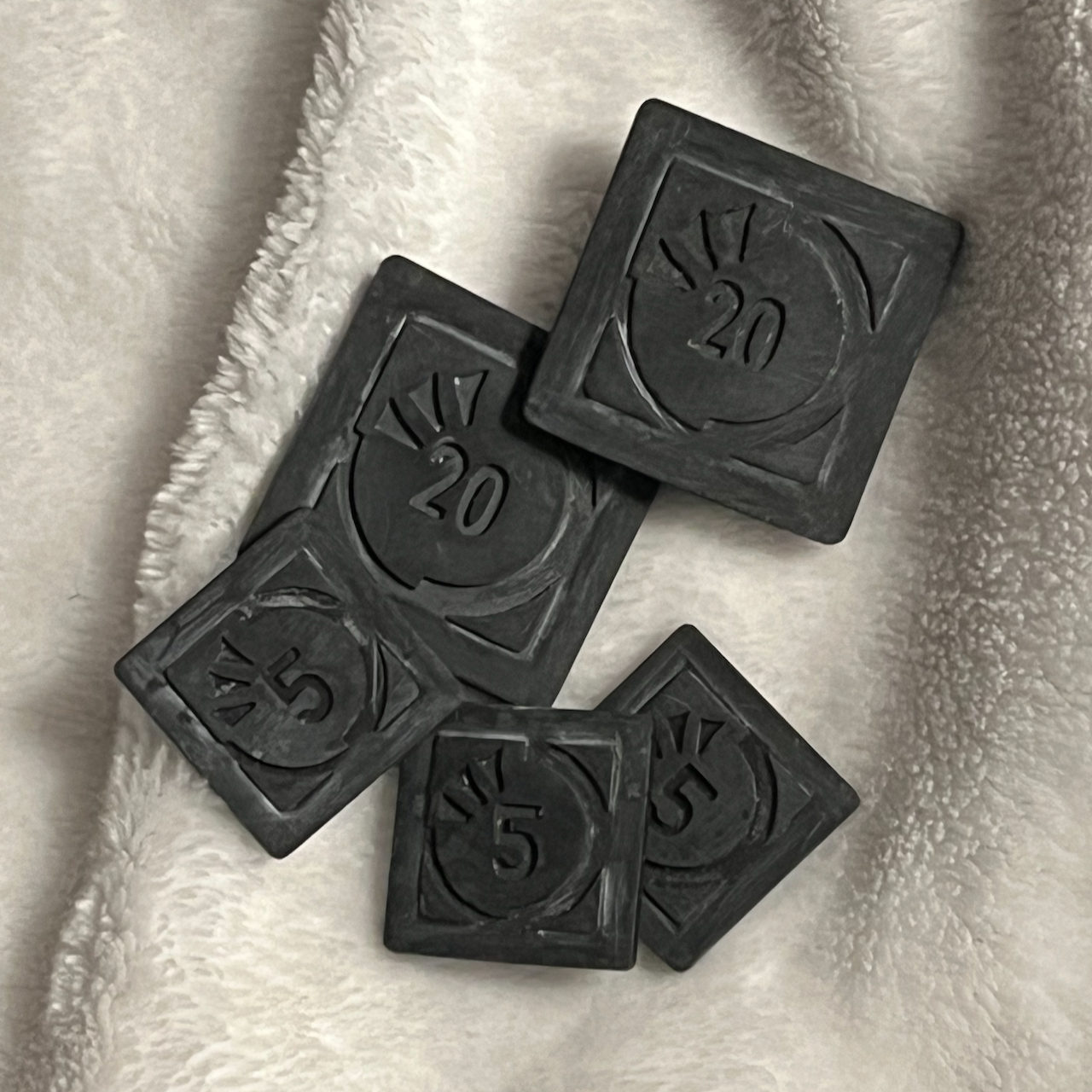

The latest batch, but these are undersized in all dimensions (I made them yesterday, before I got ahold of lint's most excellent screenshot). Pre-paint; I do plan to paint/weather/rub n buff these, but when I am ultimately happy, I'll use a finished set to assemble a sprue'd-up collection for pewter-casting.

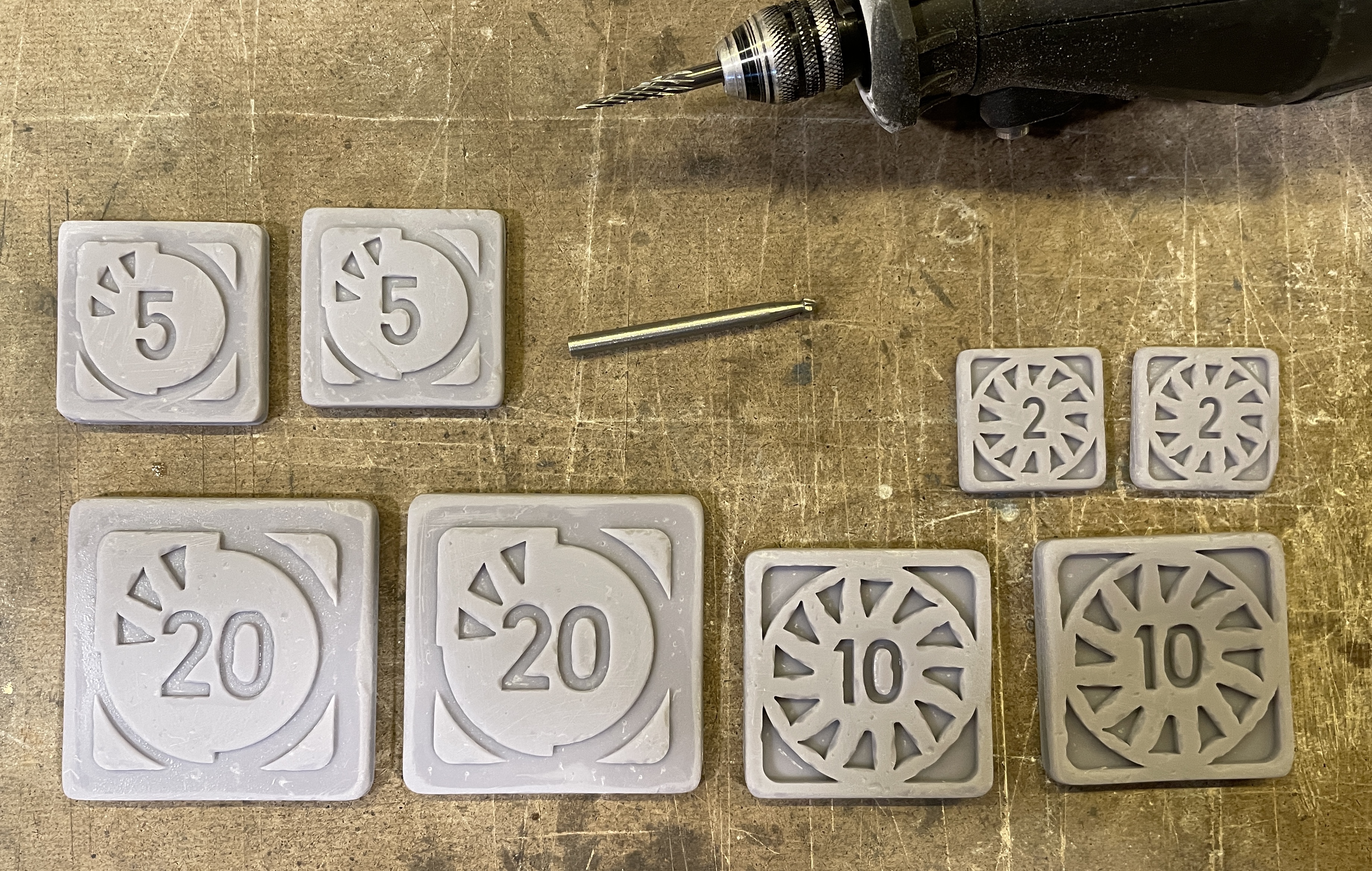

I haven't modeled the 10/2CR chits yet, but hope it goes quickly once I have the 20/5CR models figured out. Of course, now that I have typed those words out loud... ; )

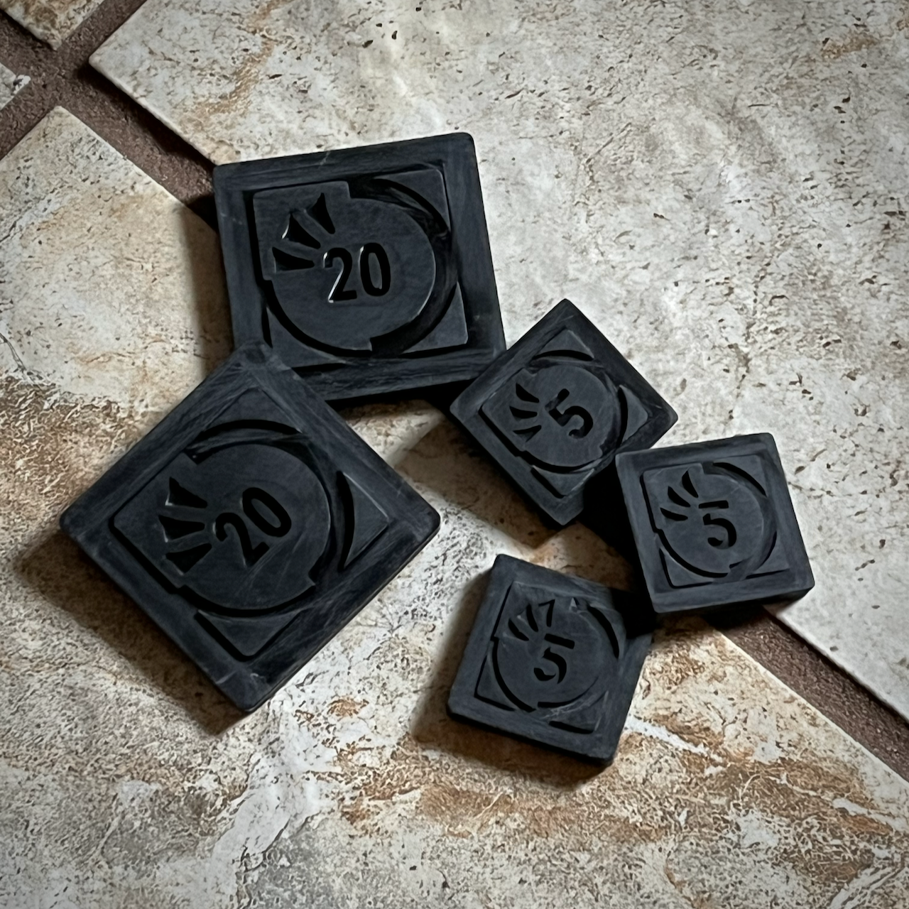

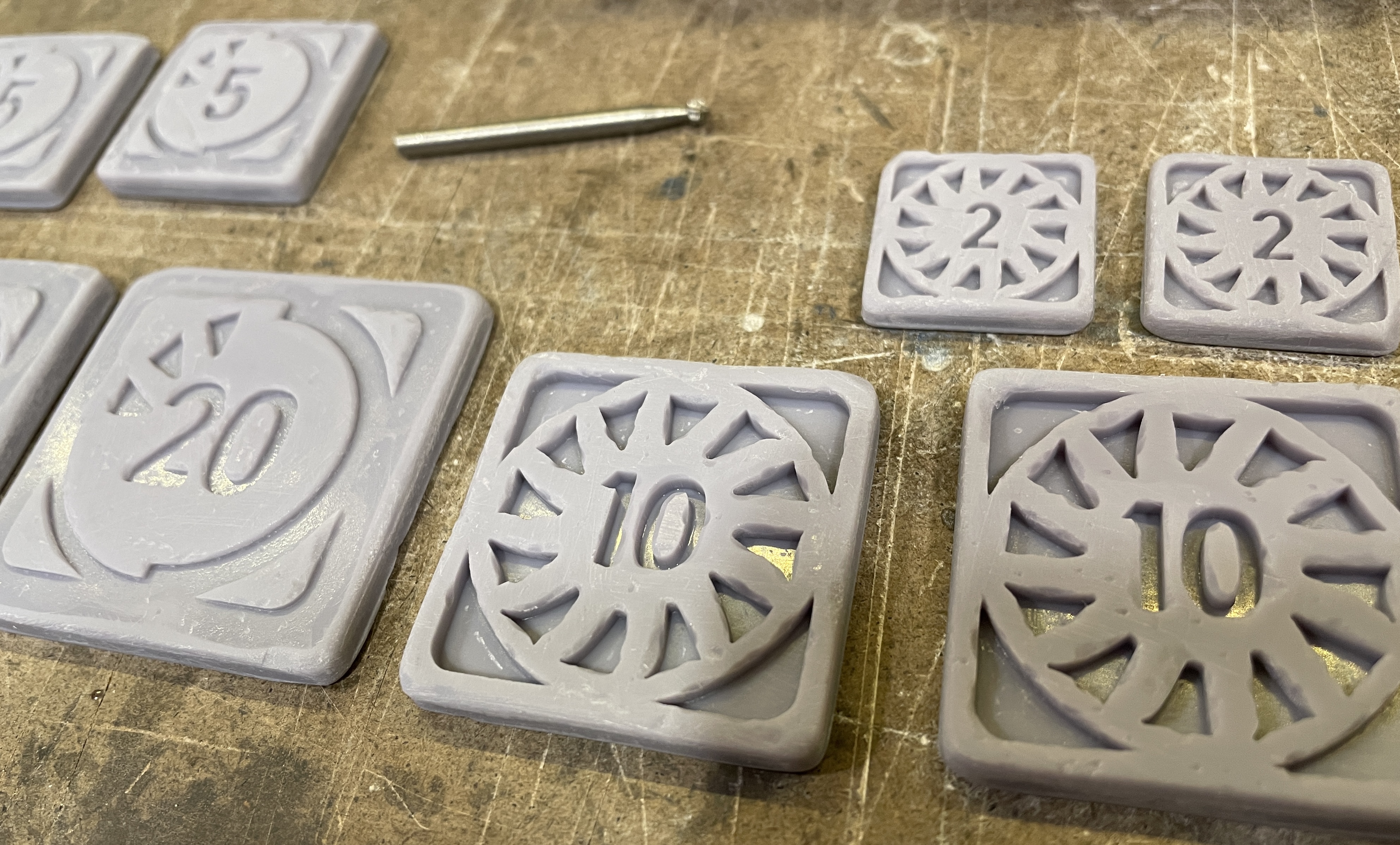

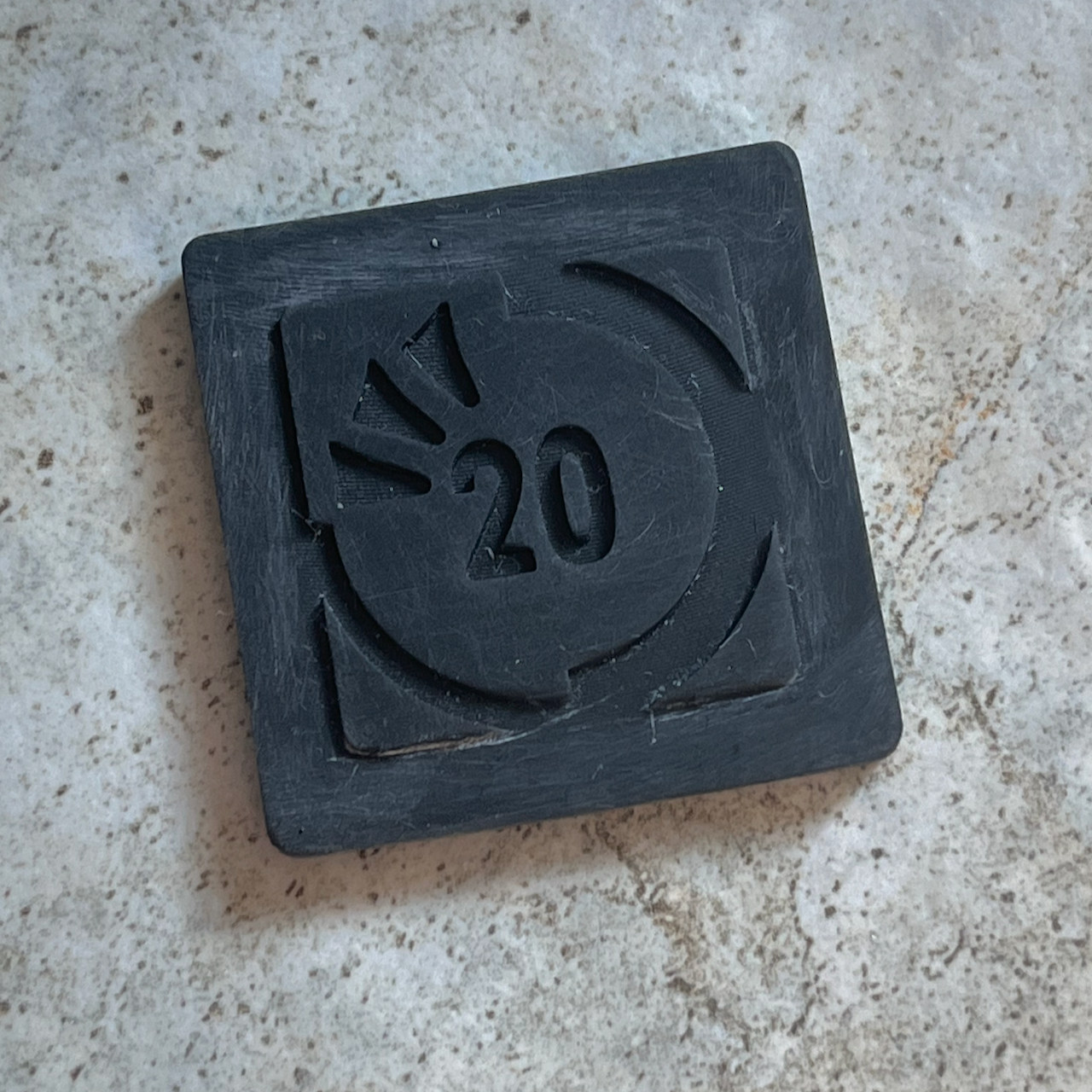

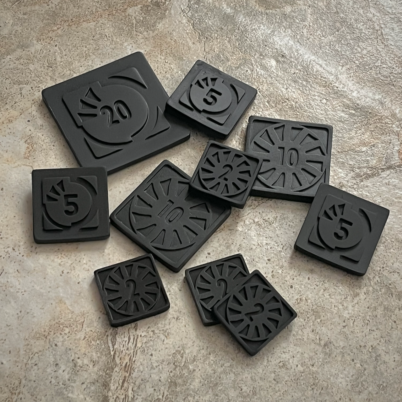

Progress. These are 40 and 25mm square, and I used a simple cube .stl file in my slicer (ChituBox) to ensure that the height of the main part of the token (not the raised parts) was 4mm high. Even in ABS-like resin, they have a pleasant heft and almost make a metallic clinking noise. These ones I will probably clearcoat and then finish -- I'd like to see if I can get the clearcoat to even out the print lines in the recessed parts of the tokens I can't reach with sanding sticks. I discovered that you can very easily over-sand before the resin is cured. At any rate, the next batch will be what I'll use to make my pewter molds, and I still have to model and print the 10 / 2 CR chits.
