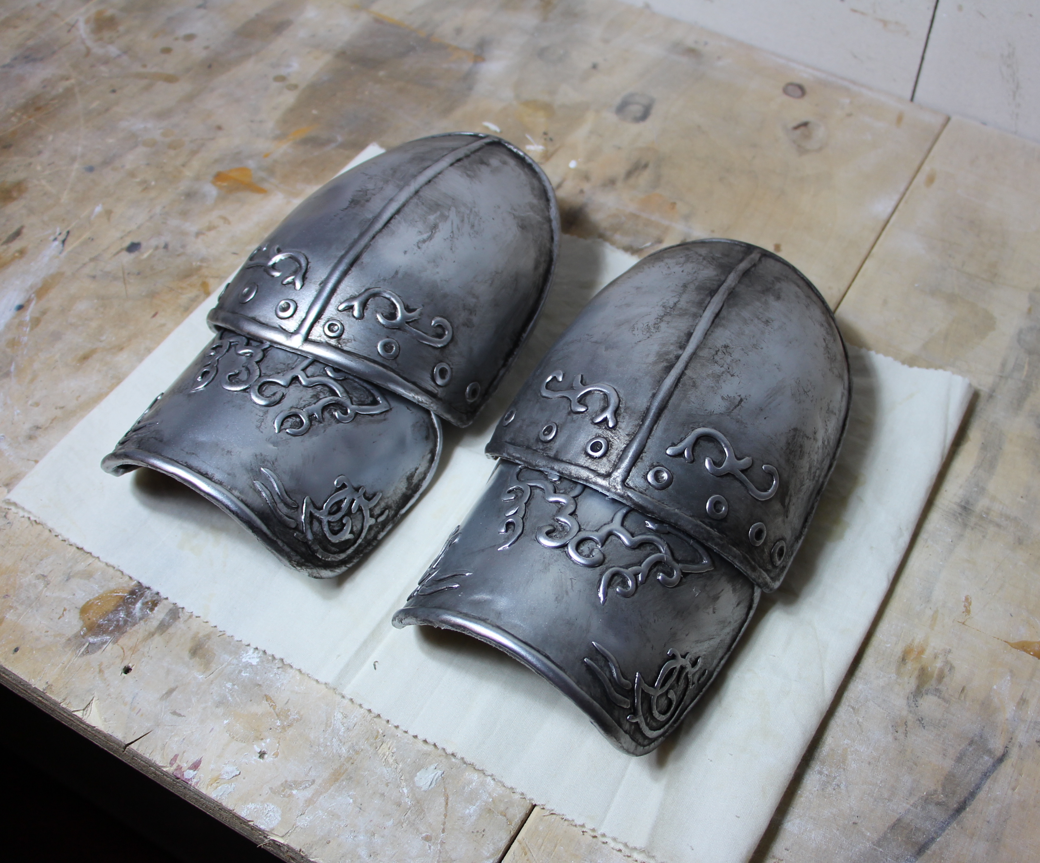

The right question for me, as I have already done an excessive build with Apoxi sculpt on Worbla. Depending on what amount of surface you want to cover you will need to pay attention to some things. It will generally work pretty.
Very important is sanding the places you want the Apoxi Sculpt to adhere to with rough sandpaper. It will make the AS stick a LOT better.
If you are just going to do some small details on the surface with you construction method, you may have to reglue them as the AS is not going to bend with the slightly flexible Worblas and can come off.
My preferred, but in case of bigger armours a bit on the expensive side, method of armour building with Worblas and AS is to cover the whole part in a layer of AS. That comes with the added benefit of creating, with some wet sanding, an extremely smooth finish and a very high stiffness of the piece. It will also be a lot more resilient and heat resistant and negate the risk of warping Worblas under the sun.
In case of this method you will also have to pay attention to not make the layer to thin, so it will not break under stress or get bubbles as it is hardening. A layer thickness around 2 millimetres is the best from my experience.
Also using to much water will reduce the structural integrity of the AS and can turn it brittle.
I hope this was helpful and here also a example of armour made with this method:
