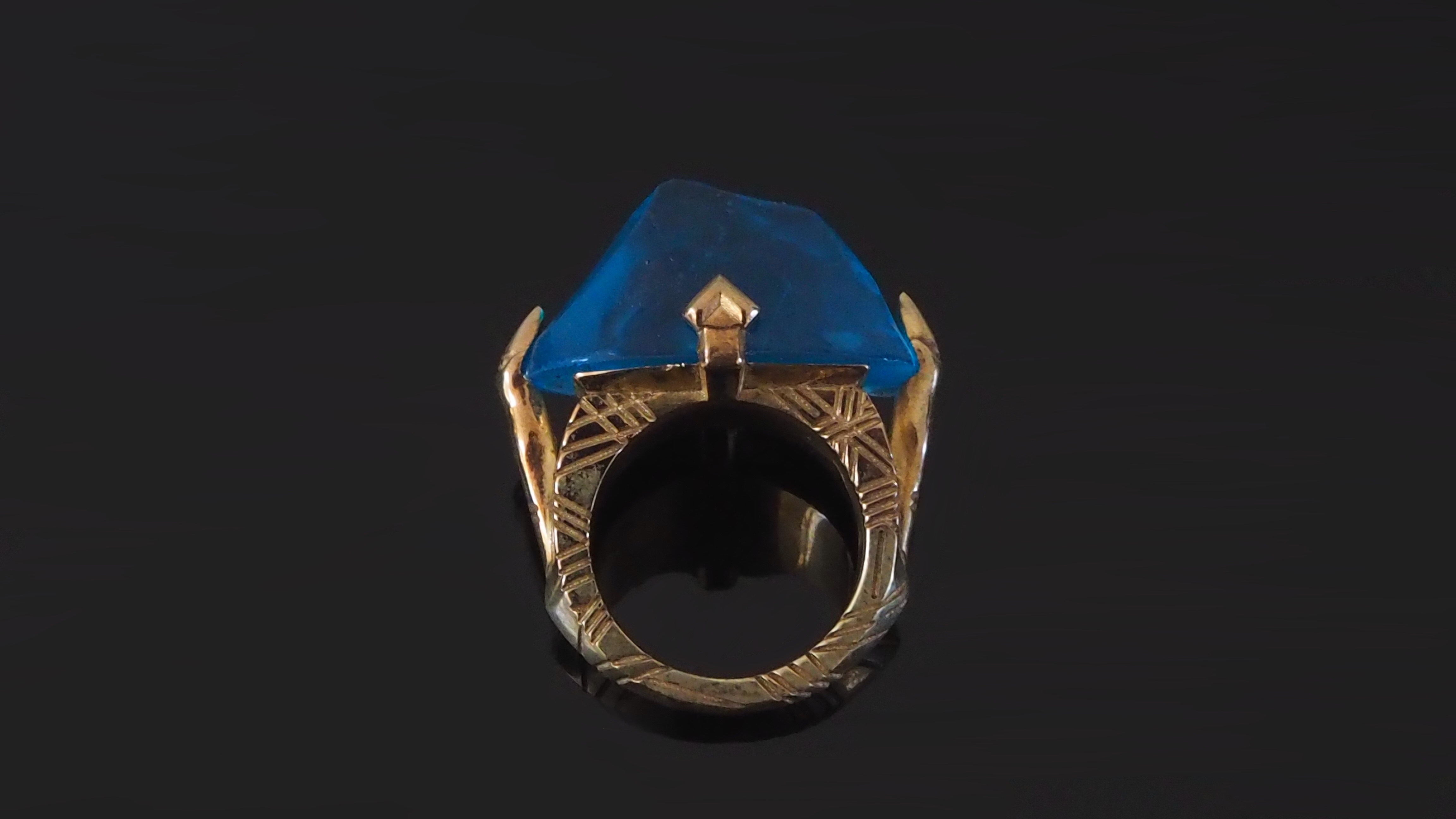

Looking for some advice on making fake coloured gems.
I'm working on a replica of Durins Ring from amazon's ROP series. Usually I work with real gemstones but I'm going to have to come up with a creative solution to replicate the stone in this ring. I thought maybe I could 3d model it to make a mould, then use some kind of dyed clear resin but that's very much outside of my wheelhouse so wondered if anyone could recommend some products/techniques?

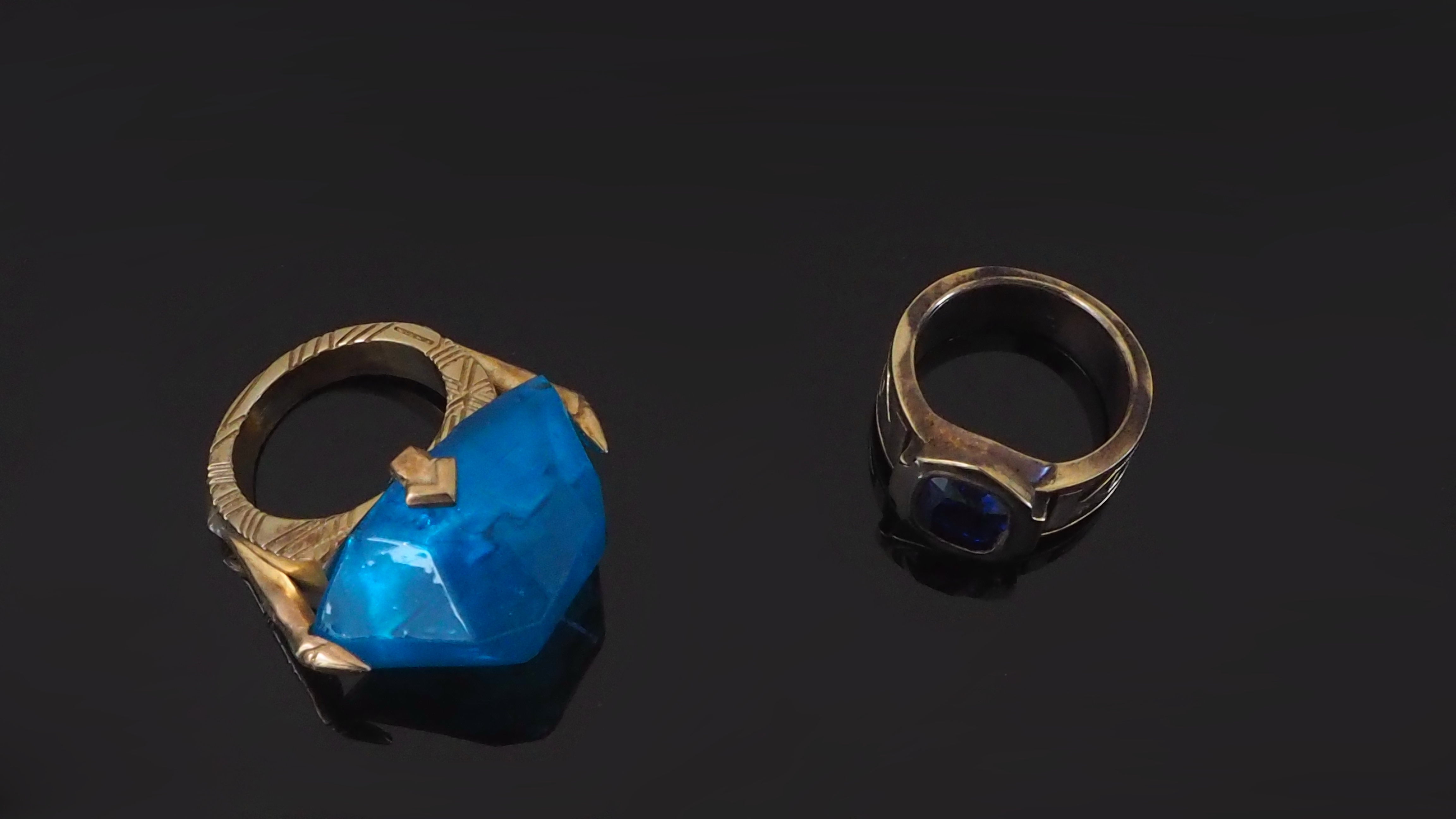

Just use a nice clear blue resin, or get a high transparency resin like Nova 3D High Transparency or Monocure Crystal Clear and add some blue ink or food colouring to get the right shade. Pretty much all the rest of the steps listed above give the final result of a gemstone made out of clear blue resin, so may as well just print it in blue resin to start.
Can even add some pearlescent pigment powder or similar to get the slightly opalescent effect of the image in the first post. Or add some glow-in-the-dark pigment or play around with glow resin to get the Glowng magic effect?
