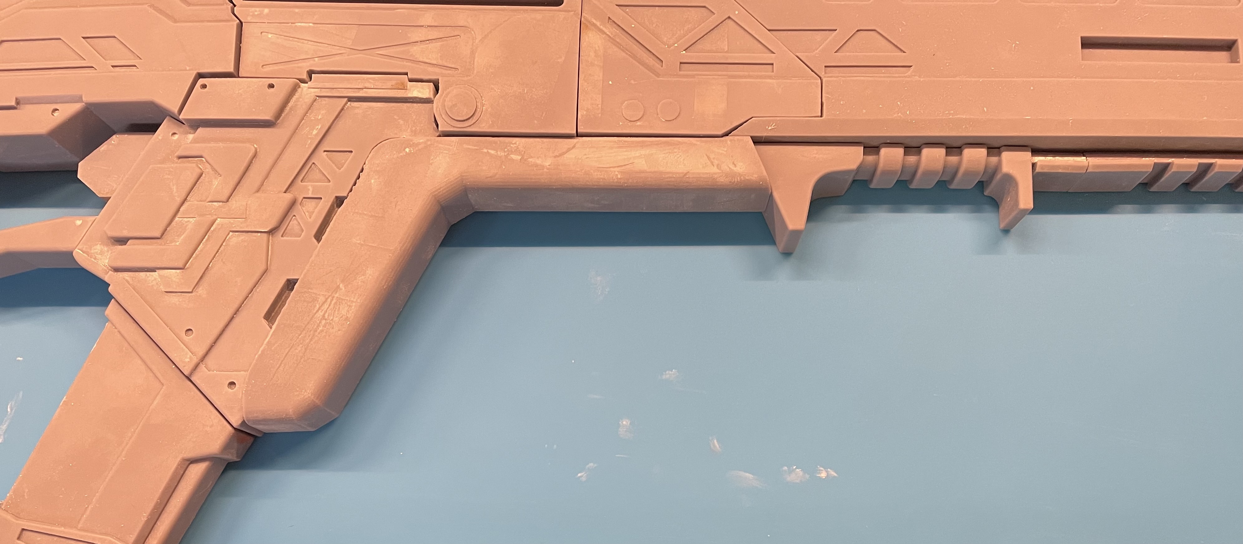

Just printing the last part on this now. All done on an Elegoo Saturn with their water-wash resin. Combo of solid and hollow parts. Going to begin creating molds for this over the next few weeks so that we can offer them in solid resin casts.

Very Nice! I've been printing the R99 non-stop over the past week and painting as I go. Just waiting for the rest of the spray paint colors I need then I should be able to finish it shortly.
I would love to do the 301 at some point, but i havent been able to find a model I really like. All of them look too boxy and sharp. I understand that theyve been modeled right off the game pcs, but in real life that fore grip edge would be *so* uncomfortable to hold
There are rounded pieces underneath going all the way from the clip to the end. It's actually a pretty comfortable gun to carry. This piece was missing from my pic:
