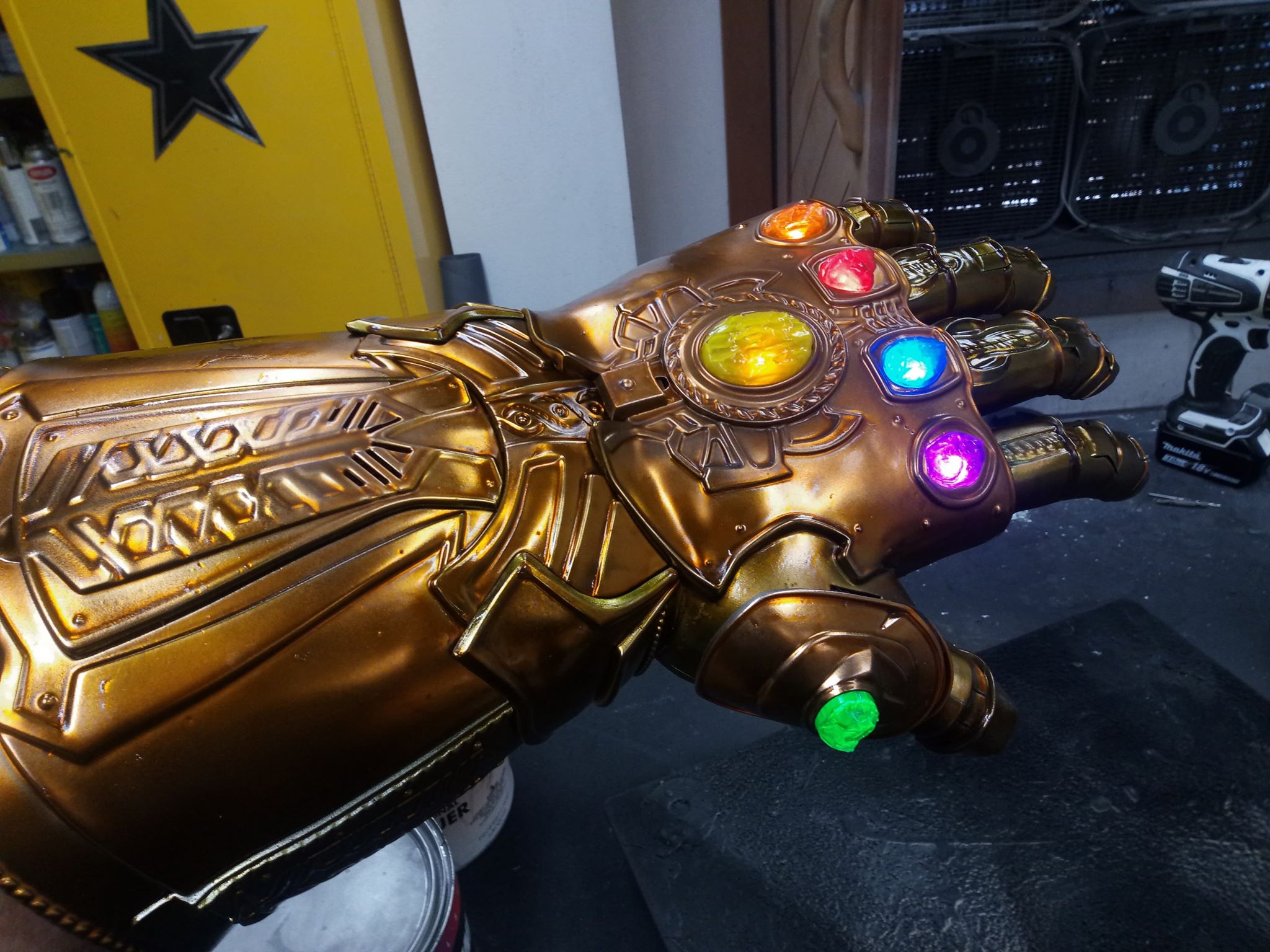

So I LOVE these helmets but was intimidated by trying the chrome. I've gotten pretty good at Alclad, but after watching Antman 2 last night I finally paid attention that it's slightly glazed over. You cannot clear coat Alclad, even using Alclad clear kote it dulls it immediately.
BUT, I watched a tutorial on using varnish over alclad actually works, but hazes the chrome slightly, which is actually the best result from putting any coat on alclad.

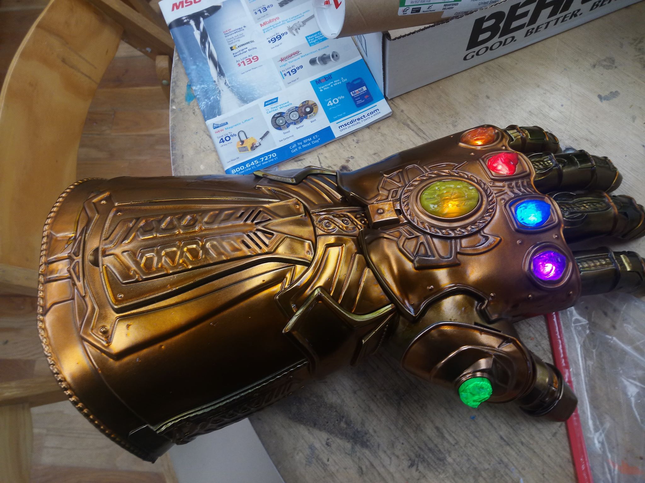

It's a liquitex gloss varnish and the result is pretty much what I think you see on screen. Here is my Infinity Gauntlet that I used this method on. You can see on the Antman helmet, that it's not perfectly chrome, it has a slight haze to it. I am pretty sure they used this same method.
Painting these helmets is a bit of a pain, because both helmets actually get more worn as the movie goes on, especially Ant-Man's. When he first puts on the suit, it's practically brand new and shiny, but by the end scene in the lab, the muzzle of the helmet in particular has become very tarnished and grimy.
