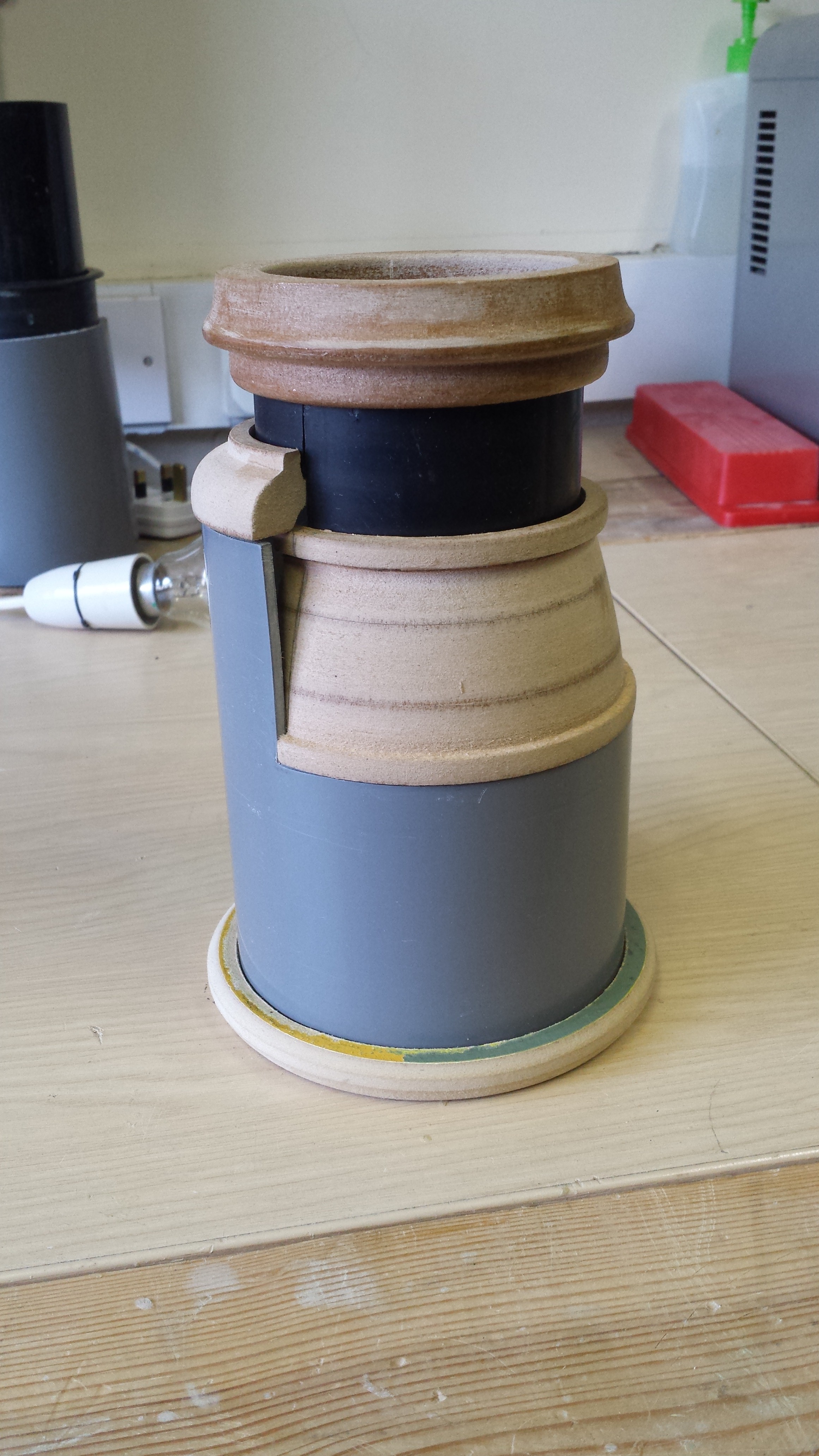

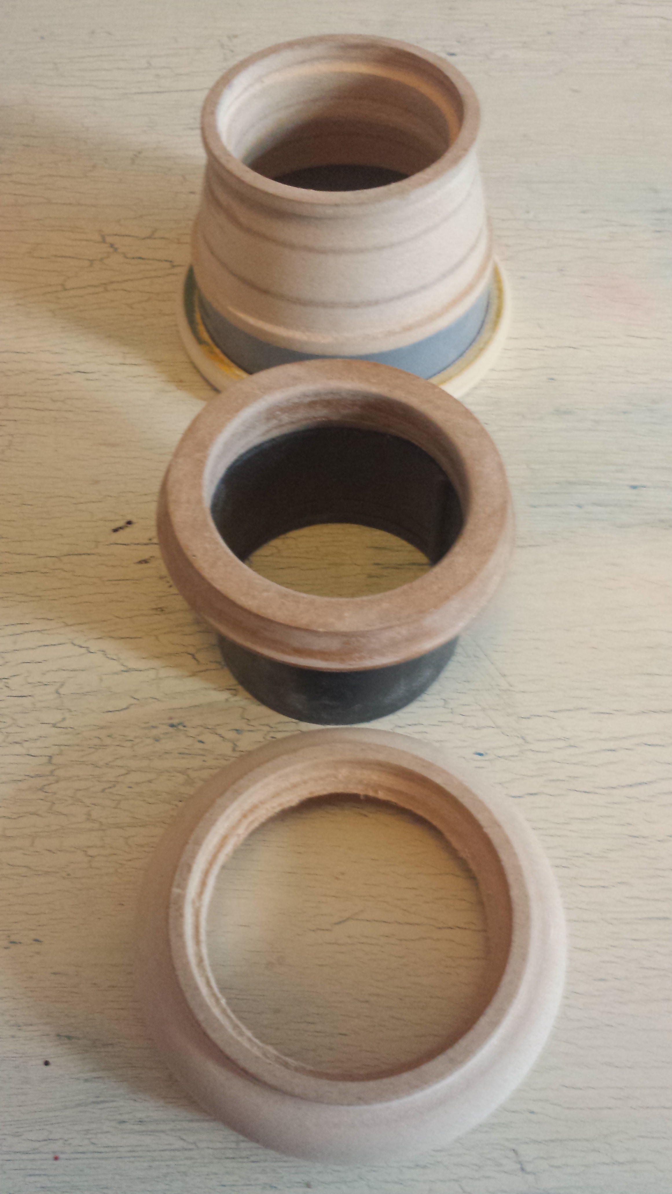

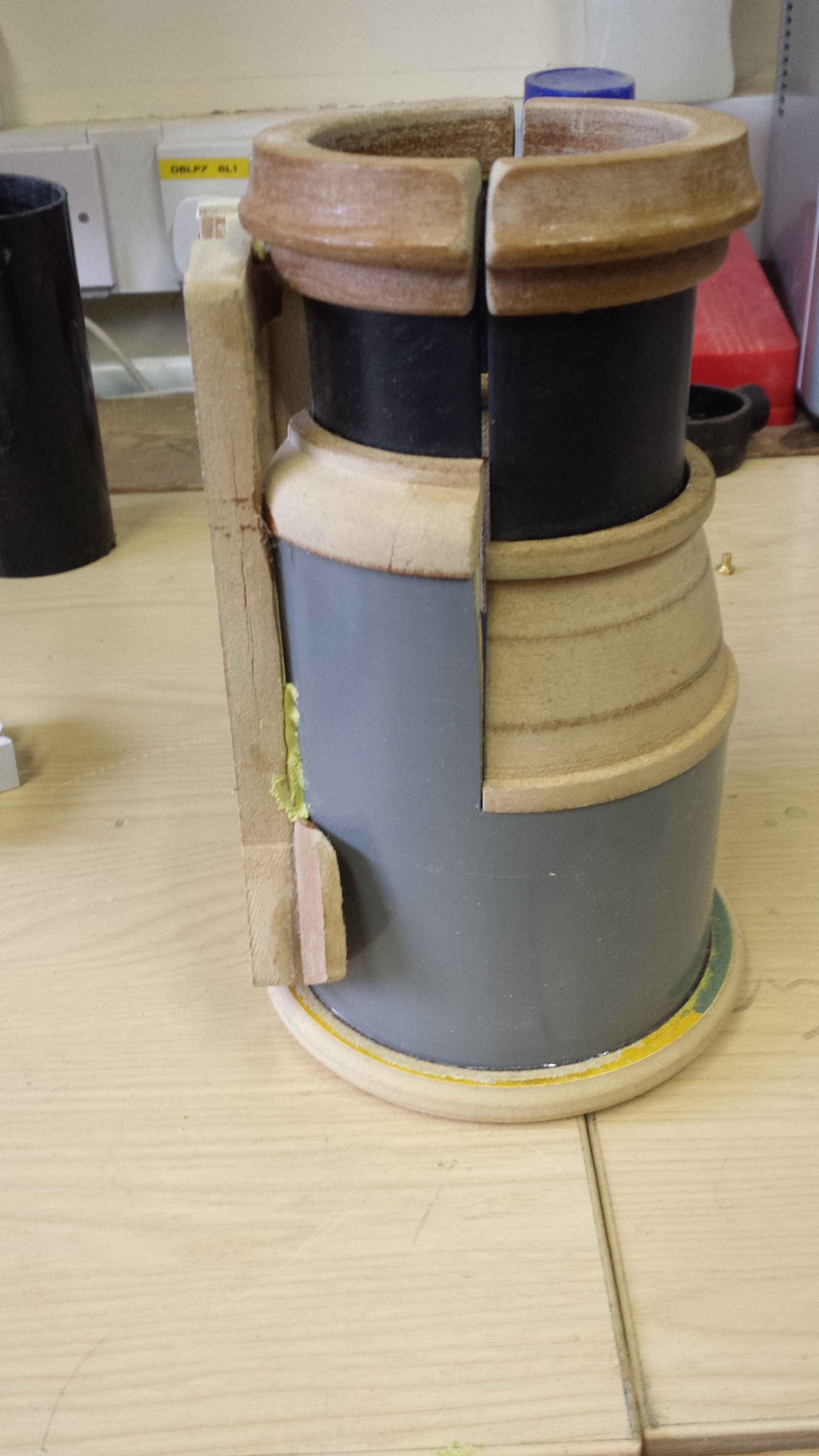

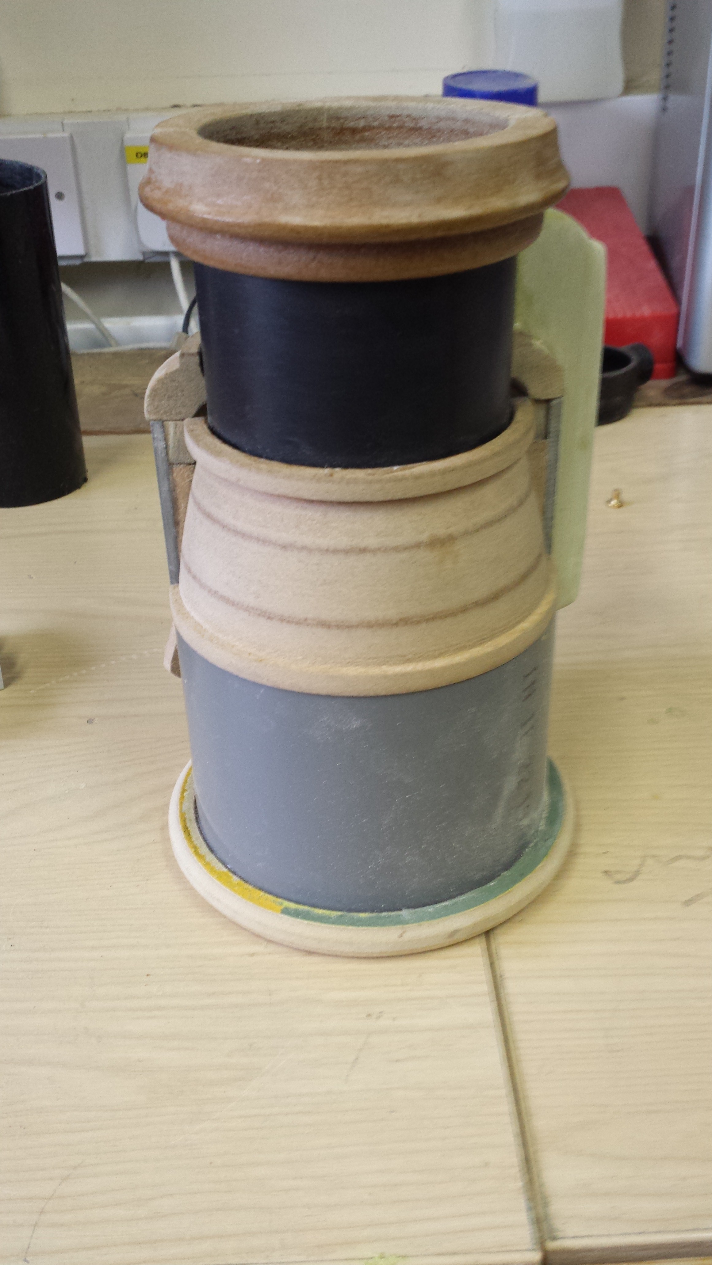

I know there are quite a few Pip-boy builds posted on this site but I thought I'd add another.
The main difference with my build is that i didnt want to slice it all the way down the middle and slap a hindge on it.
Also i have fairly large arms so I've been able to make it to fit the huskier gentleman.
Here's where I'm up to so far
20140518_193755.jpg20140519_155903.jpg20140602_153049.jpg20140602_153056.jpg20140602_153102.jpg

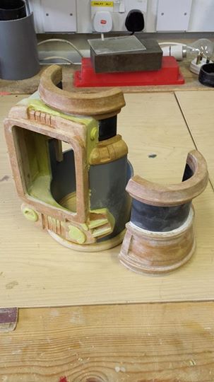

I've started to add some detail to the front. I'm planning on making a resin cast of this and fitting it with a backlit acrylic screen and some LED's. Nothing too fancy as I've not added any kind of electronics to a prop before.

Today I've built up the front section and added the strap around the middle.
I get the Milliput to a rough shape and let it set over night. I dont know what everyones experience of milliput is but I find its easy to carve into shape with a sharpe chisel and tidy up with some sand paper. You can see where I've done this on the details at the bottom of the piece.

I've added some more detail and built up the screen visor. It's not 100% accurate but i'm happy with the look of it so far.

All the round parts are MDF that I turned on my lathe. For anything thicker than 18mm I had to glue sheets together. The problem with this is that the glue is tougher than the MDF. So when you cut it the MDF comes away easier than the glue and ridges form. The ridges get worse when you sand it.
You can see the ridges in the piece at the top of this photo. I ended up having to do a scraping cut with a really sharp chisel to take them down.
attachment.php
You can also see in this photo that I made these in the same way that you would make a bracelet on a lathe. I also cut recesses and tenons on either end so that the pipe would slot into place neatley when constructed.
