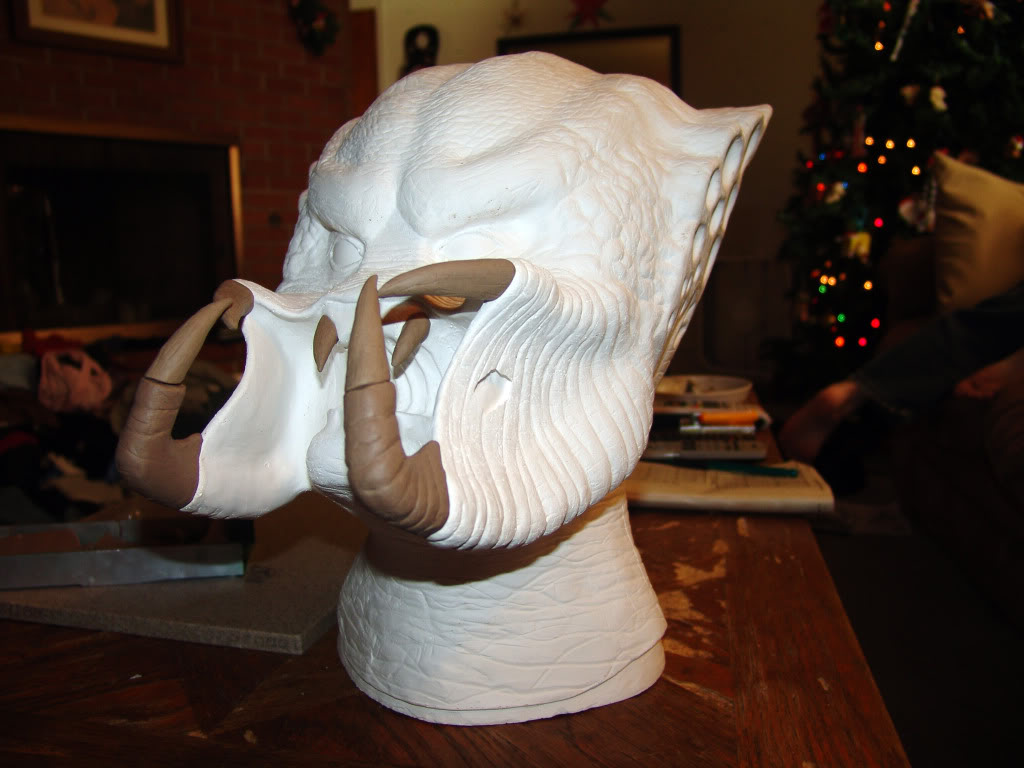

This is my second FGR-95 bust. It came out better but I still managed to have an air bubble in the cheek. I tried new techniques with a thinned first coat. This was ten pounds (dry) of FGR-95 and hollow. I'm finalizing what I want in teeth and here is what I'm going for.

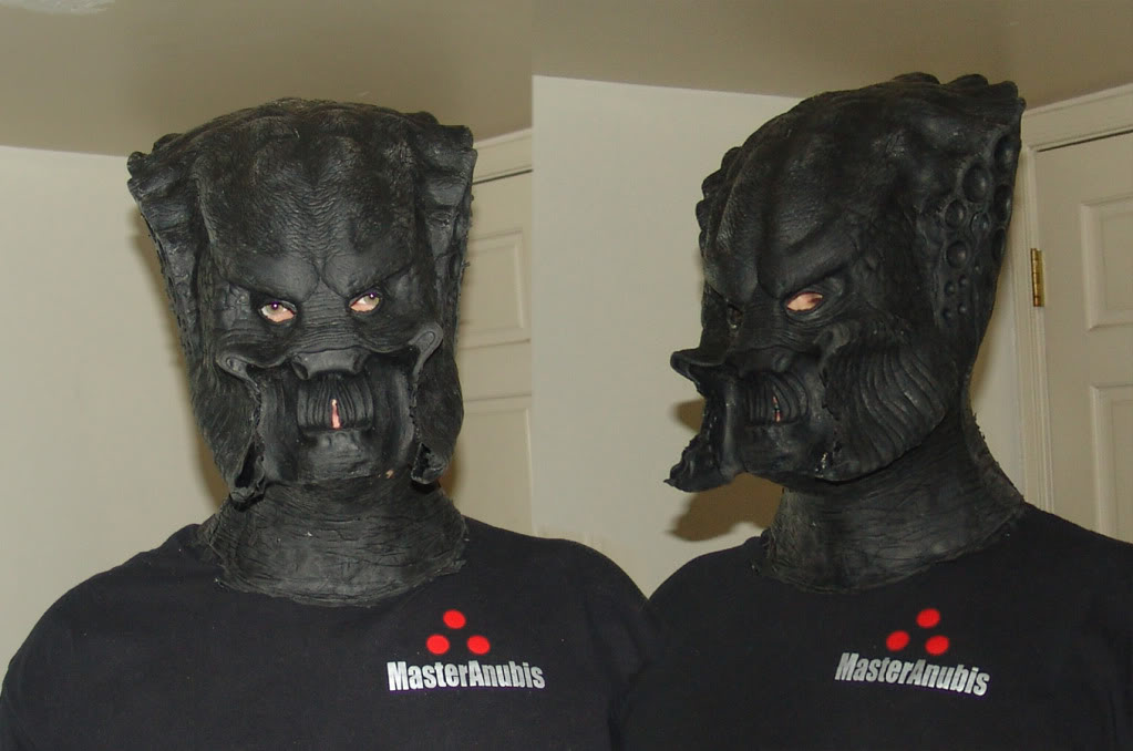

I was too curious about the latex thing so I decided to check my latex. Most of it was good and I started a latex version. I brushed in a layer and let is dry a bit. Then a second. Then some of the neck was starting to detach from the mold... I wrestled with it a little and ended up putting some tape down so that it could stay together long enough for the latex could hold the seam together after I put the mold together. I had to blow the latex out with some air so that it was thin enough to dry from the inside but overall it went OK.
I pulled it out of the mold without taking the front shell apart. I shouldn't have done that. But I kinda figured that it was underdone anyway. The end stayed in the mold. Considering this is a test and proof of concept I'm happy enough. The latex is a bit thin too. Not Grusderk thin, but still thin.
This is about as small as I was expecting since the shrinkage I didn't design for. This is a smaller bio then the stunt bio and I think it would be good if I was to run with it.
I won't do this again. Even though the mold release worked well, it took a bit of time to get the residual latex out of the little nooks and crannies. It was also a pain to get the latex in and it didn't really come out right.

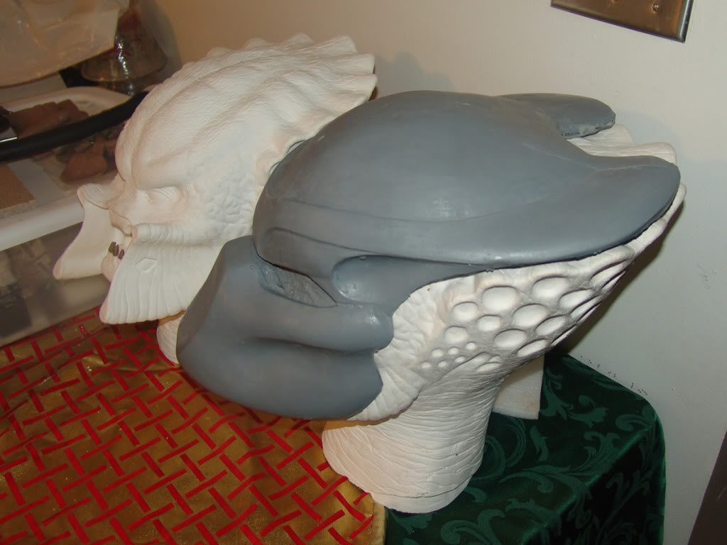

So, I have some pics I'd like a little feedback on.
The size up on the latex was a bit disappointing the more I thought of it. My #1 had a huge air bubble in the left mandible that allowed it to brake off. Oh well, opportunity. The point is that I could get the stunt P1 on it fairly good with that mandible gone. I'm not about to break off the other for a perfect fit. I'm going off the assumption that I'll get a 1:1 with silicone and the cheek area can be squeezed in a little to fit there. But how does this really look?
I put it on as even as possible to get the best view from one side. On a side note, you can tell my dome isn't nearly as pronounced as it could be.

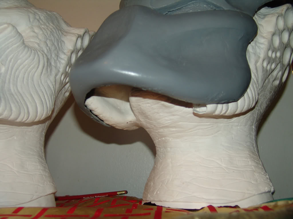

Under, you can see the missing mandible and the little room I have for the ends of them. It appears that I may have made the madibles too long. I think they may be enough room when they're tucked in.
