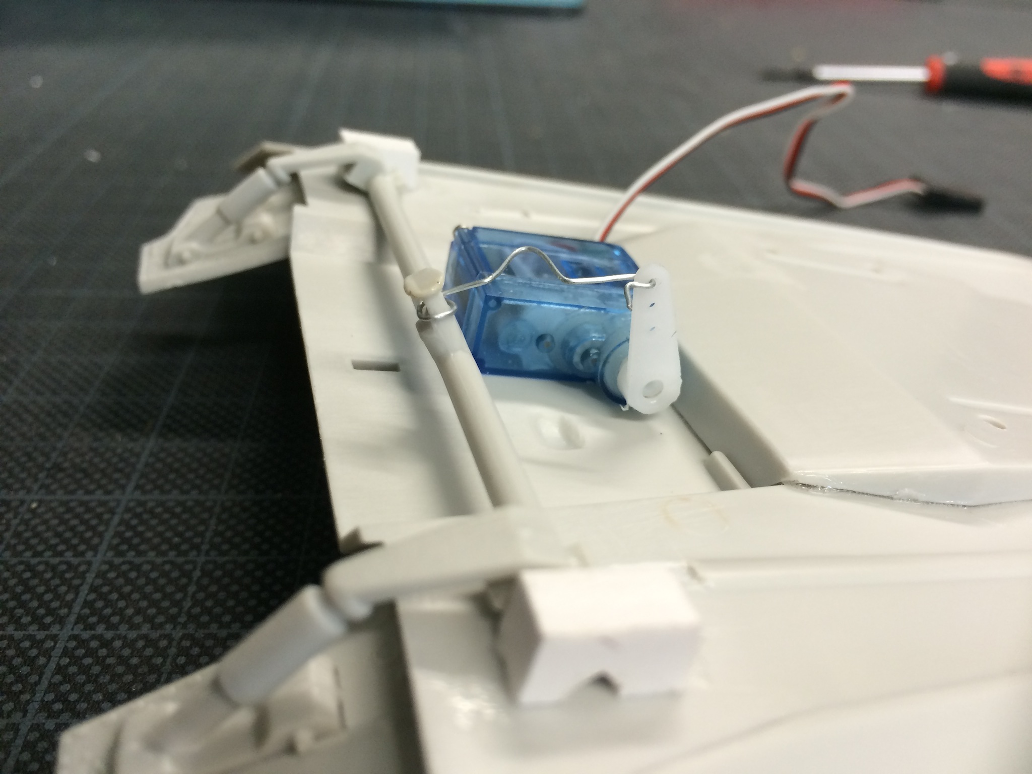

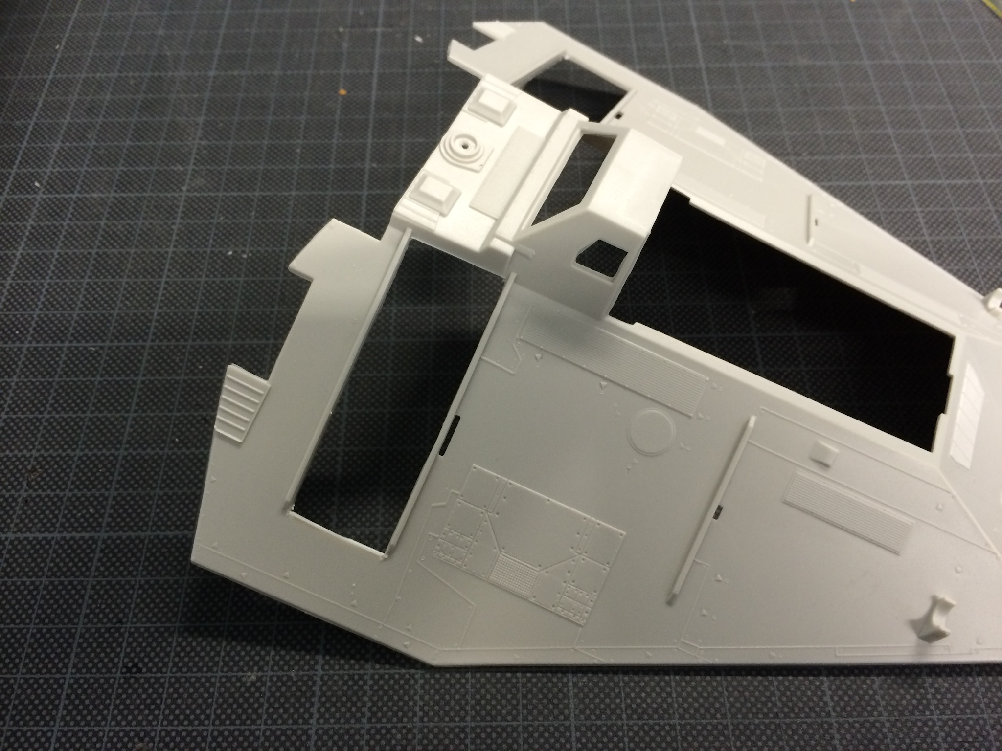

The air brakes are connected with a piece of sprue and held in place with brackets I made of polystyrene.
The steerings flaps are a little trickier since they should move up and back – I'm not sure how to get that motion with the little room I have in the speeder. I might just settle with them opening with a simple hinge.

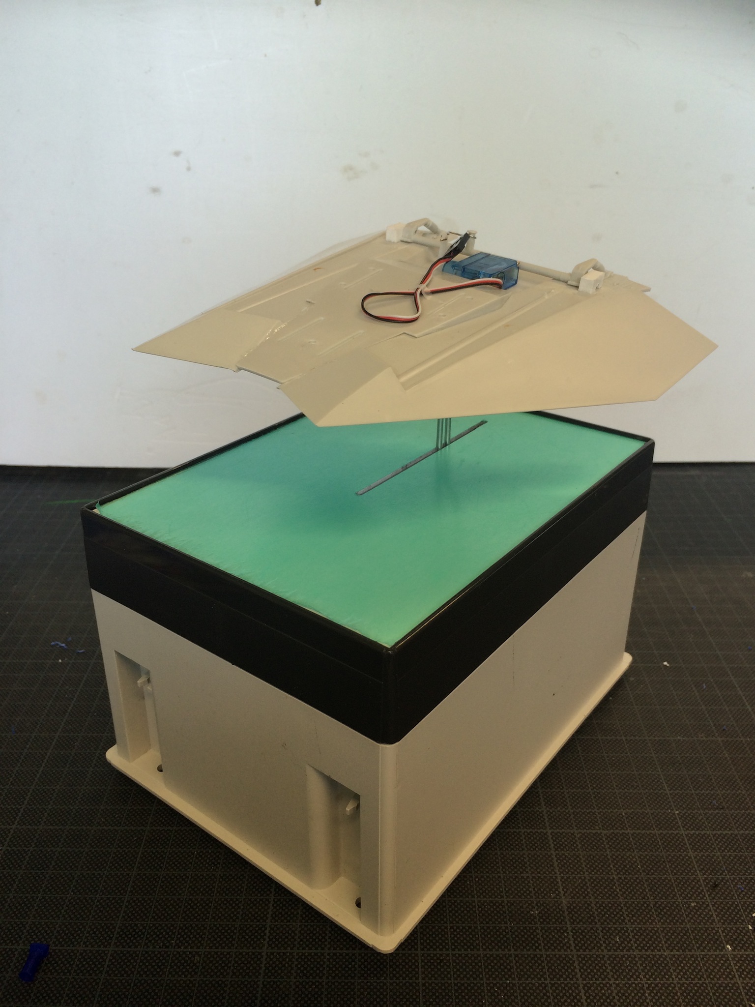

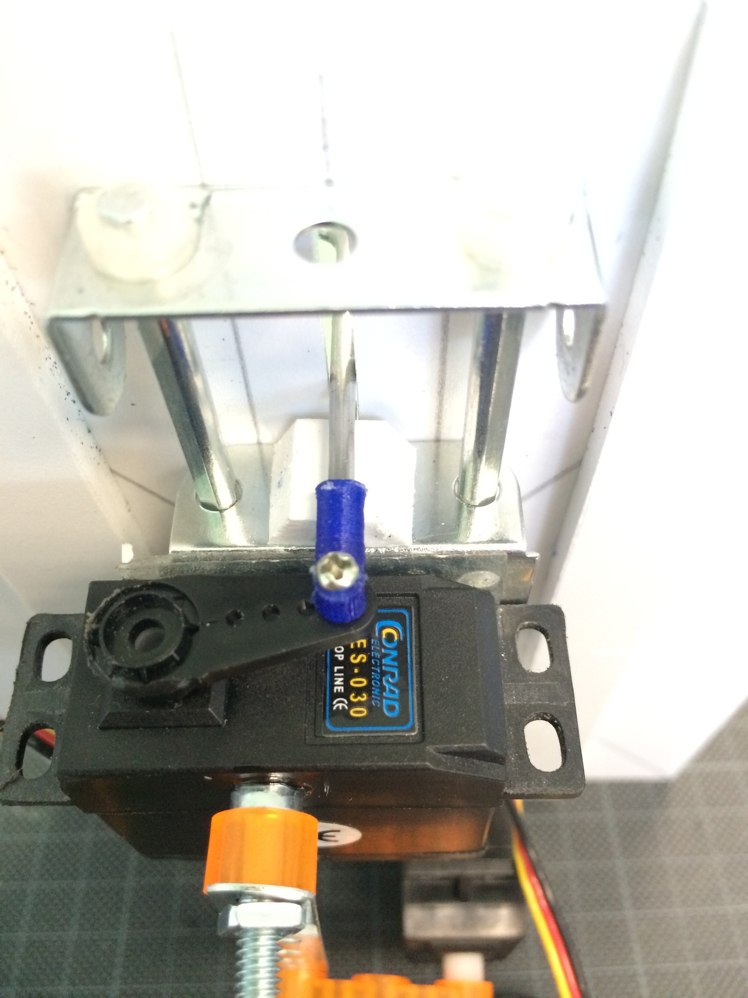

Hi all,

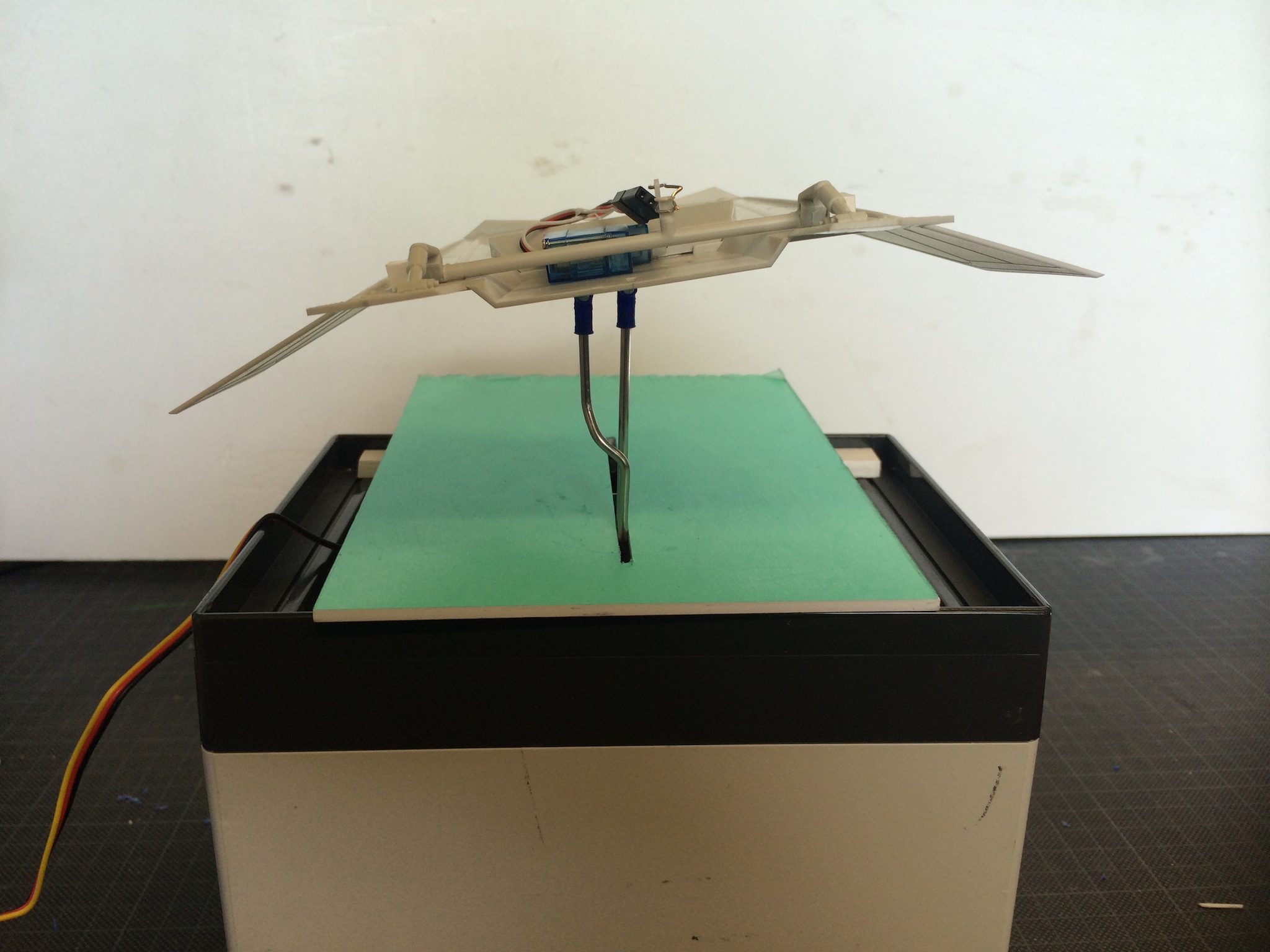

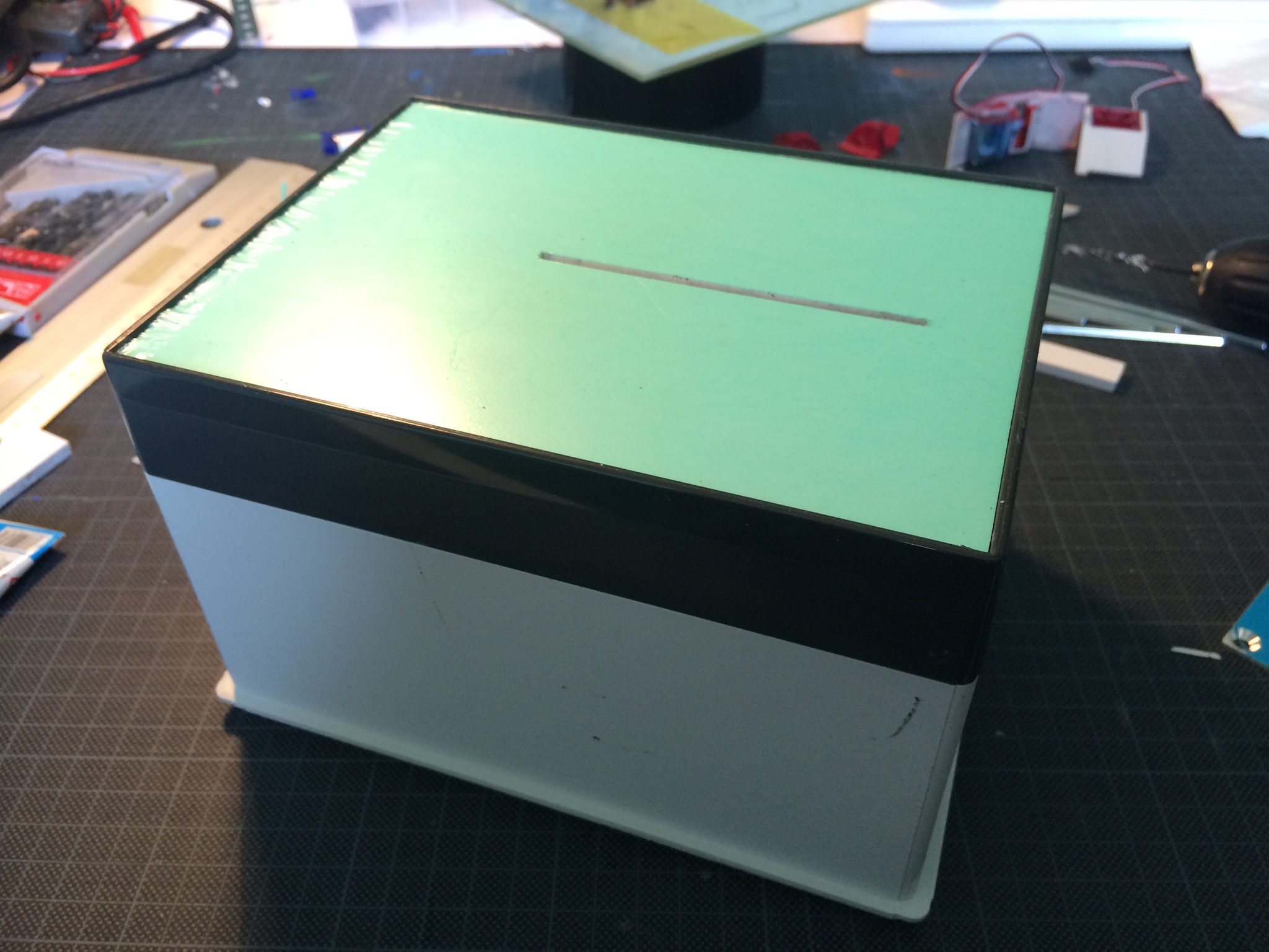

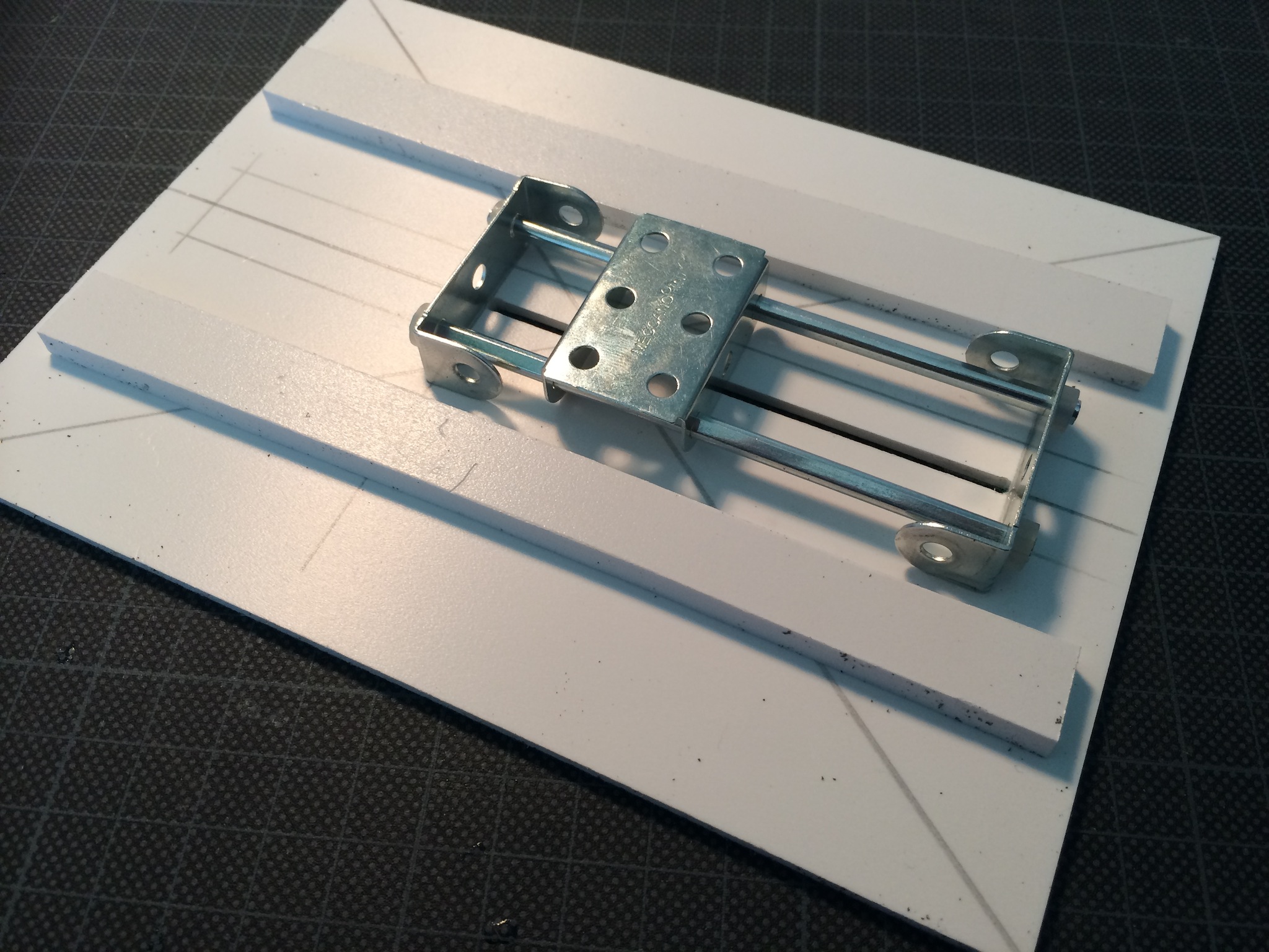

on we go: I painted the air brakes and and the wells red and while waiting for the paint to dry, I cut a slot in a PVC foam board and mounted a rail with a sled beneath it. It's made from meccano parts and will allow the Snowspeeder to move forwards and backwards.

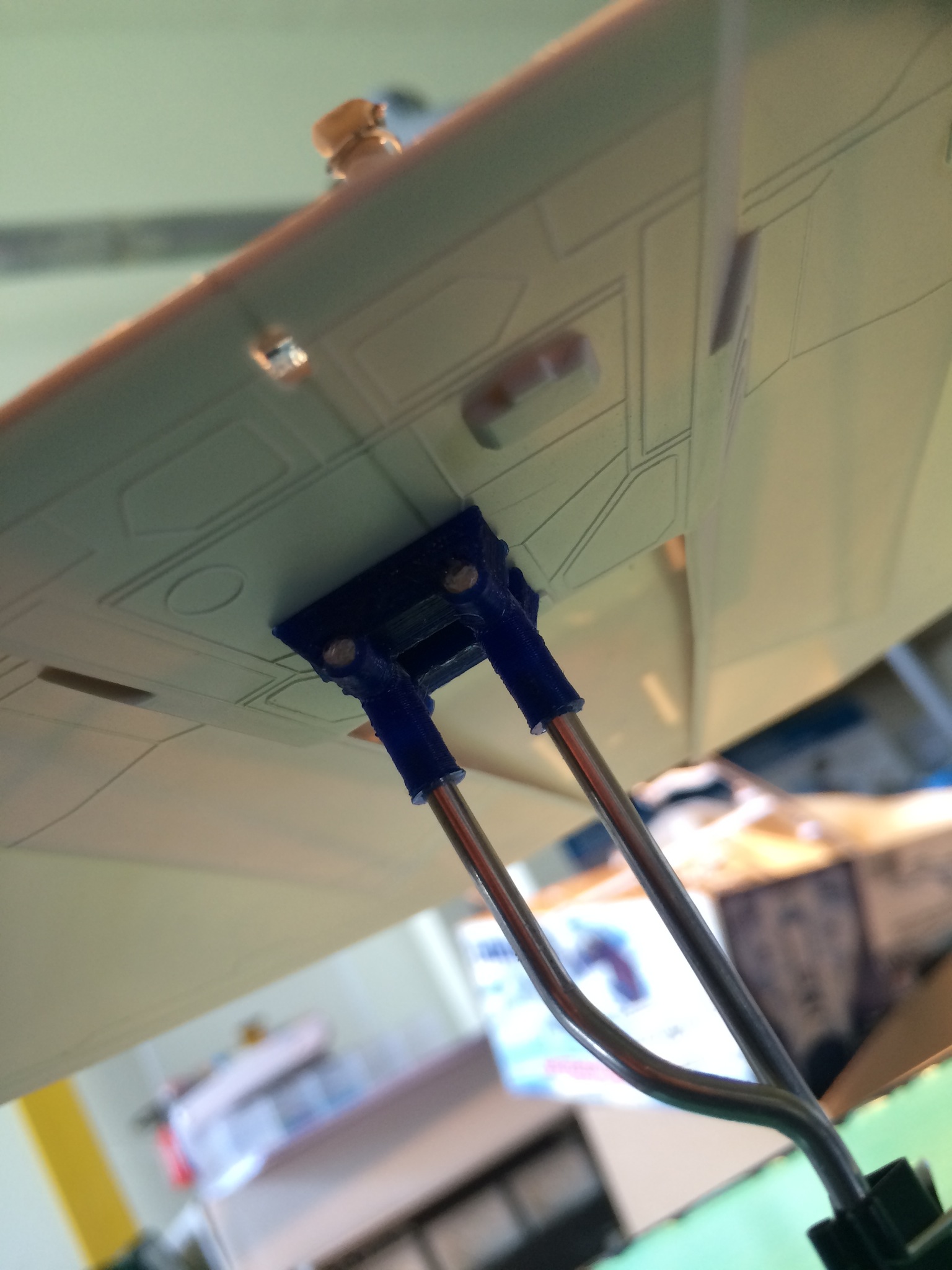

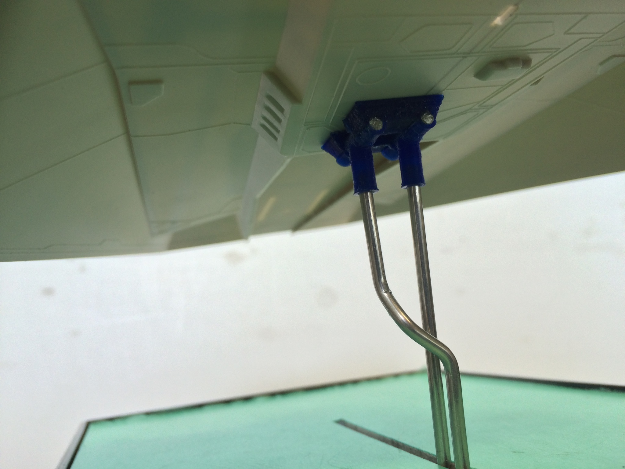

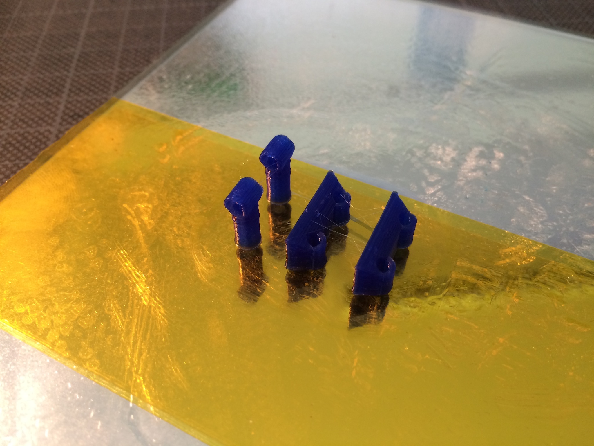

Then I 3d-printed some hinges. The hinges hold 2.5 mm aluminum rods and are responsible for tilting the Snowspeeder. I bent one rod so they will line up behind each other, allowing for a narrower slot (3 mm).
Foto 26.05.16, 14 07 38.jpgFoto 26.05.16, 15 16 22.jpgFoto 26.05.16, 15 20 18.jpg
Foto 26.05.16, 14 40 13.jpgFoto 26.05.16, 15 20 46.jpgFoto 26.05.16, 16 02 52.jpg

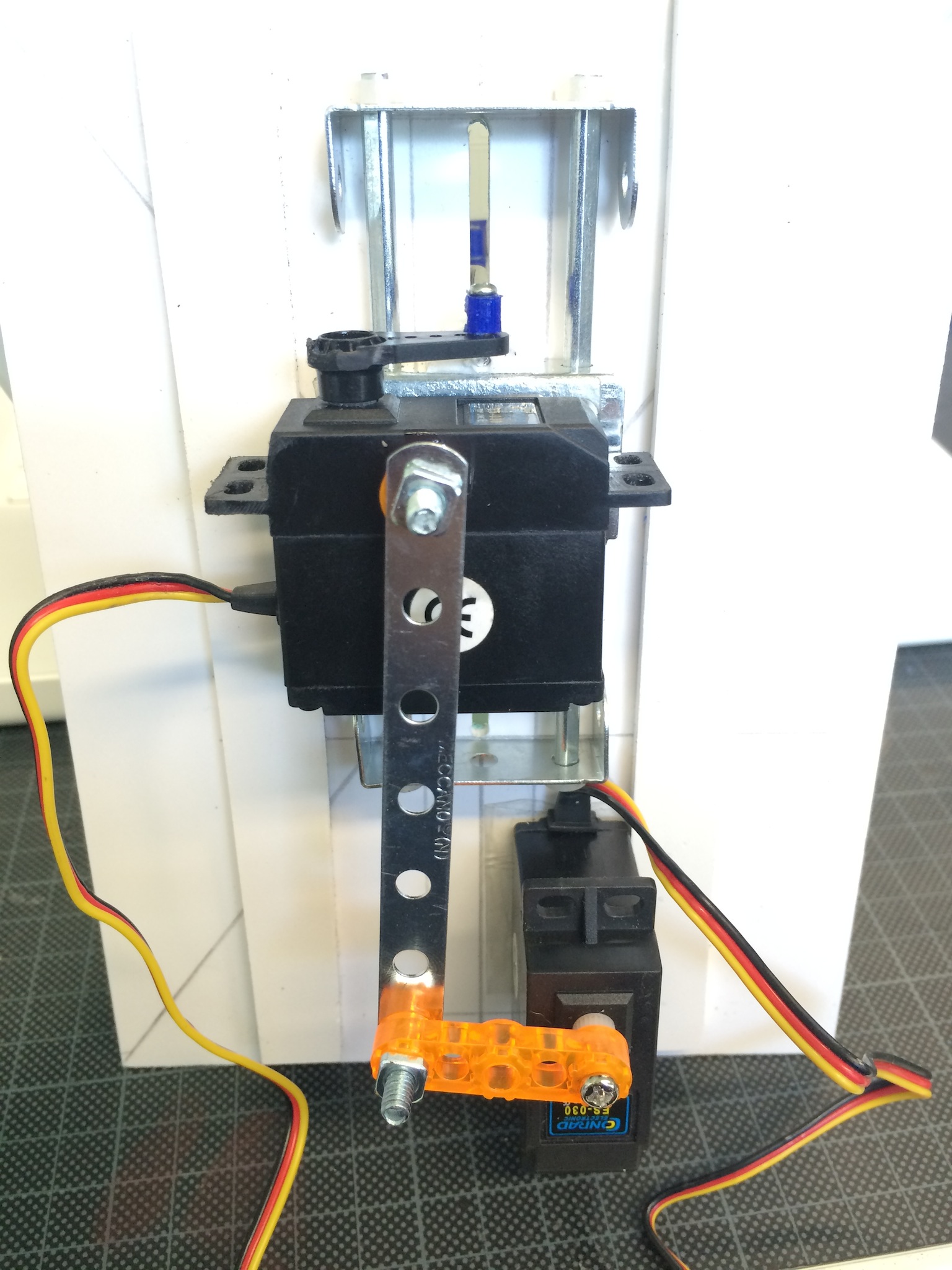

On the metal sled sits an RC servo which pushes the hind rod up or down and thereby tilts the Snowspeeder.
Another servo pushes the sled back and forth. Connected with a simple linkage made of meccano parts.

That is neat. I've always wanted to motorize a model, but don't really have much experience in way of RC stuff. It also made me think of this. Too bad the snowspeeder is only for little figures :D Although you should put a coin slot in the box for shows and exhibits ;)

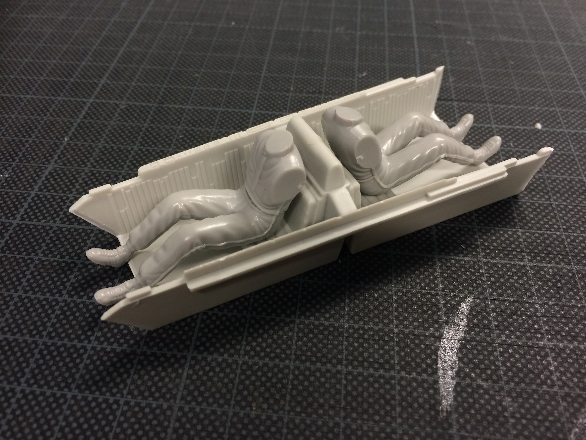

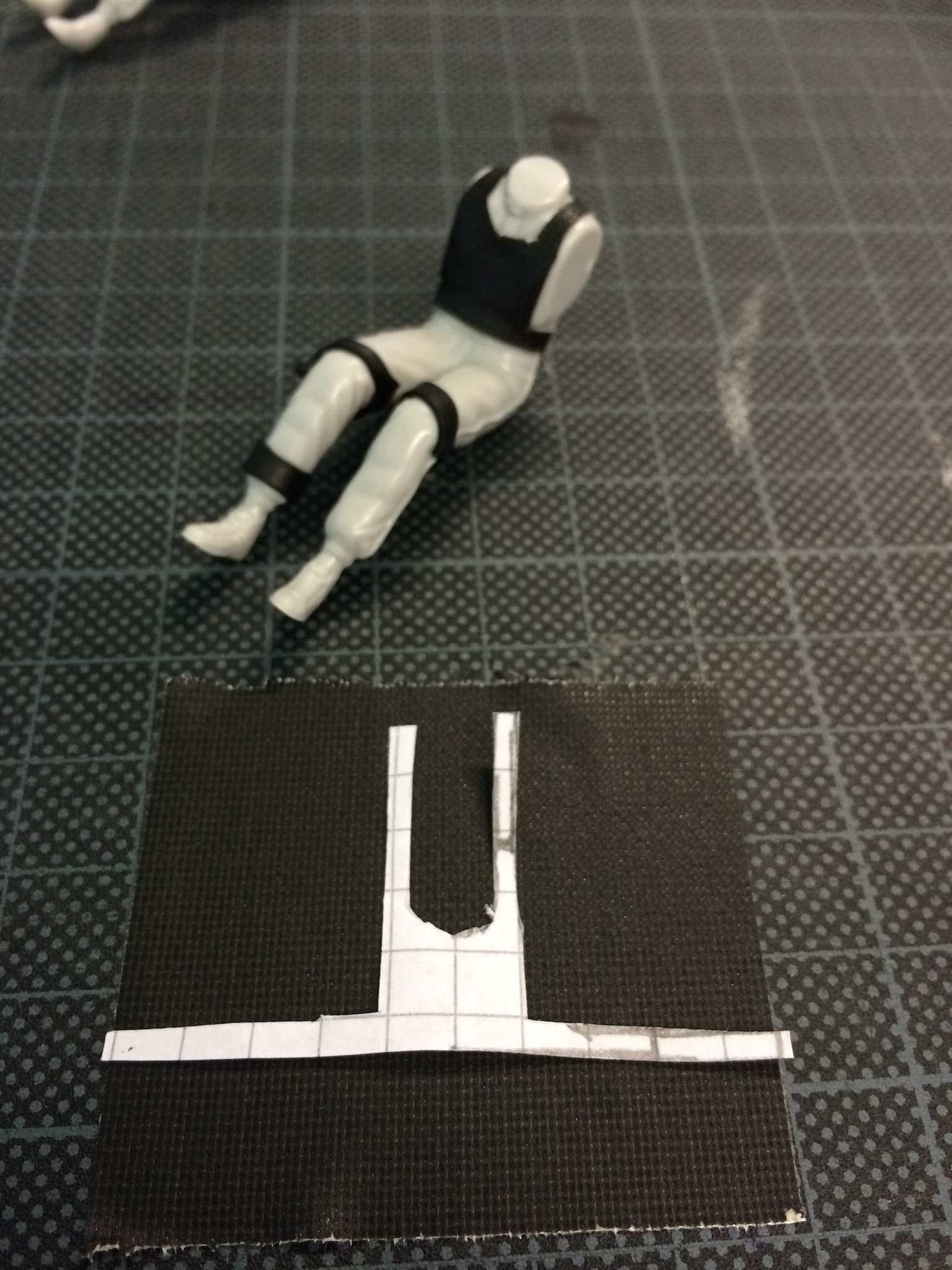

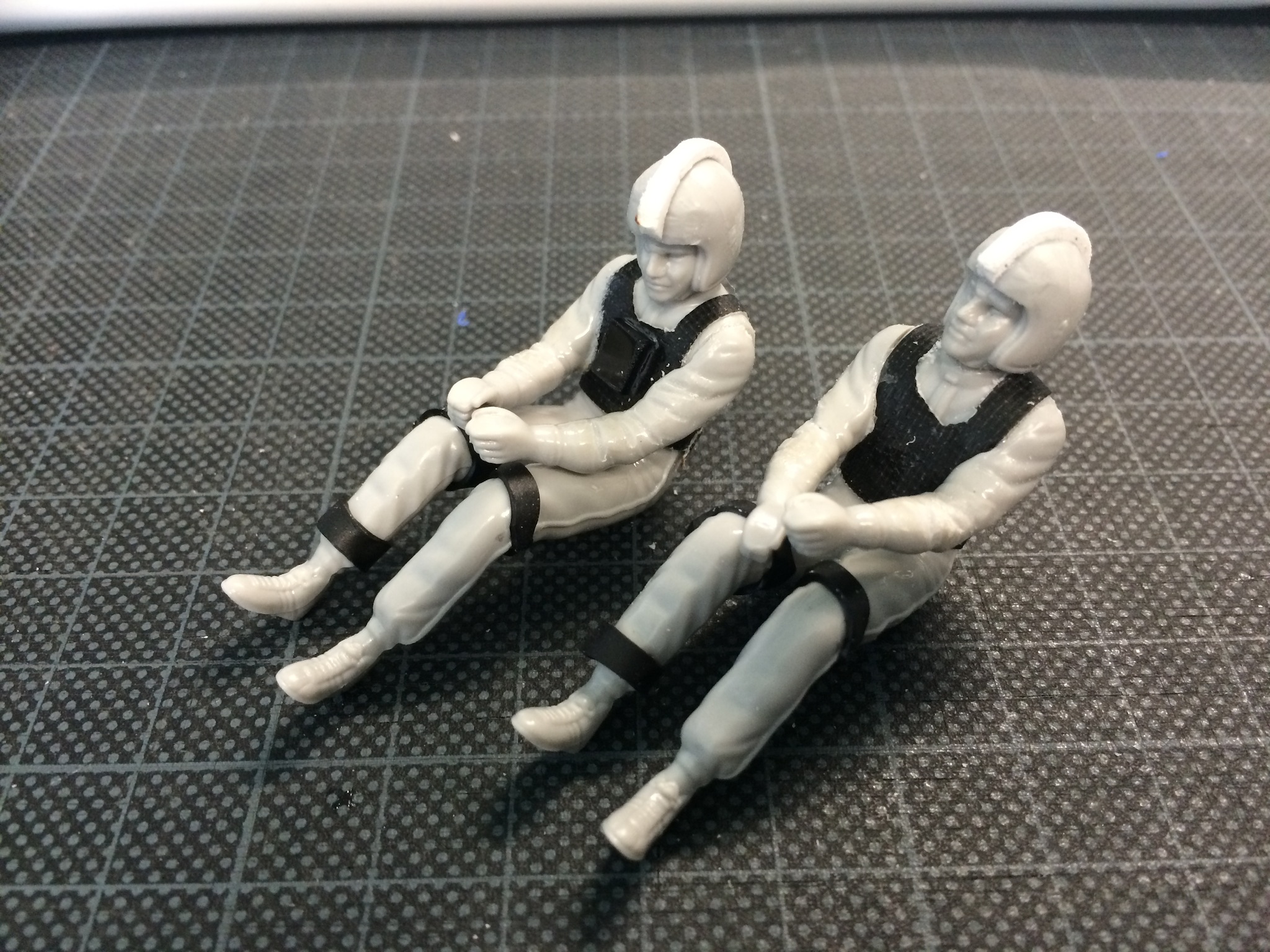

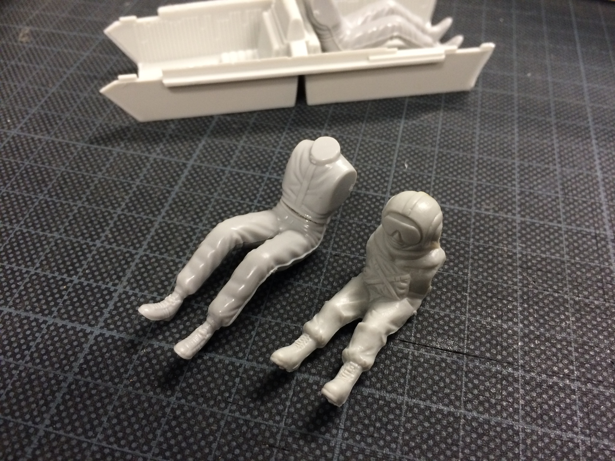

Did some work on the pilot & gunner.

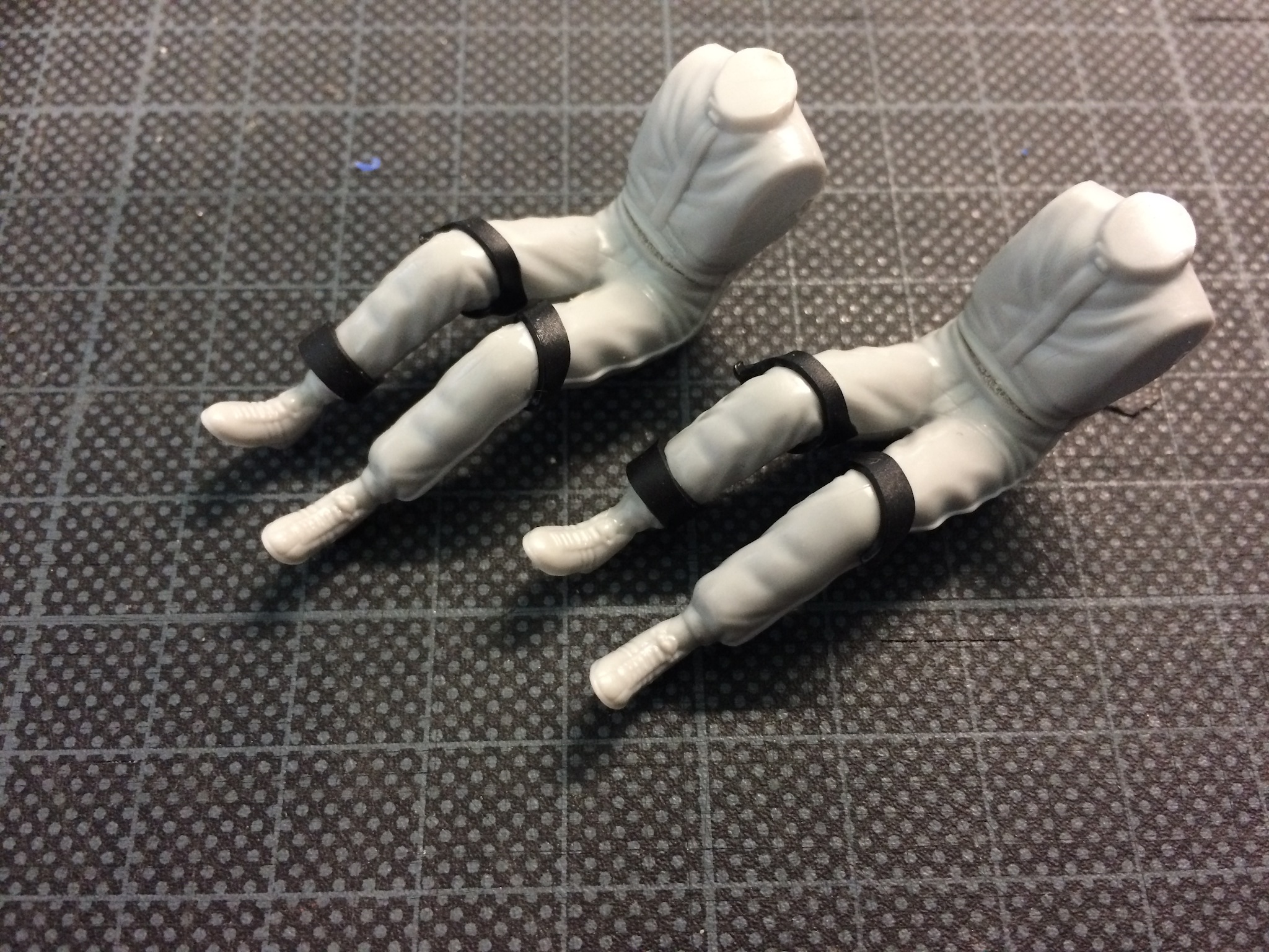

I added the straps and the ankle band using heat shrink tubing. Then I made a pattern for the vest which I cut out of gaffer's tape.

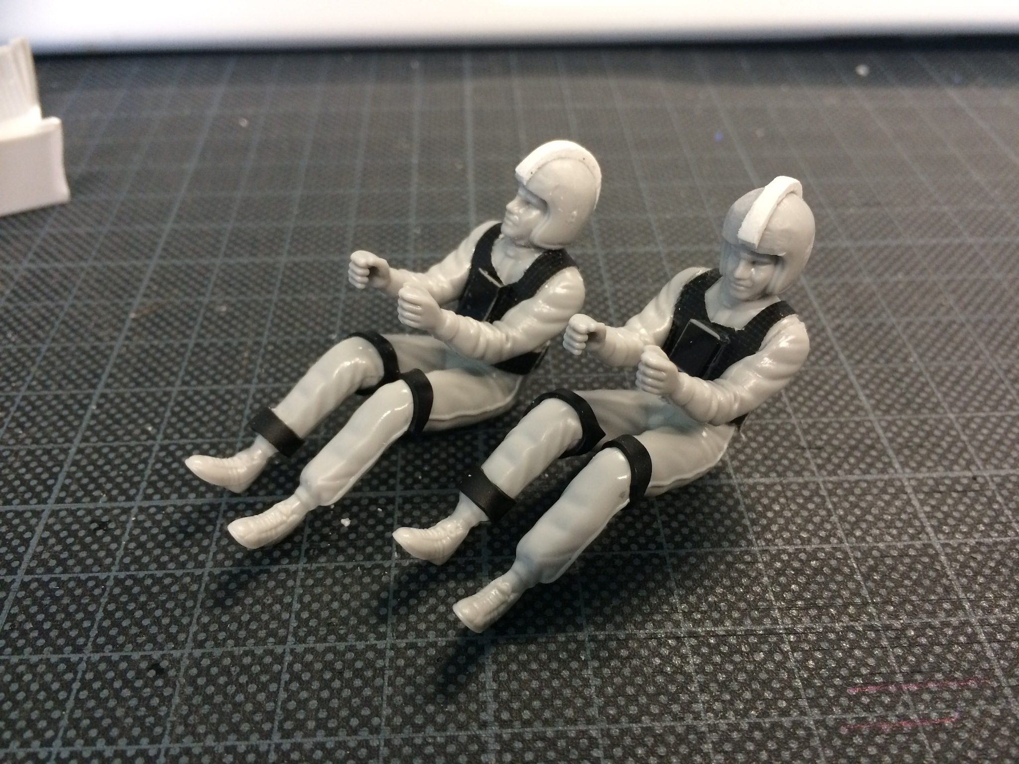

Added the crests on the helmets and mounted the heads one looking to the left, the other one looking slightly up and right. Then I added the arms and after some drying i heated up the arms to move them a little. I used a little file to add some wrinkles back, that were lost through heating.
Very good so far (flaps and tilting model)...It seems that the sliding part is a little rough; is there a way to make it smoother?
Thank you all for the great feedback.
The 3d printed hinges are a little weak/too loose and that's why the Snowspeeder wobbles. It might go away once all the weight of the rest is added, otherwise I will have to redo the hinges. I'll have to look into that.
