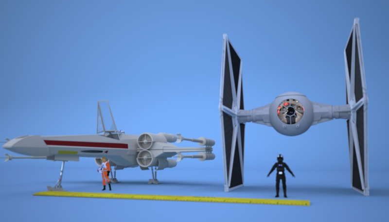

First, I did some checks to see if the Kotobukiya X-Wing was 1/35th scale as advertised. After measuring the height of the figures included with the kit, the diameter of the R2 dome, the length of the "droid strip" on the back of the fuselage and some other key measurements, it became apparent that the scale of the ship (based primarily on the size of the figures and R2 dome) is actually 1/38.
Next, I was able to get measurements from the eFX TIE and decided that since the pilot in the ILM miniatures was 1/24 scale, the rest of the ship should be the same scale. Sure, I know there's "official" dimensions for how big the TIE is supposed to be according to Lucasfilm but I wanted the size of the ships to relate back to the pilot figures inside them. After getting all the key measurements that I needed from the 1/24 scale model, I worked out the scale factor to reduce everything down to the desired 1/38.

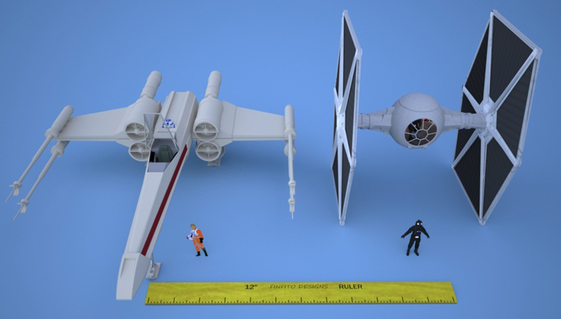

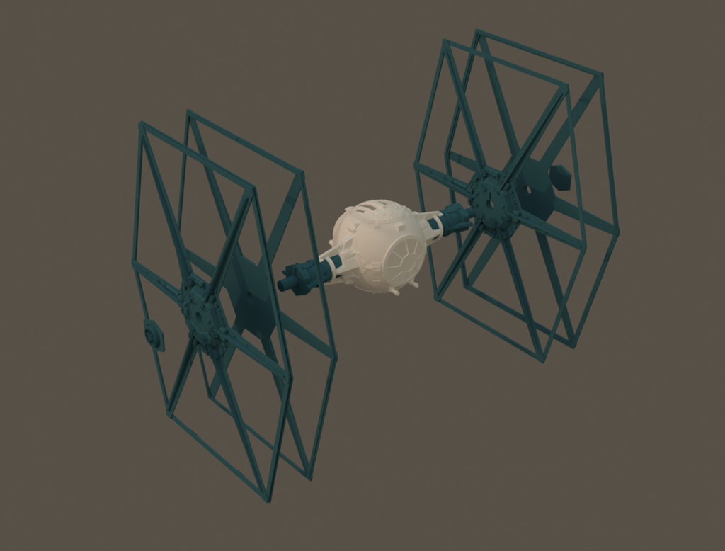

Here's a couple of renders showing the X-Wing (scaled to match the size of the Kotobukiya model) and the TIE next to it.

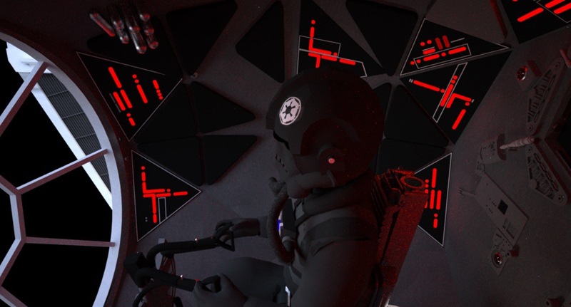

This looked great to me so I decided to go for it. Because this isn't a studio scale model, I wanted to put an accurate cockpit interior inside. Here's a render that was created from the blueprints of the full size set that the actors were filmed inside.

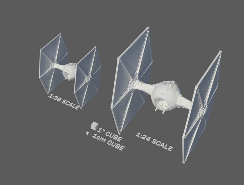

Next up, work was started on modelling the computer version of the 1/24 studio scale kit utilising measurements to match the diameter of the cockpit ball used by ILM and the thickness of the styrene "plating" they put onto it.
Here's a render showing the 1/24 model with the scaled down 1/38 version that we'll be printing.

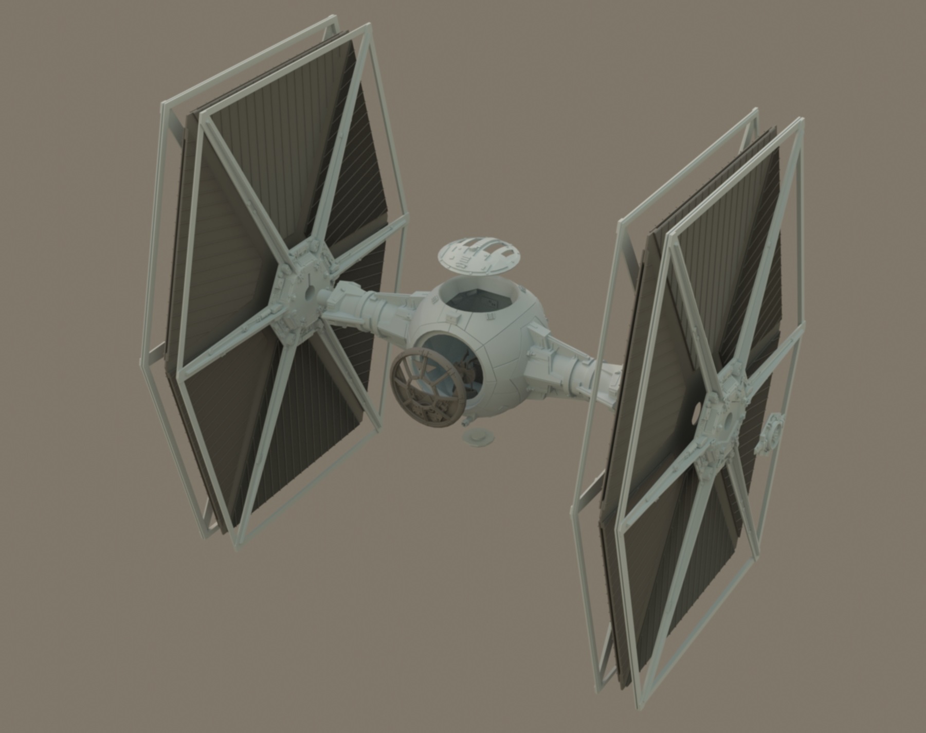

For the past couple of weeks detailing has been added to the model and it's being prepped to make it "print ready". Note that the Koolshade panels aren't shown in the renders because it slows down the rendering time. Originally, we were thinking of creating the wings the same way as the 1/24 model but after thinking about it from an ease of assembly and painting point of view, we decided to use the same sort of technique that Fine Molds did on their 1/48 kit. Basically, there will be a black Koolshade panel with all the segments of Koolshade on one piece with recessed grooves in the panel which the "wing stars" and surrounding frames will fix into after the Koolshade panel is painted. The scaled down Koolshade panel will still be "sandwiched" between the wing stars, it just won't be done in separate segments. This means that the Koolshade can be painted black and the wing stars / framework can be painted haze gray separately, then stuck together after painting to avoid any tricky masking. Great!

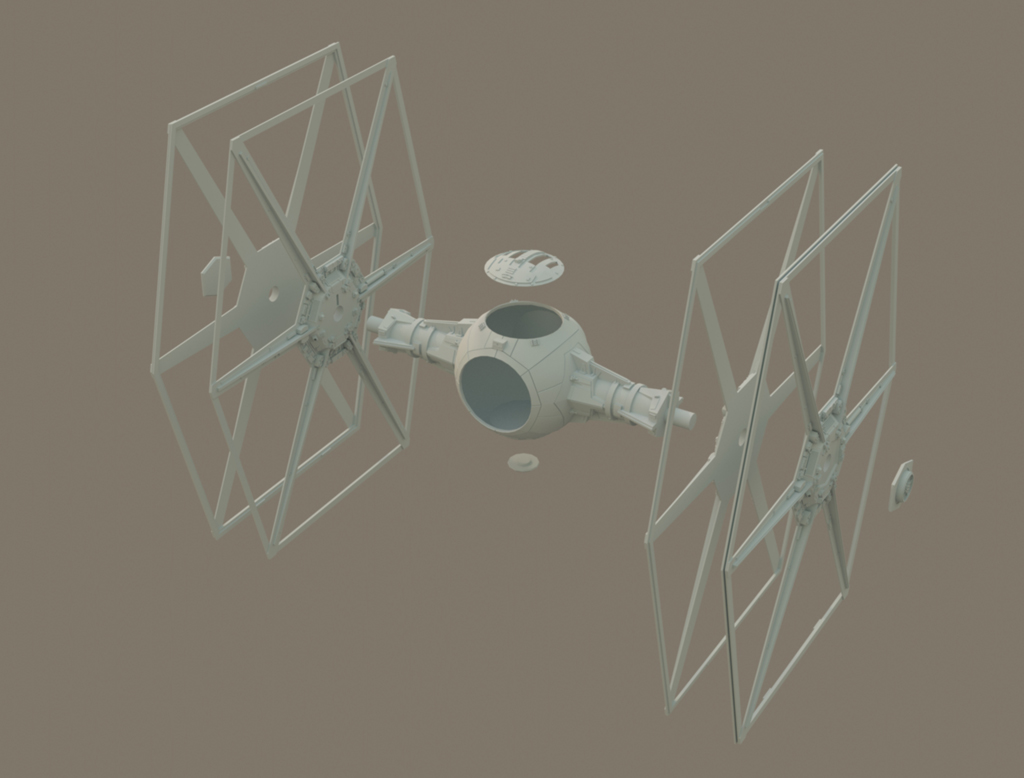

Here's a couple of renders showing the de-constructed model.

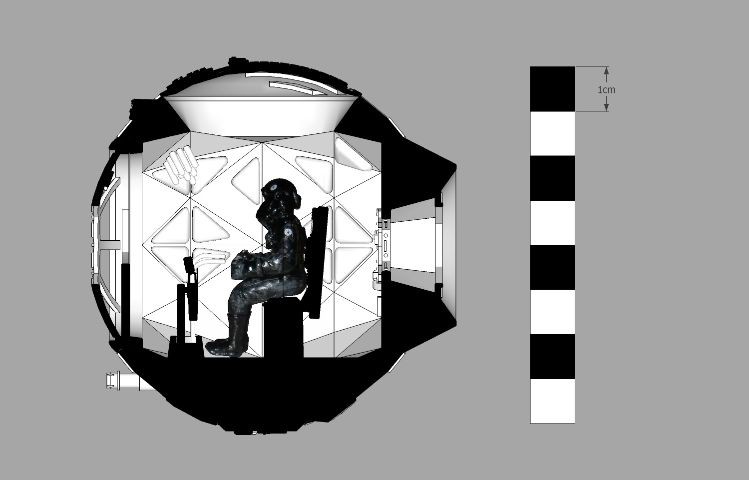

Here's a cross-section of the cockpit ball (with a photo of the Revell Easy Kit TIE pilot in place to make sure everything is scaled correctly).
Re: ANH TIE Fighter model (companion piece to Kotobukiya cross section X-WING)
Funny, that looks almost spacious.

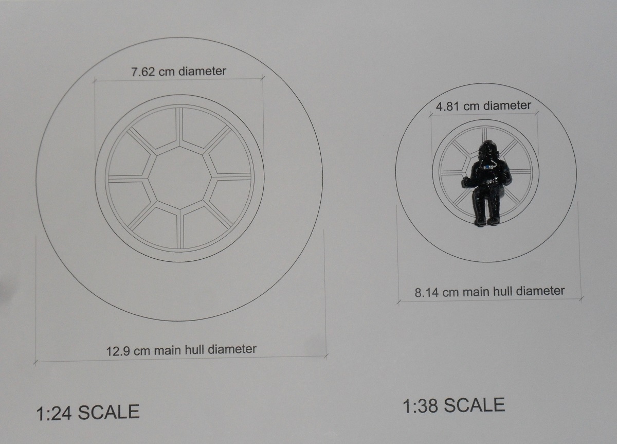

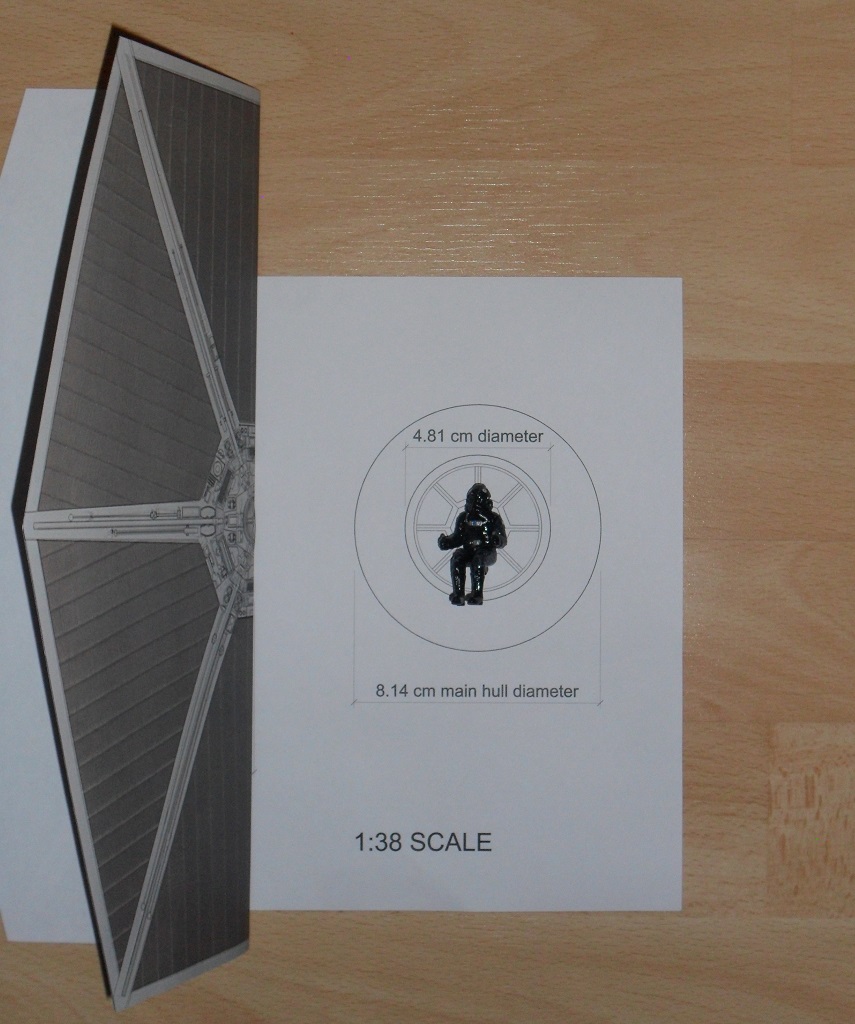

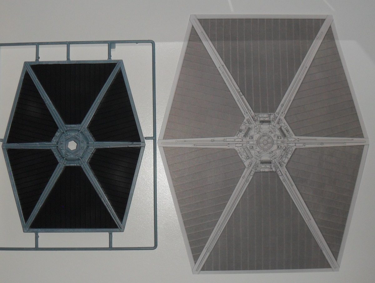

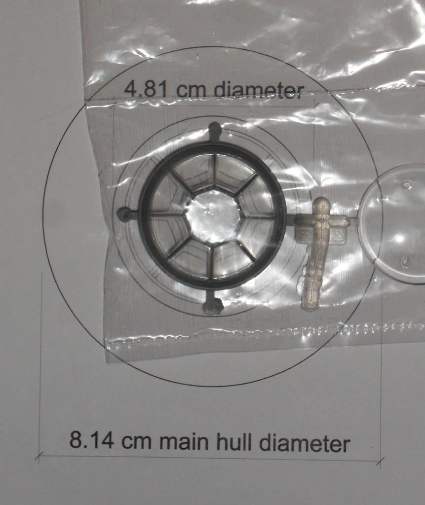

Here's some pics showing a comparison between the 1:24 studio scale cockpit ball and the scaled down 1:38 version to show the relative size difference. I've also posted a pic showing the 1:38 scale wing printed out at full size compared to the wing from the Revell Easy Kit TIE (which is the kit that I've taken the pilot figure from). It's amazing to see how undersized Revell made their version compared to the pilot figure that they used which is definitely around 1:38 scale.
I'm really thrilled with the size of this. It will fit inside the IKEA Detolf shelf beautifully and will be a great companion for the Kotobukiya X-Wing.

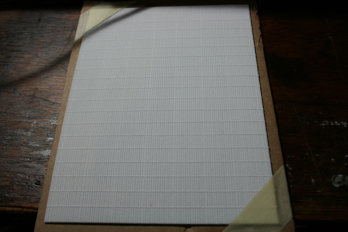

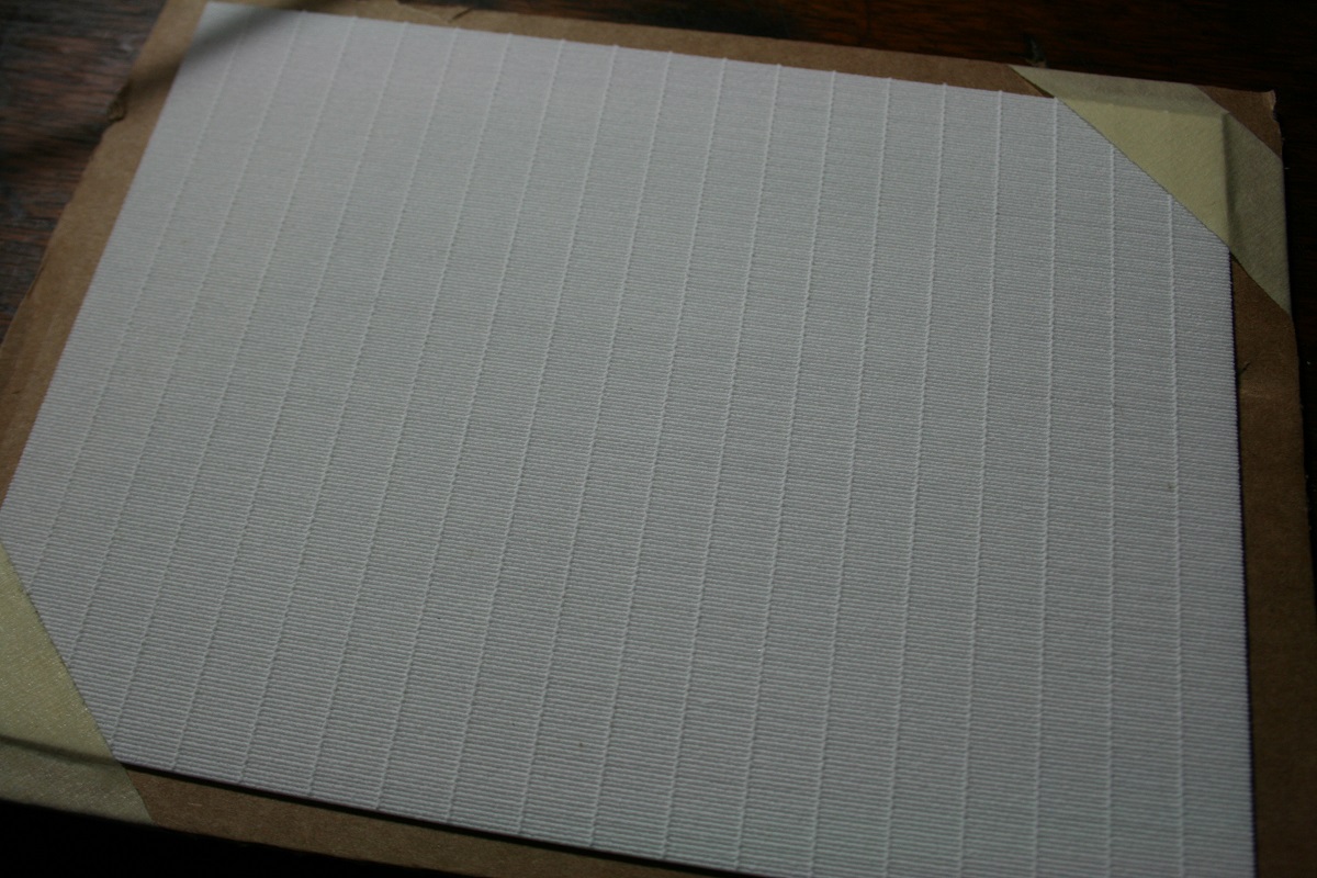

Great news guys! We received the test print of the 1:38 scale Koolshade today and it's turned out REALLY nice!
Not long before we can get the rest of this model printed and assembled. Here's the Koolshade test prints (remember - this is 1:38 scale folks, not full size Koolshade. Hard to believe when you look at the pics) !

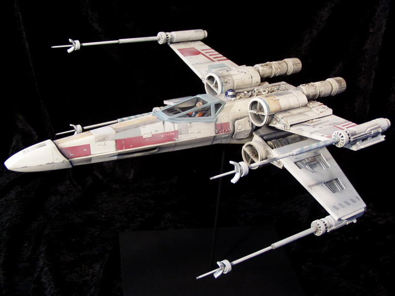

Glad you found the thread and like what you're seeing. My Koto X-Wing is displayed on a stand in flight mode. I didn't bother with all the ground crew / diorama stuff because I wanted to display just the ship. I wanted a TIE to display next to it hence the reason doing this project. I agree that it would be cool to have a Y-Wing too but I think that would require some extensive computer modelling and my funds can't run to commission that sort of project at the moment.

And it shows that having koolshade grown does not necessarily take months :p What I don´t get, though, is why didn´t you just had the area of ks grown that is needed for a wing? Is it "for the feeling that we now have miniaturized sheets of koolshade"? :p
And on what printer was the koolshade grown? The resolution looks to be a bit rough. The shapeways frosted ultra high detail is def worth the money.

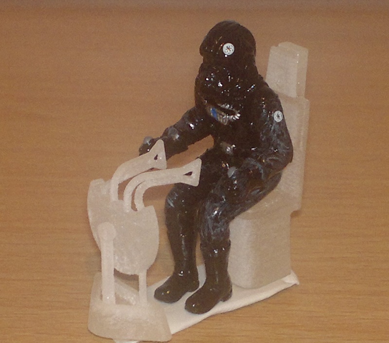

However, we did get the cockpit seat and console printed and I just received them so I could make sure that the pilot figure fitted correctly. His arms need to be bent in so that his hands are holding the controls but apart from that, I think it turned out pretty well.
