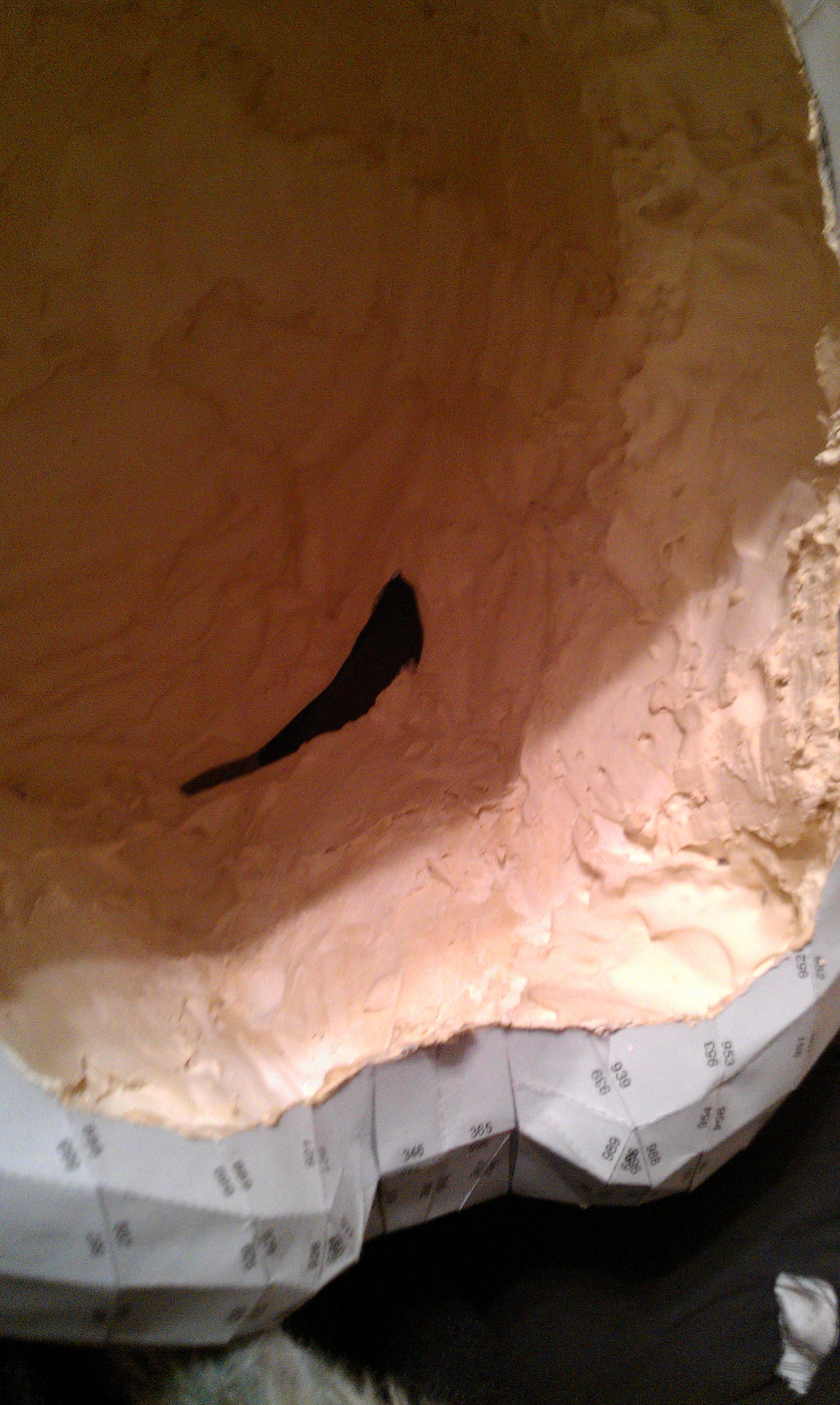

Still needing more reinforcement, I decided to try Durham's Rock Hard Water Putty (a powder you mix with water). The reviews looked good, it's very inexpensive, and come to find out a friend used to use it on his model airplanes.
I made a small batch at a time (after mixing, was maybe 1/2- 1 cup) and just applied it 1/8-1/4" thick. It dries very quickly. If you were too slow applying, it would start hardening in your bowl (was pretty easy to remove though, would just flex the bowl.You're advised not to do a paint-like coat as it will probably crack, due to thinness and flex). I would still hit it with the hairdryer for a min to speed up the process. I did do an extra layer or two around the base, just in case.
I didn't bother sanding the inside as I don't care how it looks, but it is sandable and paintable.
This baby is now as hard as a rock.
