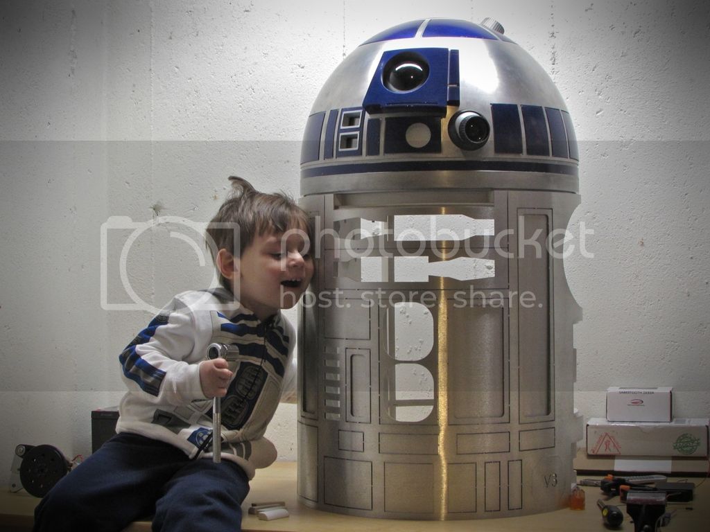

Not a lot of progress lately. I've been cutting out the panels on the skins with my dremel. There's a lot to cut out and all the little tabs need to be filed down afterwards. It's slow going.
But at least I have help!
