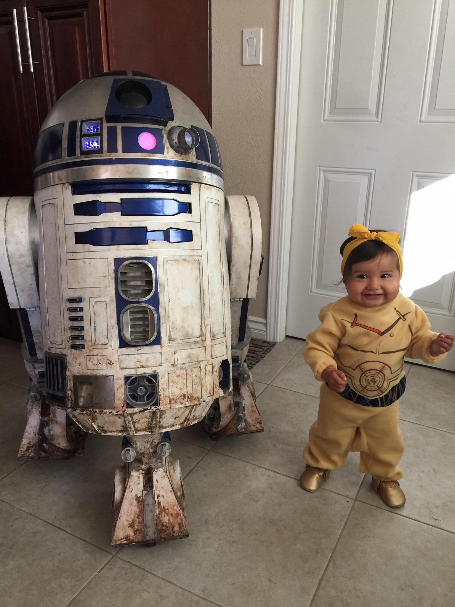

Not sure which one mine most looks like. but i'm happy to say it's all metal ( don't go this route unless you want to be broke, but i found the material easiest to work with).
and it still works after a few years, which is rather amazing. mine is just basic though. he doesn't even have a light up HP.
This is his second head. as the first one used JB weld that leaked all over the place. the second one uses E6,000 and it's MUCH nicer to work with and just as strong.
It's also his second batch of frames. we took these frames to a car place to be painted. I forget what they did to it, but it came out GREAT compared to what I could do to the thing.
I went though one head rotator after the wires got ripped out somehow, as well.
It's an interesting journey, but it was fun and nothing beats getting r2 parts in the mail.

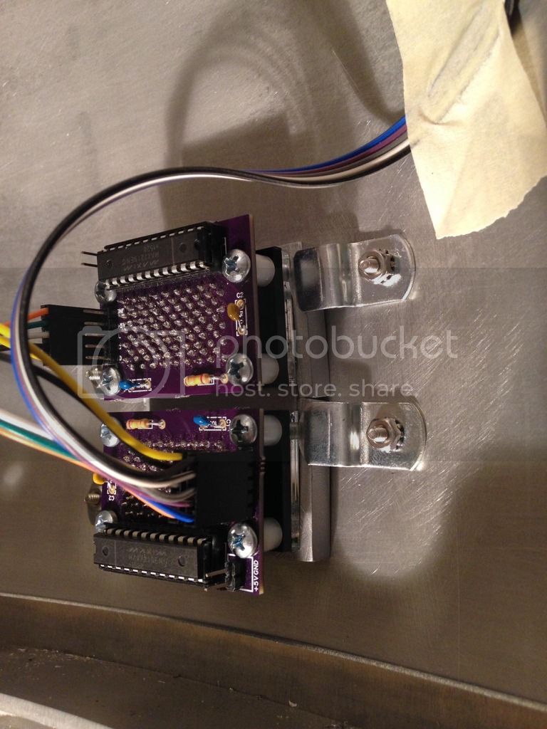

I've been working on assembling the dome some more. The idea is to use hardware to attach the various parts instead of glue or silicon. Here I used mirror clips to hold the front logic display and they worked great.
I've also been weathering a little as I go. Mainly chipping the paint. He'll get dirtied up real good eventually. I've been hitting the dome with a hammer but it's not very noticeable. I'll have to take things up a notch.
You have to be careful where you drill holes. Everything needs to be covered by the outer dome and the panels.

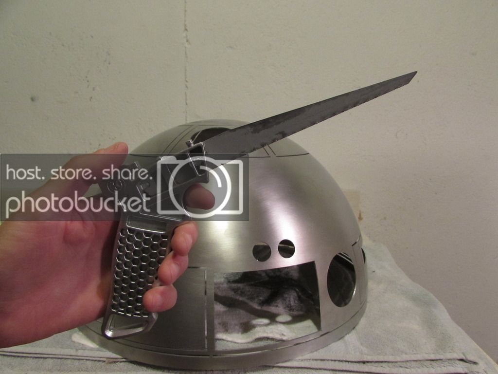

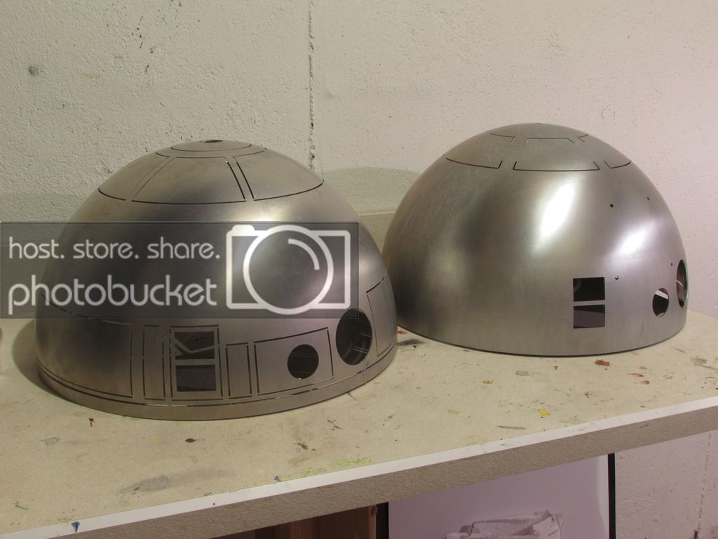

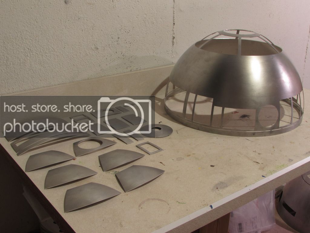

Some progress photos of the dome. These things are laser cut and amazing. The laser cutting process leaves sharp burrs on all the edges and it took me about two weeks to smooth it all out by hand.
I used a mini hacksaw to remove the panels.
Panels all cut out and ready to be cleaned up.

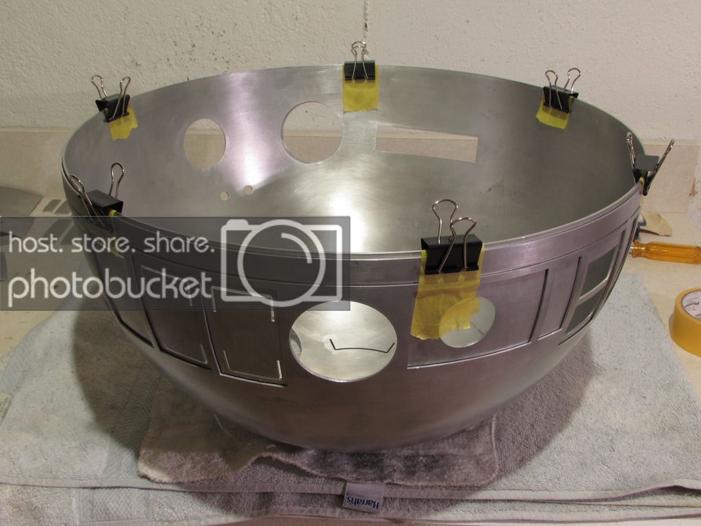

Lining up the inner and outer dome to drill the holes for the radar eye.
Everything lined up great. The panels on the inner dome can be removed if you want them to open with servos. I left them intact.
Panels ready for paint.

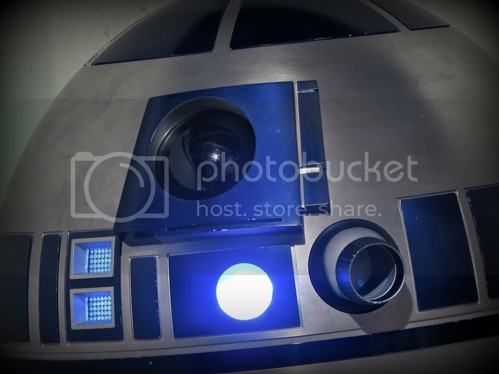

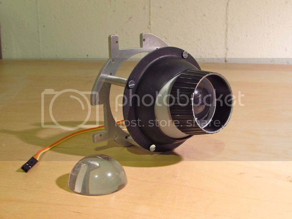

I've been working on the holos for the past week or so. Got them all painted up and received three 1.5" acrylic cabochons in the mail today. They look really cool with the lenses in. I also got the servo mount fitted on the front holo. This is where you mount the micro servos that will make it twitch.

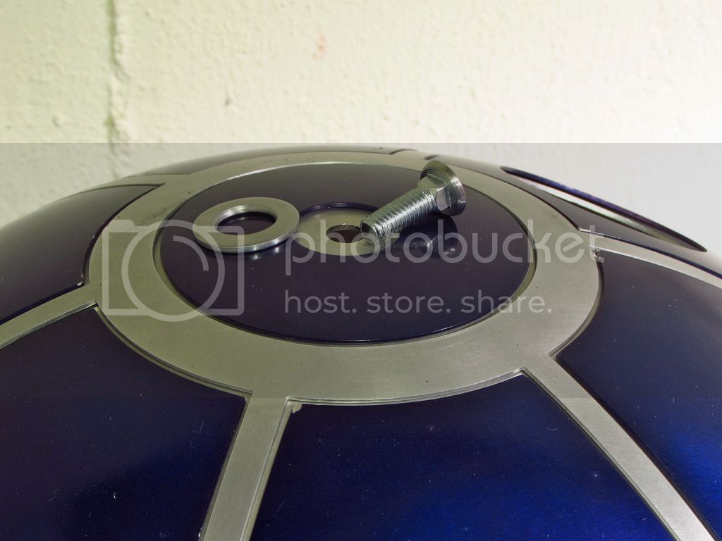

I also picked up a carriage bolt and washer to make the dome topper. I made the dome bumps out of carriage bolts and they worked great. I just have to reshape the bolt and contour the washer a little.

A small update, but I thought it was neat. I made a dome topper out of a carriage bolt. Turned it down in my fancy lathe (hand drill and file) and countersunk it into a washer. I also rounded the edge of the washer so everything would be flush with the top of the dome. I had to remove a lot of metal from the head of the bolt so this took a while. Probably pretty easy to do with the right equipment, but now I have a nice threaded topper.
