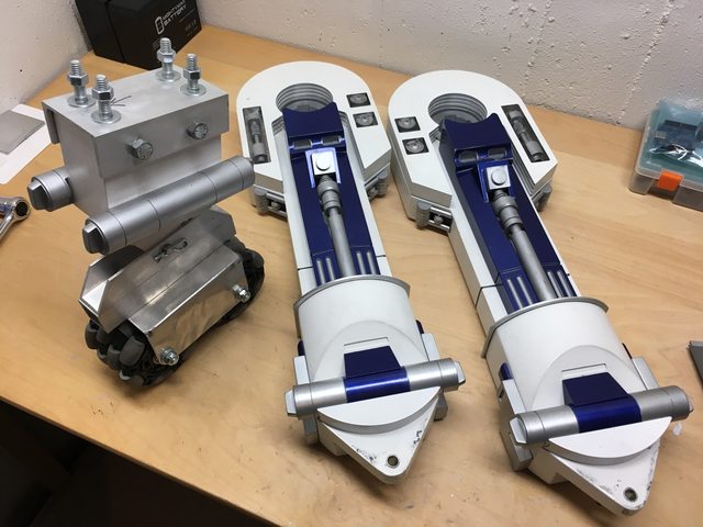

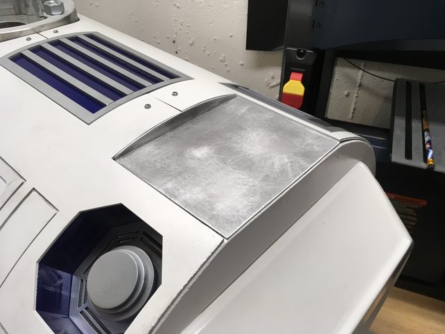

Nothing too exciting lately. I had mod my frame to get the power couplers to fit. That included routing out the bottom areas and removing a support in the front. I also had to slice the file and reprint a new one for the front so it would fit between the slanted uprights. Should be good now.
I've also been working on finishing some of my 3D printed parts. Slowly but surely getting there.

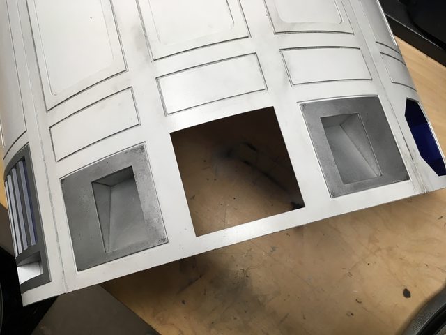

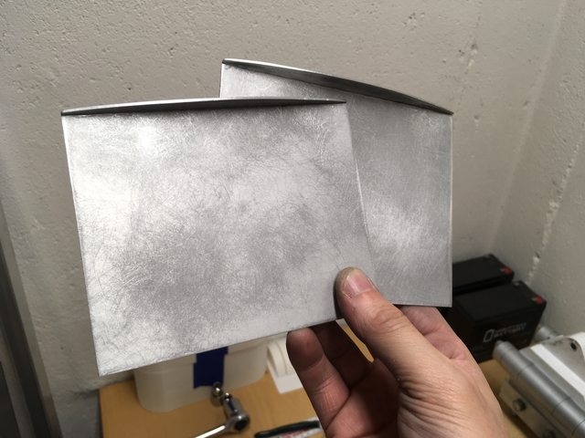

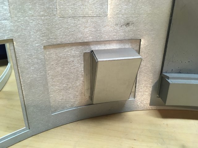

Very nice. Great job on the kick plates! Usually the aluminum frame has that curved part so the kick plate is just a flat plate that screws in from behind. I really like this design. Gives it a bit of additional geometry. excellent job.
I'm also very curious to see how you like those smaller omni wheels. Can't wait to see those bad boys in action. I have the larger ones and I absolutely love them, but I'm dying to know how differently these perform, if any different at all.

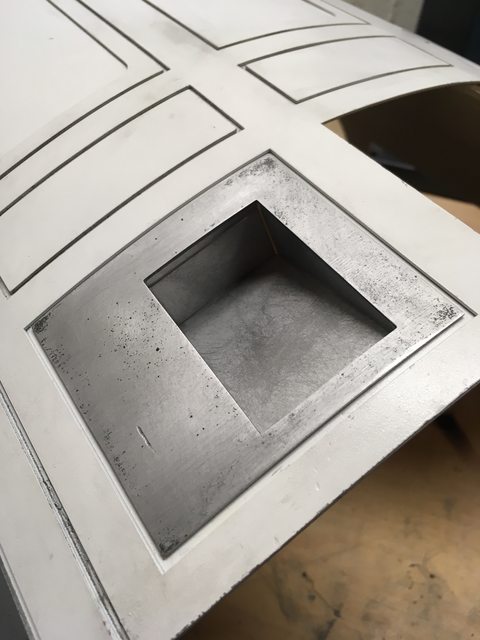

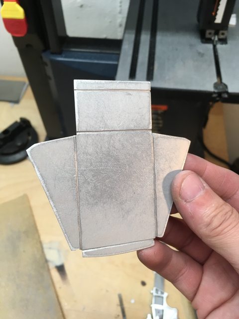

Thanks! I wanted to avoid having a big gap under the skins there. I think what I came up with looks pretty slick. Didn’t take too much time either. I’ve already painted them and stuck them on with E6000.
What kind of metal did you use for these? When I did them for R2, I used aluminum roof flashing and it was a little thin for what I would have liked. Broke numerous times until I got it right. I am building an R5 now and want to improve on this.
-Eric
-Eric
It was some scrap aluminum I came across, just under 1/16" thick. Not really sure how thick it is. I experimented with flashing as well and like you said, it's just too thin. The outer facings were actually leftover skin parts that I cut rectangular holes into. That was the hardest part of the whole thing.
