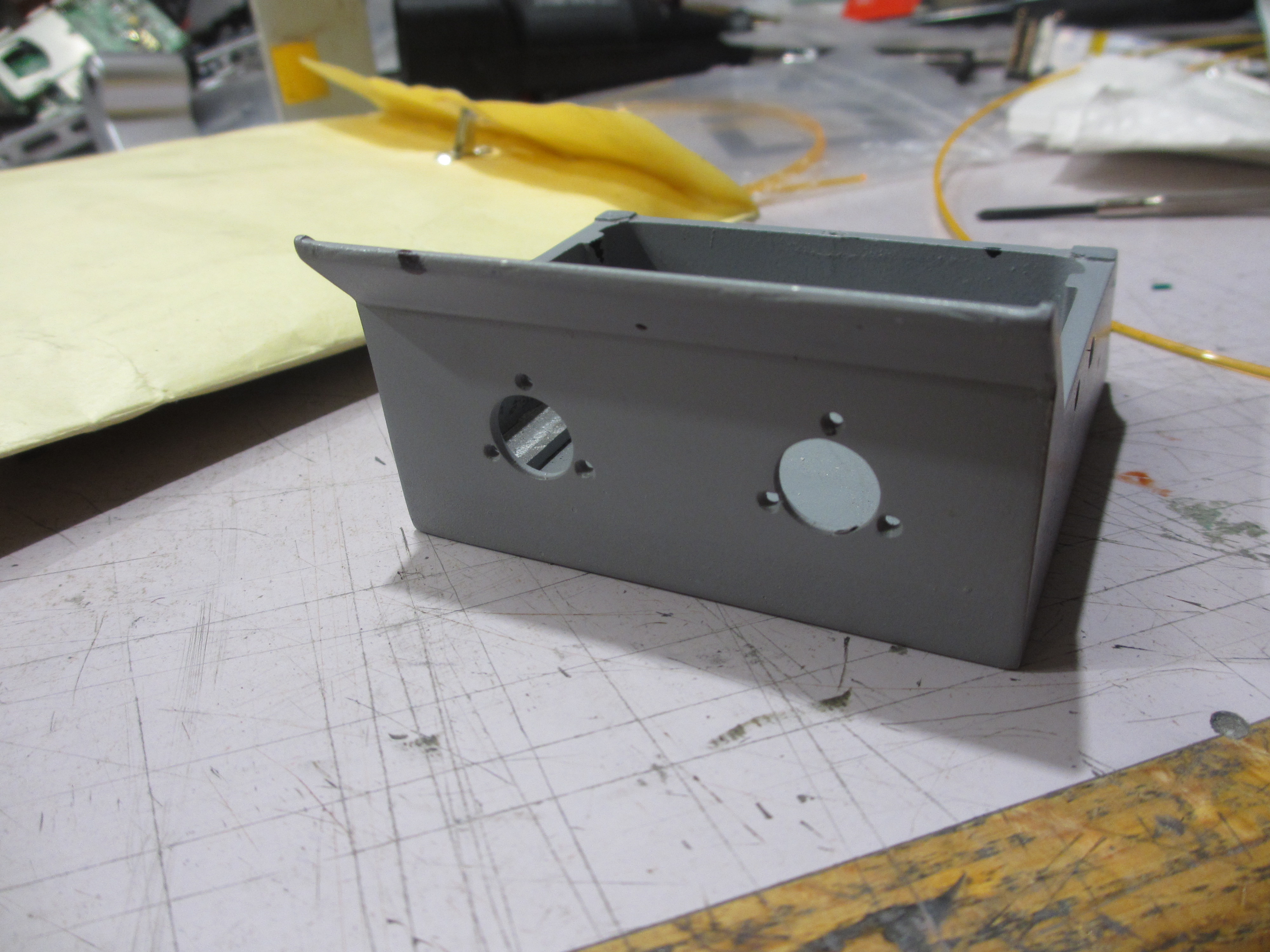

I’m 99% certain the transition box is made from the Kalimar body. It’s a pain to do but it matches up to reference.[/QUOTE
That's what I used on my builds.

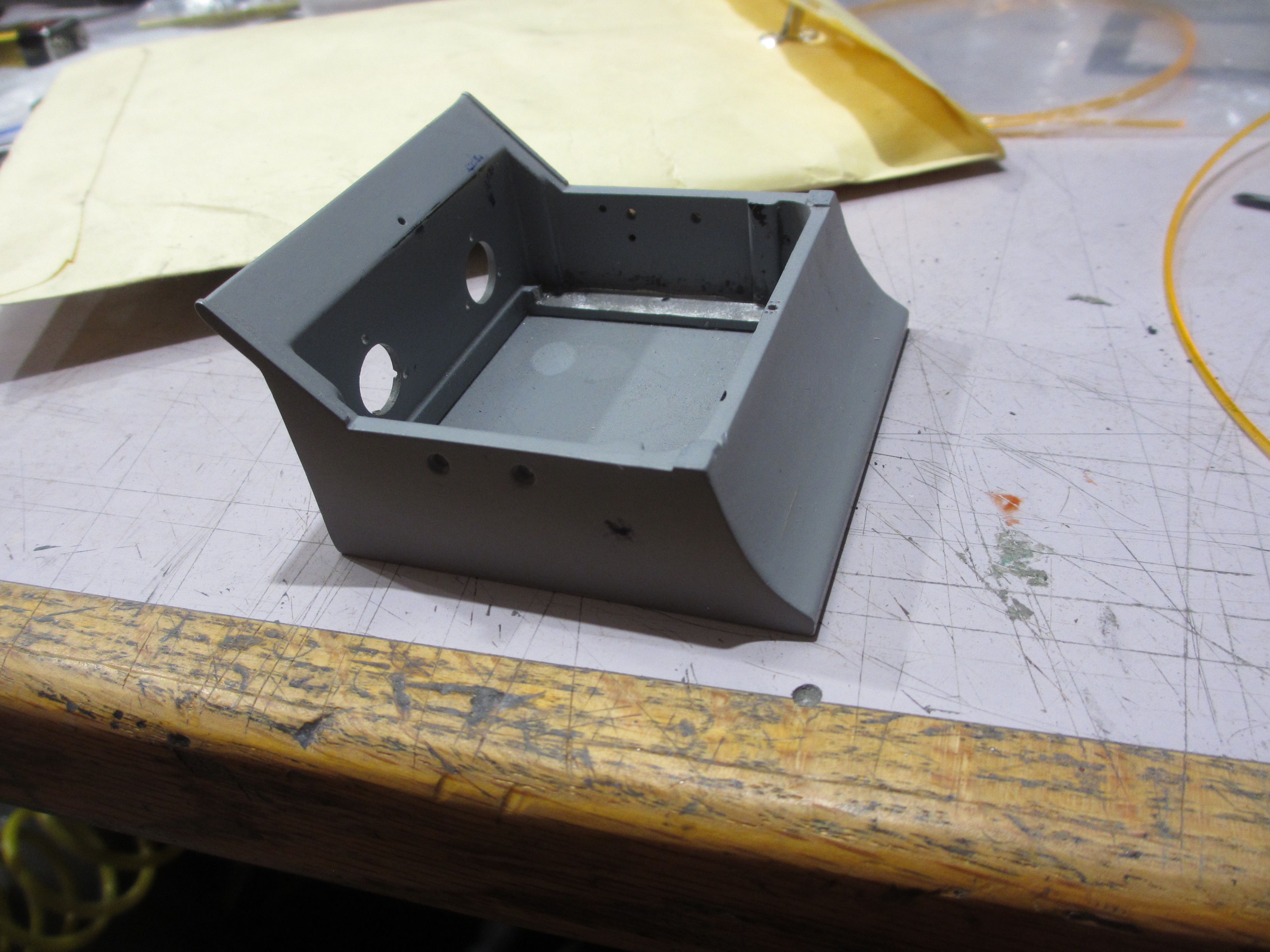

Jerry...post a picture of the transition box I build, if you want
Odiwan72's box is a work of art !
fyi to others, my resin transition boxes are molded from a moded kalimar top...only way to do it !!!
That's what I used on my builds ��

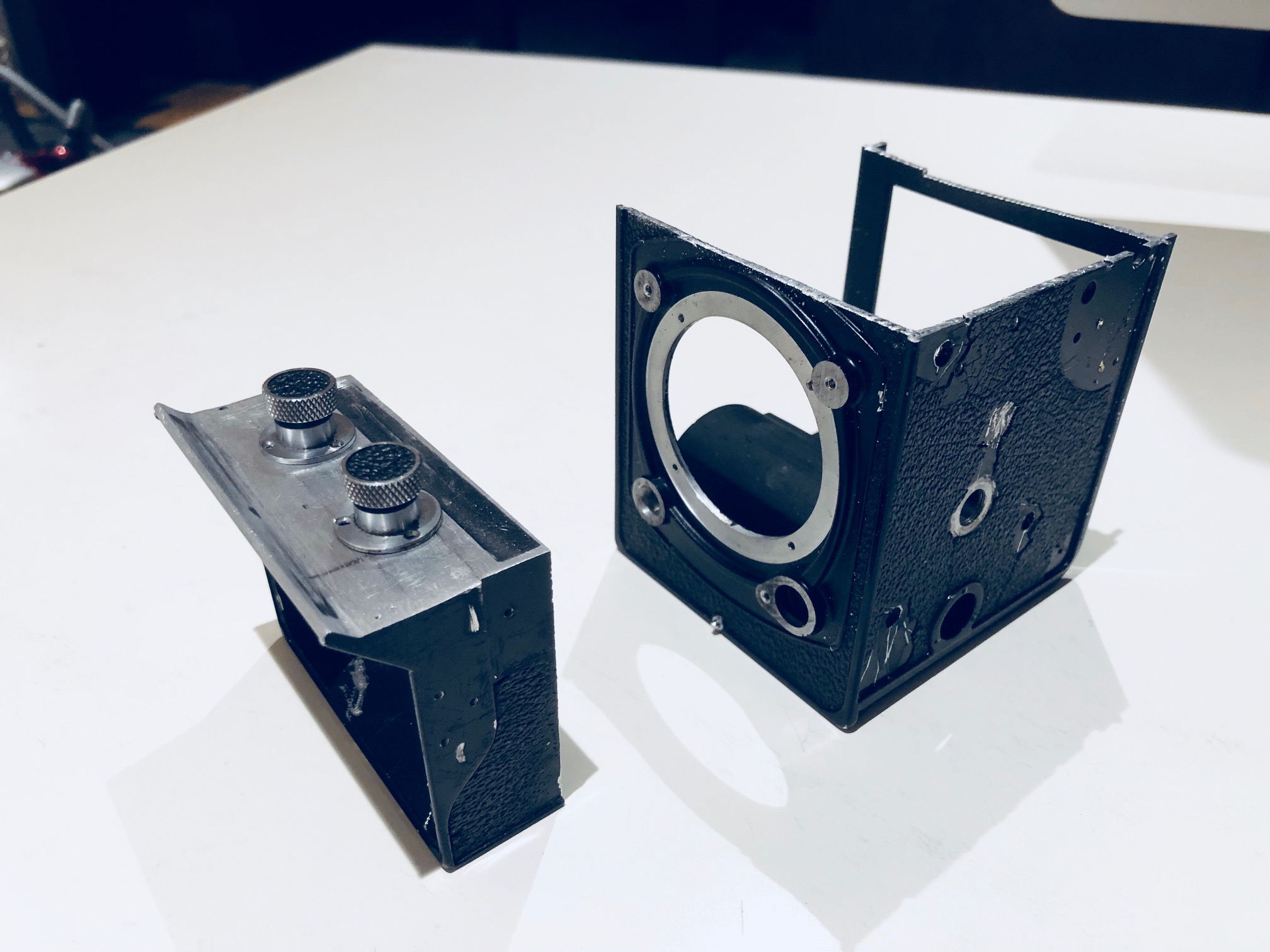

I'm trying to visualize this as to what part of the camera was cut and bent to make said transition box.
Wow, I never heard of making the T-box from the Kalimar body ... I love that idea! Would love to see a build thread for one of these!
the top is cut off, then a bottom plate is added. i fill in the swoop with filler, but you can also bend a piece into shape. for my purpose i just needed it to last for making a mold. i find the resin is more sturdy than epoxied together parts.

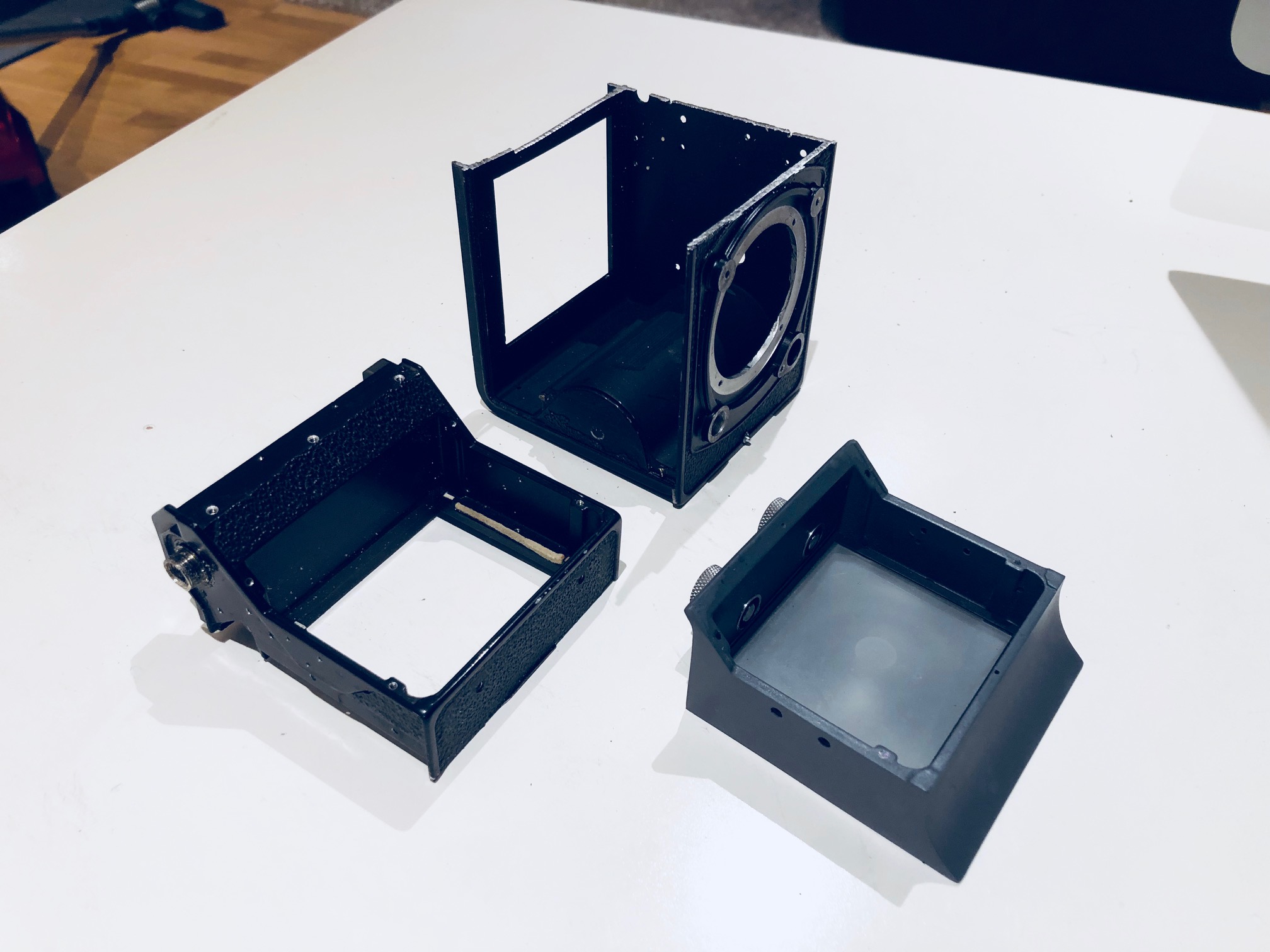

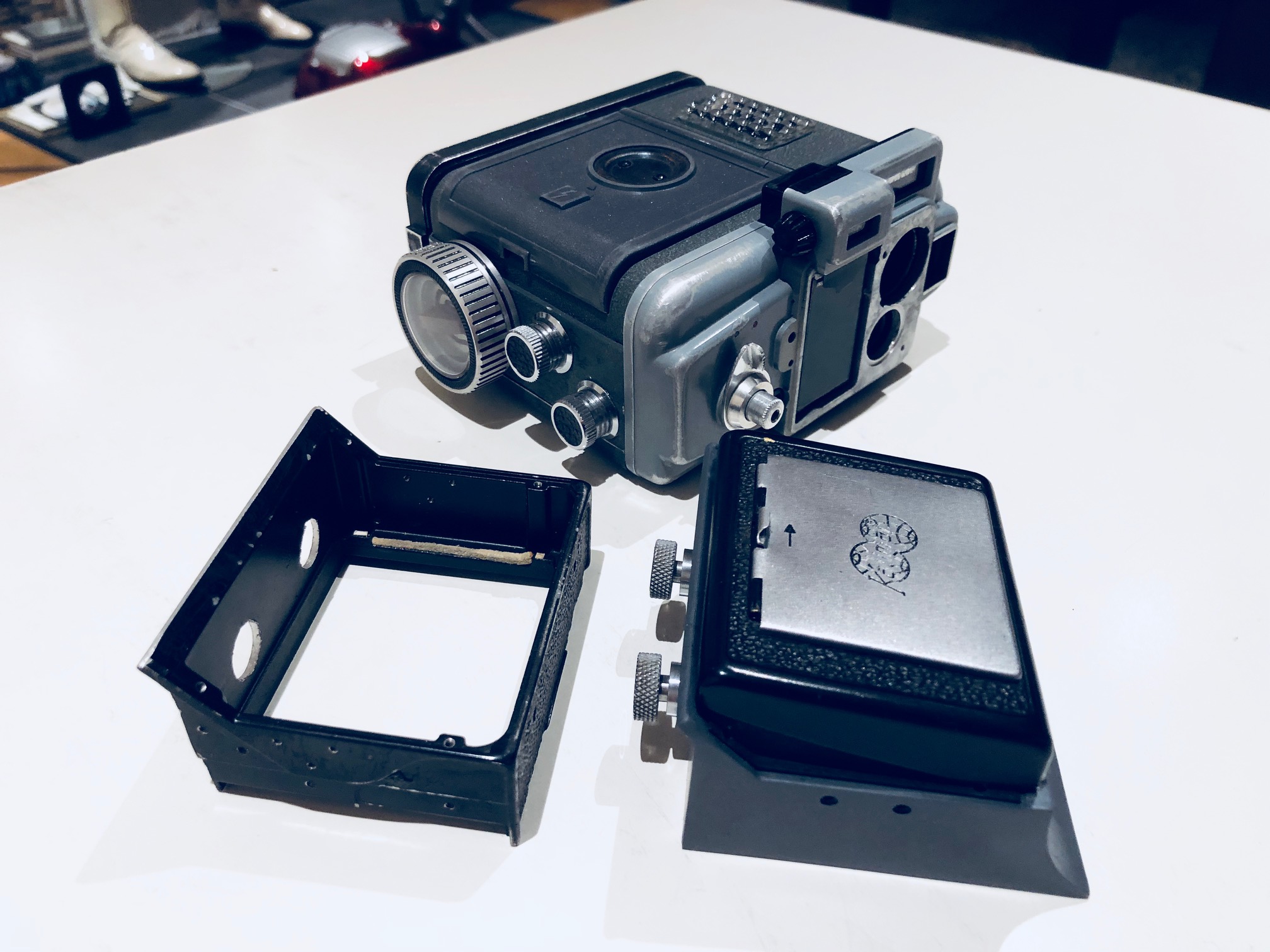

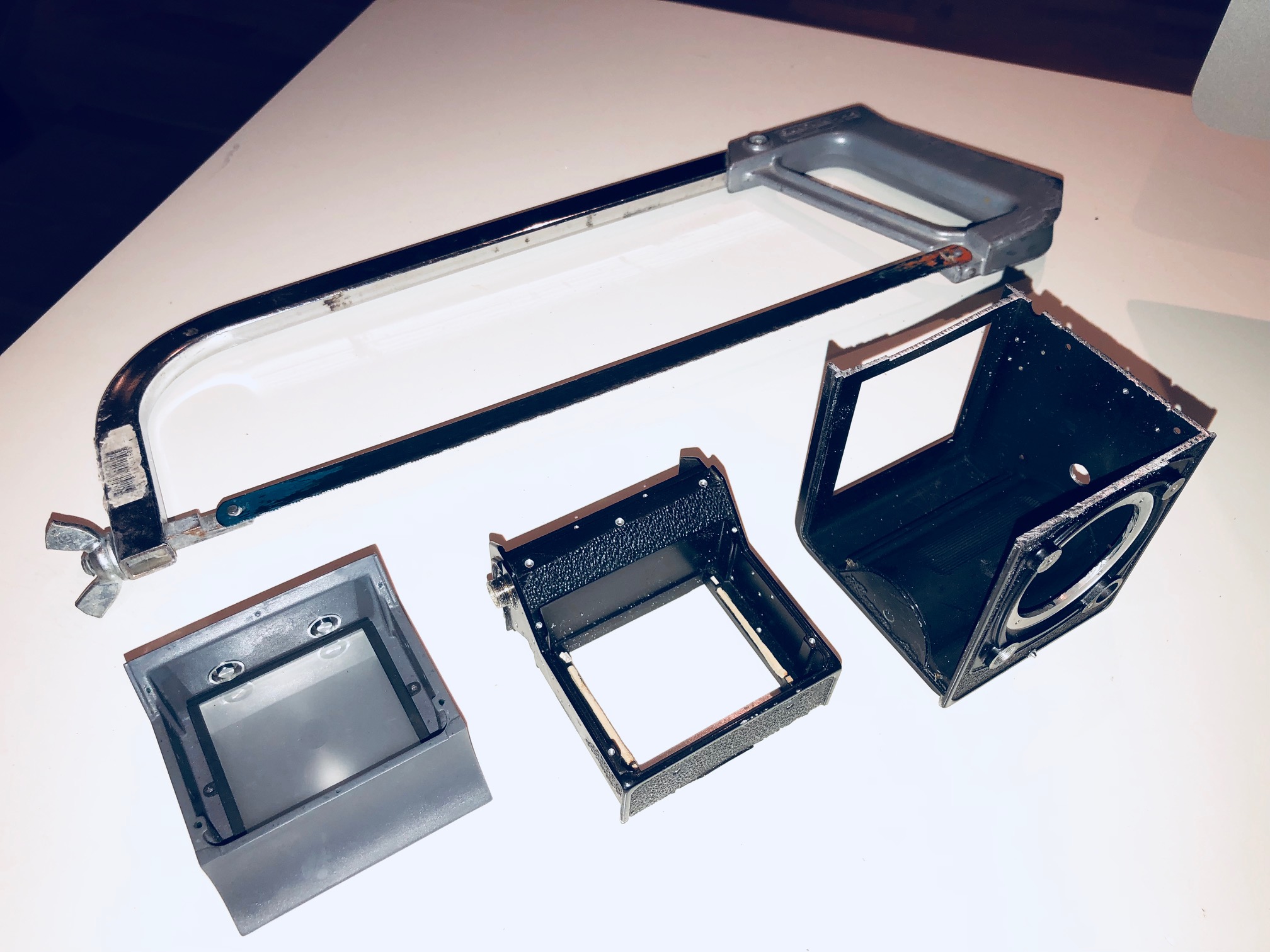

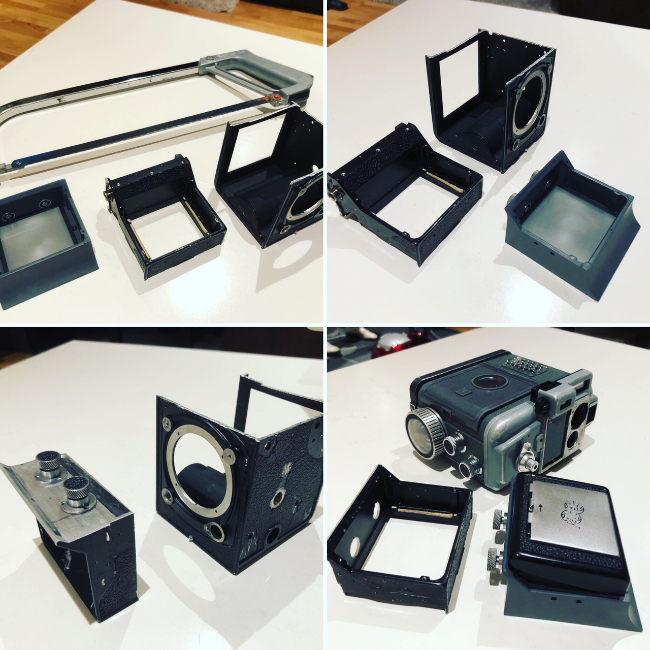

I am playing around with making a transition box this way and have cut the top of a kalimar reflex camera. Pretty much identical to the six sixty. I used a hacksaw to cut the top of, and then sawed and filed off the excess material. The next step will be to add the bottom plate and make the lower bend. My sawed off top is showed next to the excellent resin part i for from Jerry
View attachment 807374View attachment 807377View attachment 807376View attachment 807375View attachment 807373
Exactly how I did mine...well done
Wow, that is so cool! I think you've sold me on trying this. Hacksaw did the job?
The original transition box was likely something made from scratch by the propguys. This is more an alternate way to make it i think.
Very impressive.
Looking forward to the finished product.
(I'll be using Jerry's as I don't have a camera)
